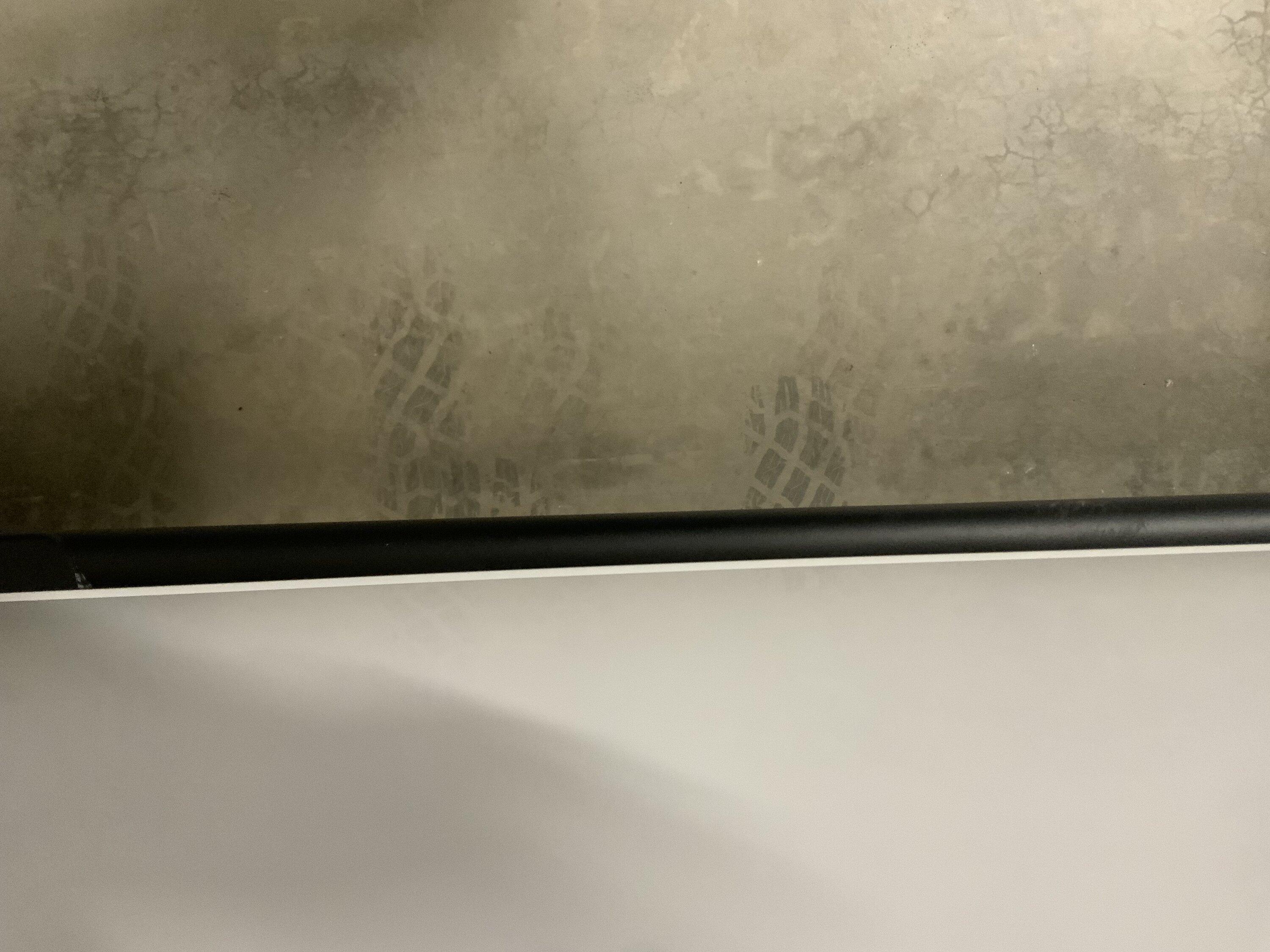

I am very sure that an adult would not be able to use these as a step. A little one might be able to. The sliders do fit pretty snug against the body. With the door open from the sill to the edge of the slider is only 2.5 inches.

top picture is with the door open.
bottom picture is looking down from the door handle .

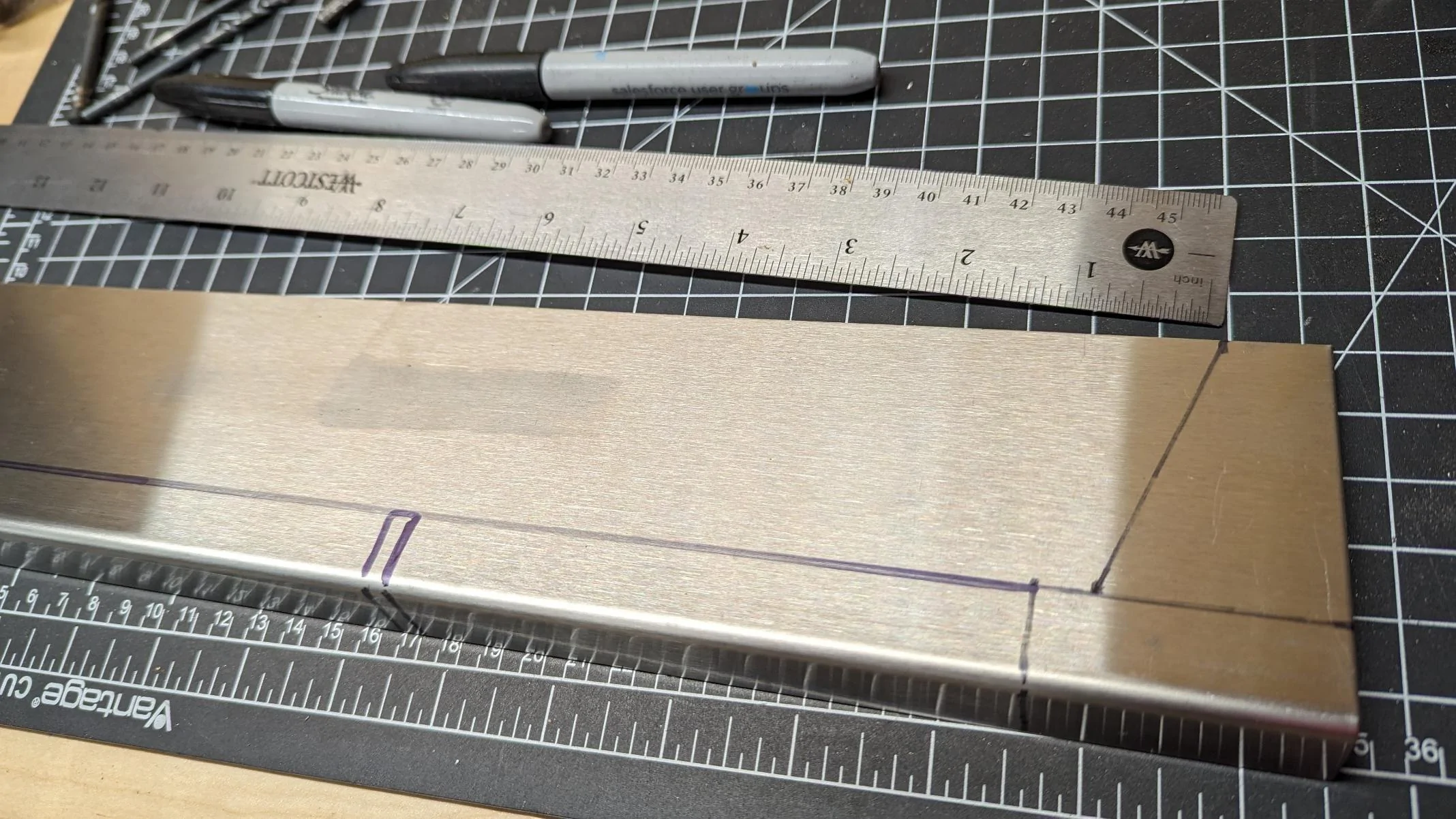

I definitely didn't want to carry that ballast – it would eventually lead to corrosion. After some ideation, I came up with a solution on how to protect the internals from dirt, and here's what I did. I purchased two 60" x 3" x 0.75" 18ga stainless steel corner guards and made covers out of them. I coated them with the Rust-Oleum primer and textured spray paint.
Ford Bronco Turn Off-road sliders - reviews / feedback? 1708930737432
Ford Bronco Turn Off-road sliders - reviews / feedback? 1708931710129
When I bought these rock sliders, I liked that all the seams were covered with sealant, but later I came to the conclusion that it would have been better if TOR had made some cutouts along the bottom edge instead, so the water and dirt could find its way out. Even though I closed the top opening with the sheet metal, I drilled 5 small drain holes along the bottom edge, so that the water from a pressure washer could drain out and not sit there for days.
Ford Bronco Turn Off-road sliders - reviews / feedback? 1708930955956

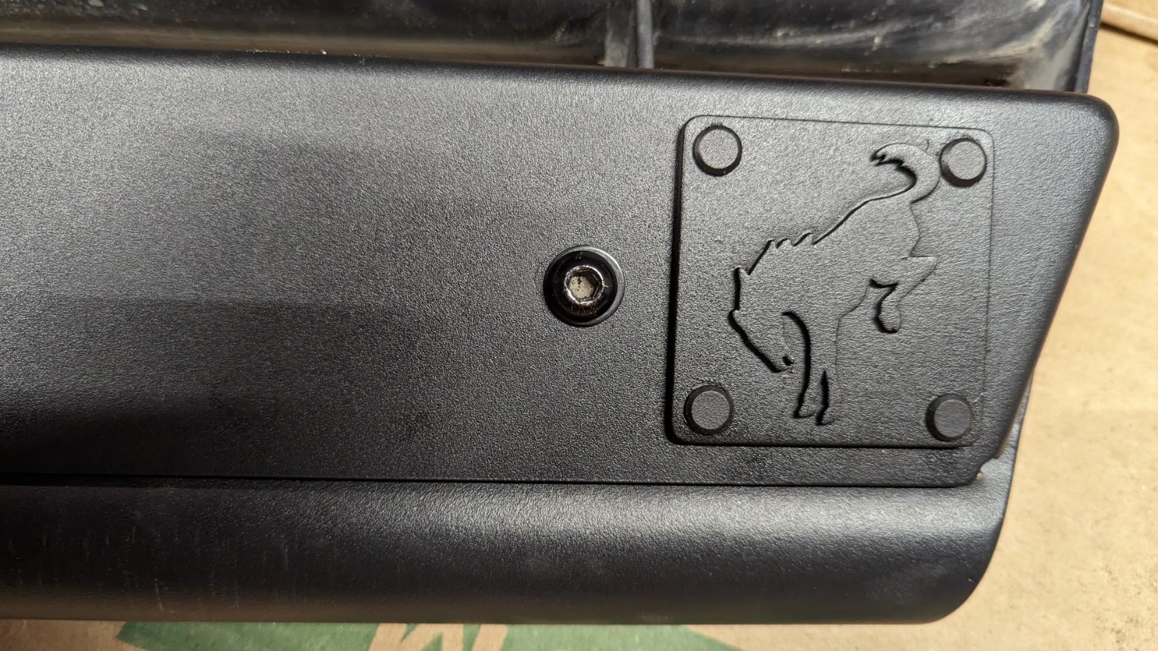

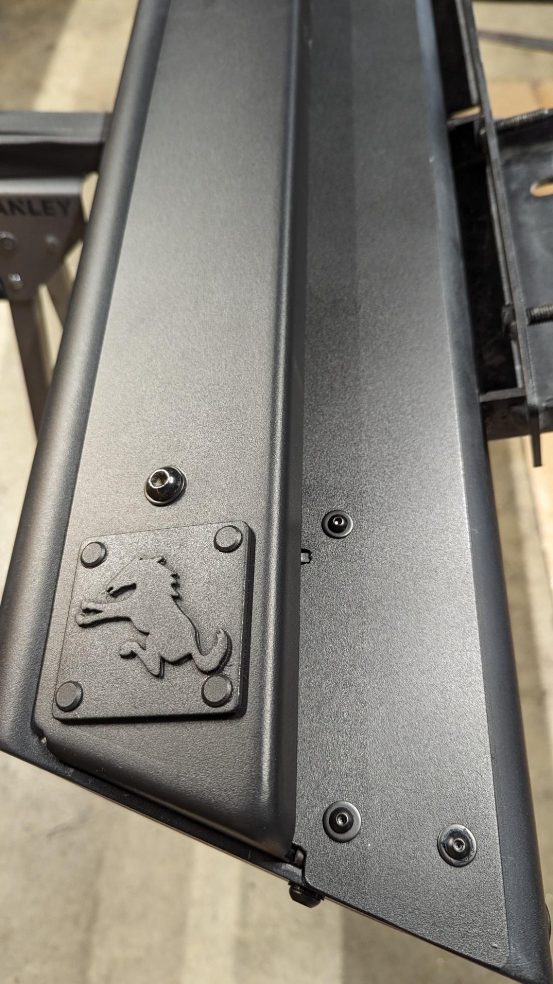

I covered the TOR logos with the Bronco badges. I made them using two keychains I had bought on Amazon. I'm sorry, TOR, – your cutout logo looked good, but the tires liked to play cornhole game with it. I can only wonder how much more ballast these rock sliders would have collected if my Bronco didn't have mudflaps.
Ford Bronco Turn Off-road sliders - reviews / feedback? 1708931771994
Ford Bronco Turn Off-road sliders - reviews / feedback? 1708930851930
Ford Bronco Turn Off-road sliders - reviews / feedback? 1708932537356

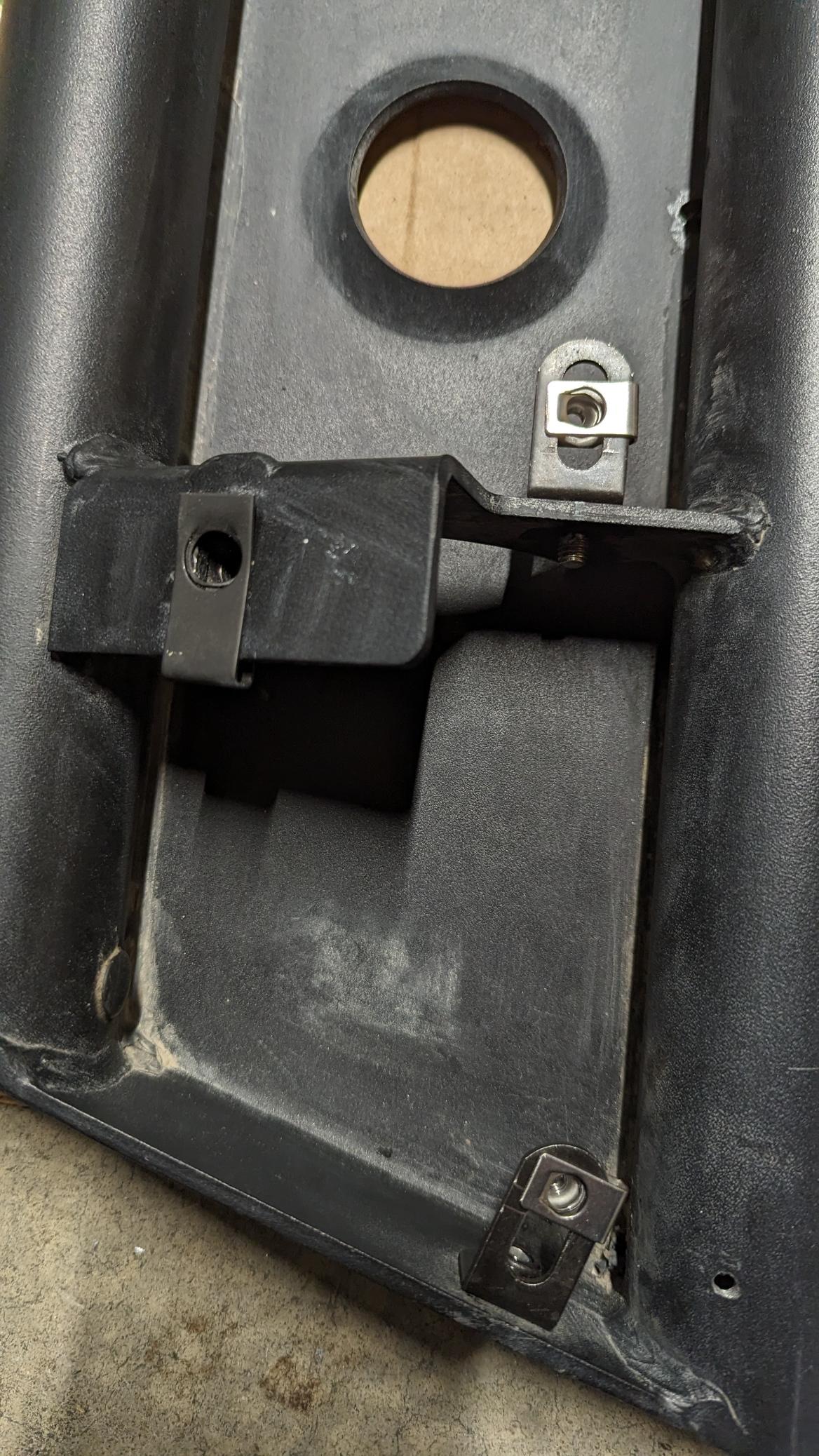

I replaced the regular nuts with U-nuts. They will make the unscrewing process much easier in case I want to inspect the internals.
Ford Bronco Turn Off-road sliders - reviews / feedback? 1708930763259
Even though the covers were not going to be much visible after the rock sliders have been installed, I was glad that the Rust-Oleum paint's texture turned out to be very close to the texture on the rock sliders.
Ford Bronco Turn Off-road sliders - reviews / feedback? 1708930800617
Ford Bronco Turn Off-road sliders - reviews / feedback? 1708930824766
Before this project, I had almost zero experience in metalworking, so it was quite a challenge for me, but can say that I'm pretty happy with the final result.

It's been almost 4 months since I installed the TOR rock sliders on my 2 door, and here are my thoughts about them.
I love how they look, the built quality, and how beefy they are. There are some things that I think @Turn Offroad might improve though. One of them is the coating – it scratches pretty easily by the small rocks and sand that gets stuck in the shoes. I had GoRhino side steps on my Bronco before swapping them out for the TOR sliders, and the coating on those steps was more scratch resistant.
There's one design flaw that I'd like to focus on specifically. These rock sliders are prone to collect sand, rocks, and water inside of them due to the semi-open structure. The cutout logo in the step surface also adds its share of dirt to this problem.
