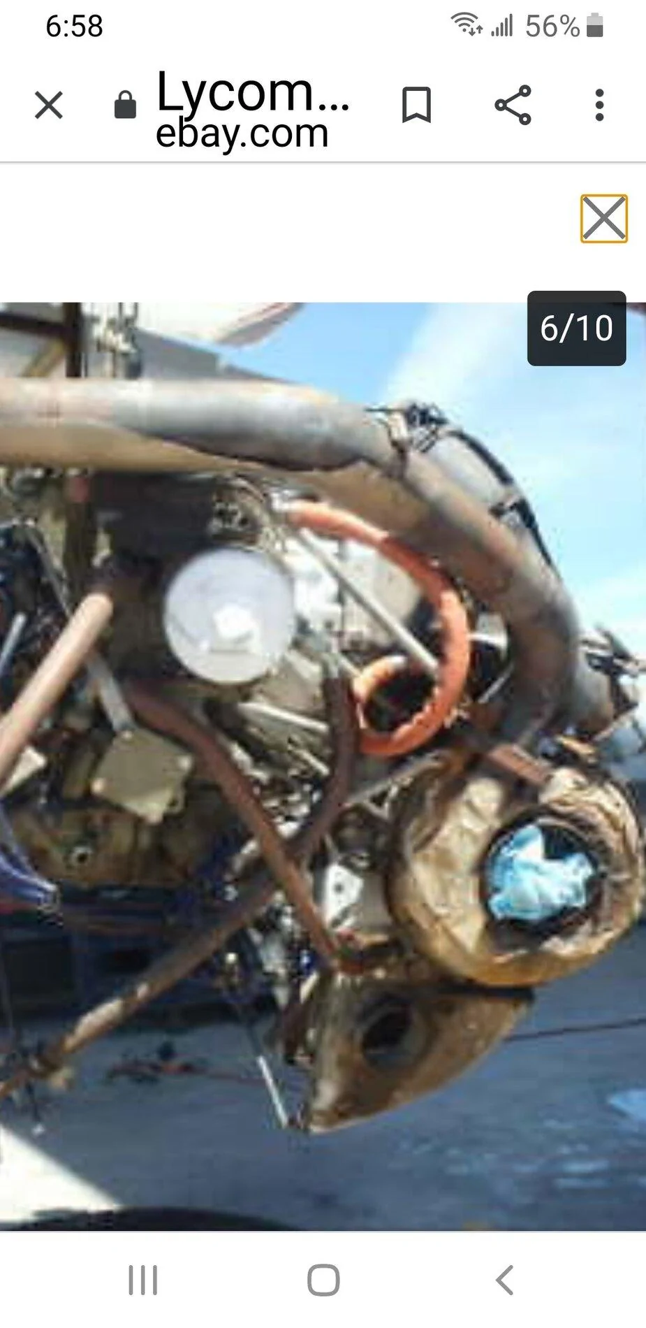

High perf aircraft engine TIO-540 It uses a blanket perhaps high airflow keeps it from coking,also it may be there to protect the other components from heat.
