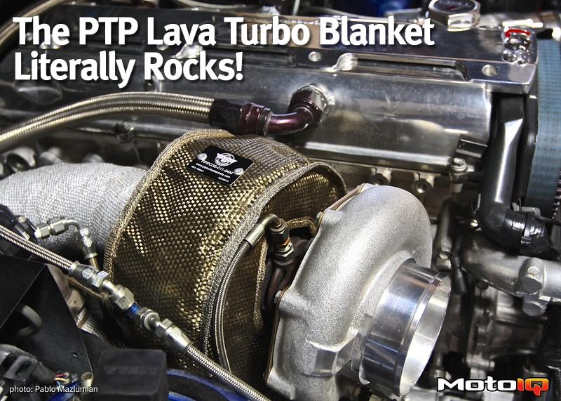

A quick and simple explanation that I found (it also explains it better than I could):
Turbochargers work on the basis of heat energy and keeping the turbo as hot as possible. By containing as much heat as possible within the turbine housing, the turbo is able to spool up quicker, run more efficiently, and produce a faster response along with more power faster. However, as turbocharger temperatures increase, so does the temperature of everything surrounding the turbo such as wires, hoses, intercoolers, radiators, and oil pans. As a result, this could lead to surrounding components to deteriorate, corrode, and run inefficiently.
I have had a PTP Lava blanket on my Sti for about 6 years now with no issues. I mainly got it because my car has a top mounted intercooler and I wanted to reduce the under hood heat some.
Quick video explanation.
