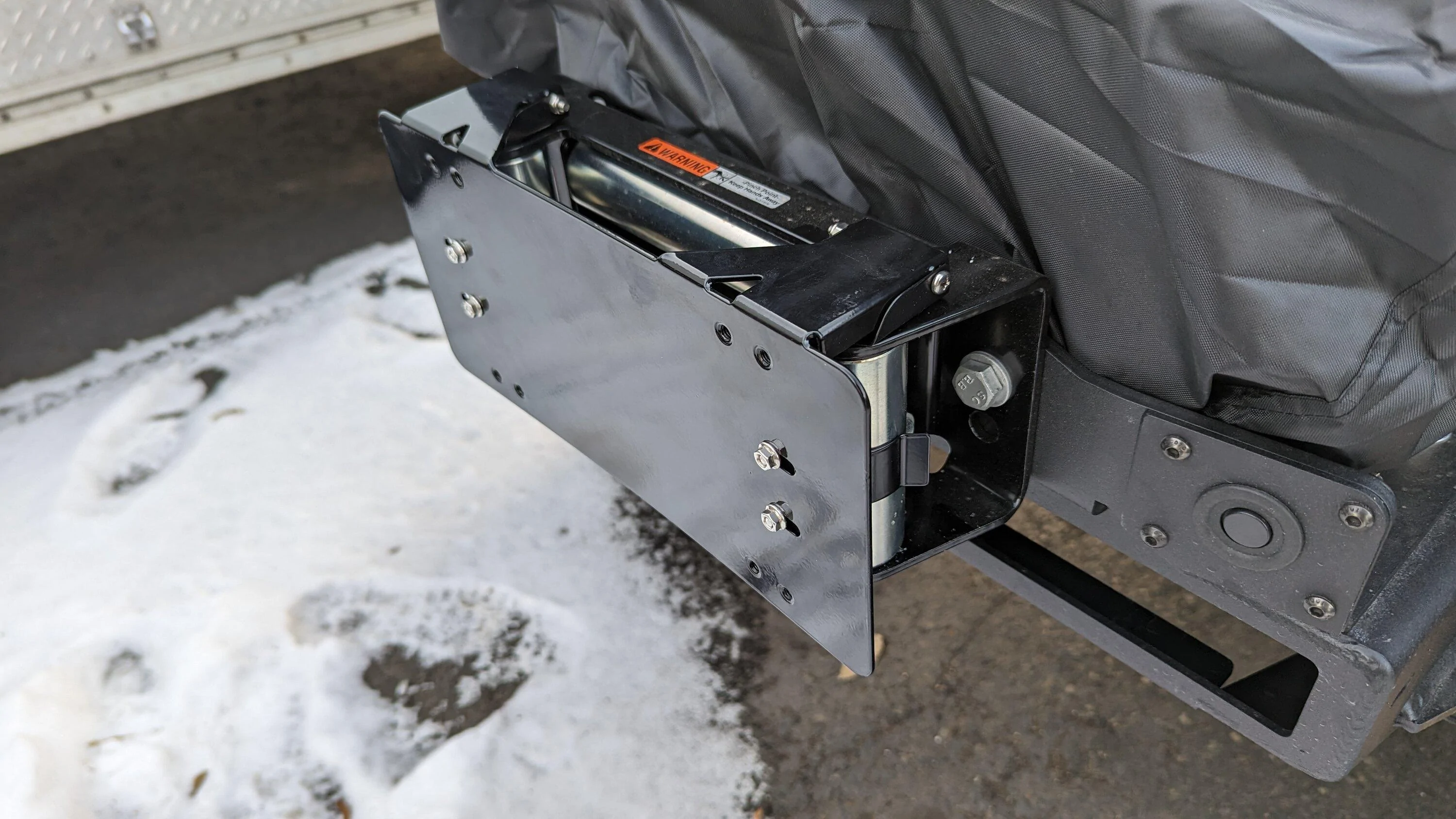

Finally got the from camera pulled today and put the grill back then locked down the winch. Waiting on a camera extension and wire loom to come in then I'll get the wires all hooked up.
Found this $10 winch cover and threw it on. Nothing special but it'll keep some weather off it.

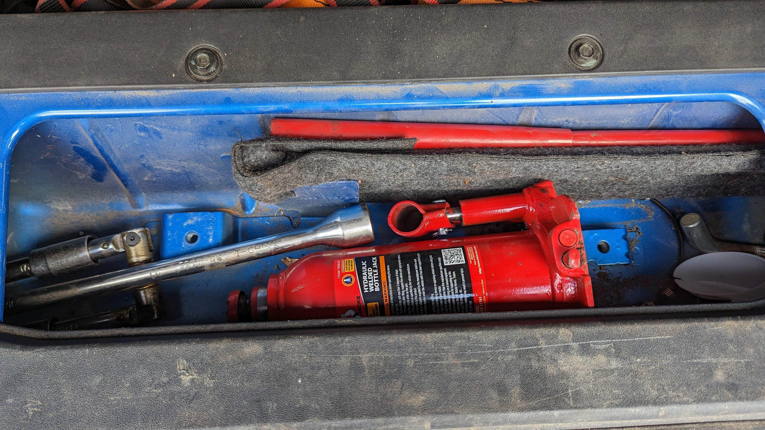

Base wheels on and scissor jack deleted.
So you put in a bottle jack, yet your spare tire doesn't appear to match your other 4 tires.
Seems like one is useless without the other.

I'm trying to find something the same size that isn't directional and I don't think anything exists.

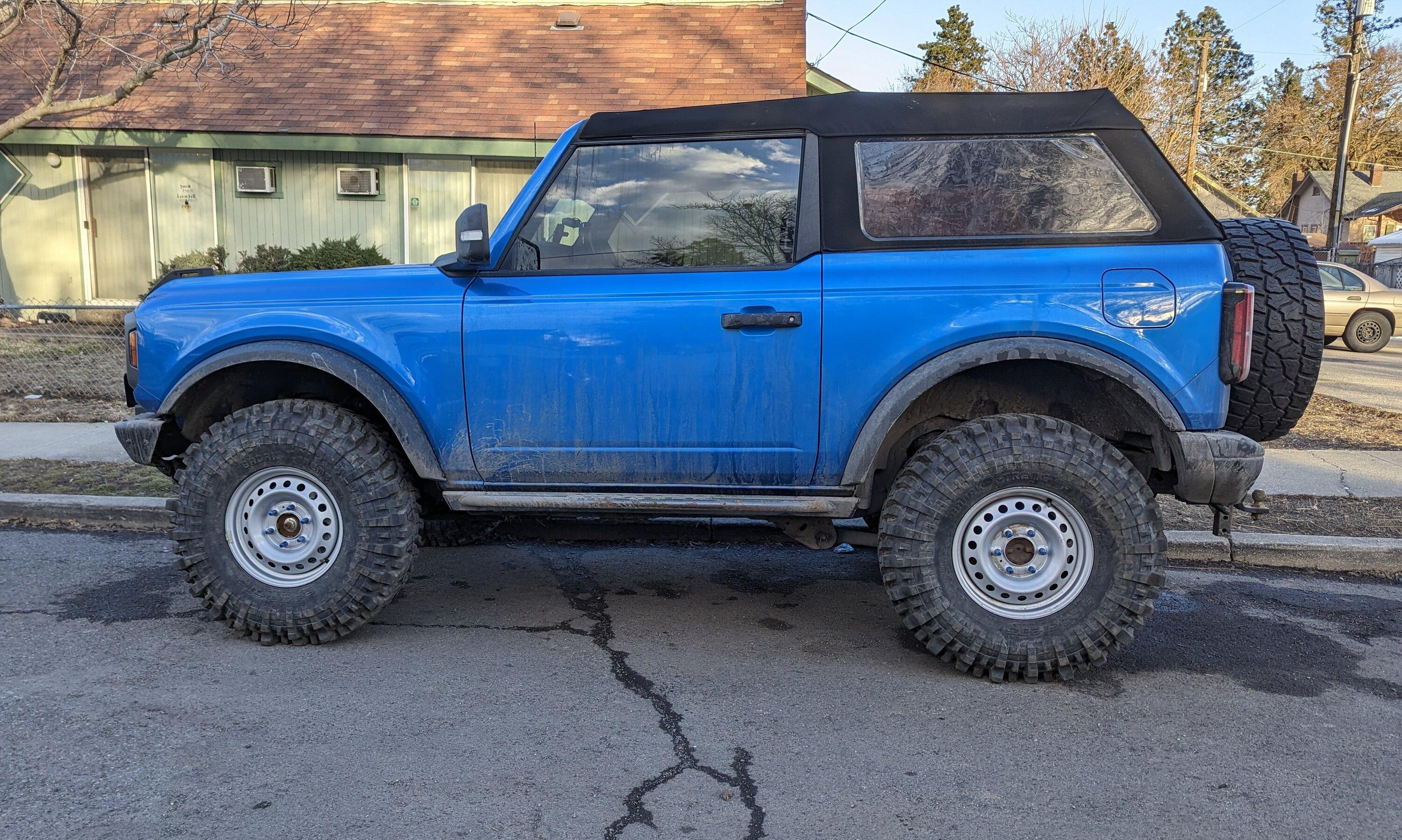

it looks like you have a significant amount of rake? Am I seeing that right.

IDK why it looks like that, camera angle I guess. This pic is of the same lift a few days earlier.
