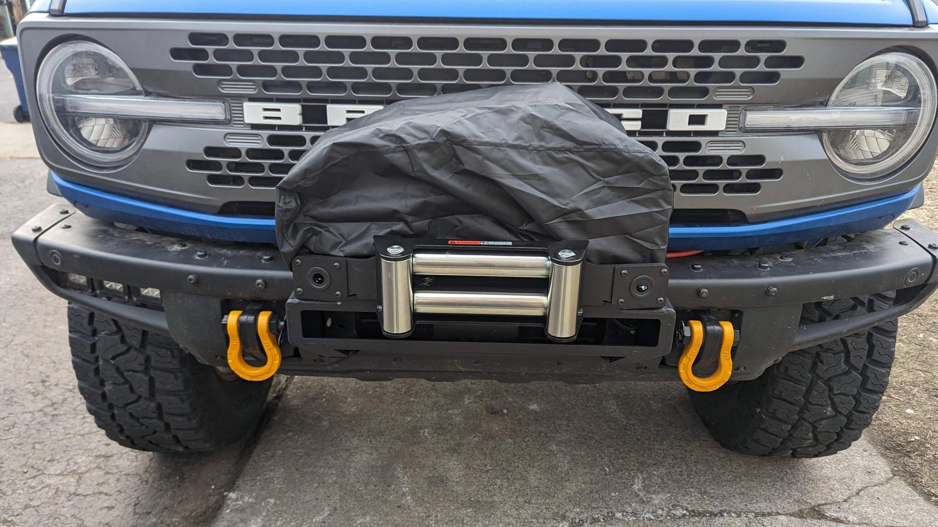

Finally got the from camera pulled today and put the grill back then locked down the winch. Waiting on a camera extension and wire loom to come in then I'll get the wires all hooked up.
Found this $10 winch cover and threw it on. Nothing special but it'll keep some weather off it.
I learned something about beadlocks today. The reason I went through hell getting them torqued was I never got metal to metal contact. These tire beads are too thick. The answer is ring spacers, which of course are custom.
Did some figuring, plotted them out in CAD (which I'm really getting the hang of) and submitted the file to the manufacturer I've been working with on other brackets.
Trying some 1/8" thick for $300, hopefully that's enough because the step up to 3/16" is $400.

I have seen people use washers and some weird u-clips from McMaster Car.
