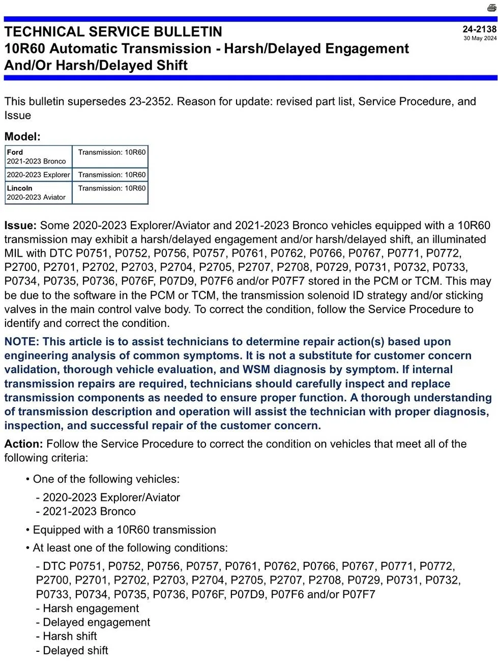

I’ve got a ‘23 Badsquatch with 4,500 miles that started having these same shifting issues being discussed here. Dealer performed the 24-2138 TSB, but it did not correct the problem, so they replaced the valve body. Was told I need to drive it for “a few drive cycles,” basically 400-500 miles until the transmission relearns itself. I’ve only driven about 200 miles since the service, but I’m still experiencing the transmission acting up with hard downshift, cold start reverse, and since I got it back, there’s now a delay shifting from 3rd to 4th gear. We’ll see what this relearning may do over the next 300 miles or so, but I’m not convinced it will all be corrected. I’ll report back.
Update: It’s been close to 700 miles and I’m still experiencing the harsh down shifts and initial harsh shift into reverse as well as some new issues like when dropping a gear at highway speed to pass it downshifts but then downshifts again to an even lower gear and completely retards the truck from accelerating because it’s basically at computer limited redline, which on the highway is incredibly dangerous. It’s happened to me twice. Looking to get it back into the dealer after the holiday. Anyone else experience something similar?
LATEST UPDATE: Dealer replaced the transmission valve body for a second time within 800 miles of driving on the first replacement. I’m not convinced it’s fixed because they told me that the second valve body didn’t fix all the issues, so they were going to have the shop foreman evaluate it before replacing the entire transmission. Miraculously, the foreman is now saying that the valve body did in fact correct all the issues. I don’t have the truck back, yet but I guarantee it’s still not right. I’ll post an update once I get it back.

After a cold soak, the transmission fluid can drain out of the torque converter.
When this happens, the first engagement when cold can be slightly delayed and can also feel like it's in neutral, until it has time to fill the converter again.
There is no repair for this, Ford considers this a normal characteristic of the transmission. Some seem worse than others which may be attributed to debris in the valve body or potentially other things.
Either way, I would just bring it to your dealer and have them try and duplicate it. There is a very common TSB for various 10 speed shifting concerns that they should perform that may help with the issue.
The SSM I listed earlier in this thread has been replaced and this is now the latest TSB:
Is this still the latest info? Going to the dealer for another install and want to bring up this issue
