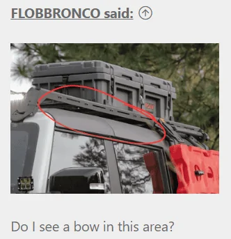

Do I see a bow in this area?
No. This will be a very strong section that has no movement, we designed it to make sure it had no flex or play at all (it is unacceptable for a rack to flex, to us). This “cut out” area is for the removal of your MIC panels giving you the option to remove them and enjoy some open air.

Can you guys load the rack and put a level on top and see? Looks like is flexing to me.

We will have Fronco do that. The rack is very solid. Not sure where you are seeing it flex. It could be the angle of the camera at which the picture was taken.

I'll take care of this later today! From my experience so far, there's generally no flex and I believe the "bow" is optical illusion from the roof lines, but I'll provide some video to clear things up.

TrailRax "TRMRR" Bow/Flex Test:
So a few folks have asked about the rack's rigidity, flex and bow, both under load and without any weight on it. I'm hoping the following photos and videos provide valuable, real-world experience so you can see for yourself how solid it's built.
tl;dr - There's no bow, unless you're concentrating weight of 300+ lbs in the unsupported center of the aluminum beam. And there's very little flex under load except for that which, IMO, can be expected when loading considerable weight onto any roof rack. Nothing is going to be flex-free. Read on....
First question to address is whether there is a bow in the natural, unloaded state. Here's the question:
Ford Bronco TrailRax Modular Roof Rack Development & Details 1654376938428
The answer is NO, and as far as I can tell, this is an optical illusion from the curvature of the roof and the cutout section. Also, just for clarity, I'll note that there was nothing in the Roam box in this photo, so we're talking just 25lbs... effectively no load. See below:

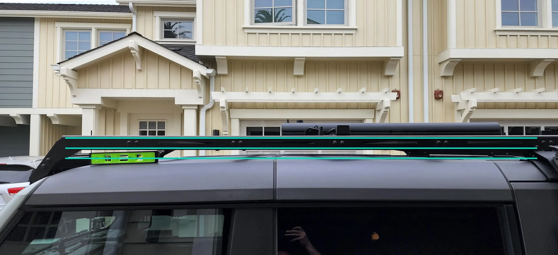

From this angle, it's easy to see that the roof is curved, with the highest point right where the front row of panels and the back row of panels meet. (Zoom to see the level indicating the slope at the front.)
Ford Bronco TrailRax Modular Roof Rack Development & Details Rack-no-Lines
But in case you're still skeptical of what your eyes are telling your brain, I overlayed some parallel, evenly spaced lines on top of this image to prove the rack is perfectly straight on top and bottom.
Ford Bronco TrailRax Modular Roof Rack Development & Details Rack-with-Lines

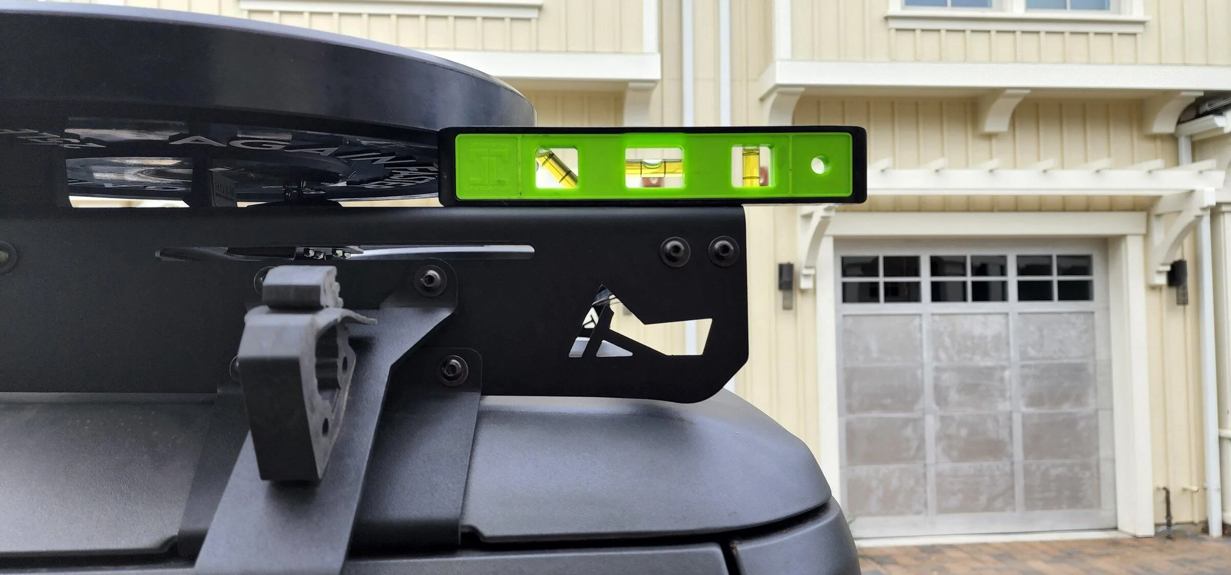

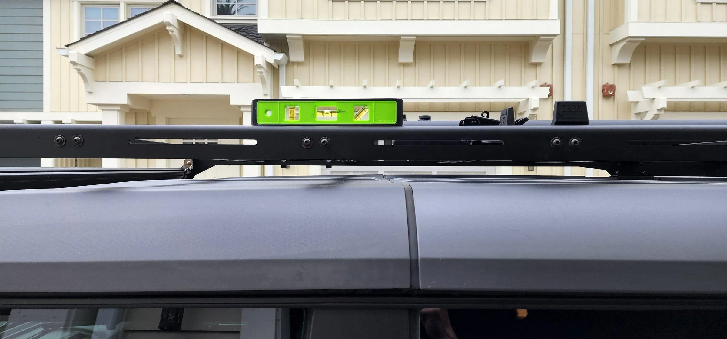

Validating this with a level, you'll see the rack is sitting level in the front row and level in the rear row, too.
Ford Bronco TrailRax Modular Roof Rack Development & Details Level-front-row-no-load
Ford Bronco TrailRax Modular Roof Rack Development & Details Level-rear-row-no-load
So for this first question "is there a bow", I think the myth should be considered BUSTED. There's no bow in the rack when mounted and with no load.

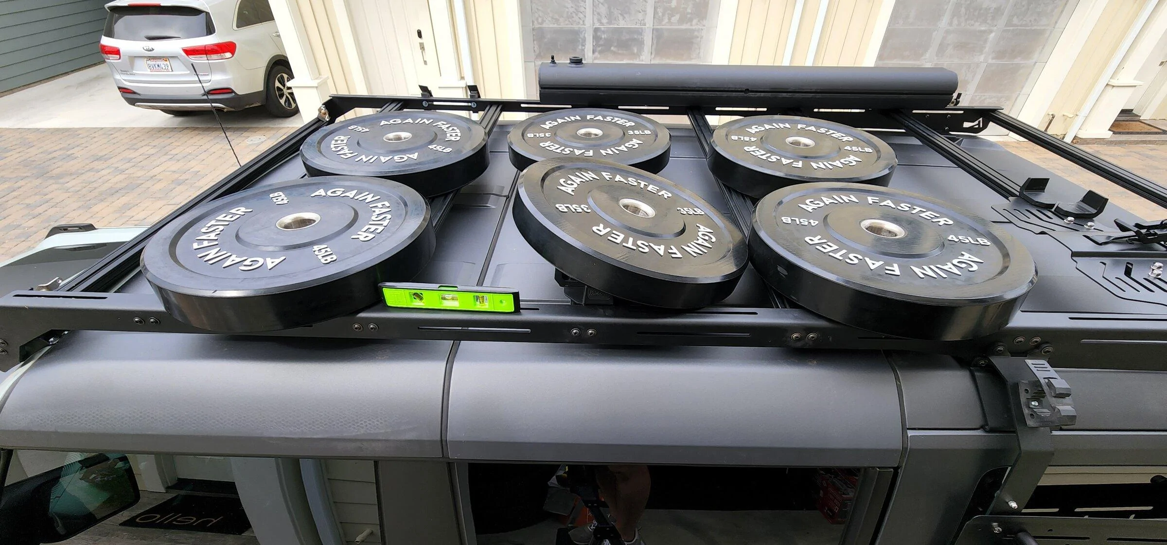

But what about UNDER LOAD, right? I've got some findings there, as well. I did two tests, first with a distribution of 250lbs, then one with 350lb.
250lb maintained its level posture, no problem (zoom to see level, try not to fall for the optical illusion of the curved roof, again):
Ford Bronco TrailRax Modular Roof Rack Development & Details 250lb Test - Level
I also gave it a good bang with my hand to test how much vibration and play there was. It seemed perfectly reasonable to me in how it absorbed the impact. Watch the plates to see the amount of motion, because if you're looking at the rails you'll probably not even notice anything.
250lb Smack Test:

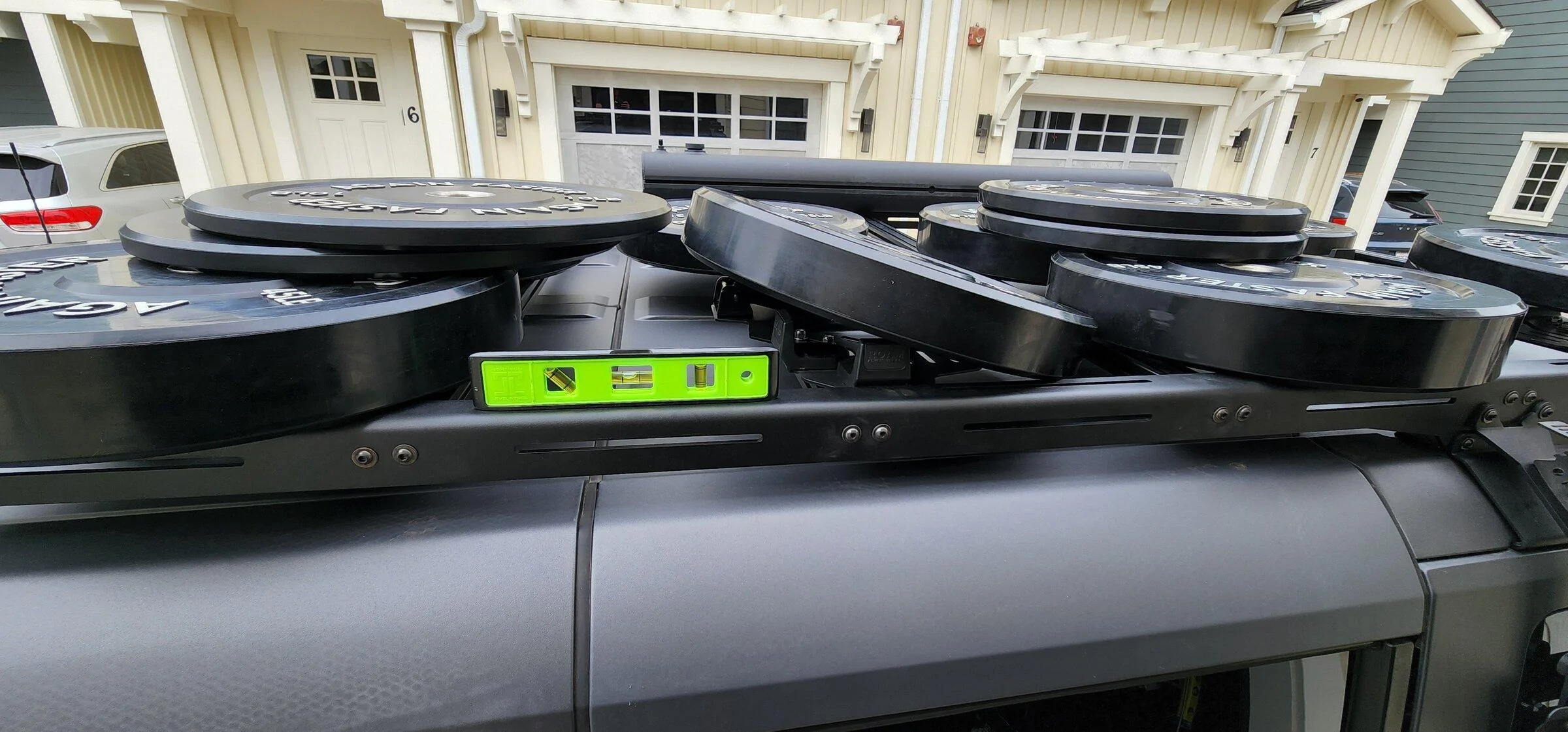

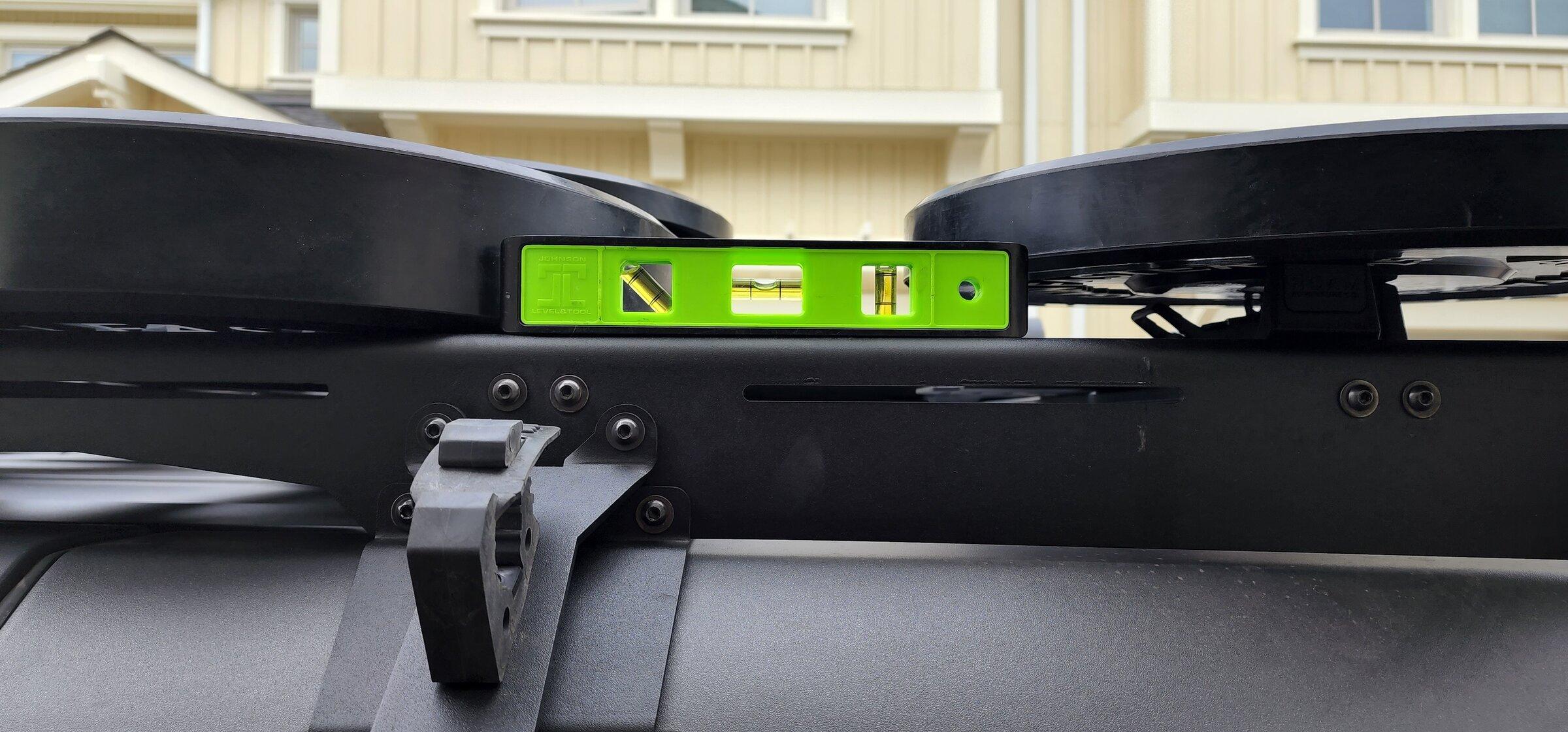

Next I upped the weight another hundred pounds, and finally saw a little bit of flex in the rails. At 350lb, here we were:
Ford Bronco TrailRax Modular Roof Rack Development & Details 350lb-test-slight-flex
Considering the weight and the amount of space that these rails cover from the front mount point to the rear, I'd say you couldn't expect more from an aluminum rack, and it's very impressive to me.

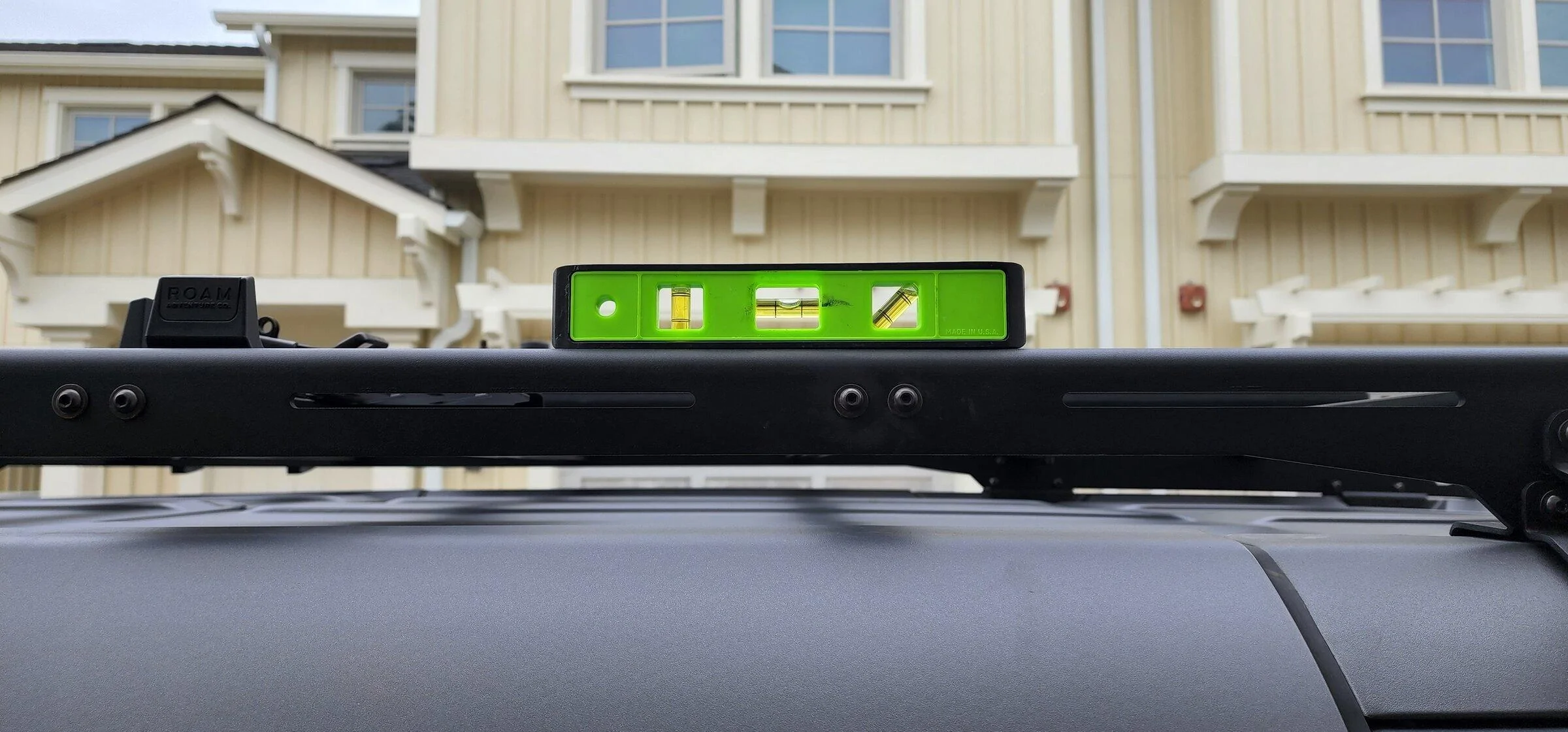

I'll also note that the rear of the rack had no flex whatsoever, event at 350lbs... definitely something to keep in mind when distributing your weight across it:
Ford Bronco TrailRax Modular Roof Rack Development & Details Level-Rear-load
Ford Bronco TrailRax Modular Roof Rack Development & Details Level-Rearmost-load
