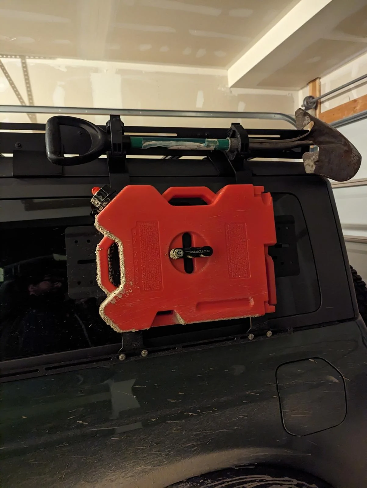

Other folks have already mentioned this, but the various "grip" shovel/paddle holders can work nicely above other things mounted on the side pax rax. There are holes drilled on the vertical side bars just above the bend that provide a rather perfect place to mount a shovel/etc holder.
I went with the Yakima TopGrip ones, but that's just because I wanted something that could lock and I already had other Yakima gear and extra lock cores, so the single key thing is a plus for me. Otherwise, there are cheaper options that would work just as well.

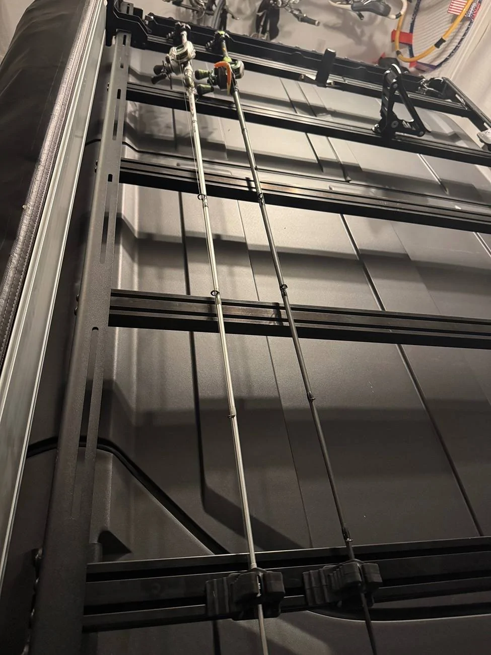

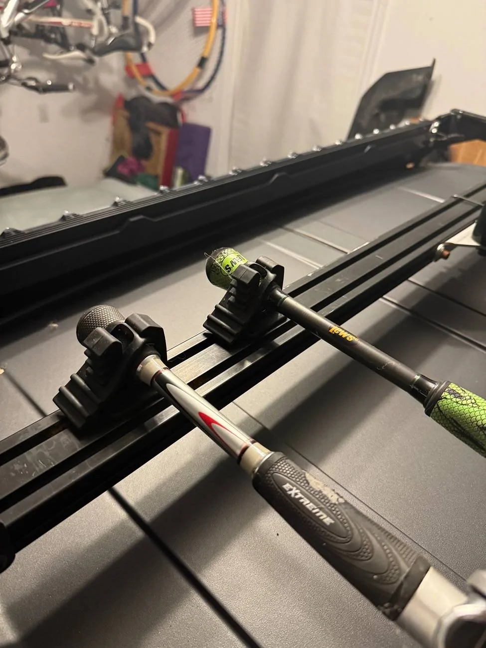

Also bought a couple sets of the small quick fists to mount fishing rods on top. Holes line up perfect with the tracks.
https://www.amazon.com/gp/aw/d/B006NOC8Q6?psc=1&ref=ppx_pop_mob_b_asin_title
Was really hoping to mount them underneath the rack, but not enough room between roof and bottom of rack for baitcaster triggers.

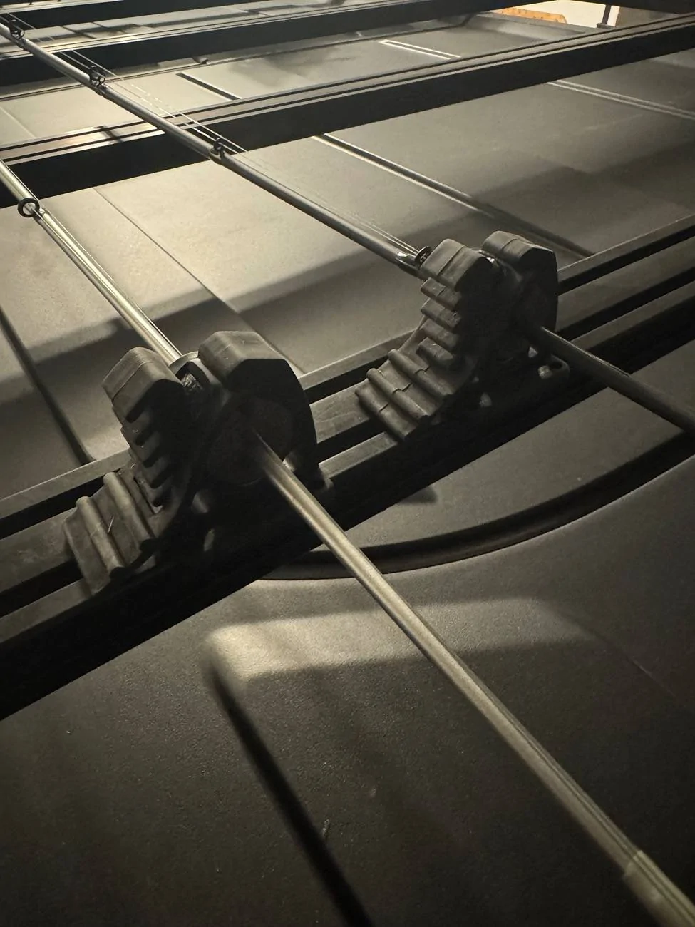

Added a little condensation pipe wrap to the ends to take up space.
Even-though the four holes of the quickfist line up with the tracks, I went with the single center hole and added a stainless washer so there was more meat to hold. The 4 holes are pretty thin rubber. Don’t want to risk my poles going flying down the highway.
