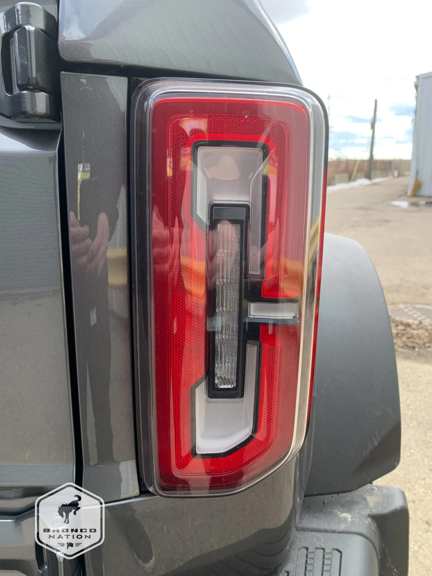

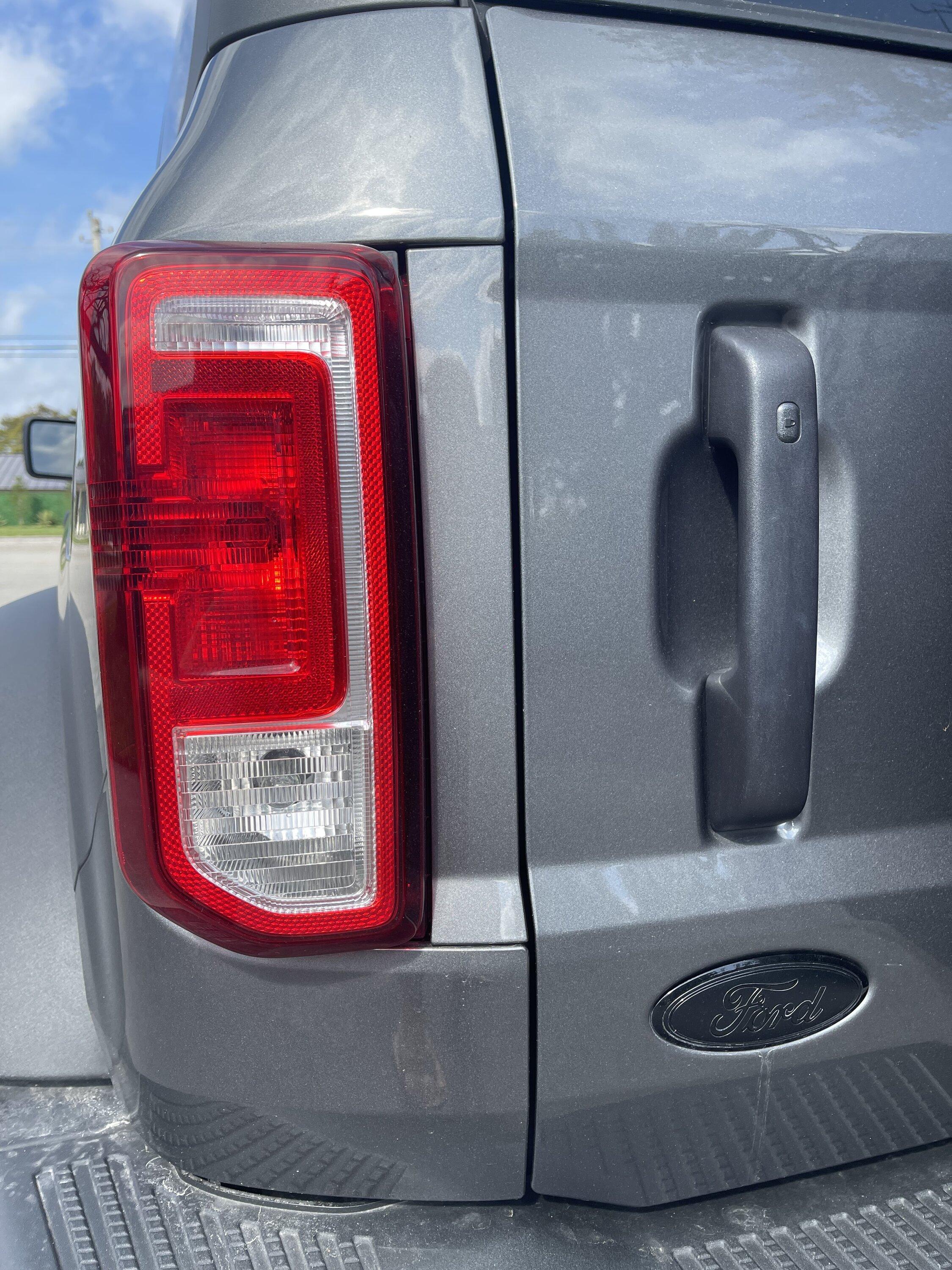

Looking at your picture with your Bronco, I think the issue is you want the kit that is for non LED taillights as that portion is directed towards what taillights you have on your Bronco (not the trailer).
Bronco tailights non LED:
Ford Bronco Trailer Wiring Harness Kit Recommendations Needed img_1930-jpe
Bronco with LED:
Ford Bronco Trailer Wiring Harness Kit Recommendations Needed tl-comp-2-jpg-jpg
This is the kit you should go with (assuming you want to stick with the same company)
Bronco with LED:
https://www.nilight.com/products/4-...-2021-2024-ford-bronco-without-led-taillights
That's it exactly. I didn't notice the Bronco has the halogen tails, but it does.
Bronco with LED:
Thanks for that, I thought that it referred to the trailer not the vehicle end. I'll go swap them out.
