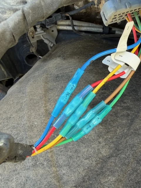

This is my suspicion, water is running down these wires, and making its way into the harness somehow, maybe the dealer didn't secure it properly or one of those crimps is loose.

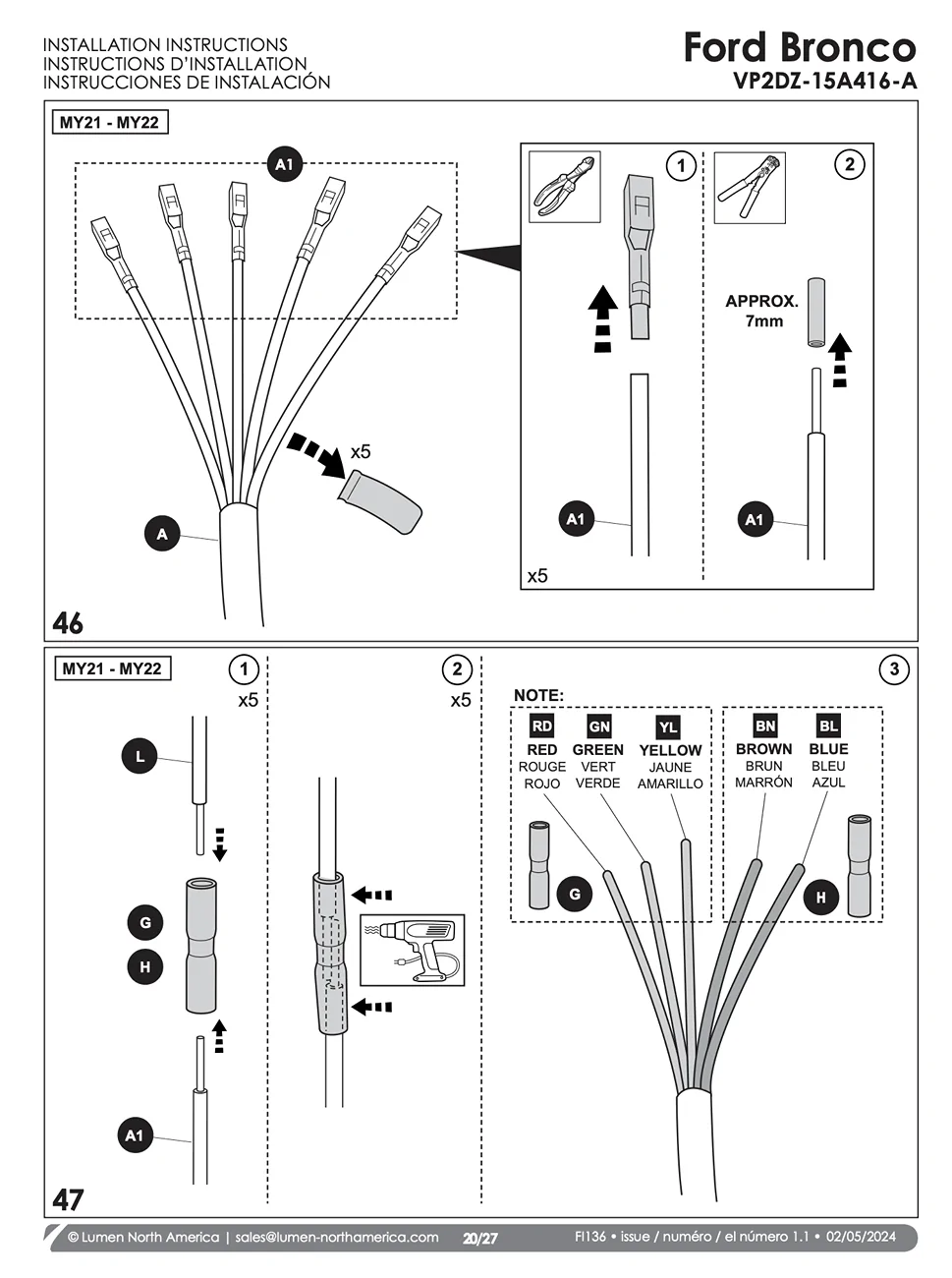

I installed this kit on my 21, very easy to get something wrong, in fact I found a huge discrepancy in the directions and if you don't check your work, you will have to re do it. Pull the left front wheel, pull the fender liner, and see how the harness plugs look and check for loose or bare wires.

Well, except for when its wet, everything functions pretty perfectly, so I'm just going to check every wire along the path, only real explanation. I agree its probably up front where the crimping and repinning happened, but I think just for good measure I'll make sure that ground at the back is good too.

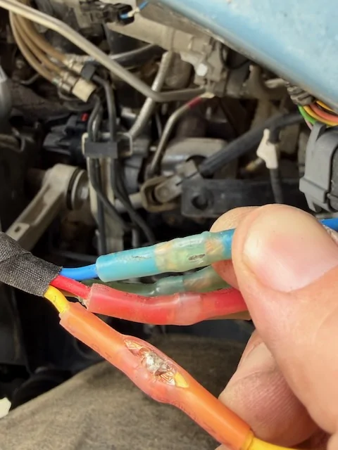

@Tonka Bronka : you were spot on. found my issue on the crimps.
all better now:
That's fantastic! Good job! Those look like solder and seal connectors. I have tried them with the same results, the plastic can melt before the solder does. I don't even try them any more.

Yeah I had the same result, I stopped using them. Maybe the knockoff versions are the issue? Hard to tell. Standard crimp and seal was fine for me. I did secure these down and wrap them in proper tape as well.
