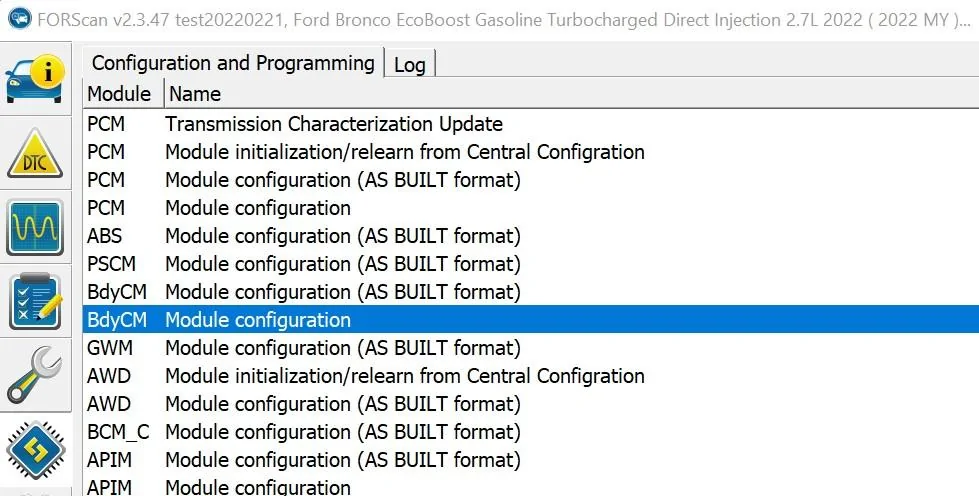

For those of you looking to lower your tire pressures and update the TPMS settings to reflect your new base pressure the following changes may be made with ForScan (verified on my 2022 base).
BdyCM
Front: 726-10-01 - XXXX-XXXX-** (where ** is desired pressure converted to HEX)
Rear: 726-10-02 - **XX-XXXX-XX (where ** is desired pressure converted to HEX)
I have updated mine to a base pressure of 35 psi and now see a warning when pressures are reduced to about 30 psi
BdyCM
Curious why you opted for updating HEX values vs just making the change on the BdyCM configurable module itself?

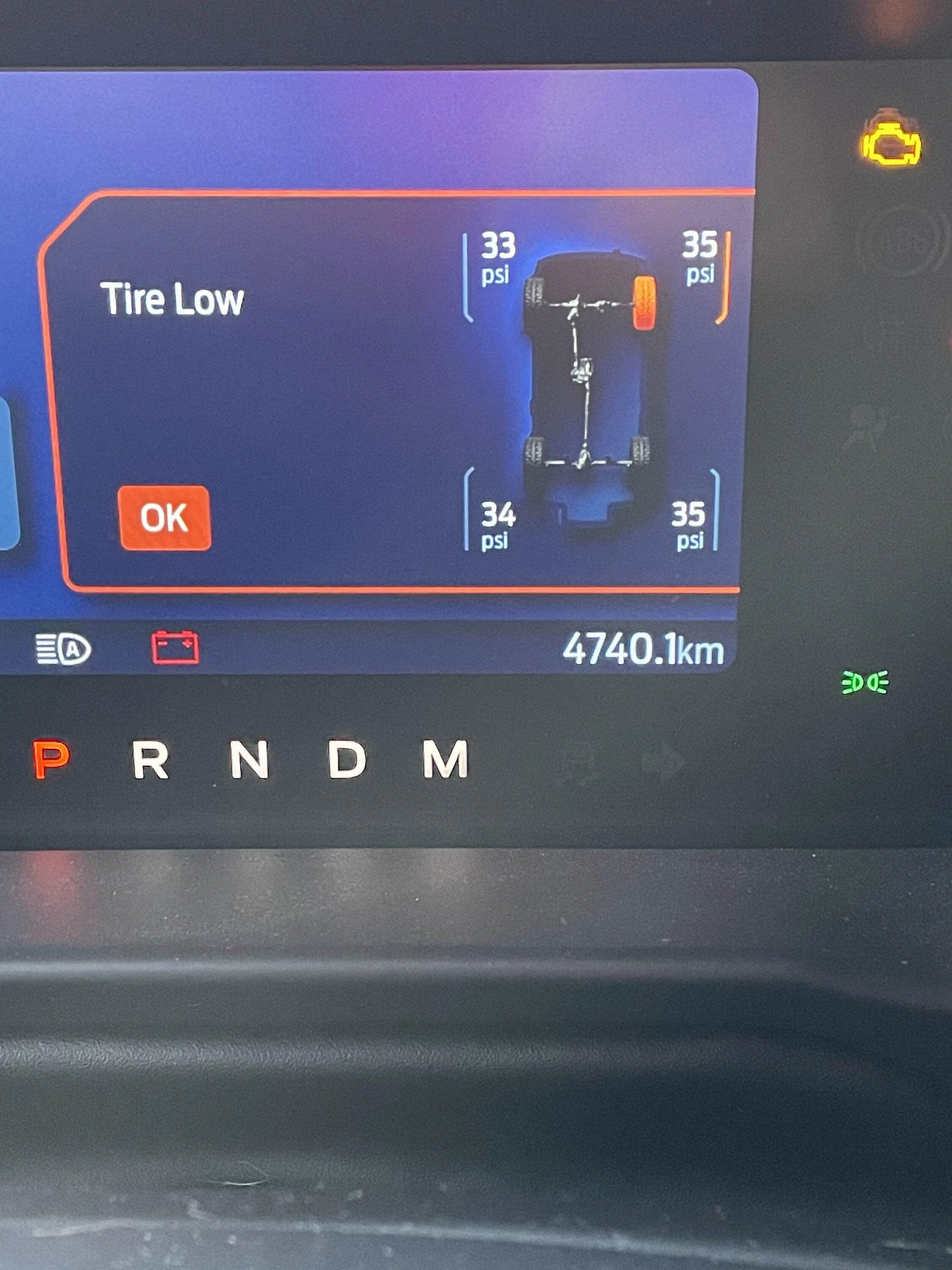

i have a 2022 wildtrak/sasq, all tires are 35 pressure but right tire sensor orange still.
Even when the pressure is off by like 4, it creates an alert.
Wtf ? Faulty sensor for front right ?

Hey, I disabled mine the same way in forscan. Disabled since I didnt have time to take my old wheelset to a shop before setting up and testing the new ones. I left it disabled for about 10 months and just did a teardown during my tire rotation to put TPMS back in and re-enable. After enabling, I got nothing... just a TPMS fault and no values for any tire. Install was easy, not sure what I could have messed up. Maybe I missed another step in forscan
Any thoughts?
