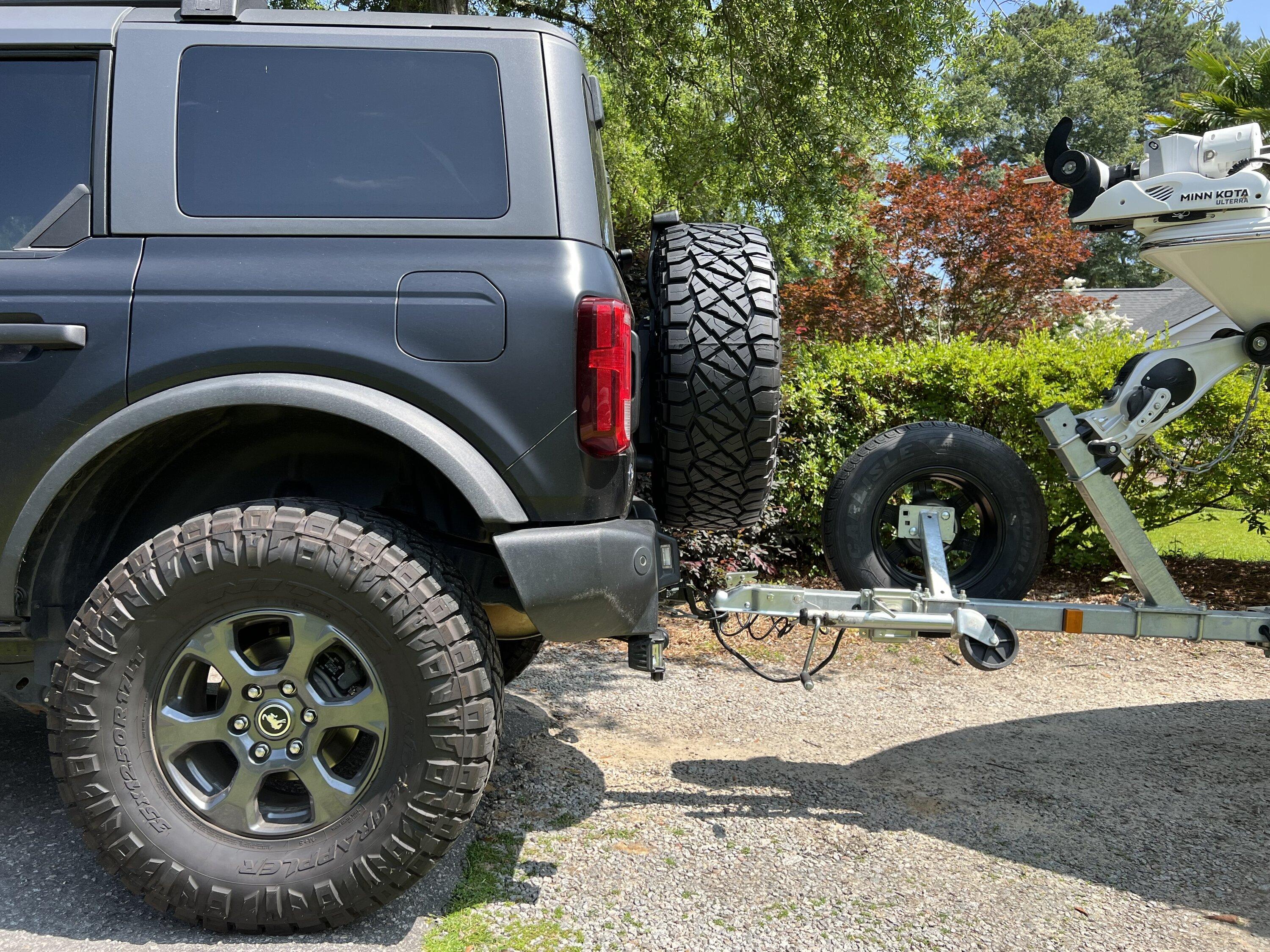

Is this still with the stock height? I towed my little teardrop trailer last weekend, and the trailer was looking up on a 2-inch drop. I wonder what's the formula to get the right drop.
3.5” leveling kit and 35”s
The trailer sits pretty level, I have a 3” drop currently but it’s just really close to the tire. The coupling on the trailer barely fits on the ball because of the 35” spare. I may go to a 4” but now that I have the boat it’s not as bad as I thought. 6” would be too low I think.

Also factor in any cargo in the back of your Bronco that may squat it. If it's loaded kinda heavy, The trailer tongue weight combined may overload your rear suspension. Good luck!

Thanks!
I think it’s sitting pretty good right now

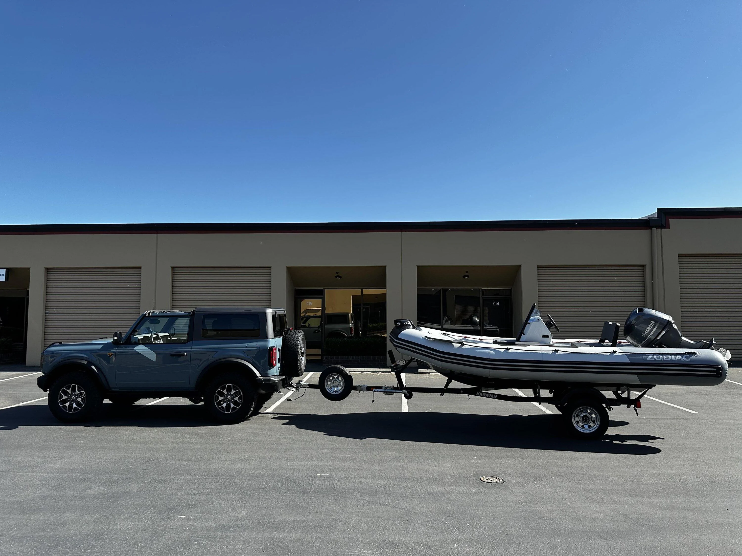

I recently towed my boat 100 miles, approx. 2000lbs and no issues.
