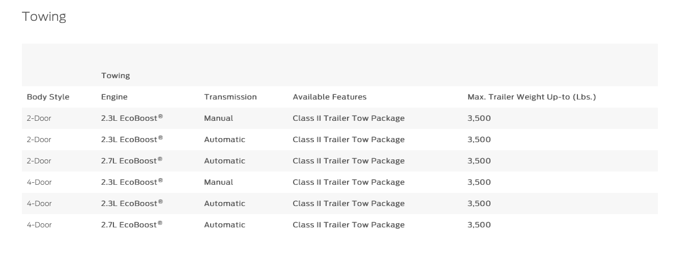

A vehicle’s tow rating depends on the manufacturer’s. GCWR. The hitch rating is only for the hardware. It is a maximum for a class. The actual tow rating for the vehicle can be a lot less.
Correct and I’m very much aware of towing numbers. The sport has a max GCWR of 6,260lbs. I was just curious as to why Uhaul spit out a class 3 for the sport in that poster’s example.

I just took mine off my order. Figured there's no point if the hitch is only rated for 3500lbs. I don't know if they will up the rating to a class3 or 5000lbs... But if they do I just wasted 600 to have to change it out again anyways... So I'll just wait a bit and see. Besides I'll get ford to install one at some point depending on what trailer I eventually buy, so that'll look after the whole package and wiring that may have been included originally.
I was under the (wrong??) impression that it is a class III . . . ?
