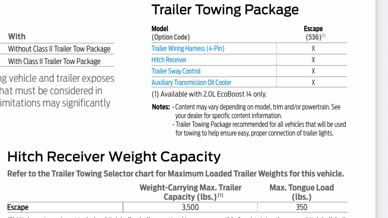

This is for reference only &
I doubt the Bronco ClassII is rated for 500lbs tongue weight. General guideline for hitches is 10% of max tow capacity, so 350lbs max. And the crossmember the Bronco hitch connects to doesn't look stout enough to deal with more than 350lbs tongue weight when you're bouncing the trailer on rough roads.
That is correct! This is for reference only & is for the Ford Escape. The Ford Edge is has the same rating.
