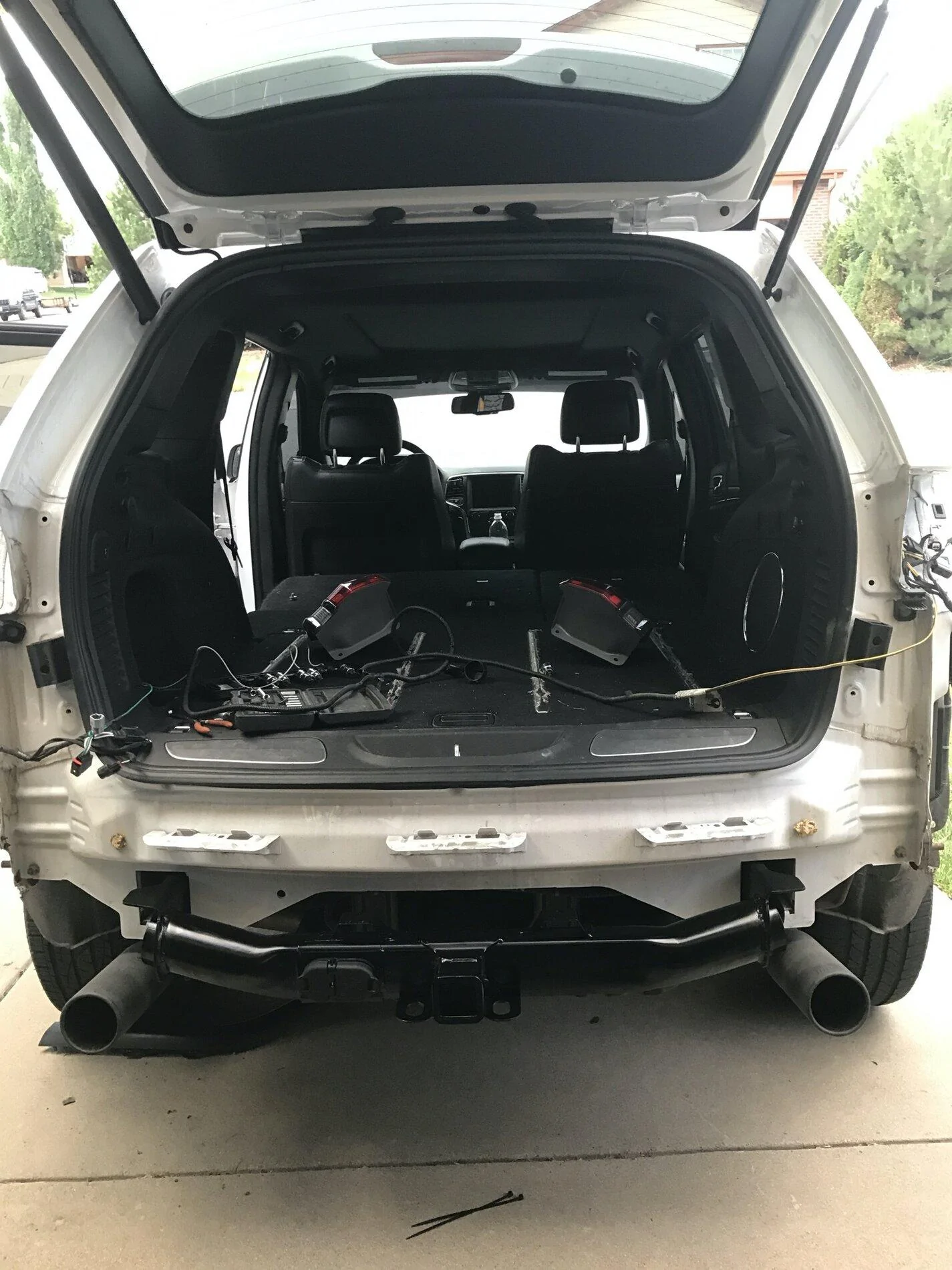

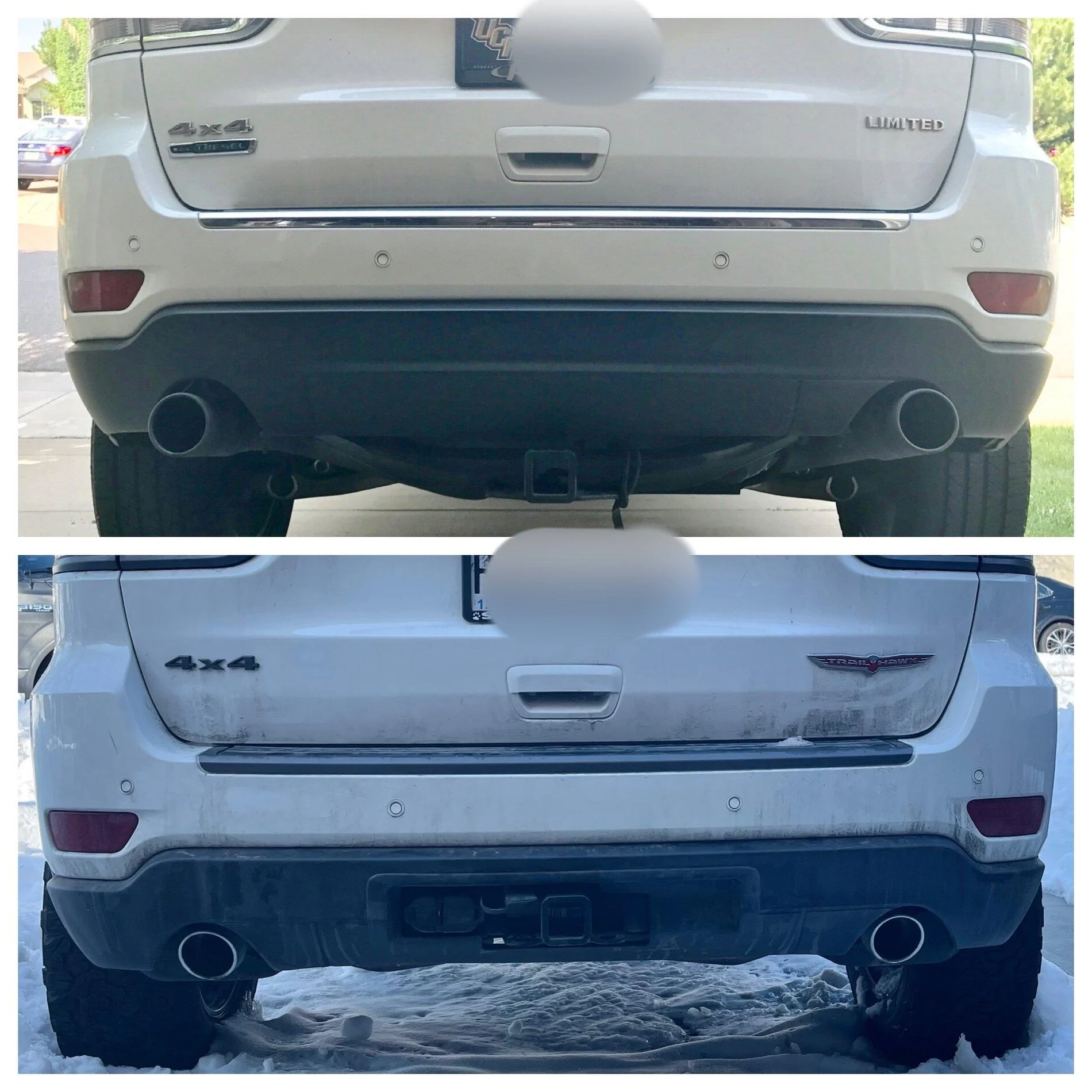

This is my fear with aftermarket. Top half of pic 1 shows a uhaul receiver on our old ‘15 GC and bottom half of pic 1 shows the factory receiver on our ‘18 GC. Will an aftermarket receiver reduce the departure angle?
Pic 2 - I ended up replacing the uhaul receiver with a factory one prior to trading in for the trailhawk.

I was really on the fence about it though and it does burn me to spend $600 for a receiver/t-connector... if the thing was on the street and I had more intel on how an aftermarket hitch fits I would have been very open to changing it.
Right, I guess that's our dilemma. No one yet has a Bronco, so no one yet knows if installing an aftermarket hitch (or even the OEM hitch) is a simple plug-and-play operation. Too many unknowns I suppose to make this an educated decision.
The price of early adoption. But yes I will be cheesed after paying $600 and finding out down the road that I could have done the exact same thing for $250 and 30 minutes of my time. I hate paying manufacturers for the obvious "profit boosters."
