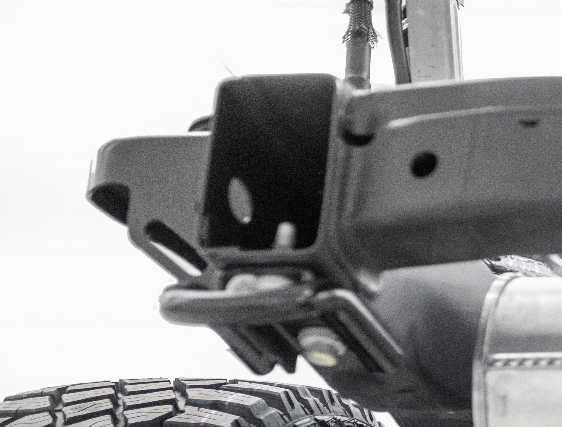

I would ask the winch manufacturer, but class II , 3500lb capacity receiver is maybe a bit light for even a 5k lb. winch. Adding a snatch block to pull the big Bronco would definitely stress the capacity.
Ford rates the hitch as a recovery point so there’s that.
It also rated at 3500 lbs and 300 lbs (or less) tongue weight. Add 80lbs of winch and it seems like a pretty weak winch mount point. I may be way off, but maybe there is a guideline somewhere. I have seen class II hitches bend from just excessive tongue weight (motorcycle rack, add a long lever , plus the weight of the motorcycle).
I really don't think the weak point is the hitch but the suspension due to being setup for Offroad.
it’s a class II ‘rated’ hitch because it’s limited to 3500lb but unlike a normal class II it has a 2” receiver instead of the 1 1/2“ normally found on a class II hitch. Remember recovery would be a line pull on the hitch which is different loading than tongue weight loading. Besides, I don’t think Ford would rate it as a recovery point if it couldn’t handle pulling the entire weight of the Bronco.
It's a 2" receiver so it's a class III hitch. There's a lot more that goes into a vehicles tow rating than the hitch strength. A class III will take up to 8000lbs towing weight. I'd venture an occasional recovery from it would be fine at 10k.
