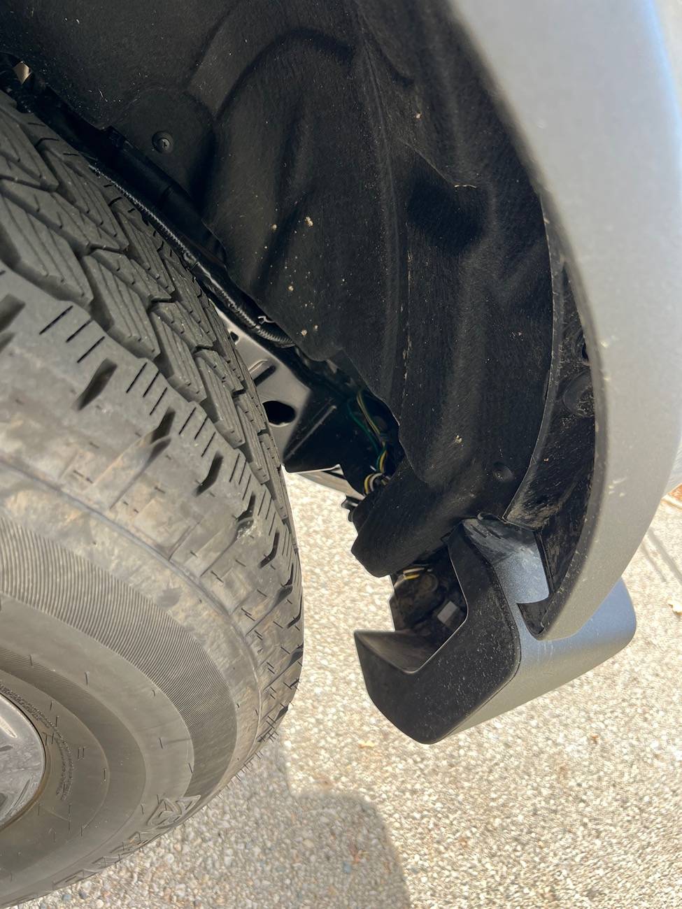

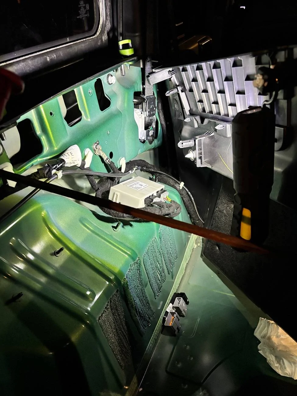

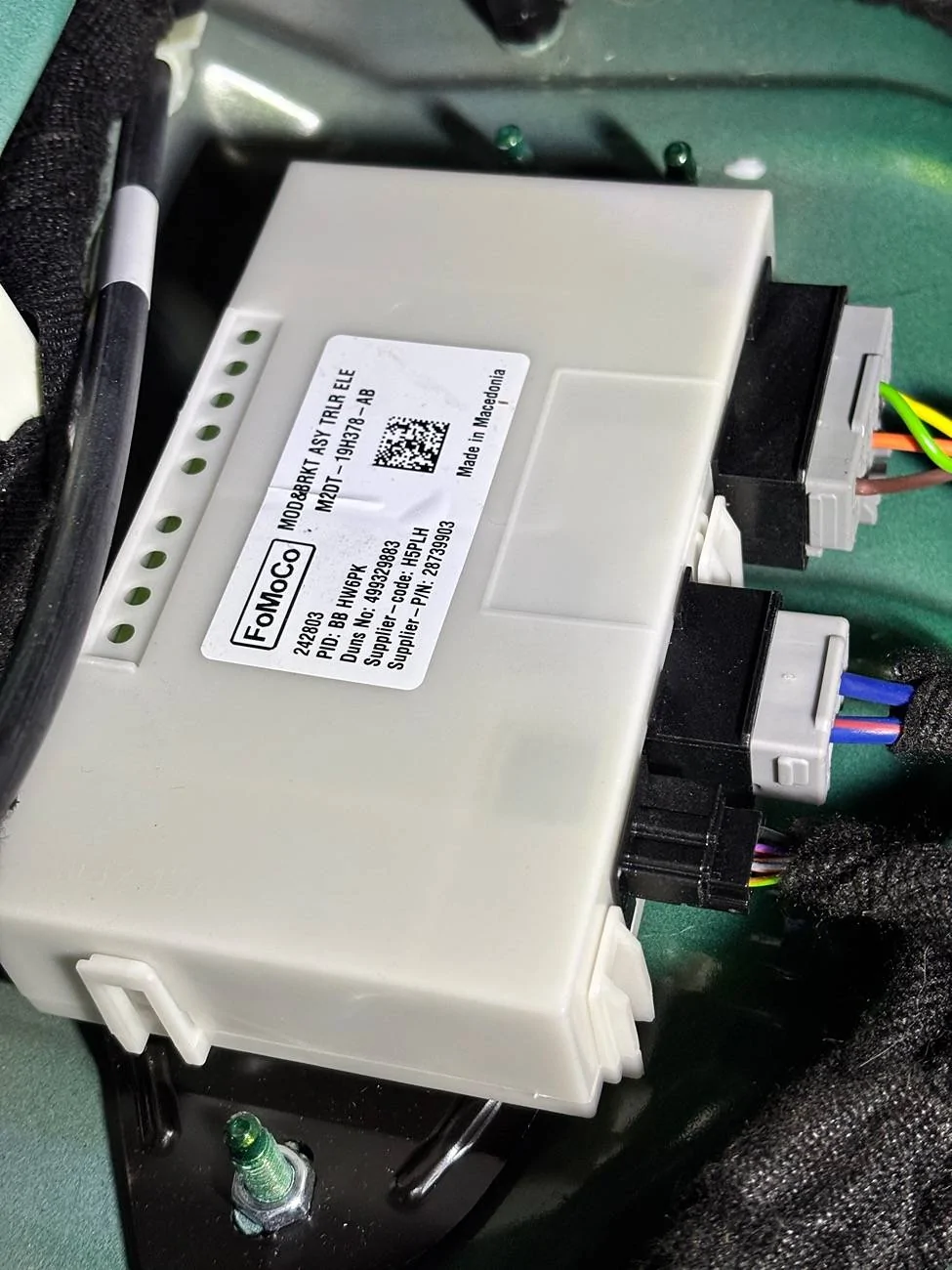

I figured it out… without the help from 2 dealerships. In fact… they both gave me incorrect information that would have cost me +$500. All the wiring is there and intact, I needed to purchase the trailer module that comes in the;
Trailer Hitch Wiring Harness – 4 / 7 Pin by Lumen - Part Number: VP2DZ15A416A
Installed behind the driver side rear quarter panel and now 4 pin and 7 pin register with my testers. The website told me it wouldn’t work with my 2024 Big Bend so buyer beware.
Also… be sure to disconnect the negative battery terminal before plugging the module in.
