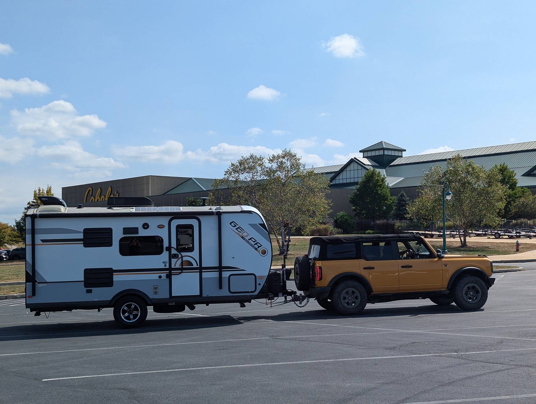

Brake controller, weight distribution hitch, and blue Sumo Springs in the rear and my 2021 Badlands 7MT had no issues pulling our 3500lb 2020 GeoPro 19GBH through the hills of northeastern Pennsylvania. We travel with a full water tank and gear for the whole family.
The 2.3 likes to rev, doesn't complain under load, and the temps never get high. Stopping is uneventful when the brake controller is set properly.
Ford Bronco Towing 3,000+ lbs - Actual experience input requested 672574-761a02574cfbe82b4ac205d0229c31aa
We did outgrow this trailer and will be towing the bigger camper with the Expedition this year but the Bronco happily pulls 3500 lbs.
