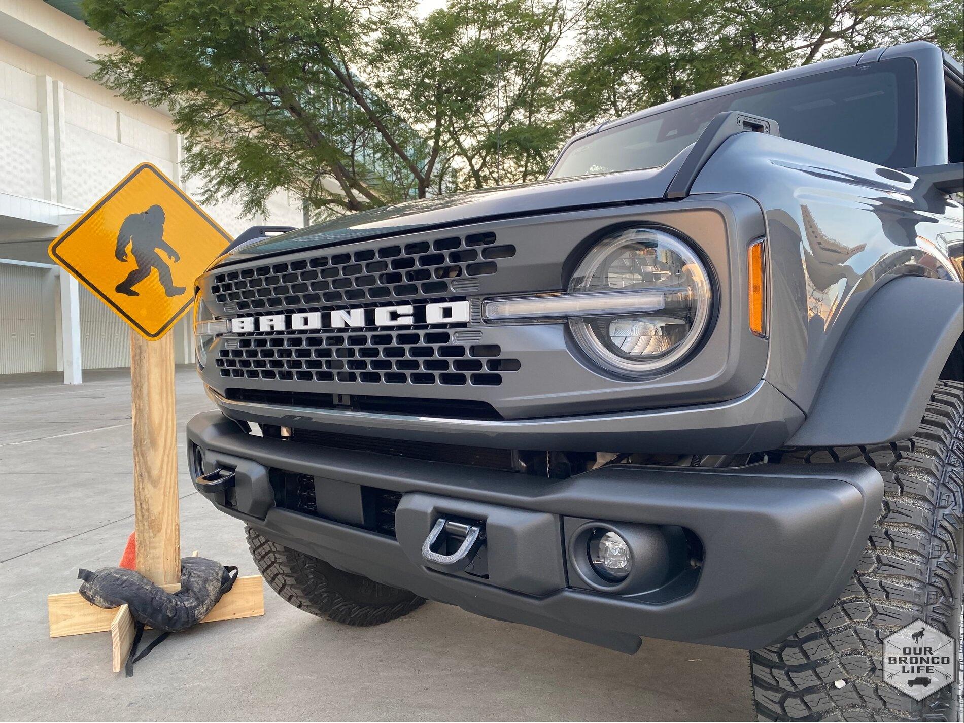

Hey North7, will these fit my Capable bumper on my Badlands (build date for end of January)?
they have a 7/8" screw pin. THX!

No, the Capable bumper does not have shackle brackets. It already has D rings.

This is the Capable Bumper.
Can’t I take the factory D rings off and put these on?
