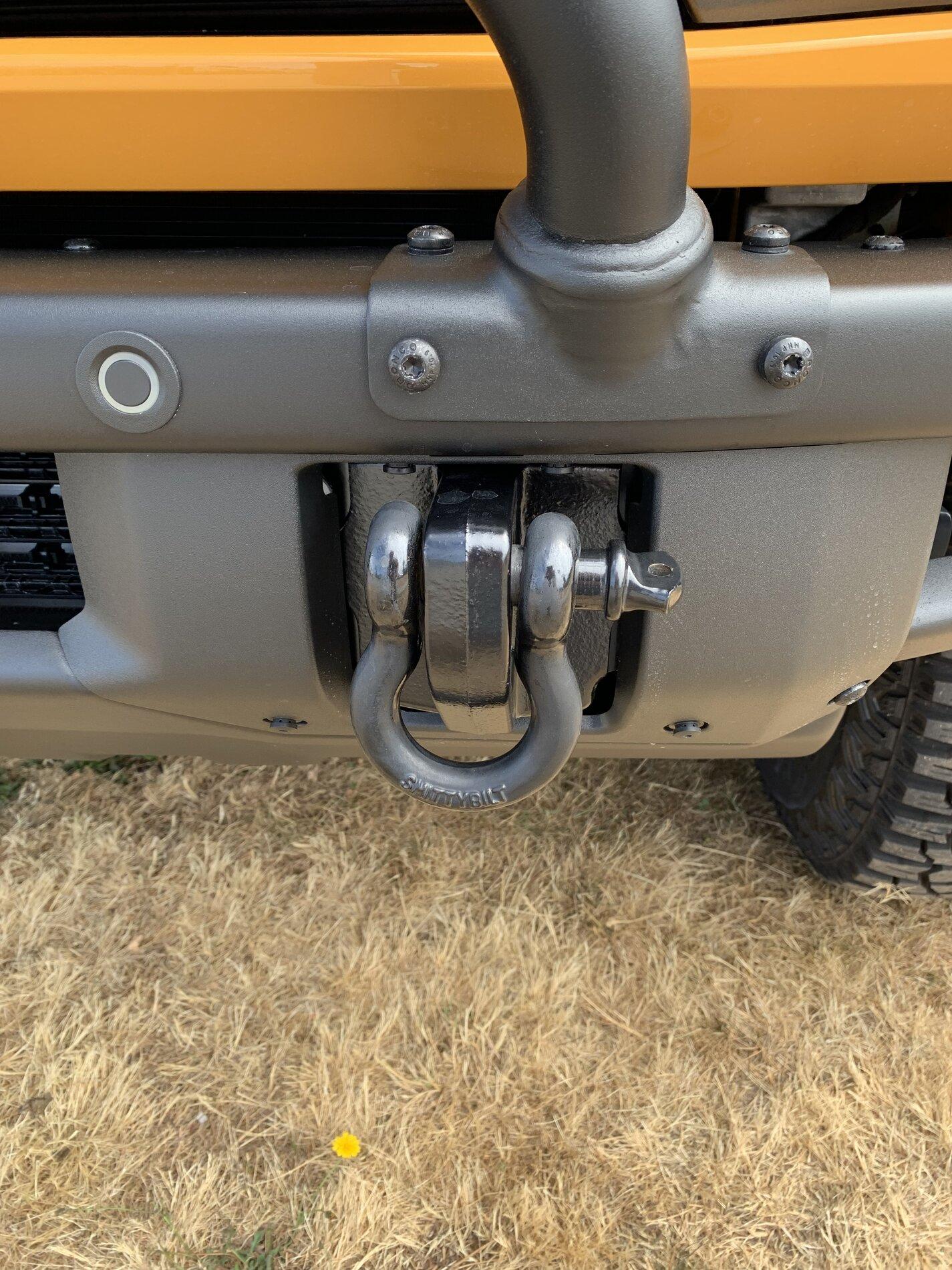

I don’t really want to start a new thread for this question, so thought I’d just post it here.
I finally got to see a Bronco in-person today. Yay!!! I took the Smittybilt shackle off my Jeep and put it on the Bronco. Looks like it fits pretty good!
Being a “newbie” to off roading, is there something you can purchase to make it slightly more snug/limit rattling? Almost like a washer that would go on.
Hope that makes sense. Thanks!
What size are the ones you tested?
I pulled it off my Smittybilt trailer hitch shackle. Their part number is 29312B - Receiver Hitch D-Ring - 3/4" - 4.75 Ton Rating - Fits 2" Receiver​
The correcct size would help, Jeep uses a 3/4" pin shackle, the Bronco uses a 7/8" shackle pin.
I took my calipers to a Bronco event to measure the pin hole diameter of the modular front bumper D-Ring mount. It measured .925" ID, so an industry standard 7/8" Shackle Pin will fit.
https://www.4wheelparts.com/p/smittybilt-7-8-d-ring-shackle-black-13048b/_/R-DSBP-13048B

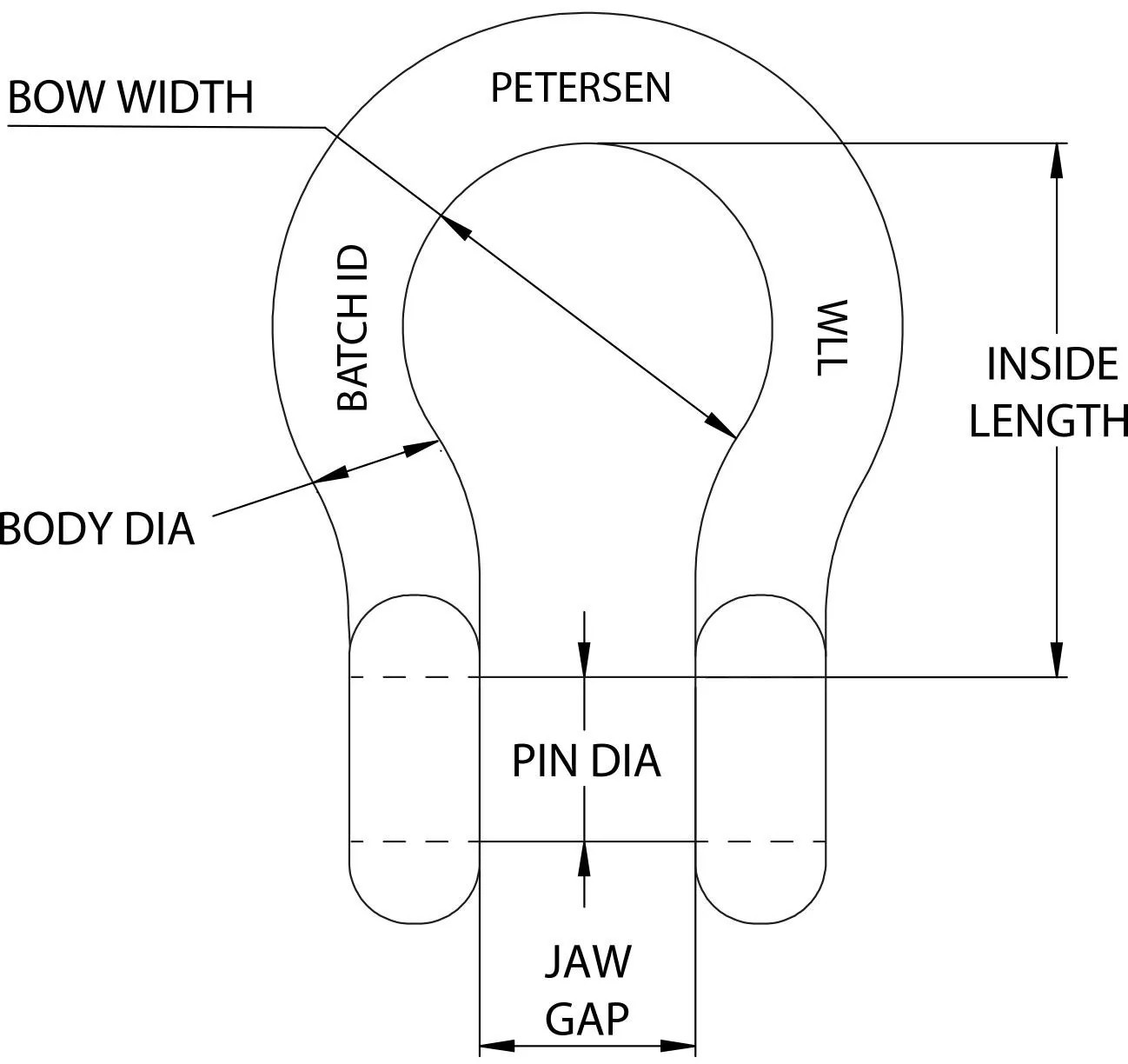

The Jaw Gap measured 1-1/8" with a ruler, not a caliper, so that needs to be confirmed on the purchased shackle as well.
https://offroadrecoveryguide.com/sizing-shackles-off-road-recovery/
