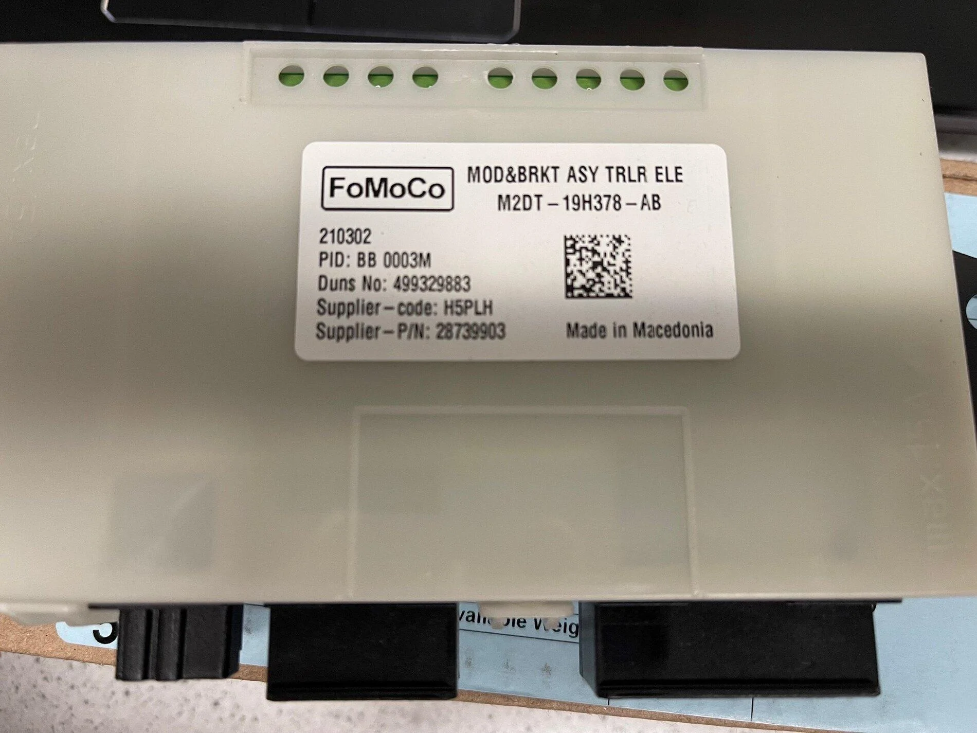

Now for the $64 question.
WHAT'S IN THE BOXXXXXXXXX?
Seriously, is there anything else in there, maybe a wiring dongle that gets clipped in somewhere? if it's really that easy, I'm whacking it from my order right now.

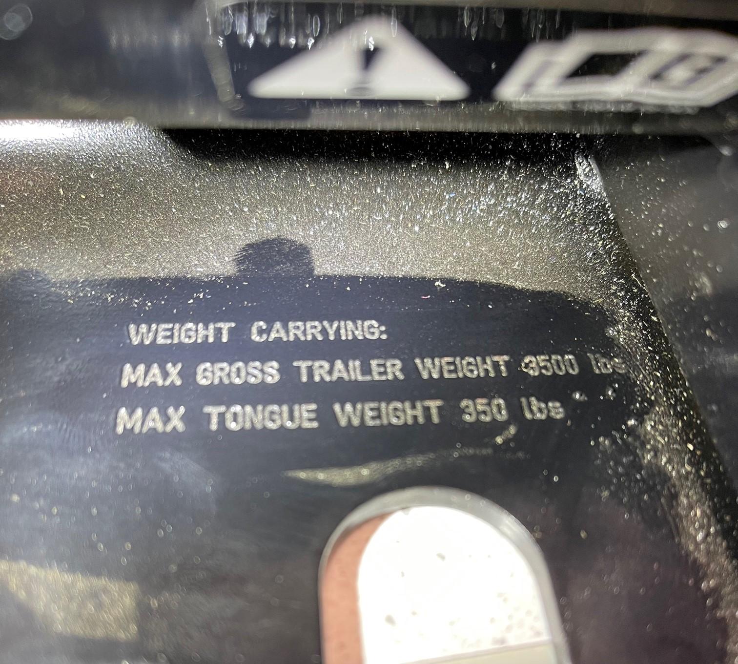

LOL, only 3 bolts out there.

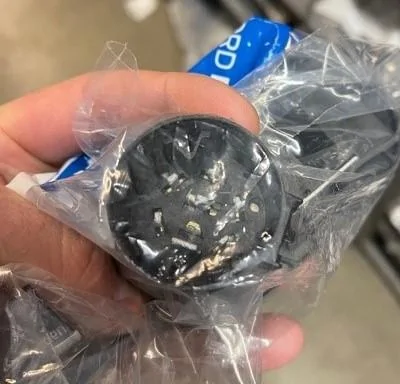

This comes with the 4-pin plug right? Let's see a picture of the cable.
No. Like other modern Ford product the 7/4 pin is a separate unit available. There is a harness that comes from the body that plugs into it.
I'm workin on some stuff but it may require tapping into the rear lights with FT1Z-15A416-A a WPT-975/3U2Z-14S411-JXC and some form of a 9U5Z-14489-MAA.
Part of the problem is the the turn signals come out of the BCM by the driver kick panel, go back to the trailer module over the left rear wheel well, back to the front, out of the body then back to the connector that plugs into the 14489.
Ugh, and that's work that's a pain in my garage vs the factory. Good to know. Thanks!
Hardest part will be finding a factory spot to take the wires out of the vehicle to the plug. Trying to come up with a semi plug-n-play with as little wire chopping as possible.

Look what showed up today. Who said tow package is a commodity problem?? Guess I'm going to clean out the depot now.
Let us know how hard it is to install the hitch and then the wiring. Thanks.
Note to aftermarket: Make the bolts insert from the front (muffler) side, so we don't have to remove the bumper facia.
EDIT: Also address halogen vs led wiring differences in harness.
