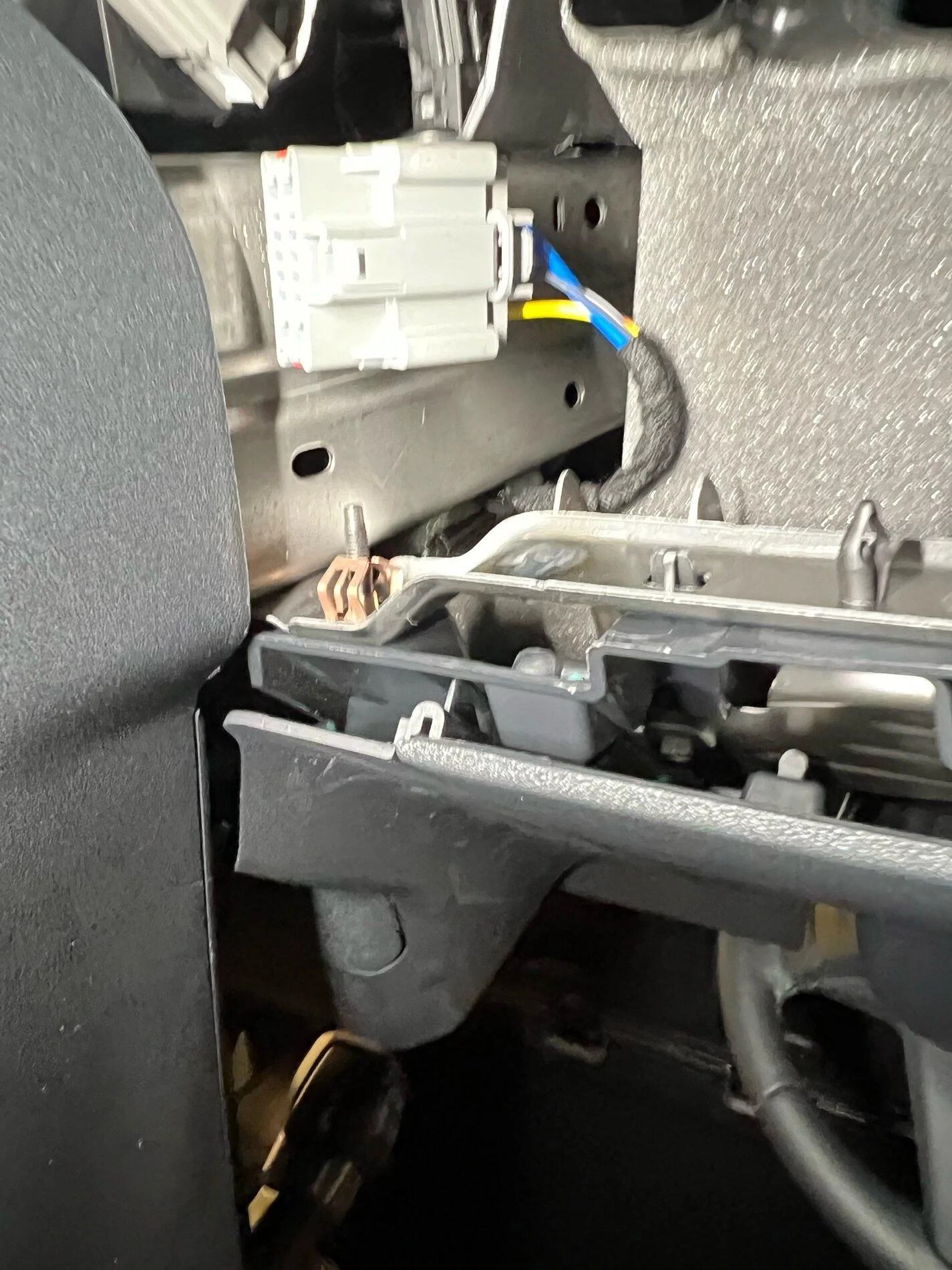

I had the knee panel down yesterday when I was installing my first mod, the Autostop Eliminator.
The connector for the TBC is present even without the tow package

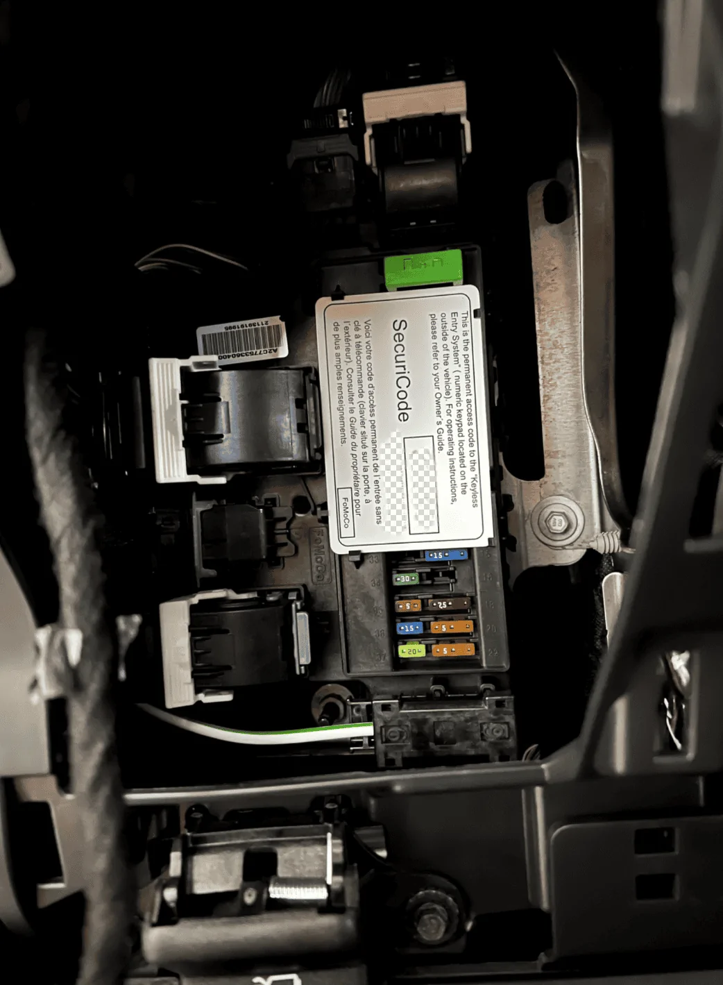

here is the BCM/Interior Fuse Panel. Interestingly enough a Secuicode keypad Code card was clipped to this, even though you can't get a wired keypad on the Bronco and the RF one doesn't use the code. Next time I have Forscan connected I'll check to see if the code in the BCM matches this card:

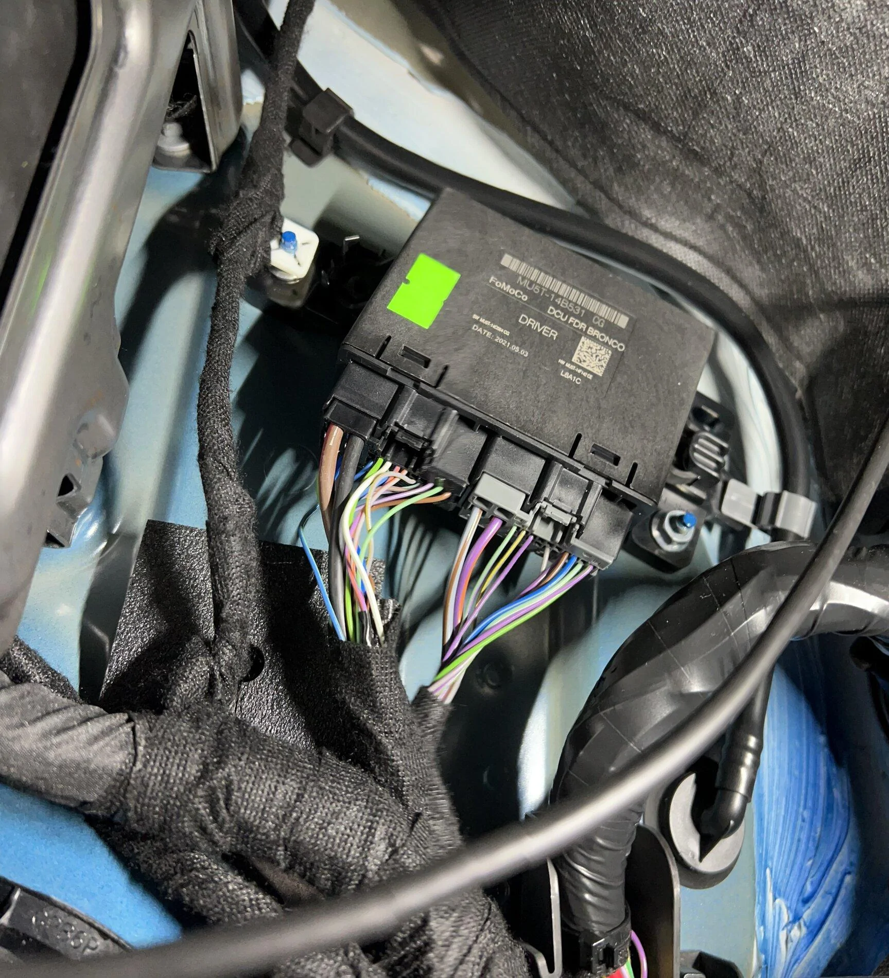

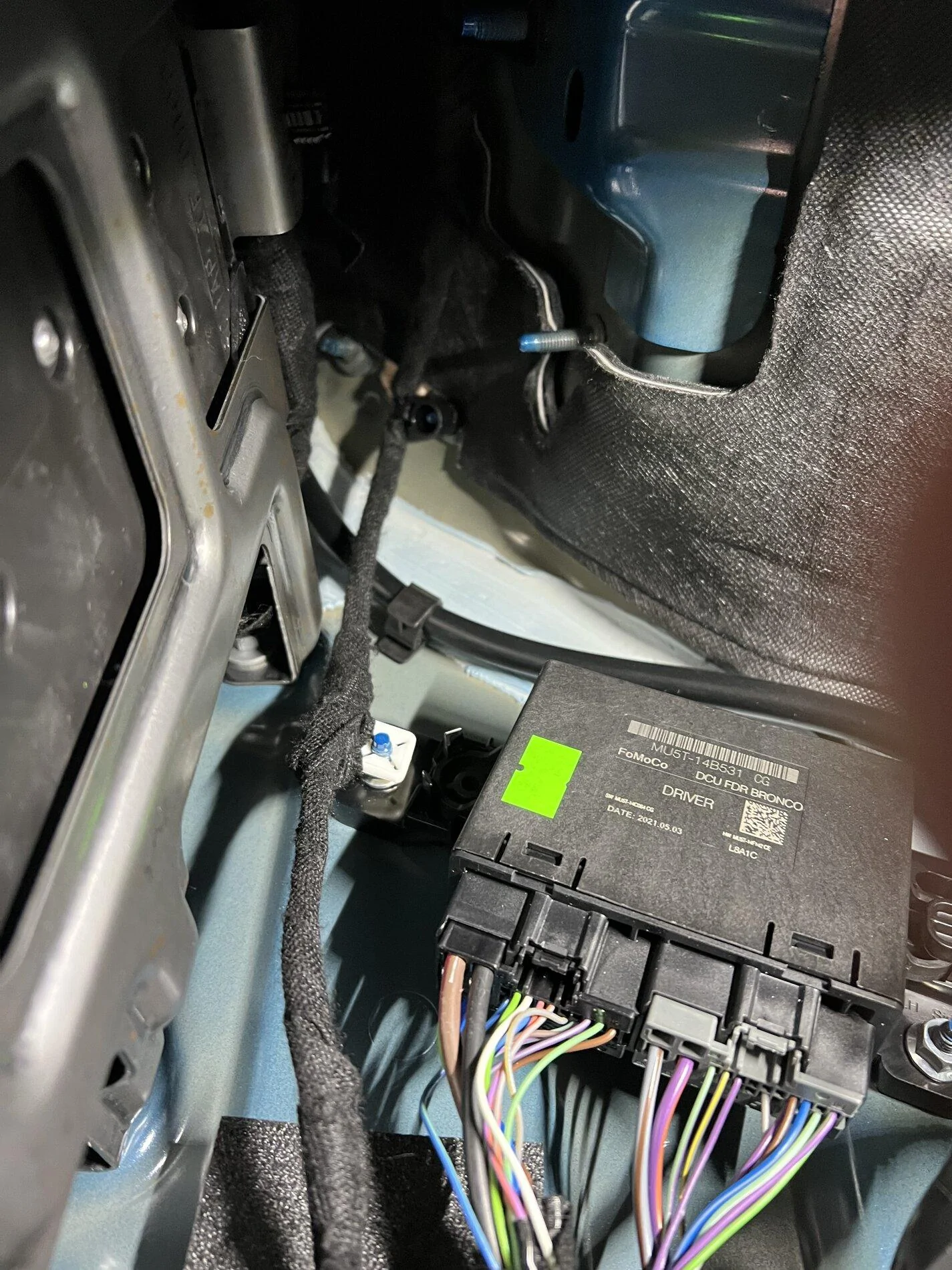

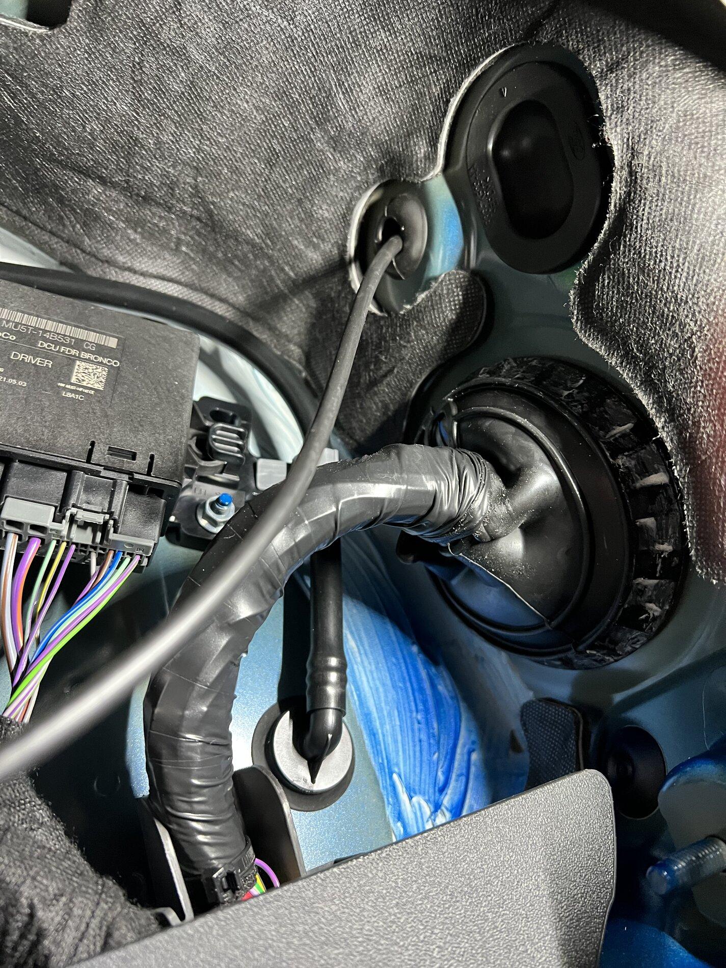

And up above the kick panel where C105/C201 are supposed to be. Only connectors I see are these two plugged into the DCU module. Maybe those connectors are behind the speaker?

Any luck finding them? I wonder if someone doing a speaker upgrade has pictures?
I found C201 and C105 and they are harness-harness connectors. They are behind the fender skin above the tire. You can see them with a mirror if you peer over the tubing that supports the fender or you can remove the flare and a few of the fender skirt fasteners and pull it down and see them from the wheel well side. Here are pictures of mine from below and then above. Note that on my base all the wires of interest go into C201 but do not come out the other side. Bummer, but at least all the fuses for those circuits are in place so I'm assuming they can be tapped off this connector.
