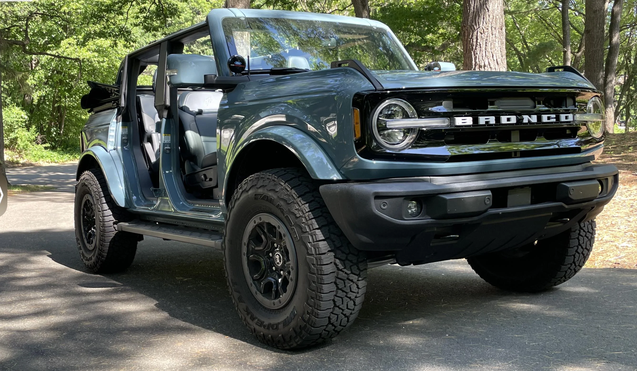

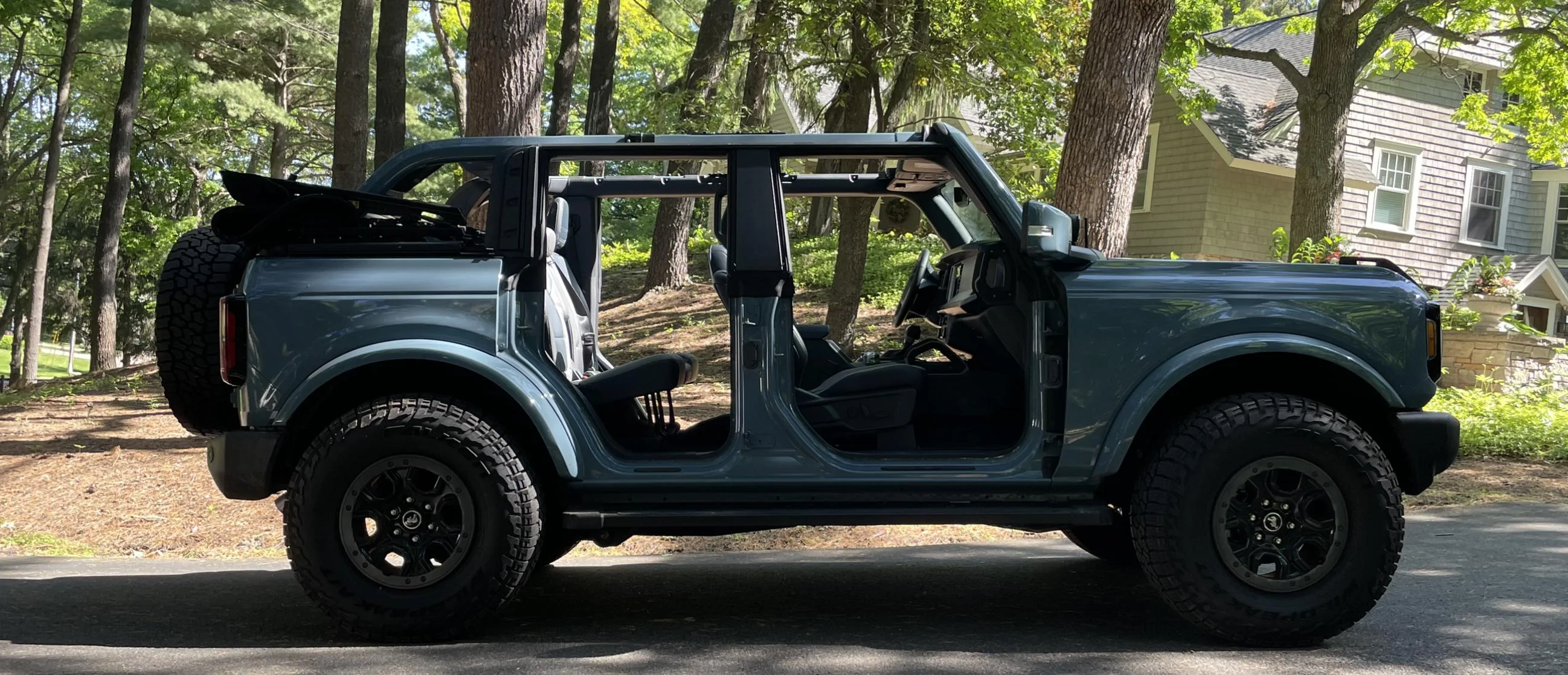

Mine is a non Sasquatch OBX with Sasquatch wheels I bought locally and put on 315/70R17 Falken Wildpeaks and a 1.25” leveling kit. Crash bars removed and zero rubbing.
Ford Bronco Tires and Wheels. Educate Me. CA17BF2D-E4EE-4890-AED5-3E7F203B51D3
Ford Bronco Tires and Wheels. Educate Me. EF8A8F6C-0117-43E1-A029-2F3A8F0B20D2
