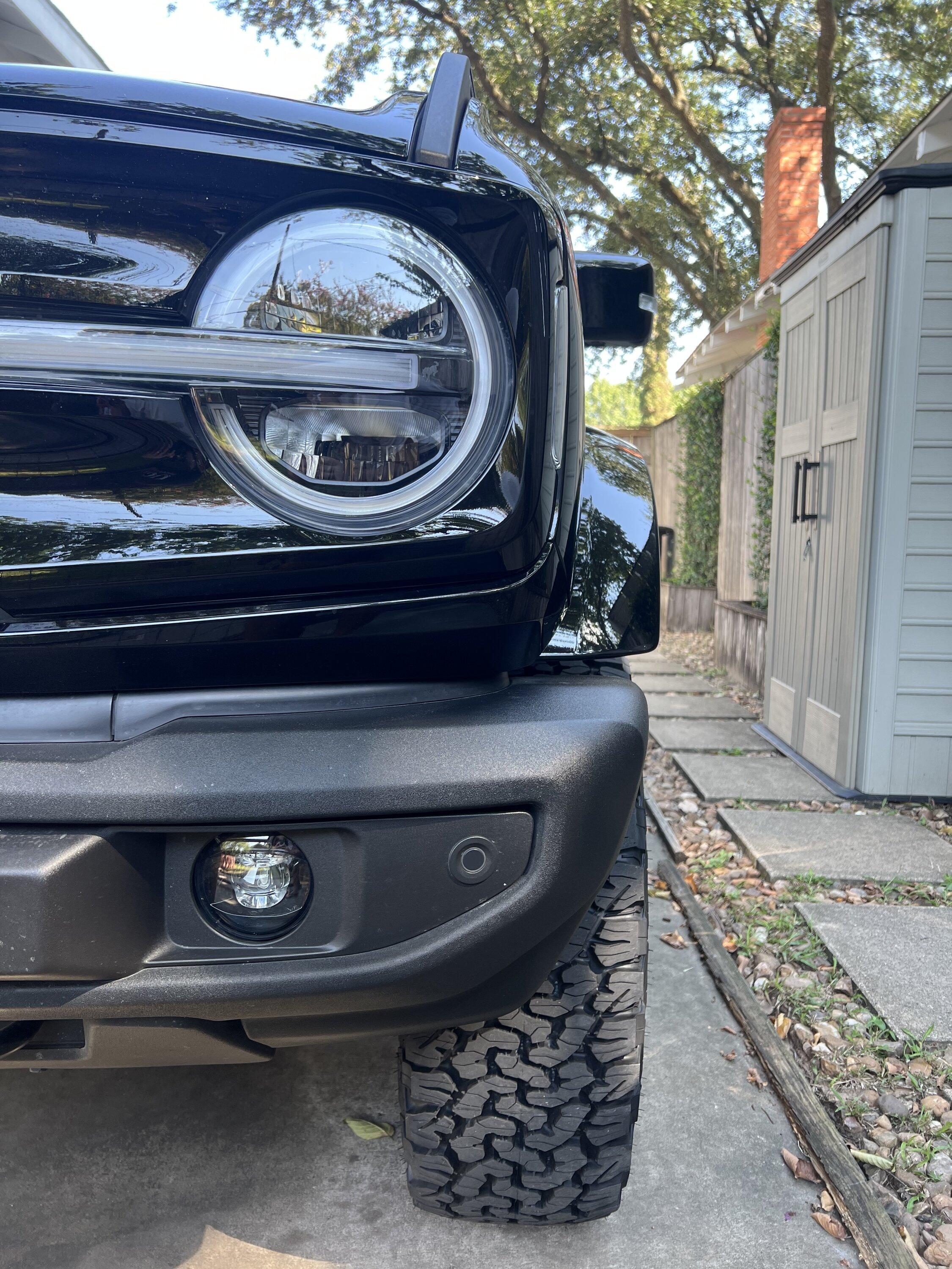

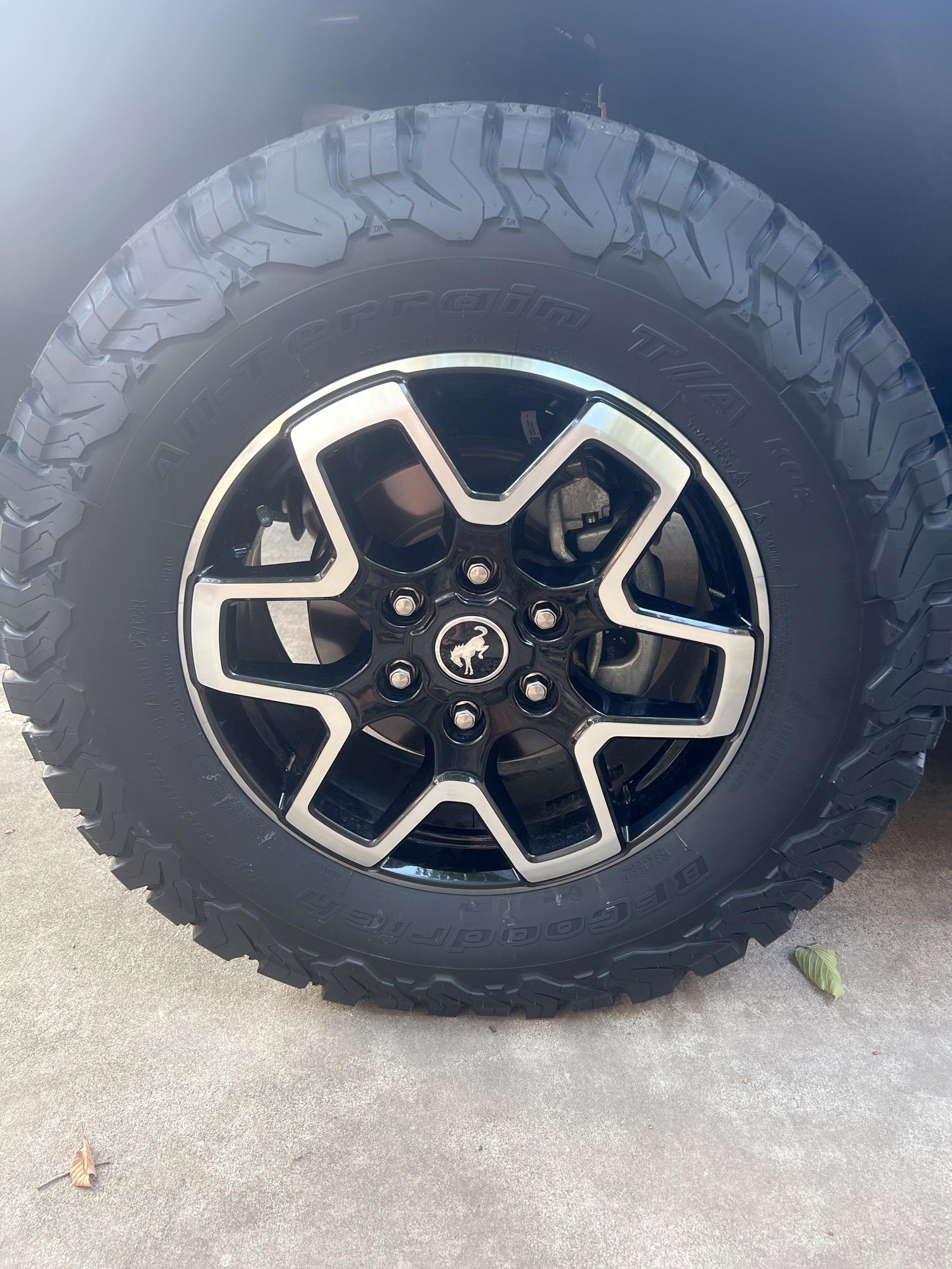

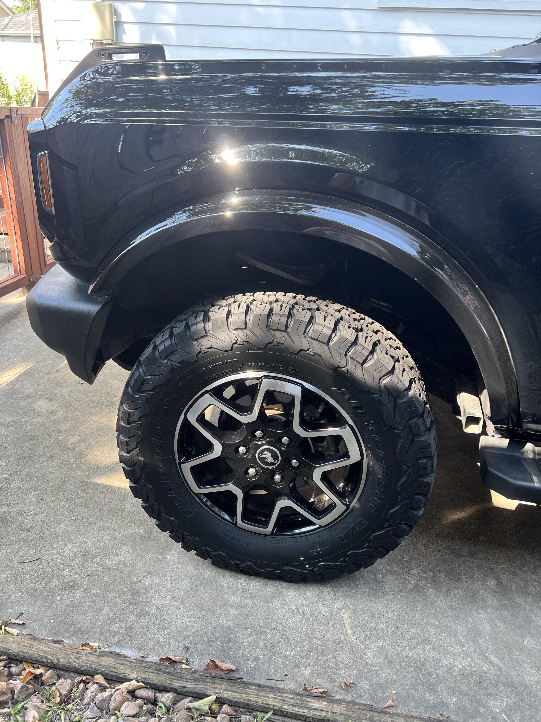

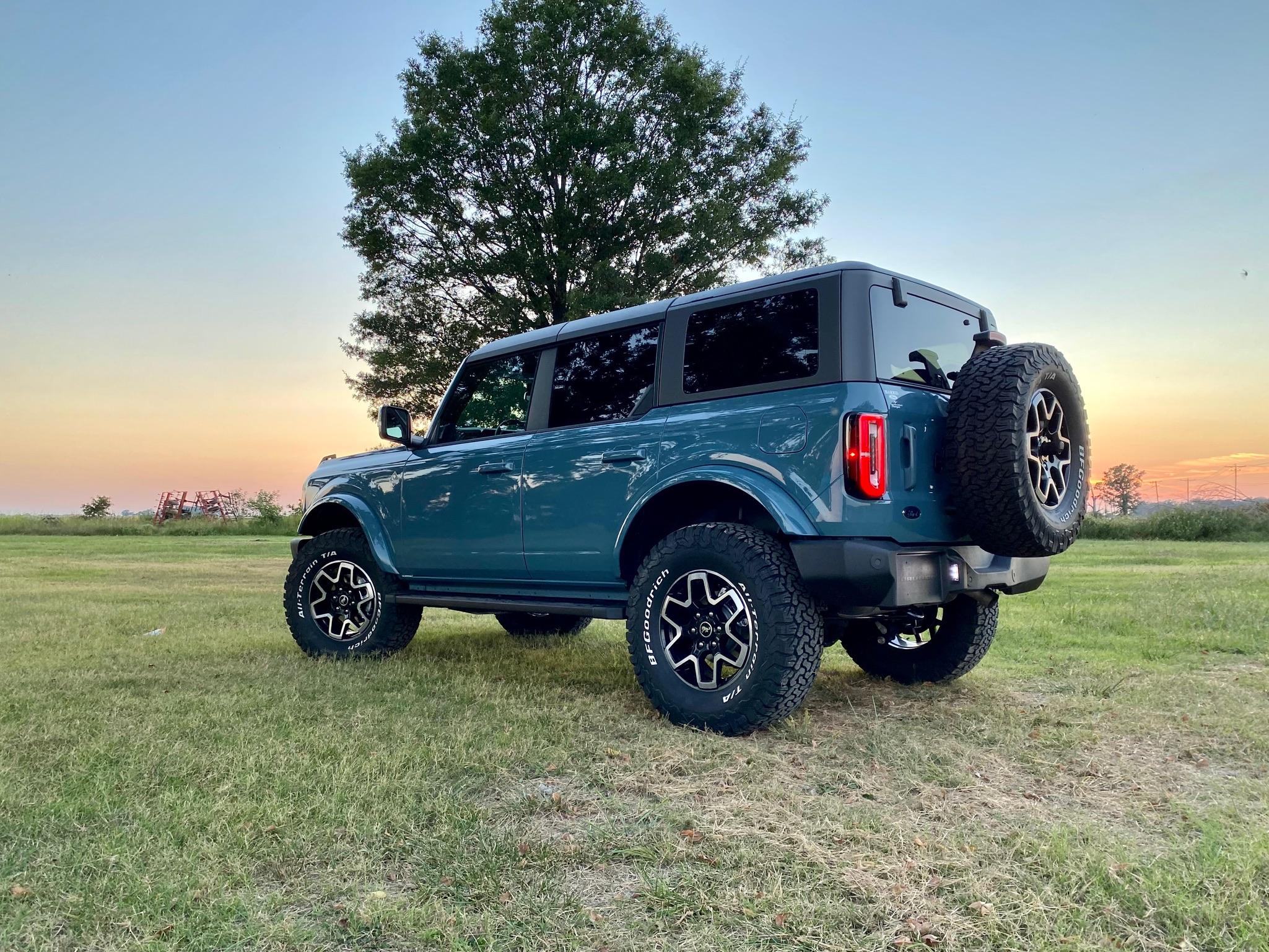

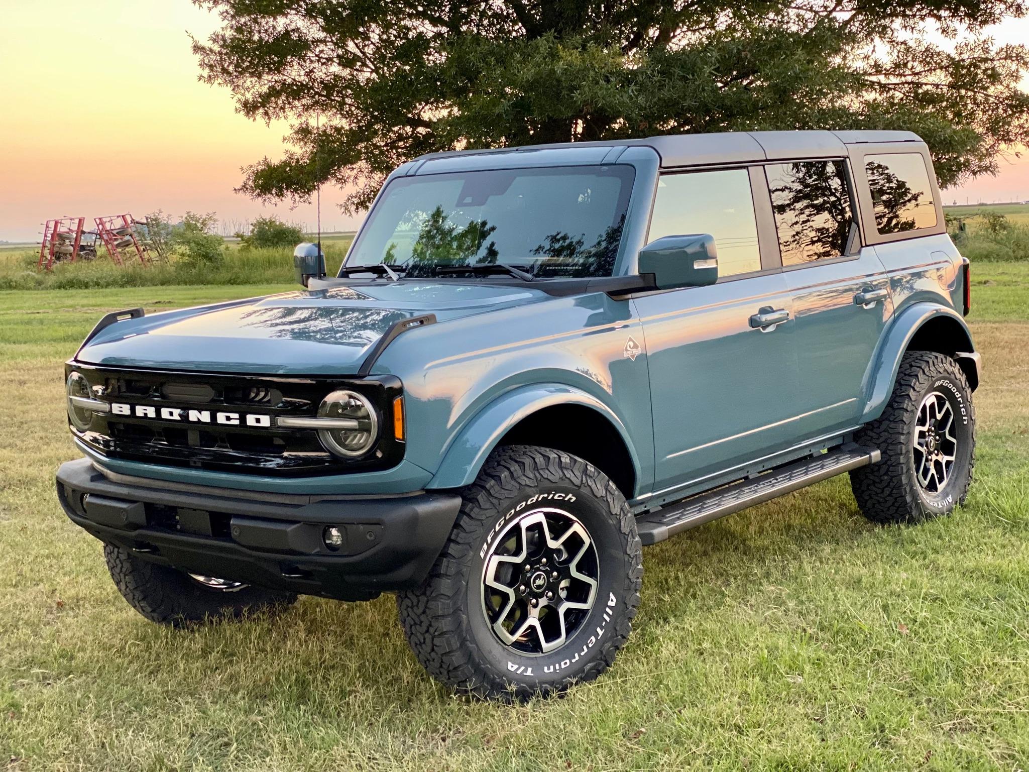

I got a non sas obx in November so rims are 18. This past week I had 285/65/18 bfg’s k02s added. Would’ve fit without a lift, but went ahead and added a 2” lift and I love it. No lift can look really squatty and potentially rub (though most haven’t had any issues it seems with 33) Attached a couple pictures for reference.

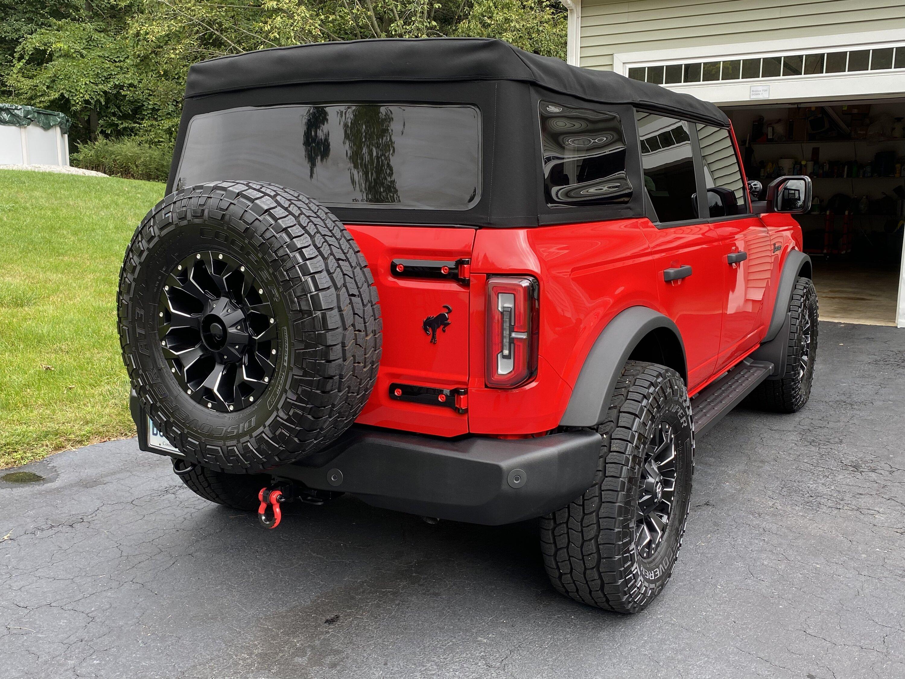

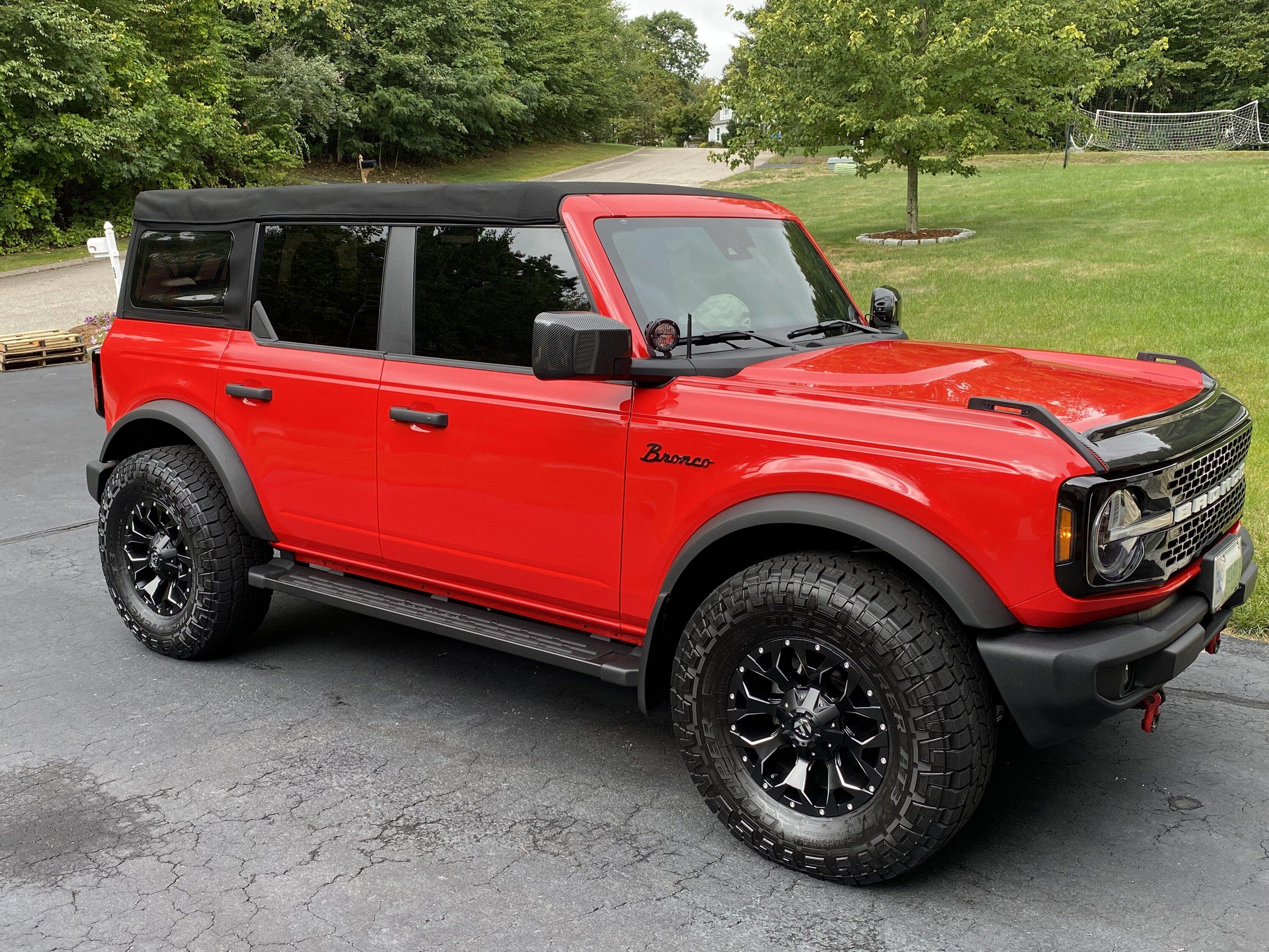

Easiest is going to reputable tire shop. There are so many variations that everyone runs on here. Im not talking about walmart. You could even call tirerack. They are pretty knowledgable. Mine are 315/70/17 on big bend. Crash bars removed. No rub lock to lock. About an inch of poke. +25 offset rim

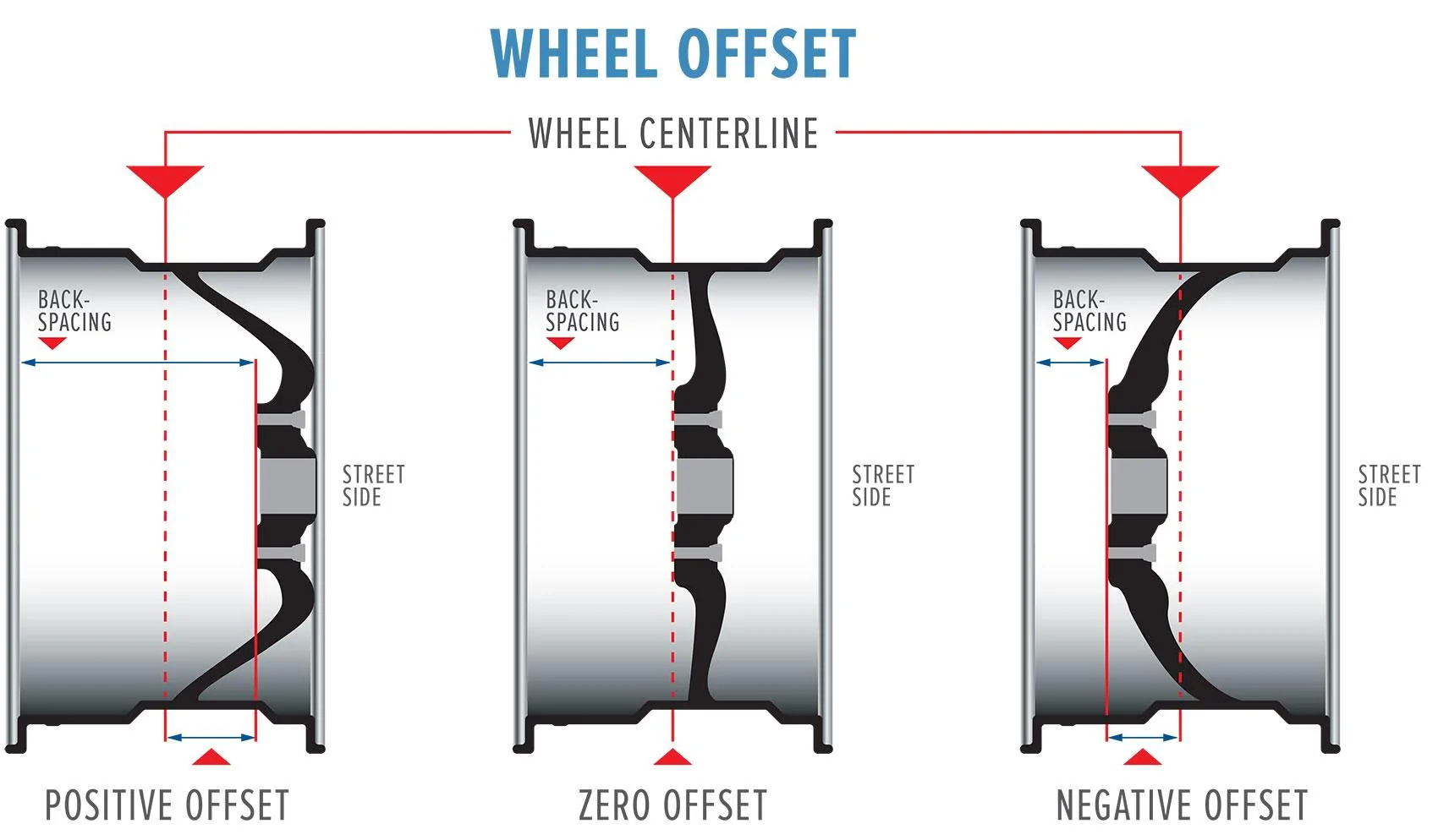

This might help with understanding offset.

I really like this look? Huge difference in road noise from Stock to these? Huge decrease in MPG? I like the look a lot. Thanks for the imput.
Noise - no change at all. The 285 is about 33.7” and I think you’d need to go to 35” (Sasquatch size) to really feel a bit difference.
MPG - so far minimal but only been about half a tanks worth of driving. Seeing a slight downturn in mostly only city driving.
10 months driving around with stock set up vs a week or so with the new one and it’s so much more fun now.

So looking at the website tiresize.com, Im not sure I understand how offset is implemented. Is it built into the rim, or is it something else? I see the effect that a negative offset has versus a positive one, but again, is that built into the rim, or how is implemented?
Thank you,

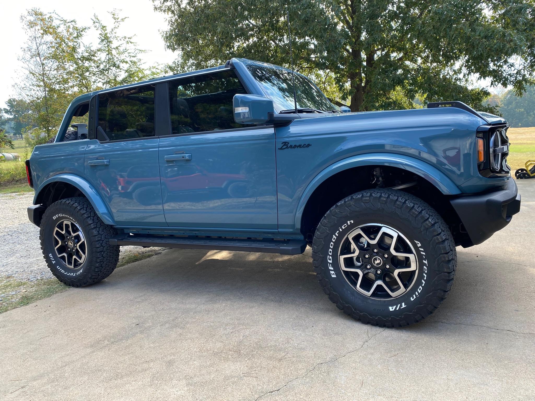

We put 35x12.5 on ours... 2" lift.
