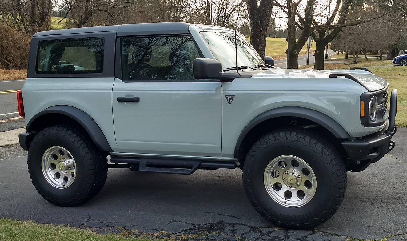

Not mine.
Ford Bronco Wheels, Tires and Lift? 1737902395606-8q

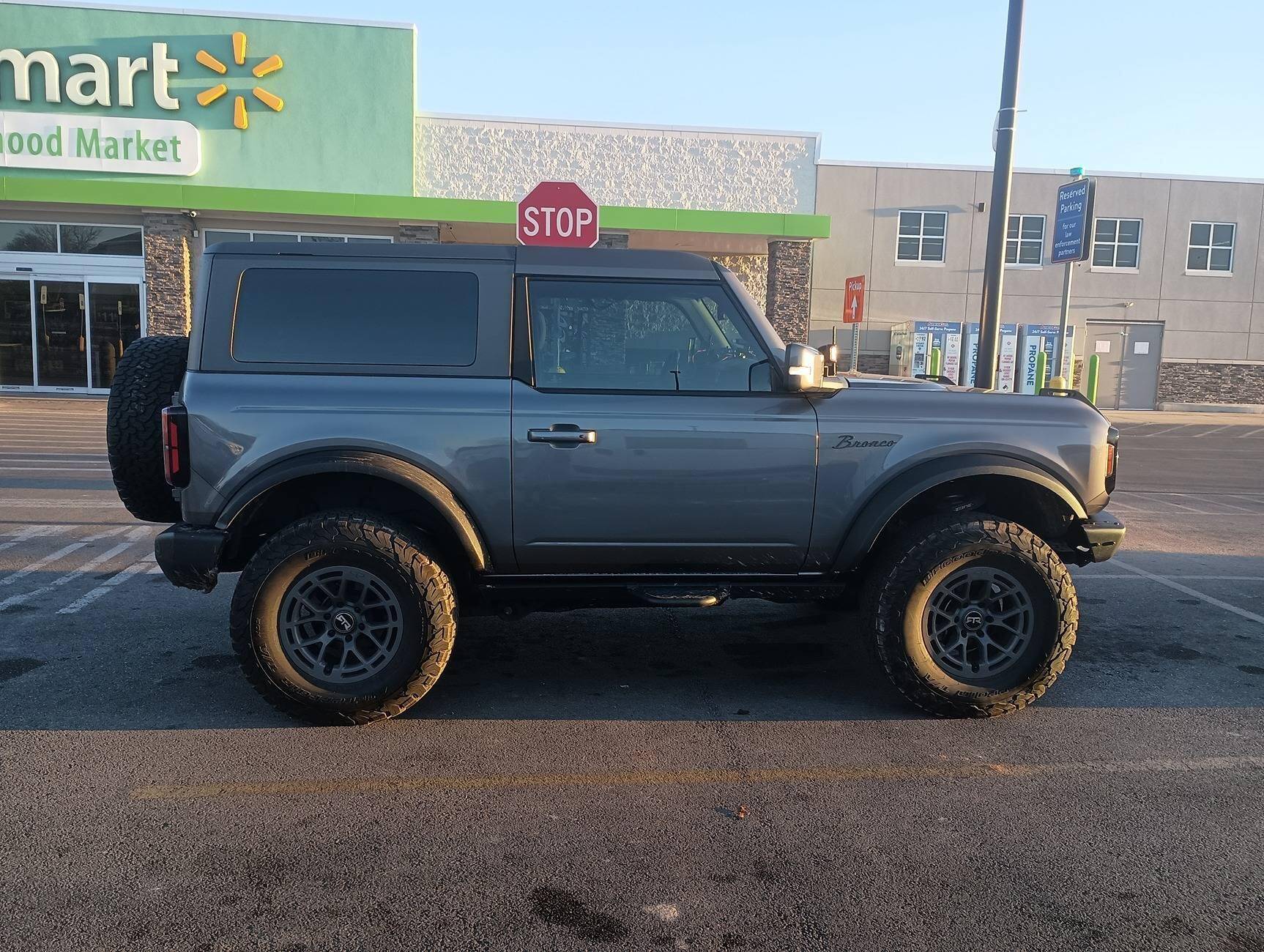

Not mine either
Ford Bronco Wheels, Tires and Lift? 1737902606744-3v

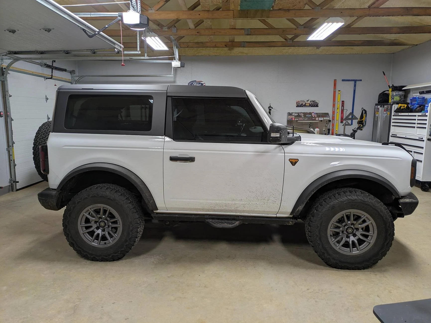

This is my Bronco. Stock Badlands suspension and tires (33"). Icon Vector 6 wheels (17")in Titanium.
Ford Bronco Wheels, Tires and Lift? PXL_20241203_232602345

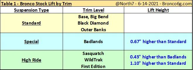

Do the Badlands have a factory lift that makes them higher than the stock Big Bends? This is exactly what I was picturing for mine!
Yes, Big Bends have Hitachi shocks and Badlands have Bilsteins. @mpeugeot (Gray Bronco)is running Eibach 2.0 coilovers and 35's.
Badlands sit just shy of 1" higher. SAS is not quite 2" higher.

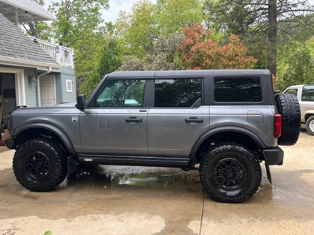

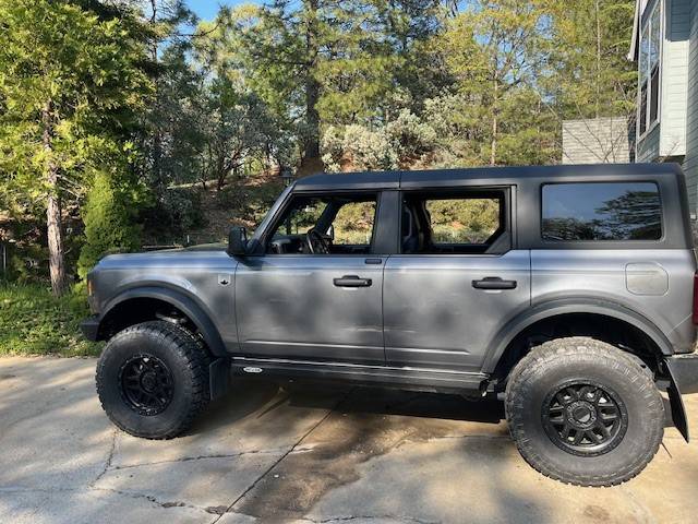

Here's a couple more pics, with my BB (non-SAS). I'm a bit lifted more than I want to be, but I figure I can always fill the wells with bigger tires :idea:
35" tires, hockey puck 2.5" lift on stock Hitachi suspension
Ford Bronco Wheels, Tires and Lift? after1
The same 35" tires, pucks and hitachi shocks replaced with 4WP coil overs set at minimum height
Ford Bronco Wheels, Tires and Lift? lift2
Badlands is .67" suspension lift and Sas is 1.1" over base. The taller tires make the overall stance higher than that, but this is the suspension difference.
