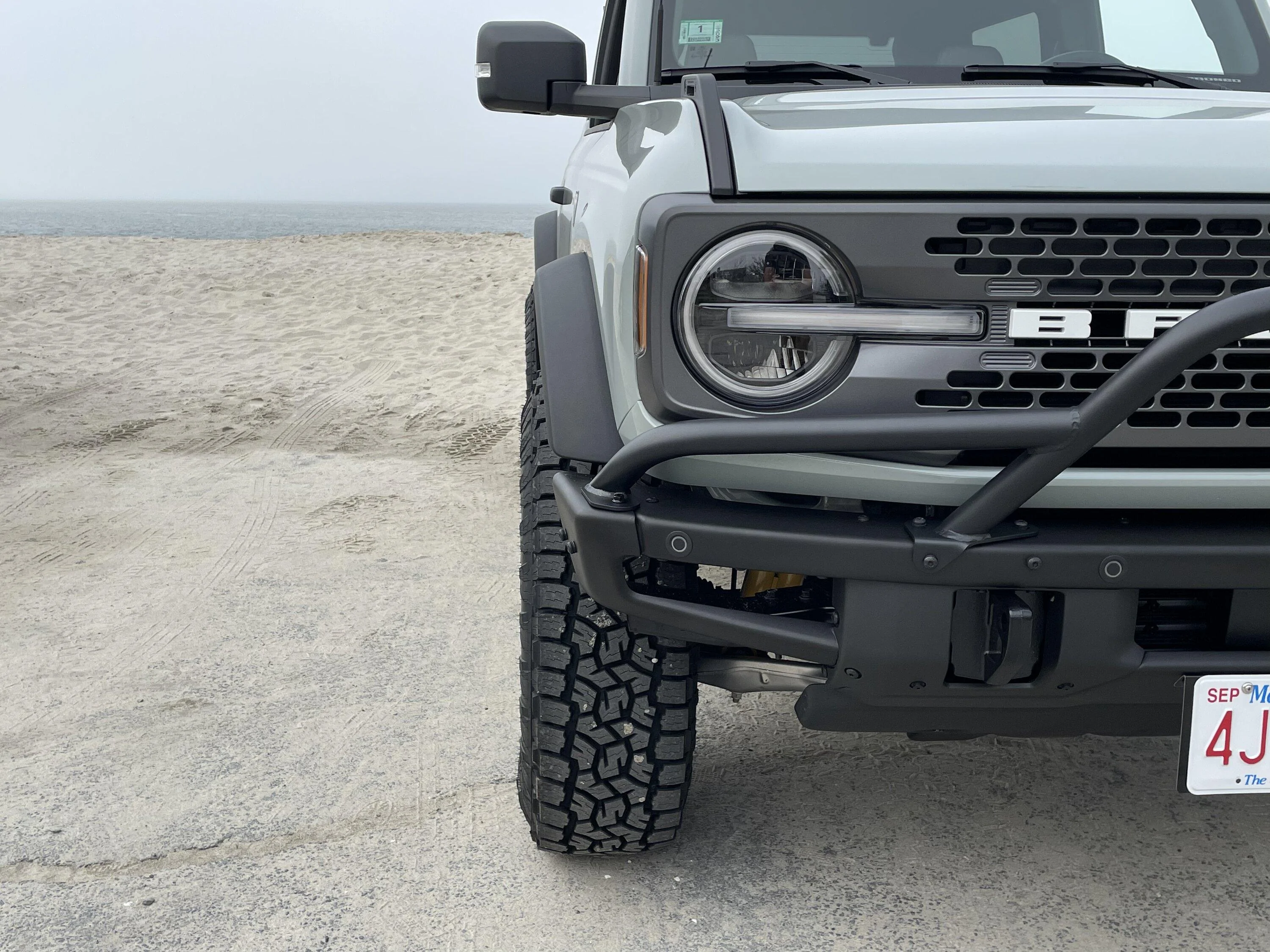

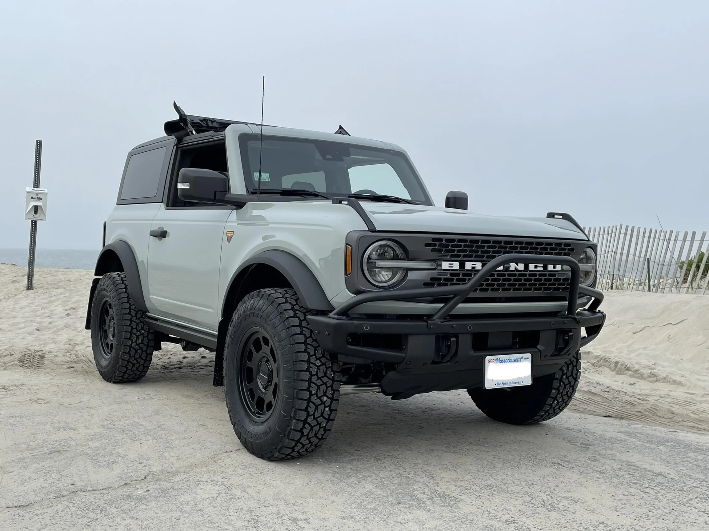

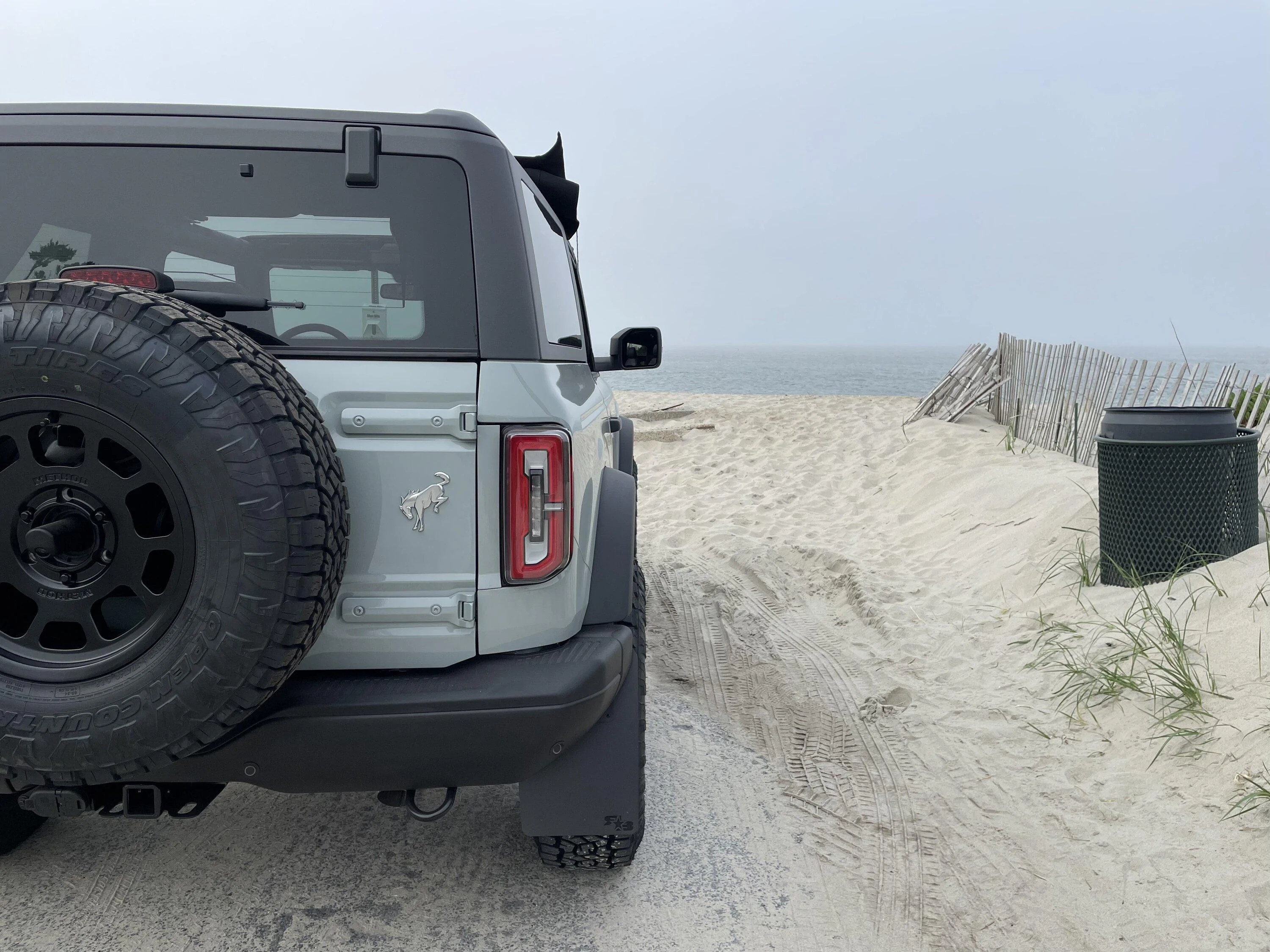

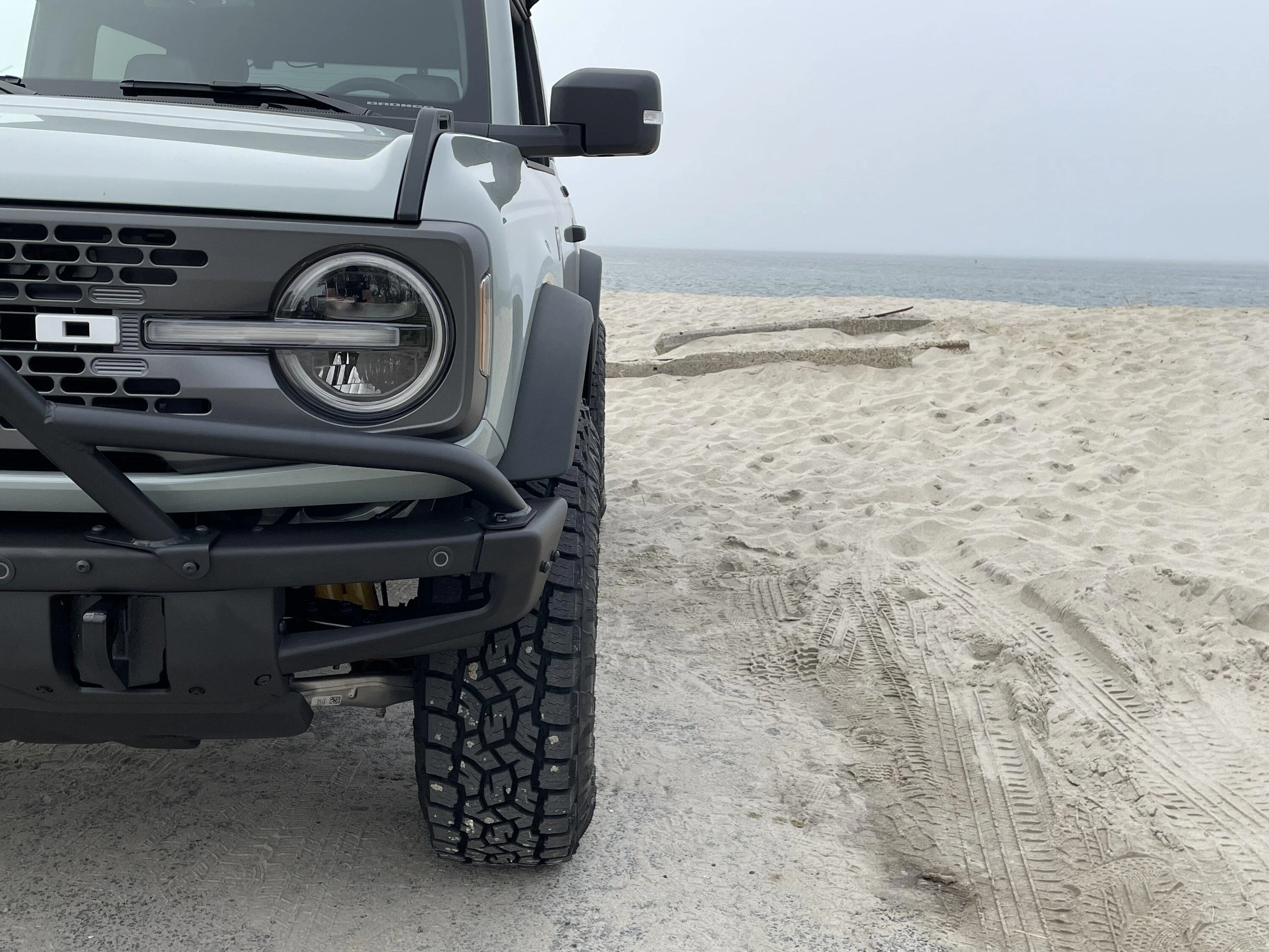

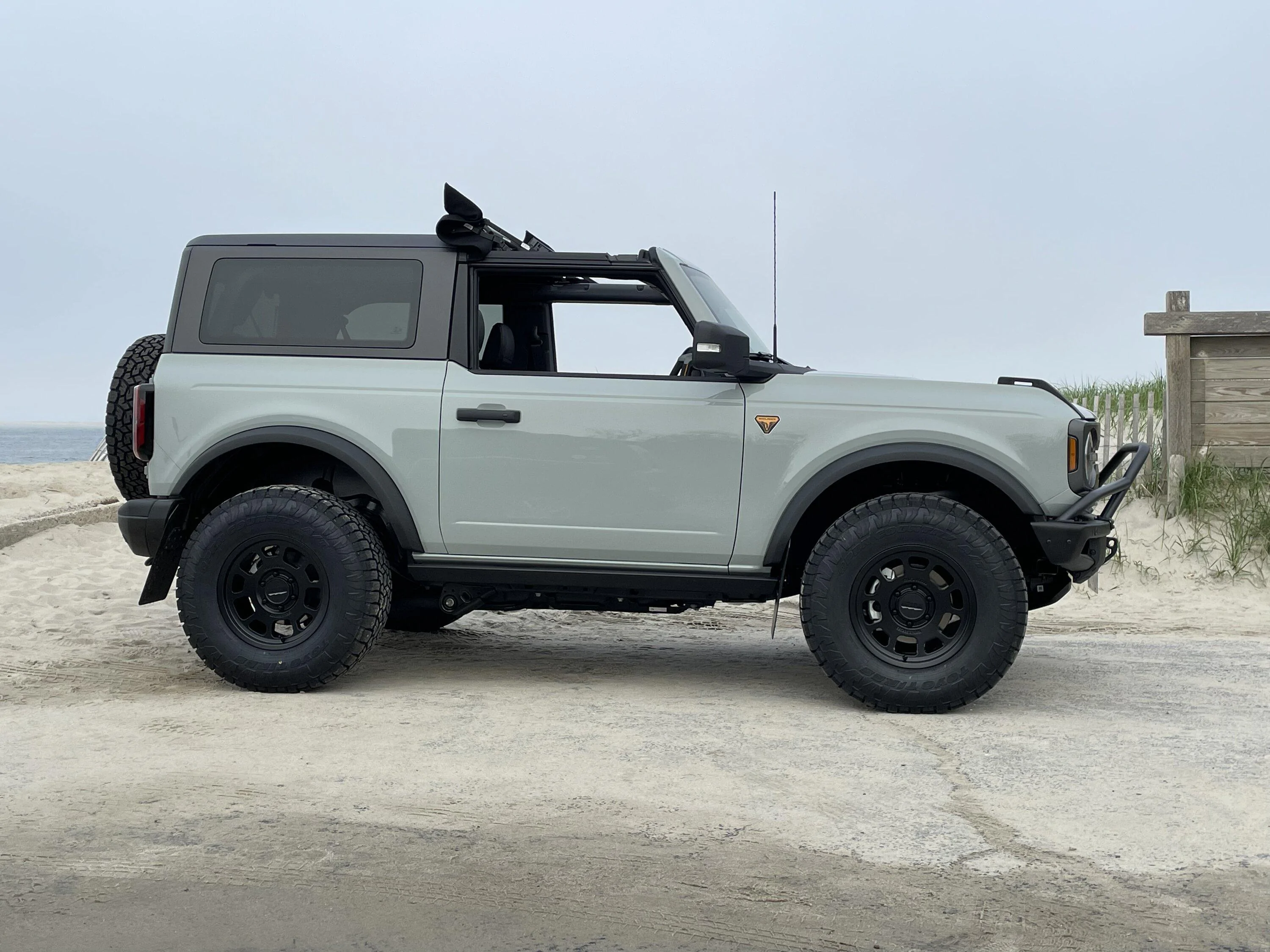

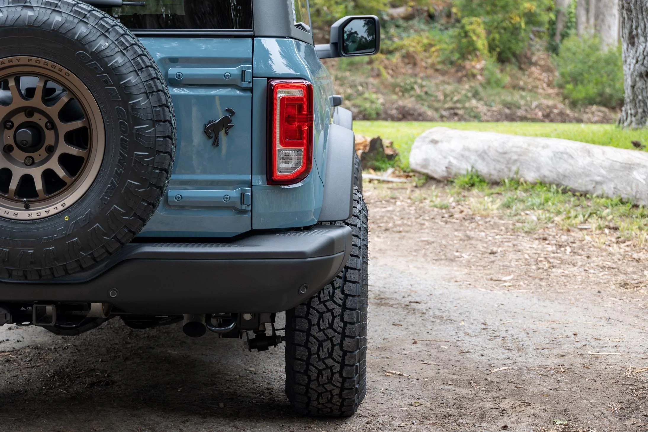

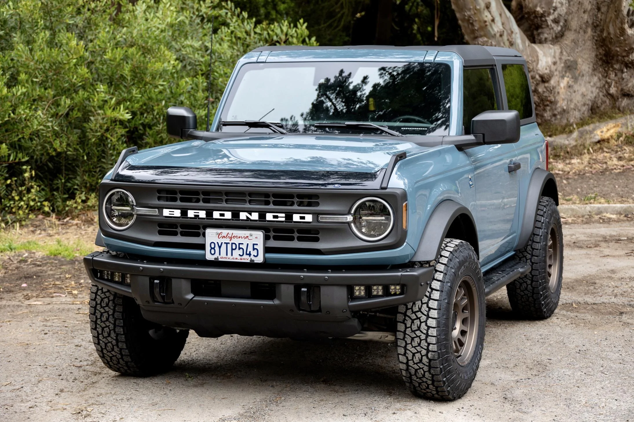

Did a chalk test on the tires. Dropped the psi to 34. Didn’t chalk completely even yet but it did feel a little better on a short freeway test ride up to 70mph.
Still waiting on getting that alignment. Also debating if I should’ve went 285/75/17 for a slightly wider tire too.
But thanks for the help everyone. Appreciate it! Few more pics just because.

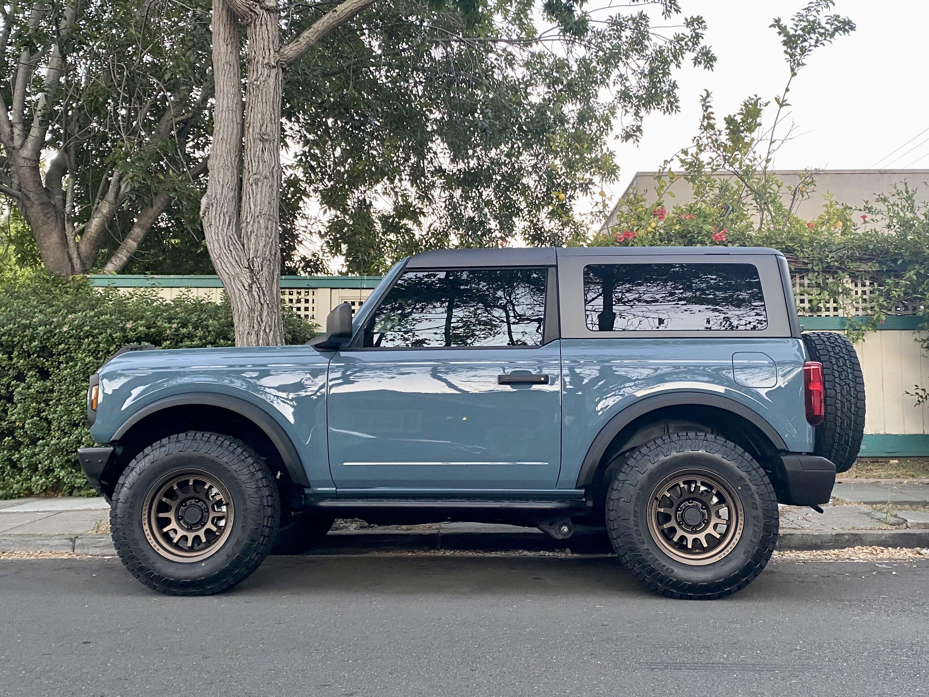

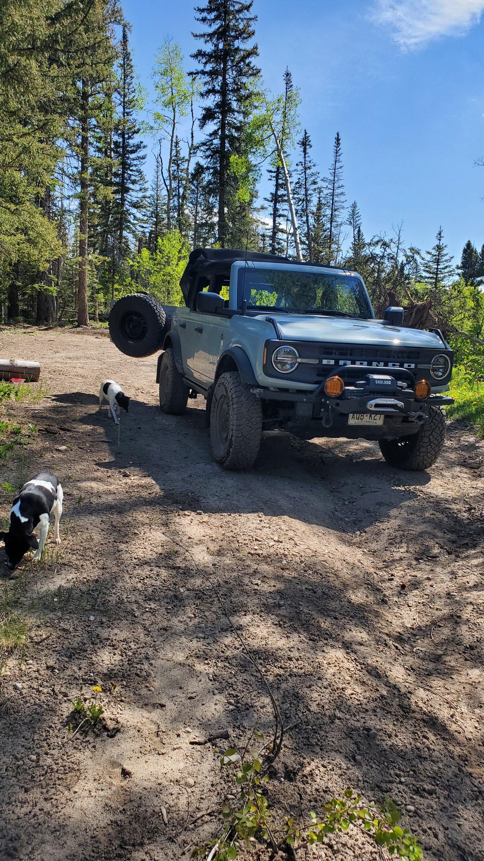

Here's an example of the Kenda's in 35x10.5R17...
Ford Bronco Tire stability on narrow tires 20220627_162748
Ford Bronco Tire stability on narrow tires 20220612_122209
Ford Bronco Tire stability on narrow tires 20220612_103300
Ford Bronco Tire stability on narrow tires 20220604_171644
Ford Bronco Tire stability on narrow tires 20220425_152127
Those Kenda’s look pretty good. I couldn’t find any weight specs on their website tho.
