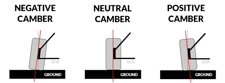

When I lifted my Ranger it felt a little squirrely as well until I got it aligned. I'm pretty sure that is your problem. An ifs lift affects camber, the wheels will lean in or out, which means you dont have the full tire on the ground.
Ford Bronco Tire stability on narrow tires 1656733841645
Pretty sure it also makes it toe in which would make it squirrely as well.
