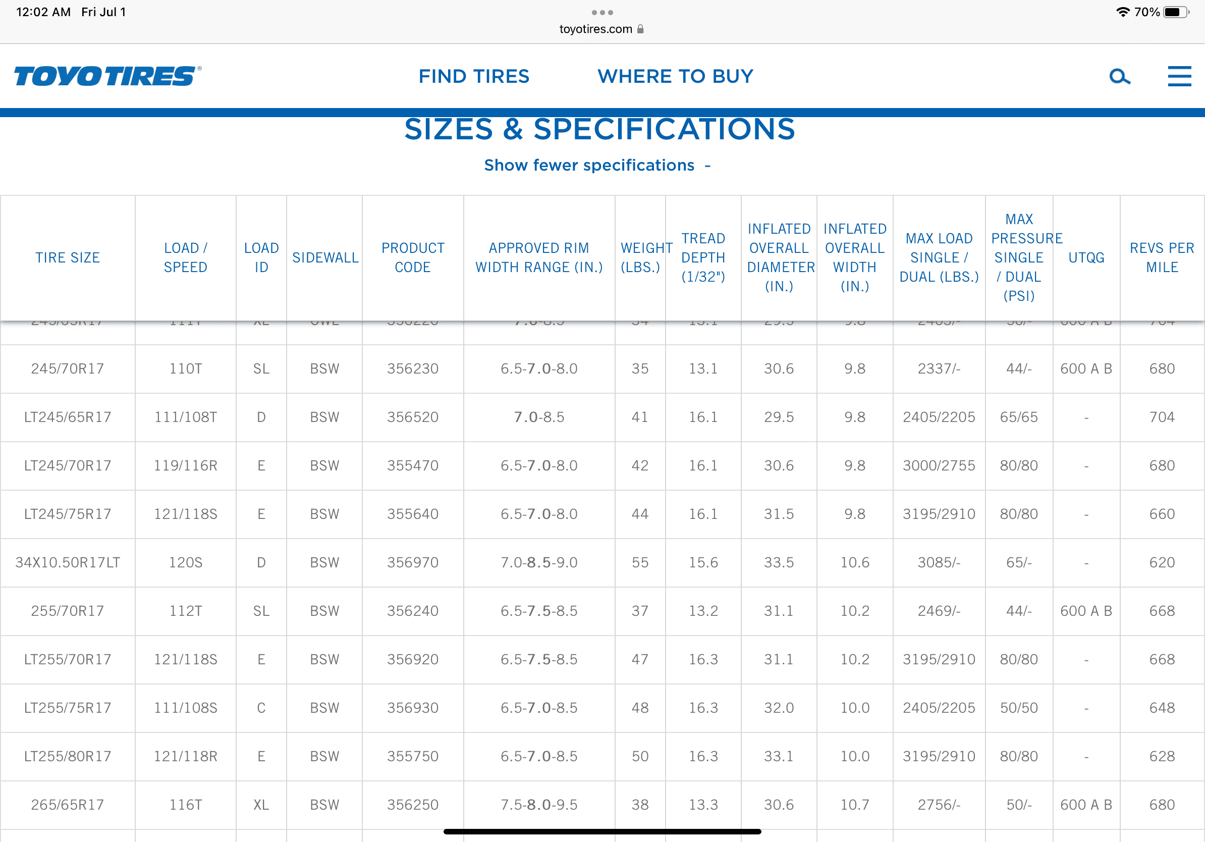

Could it maybe be that you’re getting more lateral flex in the sidewalls because the rim is kind of wide for that tire width? Your tire is only 1.5ā€ wider than the rim. I’ve never run a large diameter tire on wheels that were less than 2.5ā€ under the tire width. Right now, I’m running the same size rim as you with a 35x12.50 and don’t have any of that feeling even at 35lbs with mud tires that have large tread blocks. The stock Sasquatch wheels are a half inch narrower for a tire almost two inches wider. I’m no physics professor and probably can’t explain it correctly, especially without drawing pictures, but it makes sense in my little brain that you would get more side to side flex the more vertical the sidewalls are. It’s also quite possible that I’m full of shit and don’t know wtf I’m talking about.

It does list the 17x9 as the maximum approved rim width for that tire on the Toyo website, but I think if you went to a narrower wheel, it might take out some of the lateral flex in the sidewall.

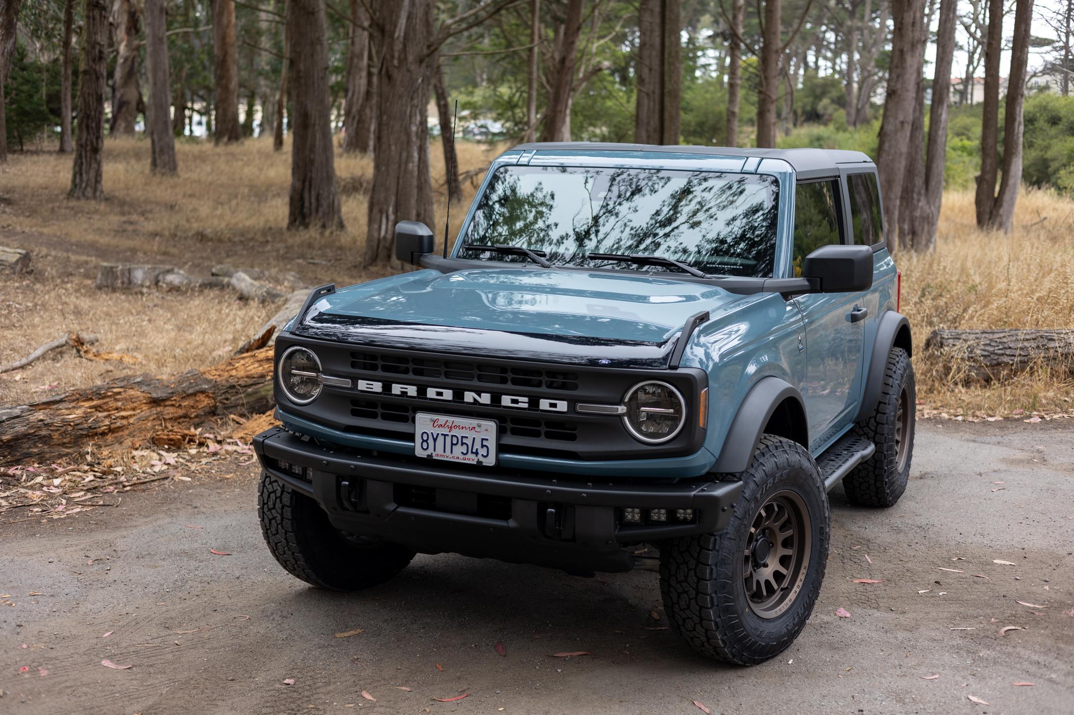

Hey everyone,
I just recently installed my new wheels and tires. I chose to go with 17x9 and 34"x10.5" Toyo AT3 D Load tires. I noticed today on the freeway around 70mph that it feels (for lack of a better term) kind of "squirrelly". This is on a Black Diamond with 1" leveling kit. It felt much more grounded with the stock tires.
Do you think it would be better with a slightly wider 285/75/17 or 285/70/17 which are about .7" wider? I drove a 3" lifted 4runner on 297/70/17 before this bronco, and it didn't feel loose like this. The bronco actually felt great on the stock tires, so I'm wondering if it's the narrower tires with increased height. Any insight is appreciated, thanks!
pic is for reference
