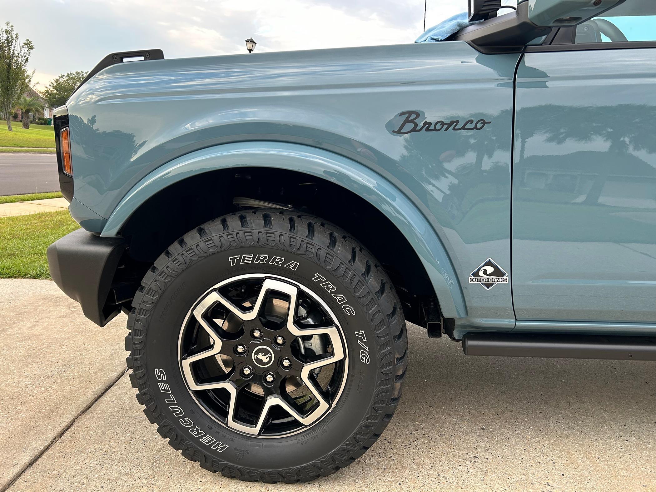

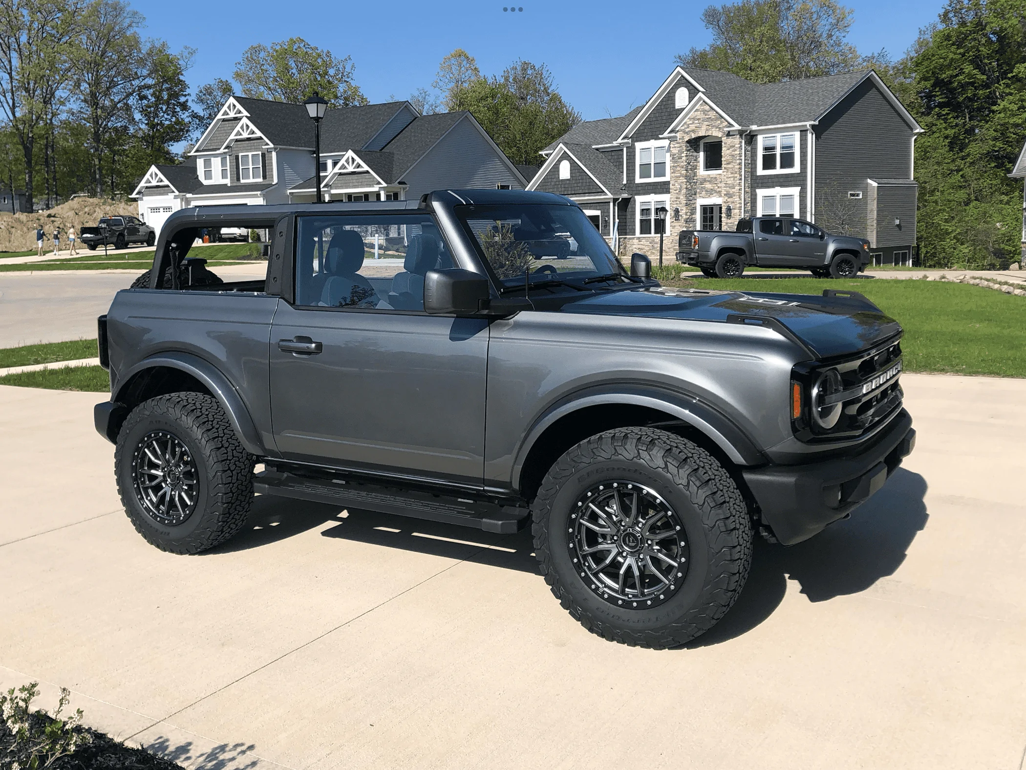

I own a 2 door, 2022 Outer Banks that has all stock equipment. It came with 32" tires. Does anyone know the largest size tire size that I can go with while keeping stock? I would like to go more aggressive without upgrading suspension. Thanks!

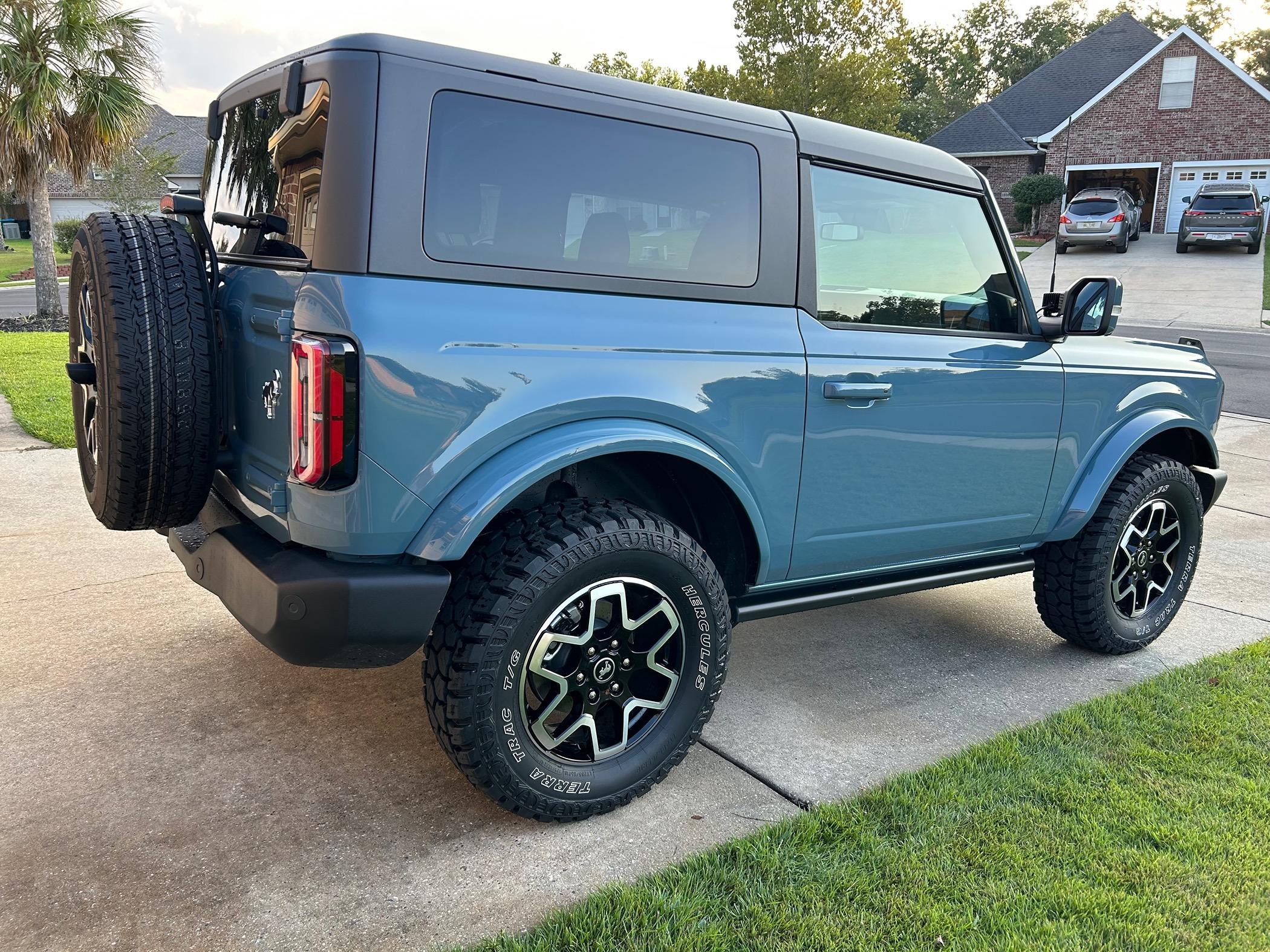

I have a OBX as well and I went with 17” wheels and BFG K02’s that are 315/70R17 which aren’t quite 35” - more like 34.5”. Crash bars removed. No lift or leveling and no rubbing issues this far. I first swapped to regular fenders (for aesthetic reasons) then needed the Sasquatch fenders due to a 0mm offset.

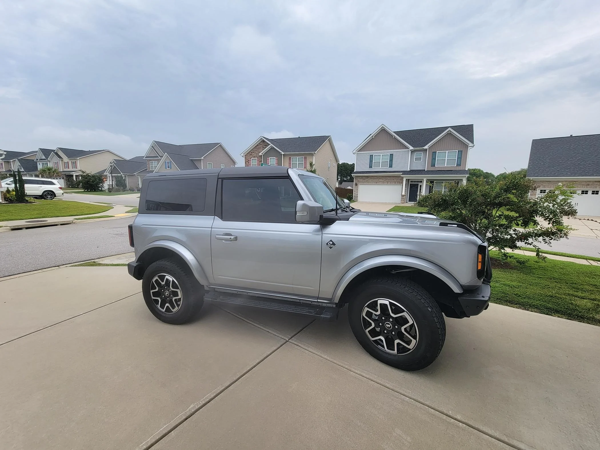

I went with 275/70R 18 on Fuel 18x9 rims +25 stock OBX no lift non Sas. W/ crash bars. I didn’t want to go bigger because the stock 3.73 gearing. I’m satisfied with the looks and performance, lost a little gas mileage.

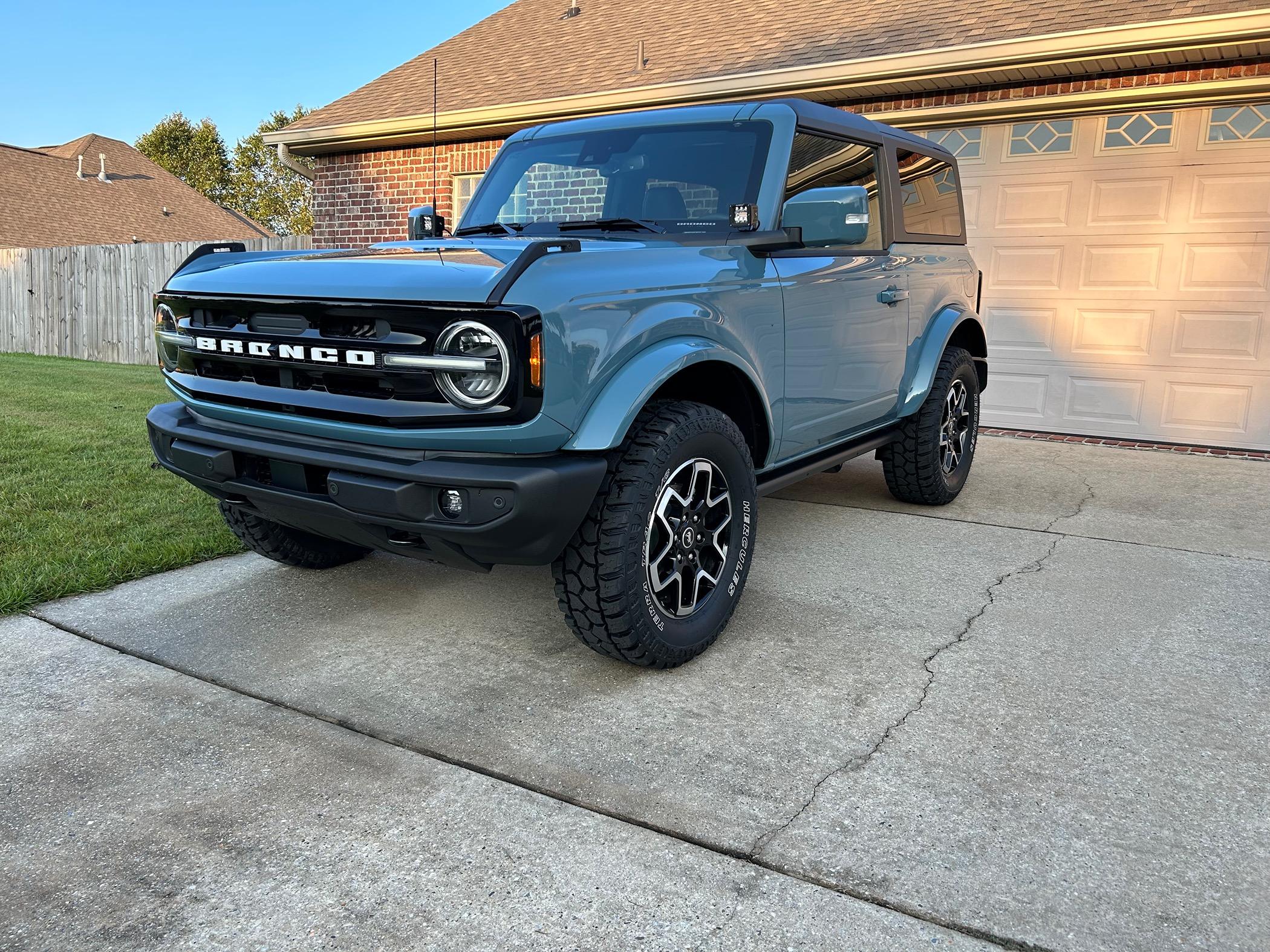

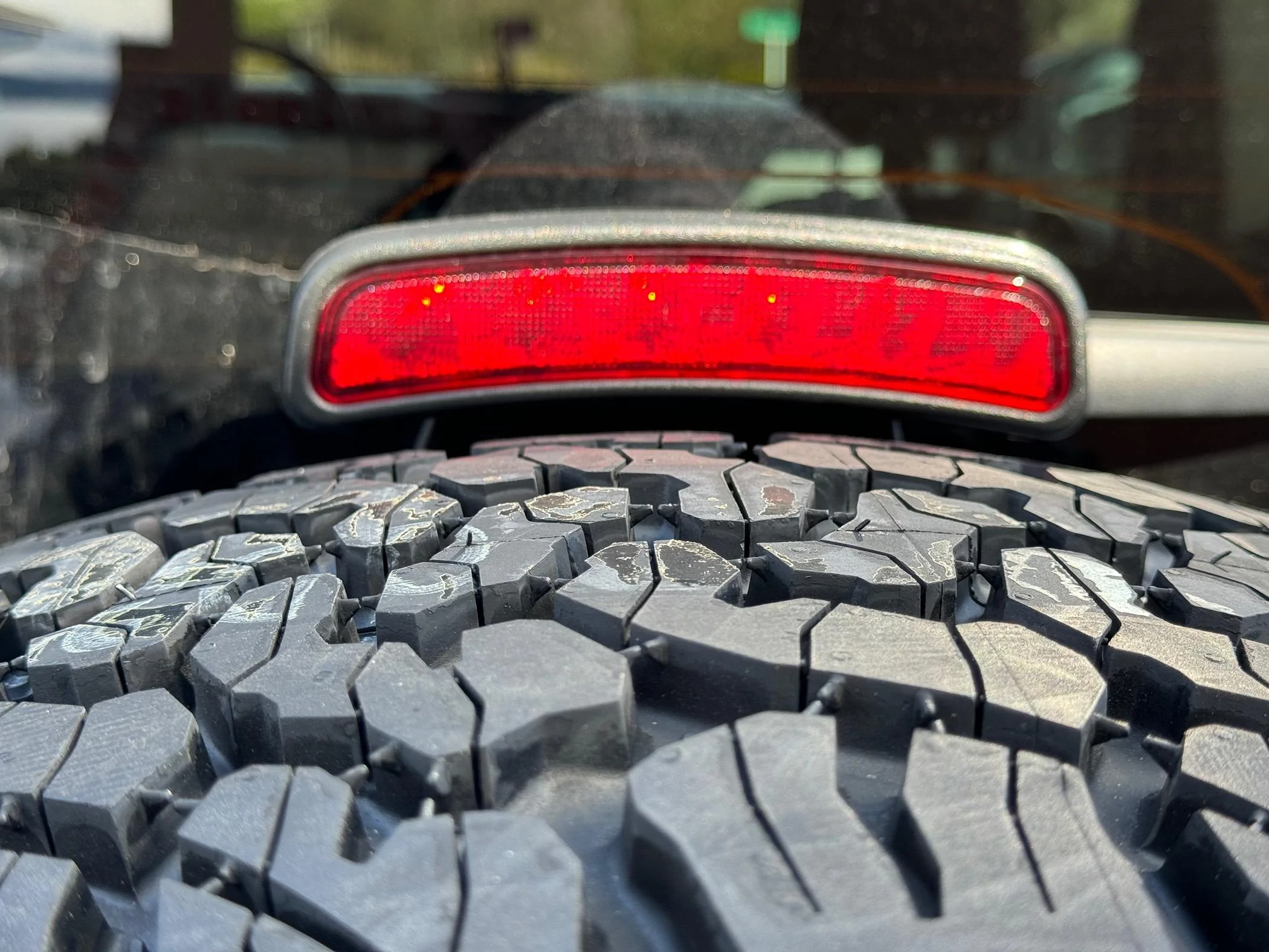

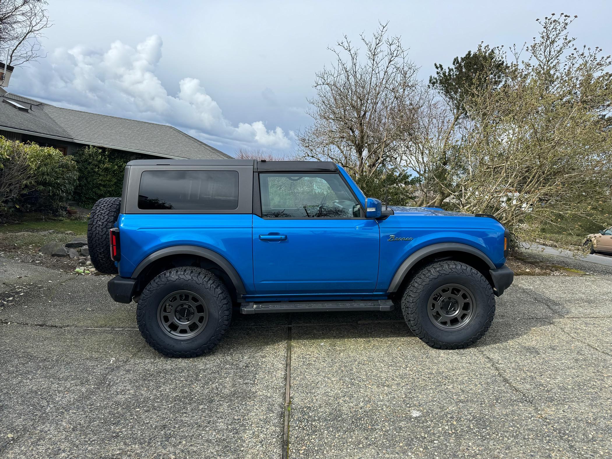

Before I put Sasquatch wheels and tires on I was running 285/65r18 and I felt they fit great with no lift plus it filled the wheel well. Definitely made a big difference in looks from stock.

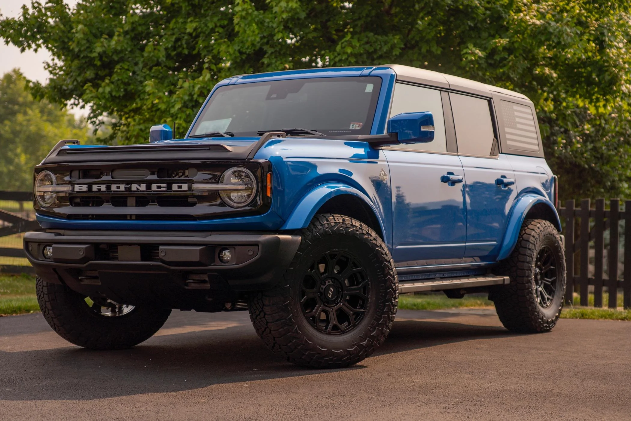

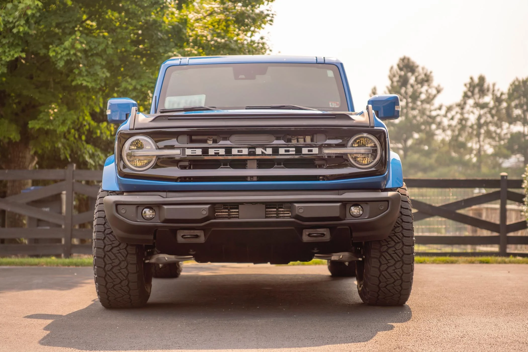

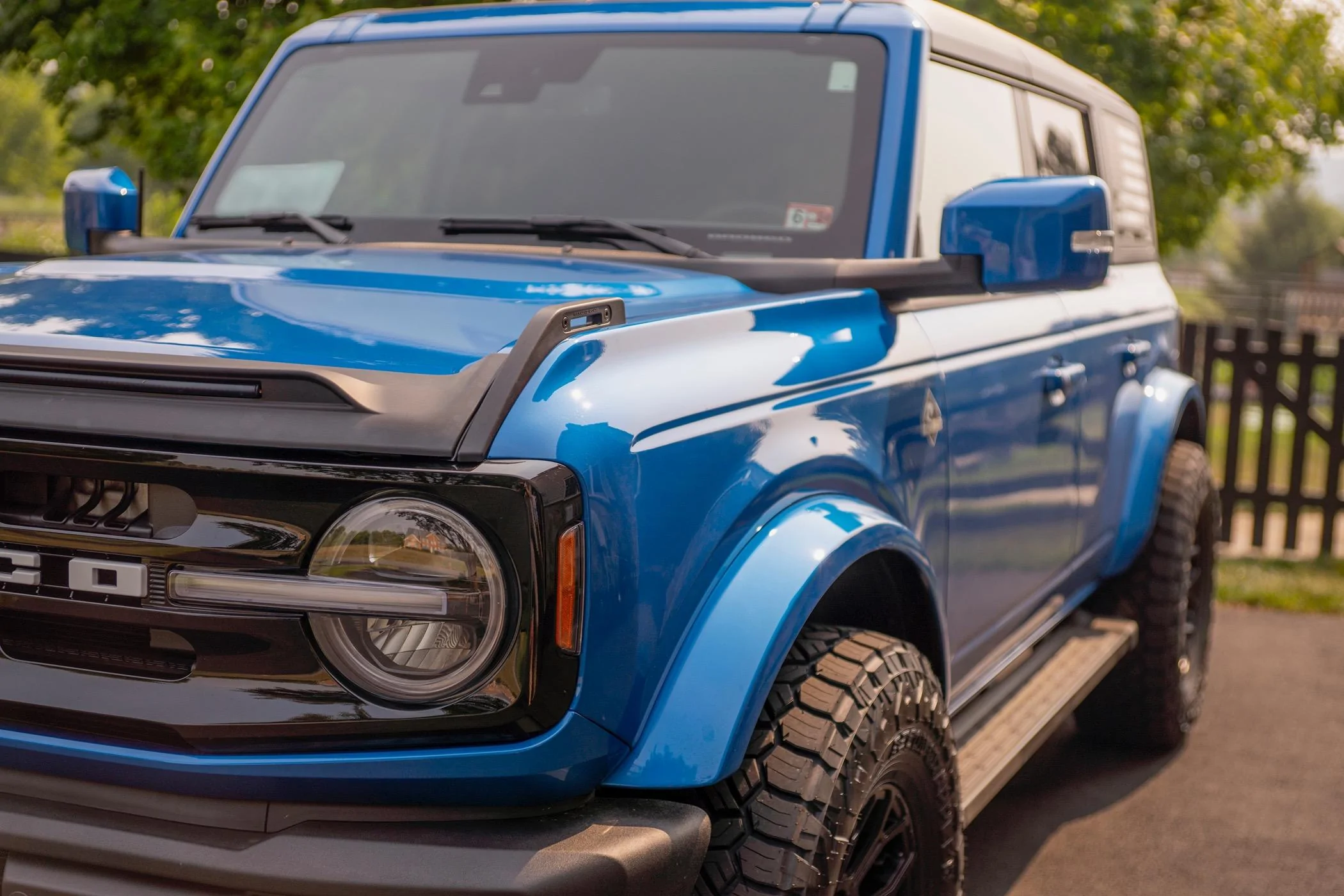

I went with 315/70/17 at +18. I have ONX as well and I’m really happy with the amount of poke.
