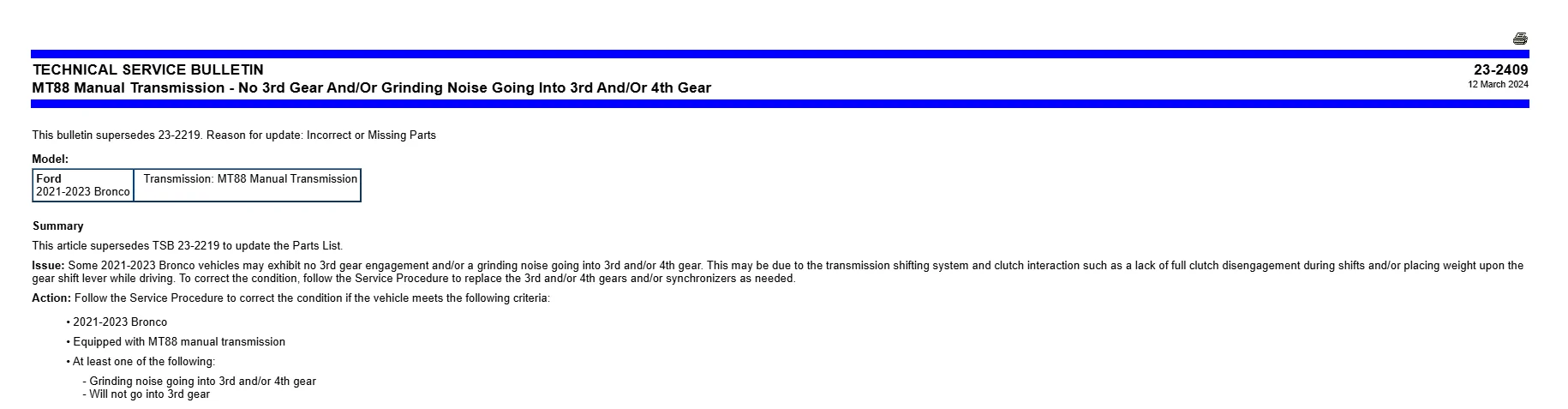

Third gear is grinding intermittently on my '22 Badlands 7 speed. 70K miles, and I'm not friggin' happy about it. What's the experience here with owners ??

Common problem. Sounds like it probably needs a new 3rd gear synchronizer.

Actually I noticed it from just a couple months driving it when first purchased. But it was so minor I thought maybe it was my fault, not fully engaging the clutch or my timing at the shiftstick ?
It started to do it more frequently the last 45 days or so and is getting worse.

Same thing happened to mine last year, at around 60-65k miles I believe. At first I thought I developed a habit of missing 3rd or getting lazy while shifting, but no it got worse to the point where I had to go from 2nd to 4th on purpose and vice versa. It's that TSB that @Ducati1098 was referencing. That should take care of it.
