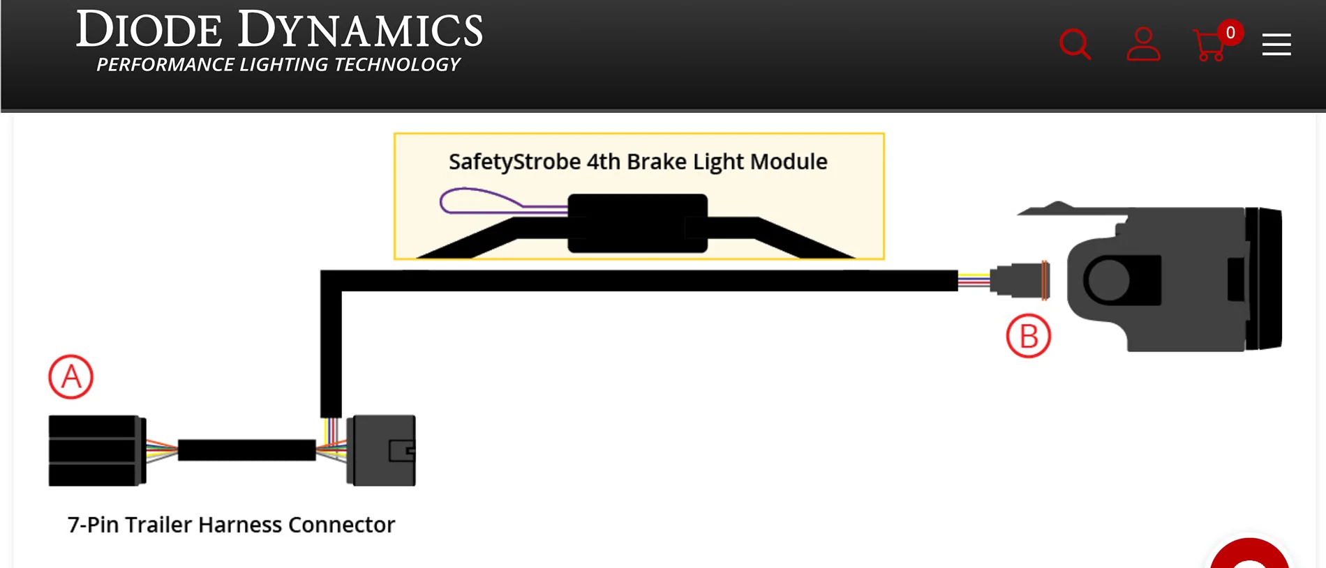

In the MOOOOORE light thread 'Let's talk lights. How much lighting needed? I need suggestions.' @Gluestick shared 'diode dynamics C1R' wiring that splits before plug, good product ... but diode dynamics is having error codes issues on Ford Bronco modules FROM mid 2024 - current

Not a problem… It’s clear Ford changed their tow package at some point, the VS2DZ-15A416-C states it’s for 2025 - current, but there are posts about Ford OEM shortages during the end of 2024 into 2025 model year.
Vehicle CAN bus (software coding) wiring in general and tow/trailer wiring is a long way from just tapping into a few rear lighting wires… lol Don’t think fixing software issues in trailer lighting functions is high on any OEM priority list…
The CR1 is nice that it’s in the wiring before the actual female connector… but Ford I’m guessing has ability to detect modifications in their wiring into that female connector… It looks like Diode Dynamics is using a miniature circuit to create a ‘third brake light function, like what I am about to try with the two relays. AND using the tow wiring allows for a lot of other lighting functions... My parts will be here soon so I can bench test my approach .

AGAIN my extra third brake light and rear chase lights are not being install on my bronco, it’s going on my cargo carrier and is removable so using the tow 7 pin works just fine for me…
Companies deal with a lot of OEM issues to insure their products work BUT …
diode dynamics C1R install instruction:
Step 5 - Test Function.
Verify that reverse and running lights function correctly. If your C1R includes a brake light, test that as well. Some vehicles may change trailer-related settings when a 7-pin is connected—this is normal. Power cycle your vehicle if the light does not turn on, and contact Diode Dynamics if issues persist.
Step 6 - Optional Red Wire Lead for Brake Signal Compatibility.
If your vehicle disables the brake light circuit when a trailer is detected, or if you experience flickering or trailer detection warnings, you may use the included red wire tap harness.
Disconnect the red AMP-style plug from the 7-pin harness. Then, connect the red AMP-style plug on the tap harness into the exposed port on the 7-pin harness. Cover the disconnected lead with the included cap and secure it out of the way.
Next, use the included T-tap to tap into your vehicle’s factory brake light wire near the tail lamp. Connect the wire lead from the tap harness to the T-tap. This will provide the C1R with a clean brake signal, resolving most compatibility issues.

Grab the Diode Dynamics SS10 Chase Kit. It plugs in-line to the factory tail light connector with our harness and gives you RUNNING, BRAKE, REVERSE and from your upfitter... CHASE light functions.
Make sure you add-on our KR Off-Road Brackets, as we're the only ones who currently make a U-Bracket to mount the chase light which simplifies installation
SS10 Chase Light: https://www.4x4truckleds.com/diode-dynamics-ss10-10-led-chase-light/
Harness (this will NOT work the chase light, but when we see you ordering the Chase Light we'll provide the right harness... this is a place holder for pricing): https://www.4x4truckleds.com/diode-...ight-wiring-harness-kit-for-2021-ford-bronco/

We actually offer the C1R for the Broncos. We provide an additional harness that utilizes the tail light for it's power feeds: https://www.4x4truckleds.com/diode-dynamics-hitchmount-led-pod-reverse-kit/
You just have to select FORD BRONCO in the drop down.
