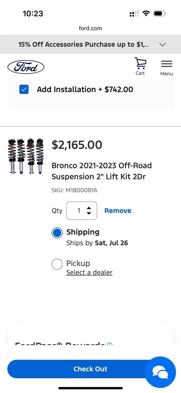

I have a 2 door black diamond that I don't drive enough as the Braptor has become my daily driver. The 2 door currently has the old Bilstein Sasquatch take-offs from a 4 door 2.7 and I really like the height it gives me but the ride quality is pretty stiff. Thinking of changing those to the Ford Performance 2" 2 door lift kit (Bilstein 2.65 monotube).
Does anyone have these, and if so how is the ride quality?
While I'm at it I will also upgrade to the sever duty steering kit, any opinions on that?
Lastly I have Icon Billet upper control arms that I've never installed, I will put these in at the same time.

It has 35s, I've definitely done some decent trails with no issues. My wife would like it to ride a little softer, think she feels they all should ride like my Braptor :) I'll look into the Eibach's that you mentioned. Main thing is I already own the UCA's and I got a a couple grand in Ford Pass points so the cost of all of this would be minimal.

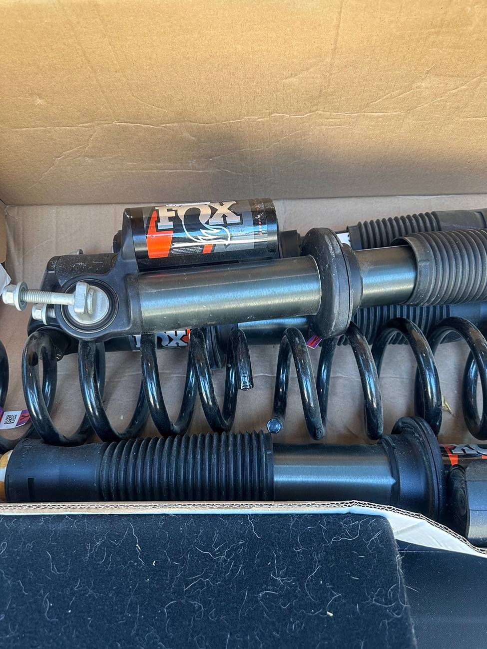

Purposely did the 4 door with the larger engine to make up for my winch and ensure a good height. Think I found a solution today, gonna give it a try
Ford Bronco Thinking about some suspension upgrade, opinions? IMG_9874
