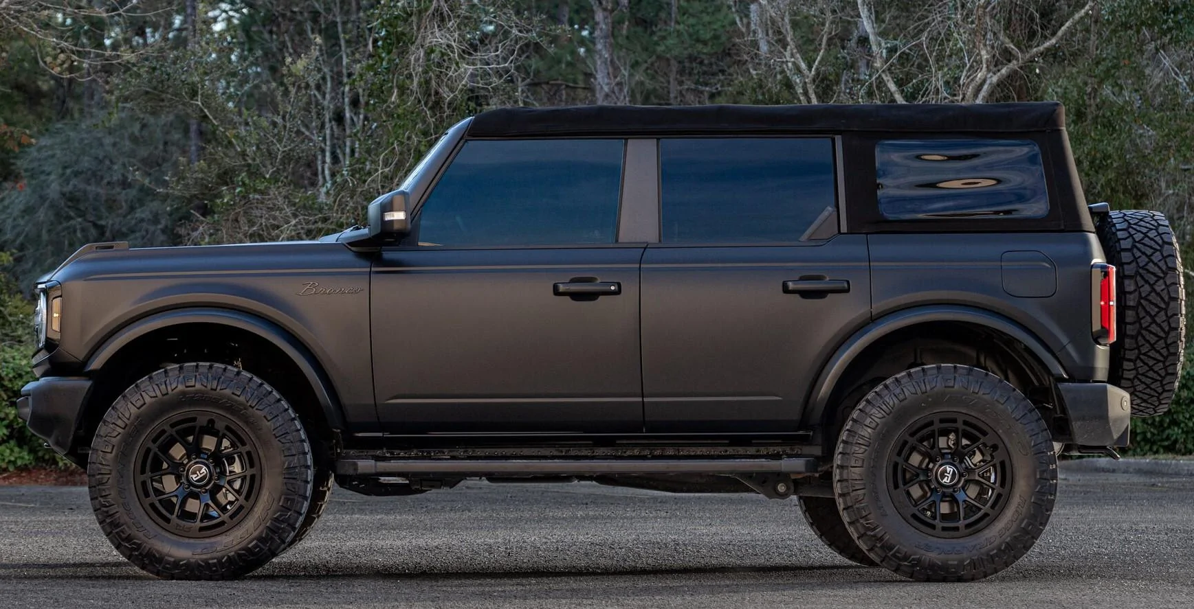

I need to be educated.
When I first received my Bronco (Outer Banks Non-sas) I put a 2" Rough Country spacer lift on it to fit 35" tires. Since then I am somewhat unhappy with the ride, both on road and off. I have about $900 worth of Ford credits to use. I've seen several different options that I could purchase from Ford like a Bilstein 2" Ford performance lift and the HOSS 3.0 package.
Go ahead and assume I know nothing about any of this. What is my best option here?
