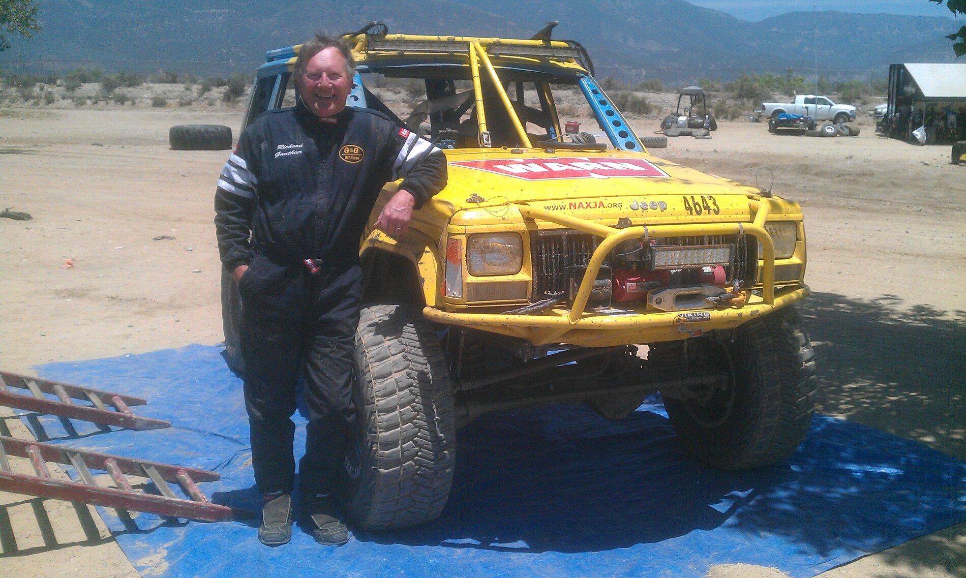

Our 4600 car had 11" travel in the front and 12.5" travel in the back, and two full days of shock tuning, and I would never drive the Bronco close to as fast as I drove that car. It will be my daily driver and I don't want to barrel roll it. We rolled the 4600 car a number of times, if you're going to go really fast it is just a risk. I also don't want to daily drive a lifted car, and my wife needs to get into it. So, like I said, lots of things are possible, but what do you want and how much are you willing to spend.
