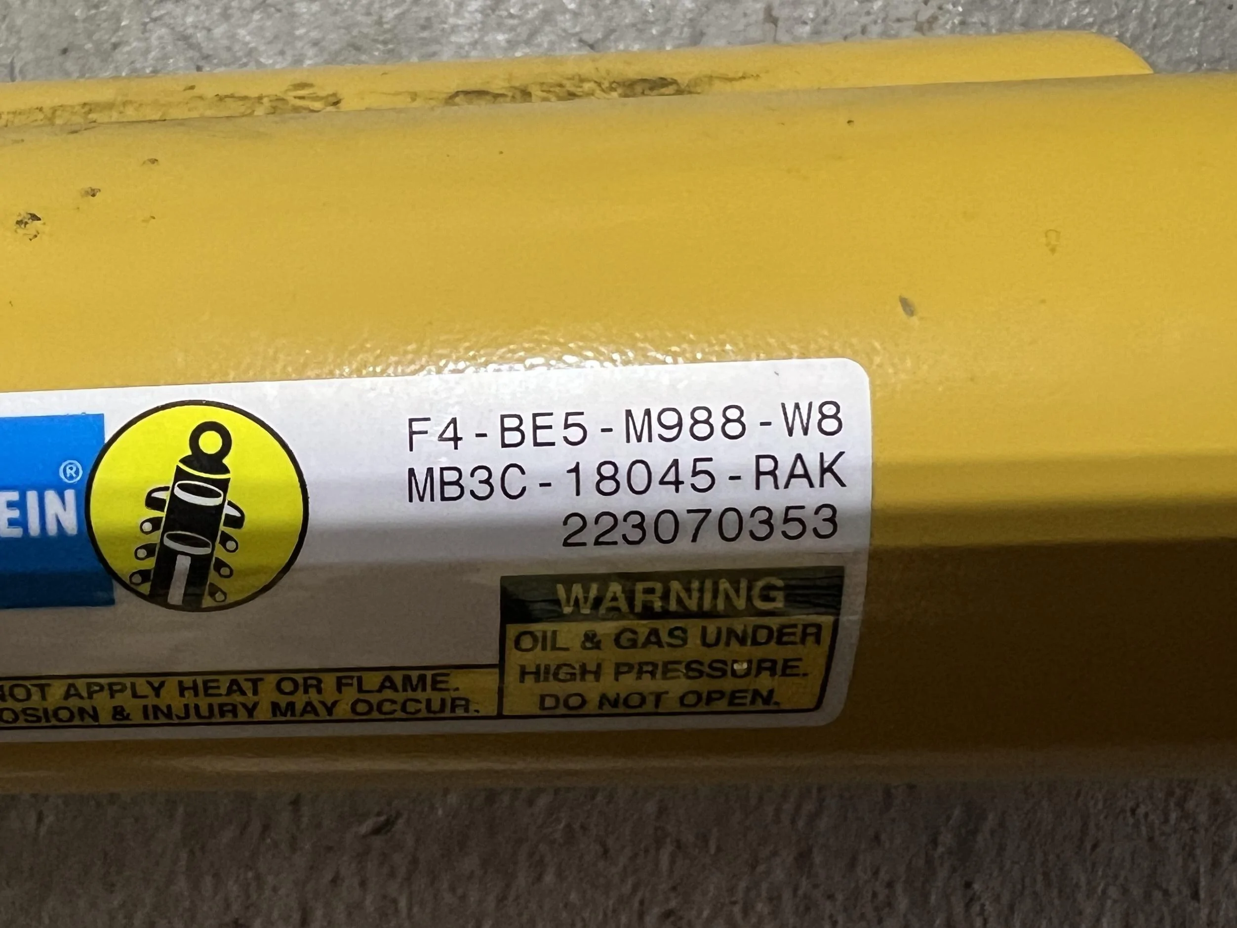

I have been searching FB Marketplace for shocks and springs but I run into part numbers that I can not reference in the information above in this thread. Some of the part numbers I am unable to find on Ford Parts searches also.
Am I using the information in this post incorrectly? What am I missing?
