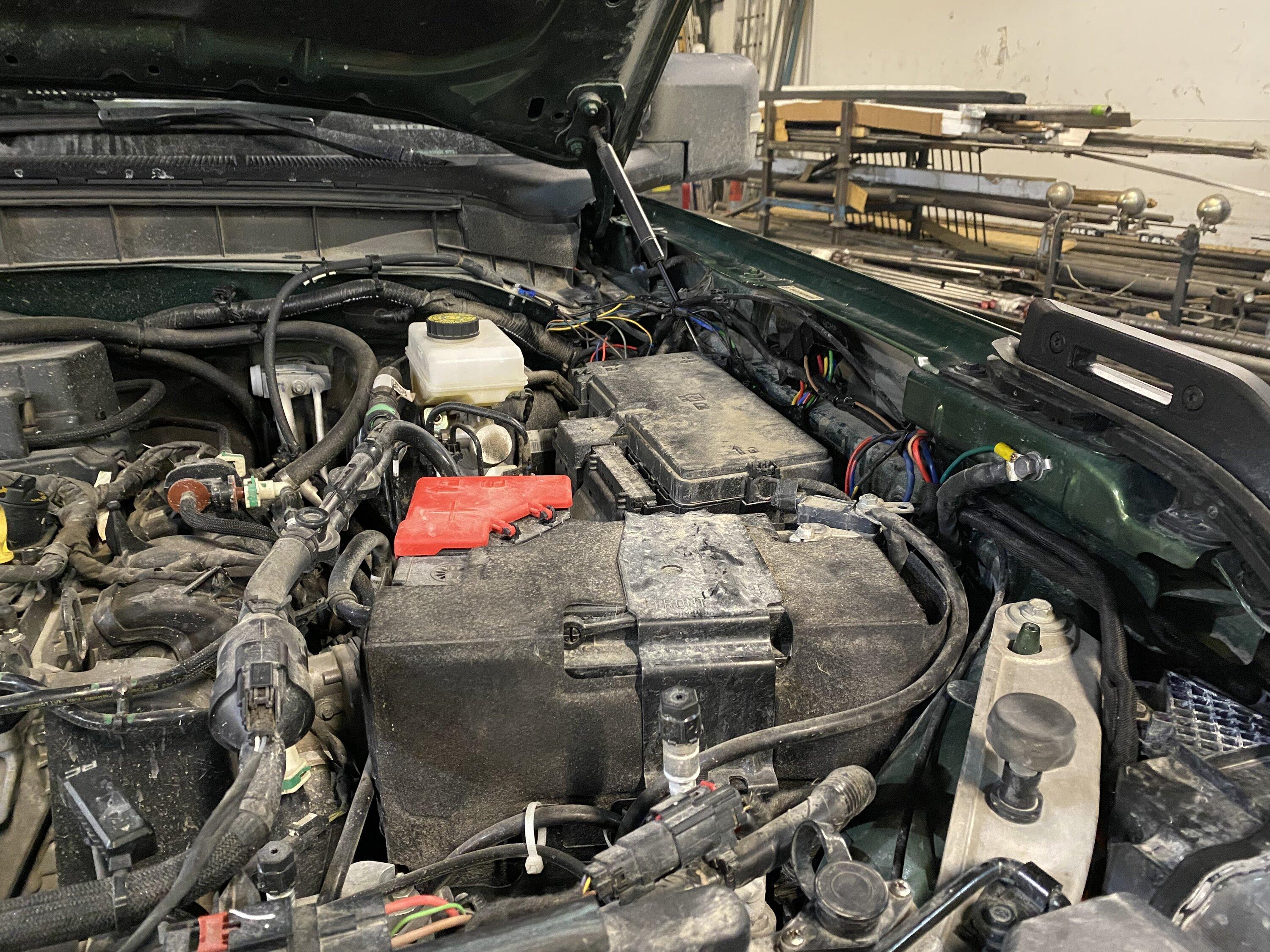

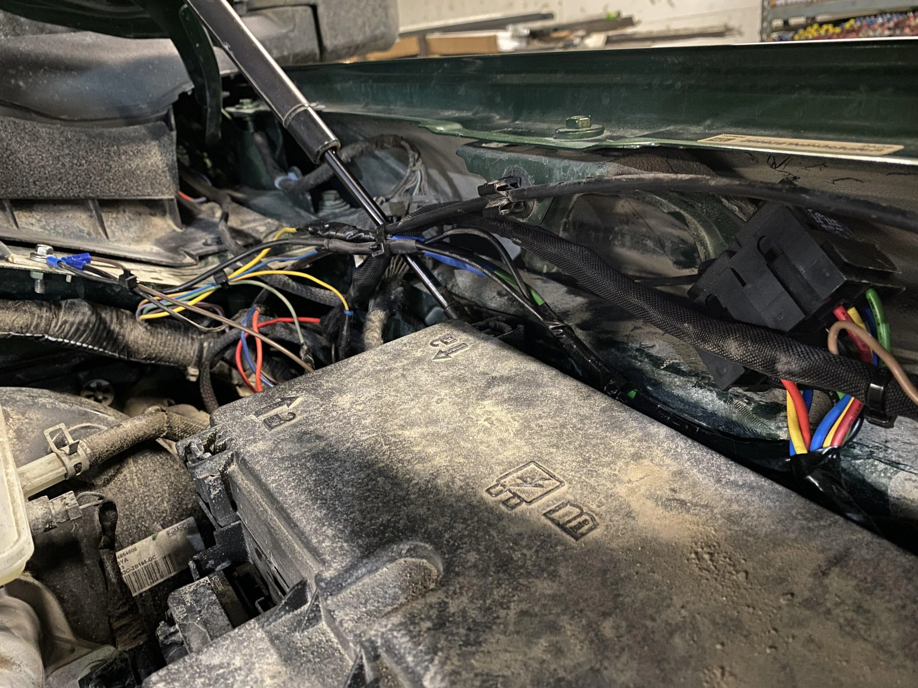

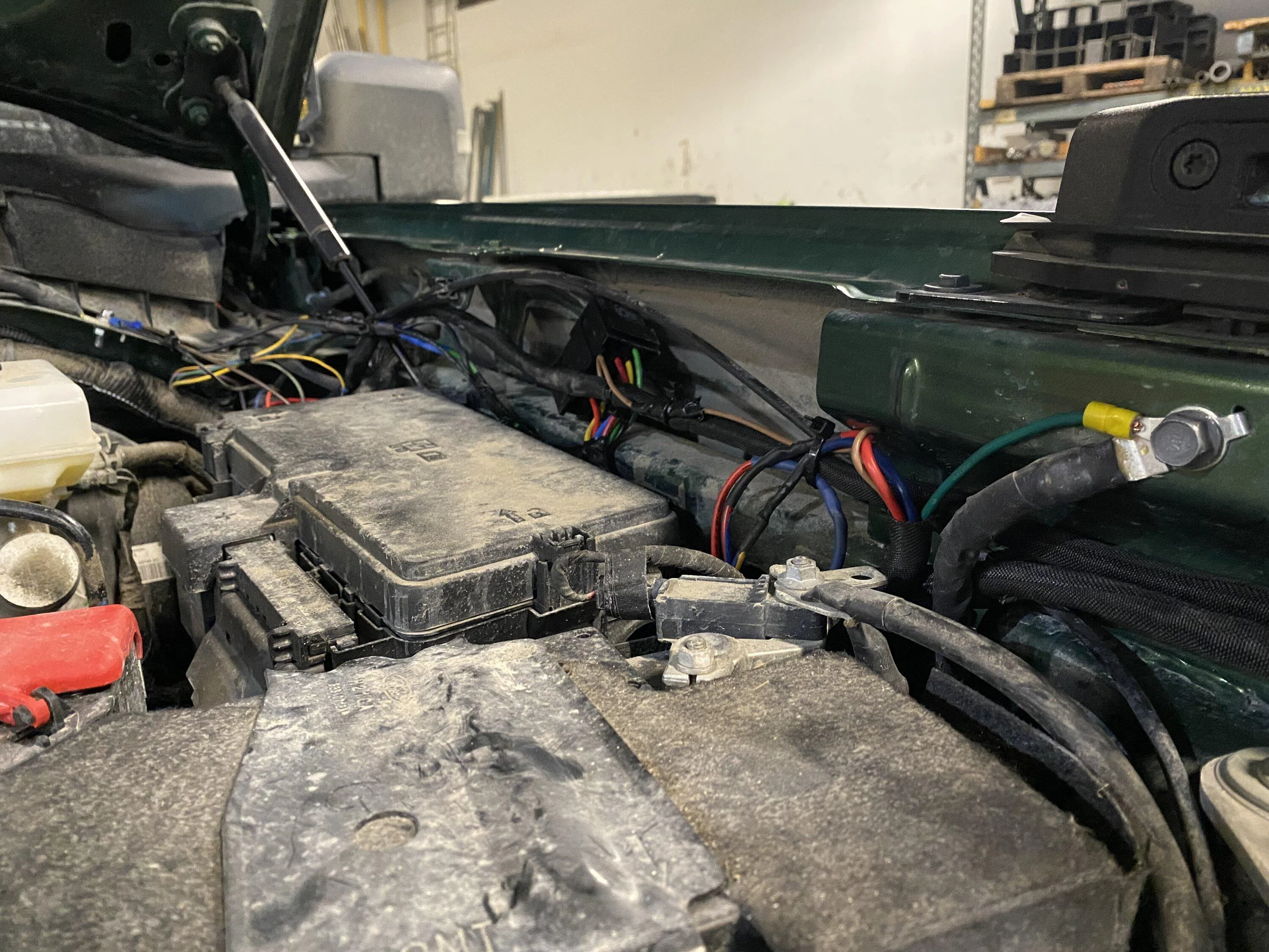

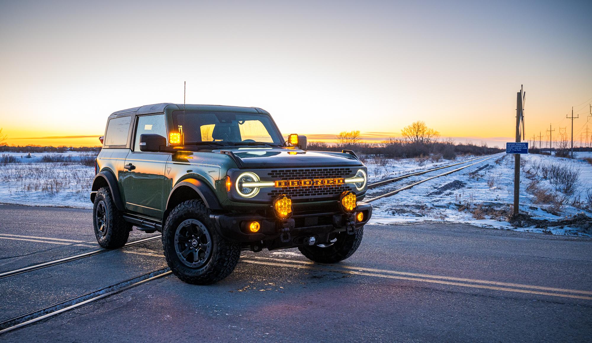

In the evenings I prepped the Relays and wiring harness for the LP9’s.
Ford Bronco The Boreal Badlands FEE531FA-4BB5-4631-B8C3-9C053A2E4C08

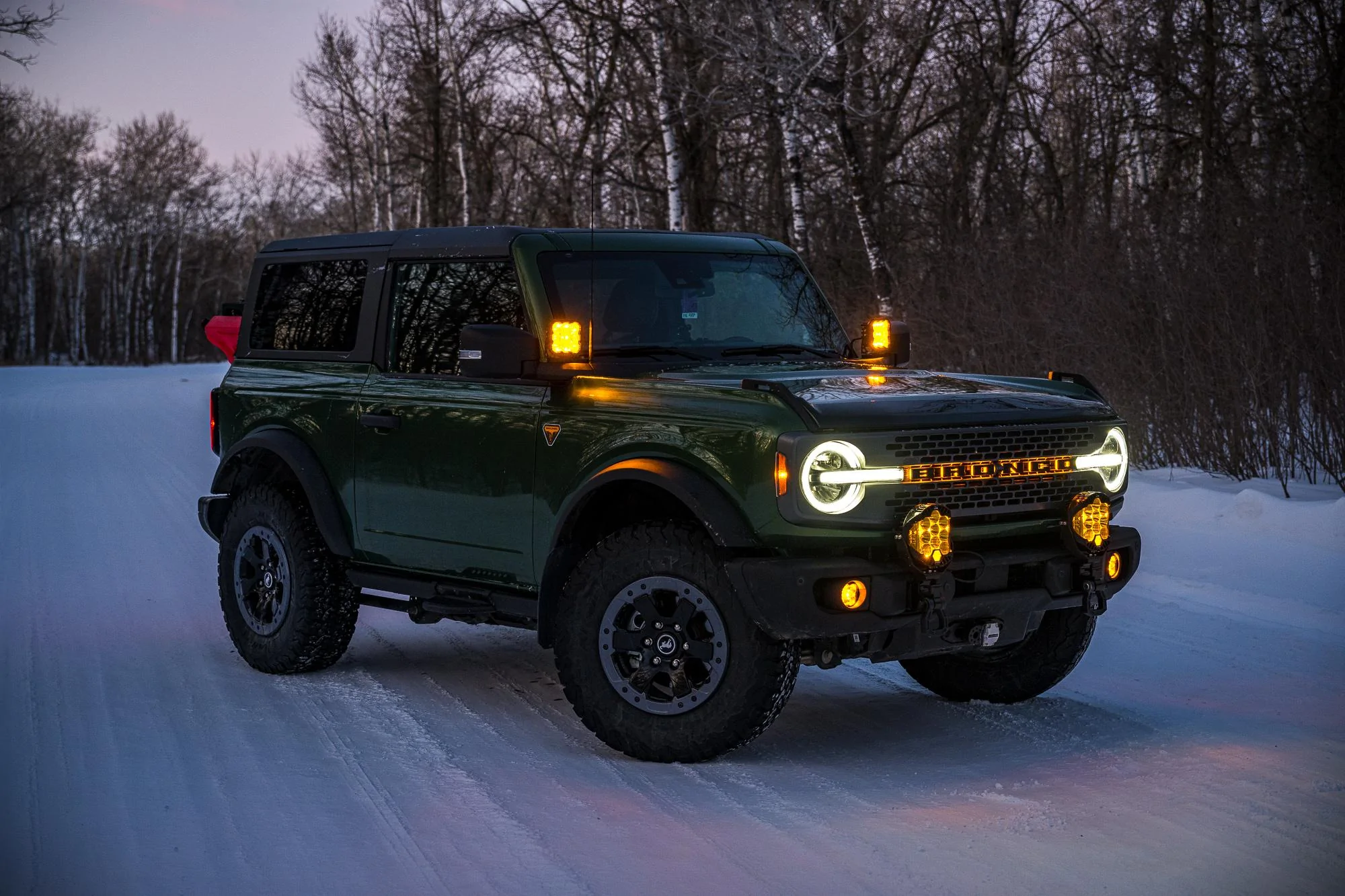

I finally got the @ORACLE Lighting Grill letters swapped on. Unfortunately the N was chipped (sharpied in the missing paint) and the primer wipes were bone dry. A few of the plastic weld holes needed to be opened up to avoid stressing the wiring or sticking over it… elongated if you will…. I threw a .25” endmill into the drill and relieved where necessary. Soldering in the letters to make their own harness, I melted a hot glue stick to get everything routed cleanly and oriented
Ford Bronco The Boreal Badlands 4C3BE564-7D38-4B98-AC2F-7BE44786E176
Ford Bronco The Boreal Badlands A6A47FAD-D58C-4D9C-9E0A-7C994A6D918C
Ford Bronco The Boreal Badlands A247764E-710E-43D3-A455-AD0B38663BF3
Ford Bronco The Boreal Badlands 87AF3D32-9A24-4F97-900E-C28C2B3314F1
Ford Bronco The Boreal Badlands 656B2AAC-2422-4EA5-9396-7F71936FA574
Ford Bronco The Boreal Badlands FCCECC13-52C5-4818-AE4D-F1C0CF2A0A13
Ford Bronco The Boreal Badlands FD14B098-3C41-4382-8A5E-4DBAC1B7051F
Ford Bronco The Boreal Badlands F1C8ACBC-B295-410A-BC09-4BDBB5D7FA81
Once the letters were in, I popped off the flares and removed the lower trim under the grill. It snapped out real easy with a panel tool. The LP9 Harness is ran within, the Deustch pigtails will pop out at the exact length and position to mate up with the lights! Custom and Clean install is always nice. I don’t have much to share on the harness photo wise, I was lost in the process.

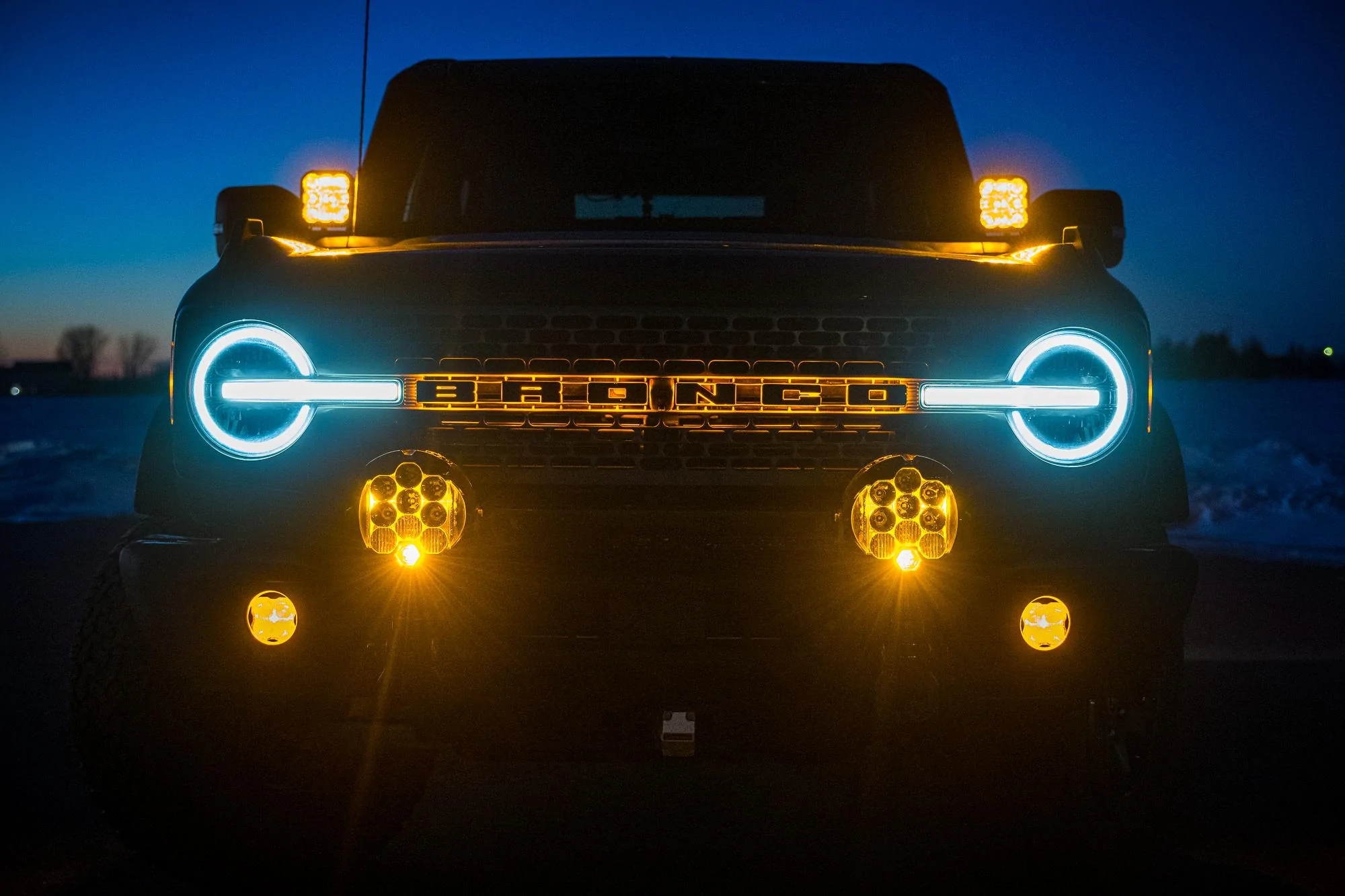

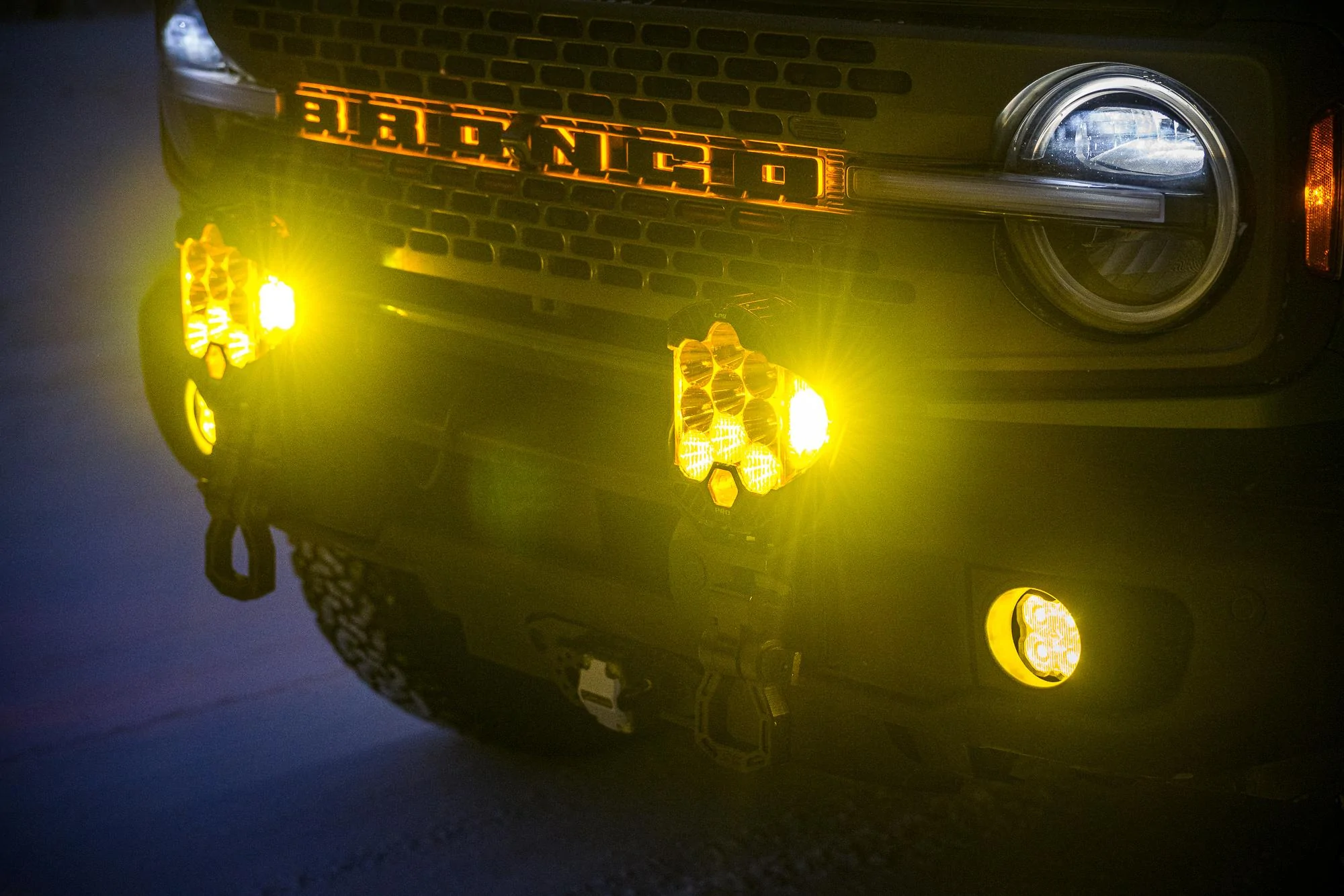

Alongside the LP9 Prep, I finally wired in the SS3 and SS5 DRL’s. With the Oracles, I tied them into Aux 6.
They look even better at night
Ford Bronco The Boreal Badlands FEF91FFE-B740-425A-894F-8CA734E34E40
Ford Bronco The Boreal Badlands 56331054-0842-4D3A-878A-7E2E46BC08FC
After hooking everything up I went home and noticed the Pass. Fog lamp was not working. “Its on the list for tomorrow”, I guess. All I can say is it’s good that I addressed it sooner rather than later. The insulation had rubbed down, the wire had corroded and the remains were smoking under use… shit
Ford Bronco The Boreal Badlands BCCEDC88-D84D-4632-B1C7-26D7EFAD8931
Ford Bronco The Boreal Badlands E990DC13-04E7-4D40-BD3F-143245C019A1
I cut out the bad, and soldered in some new. Secured both sides with some zip ties and called it a fix. Disaster avoided. #stancypants

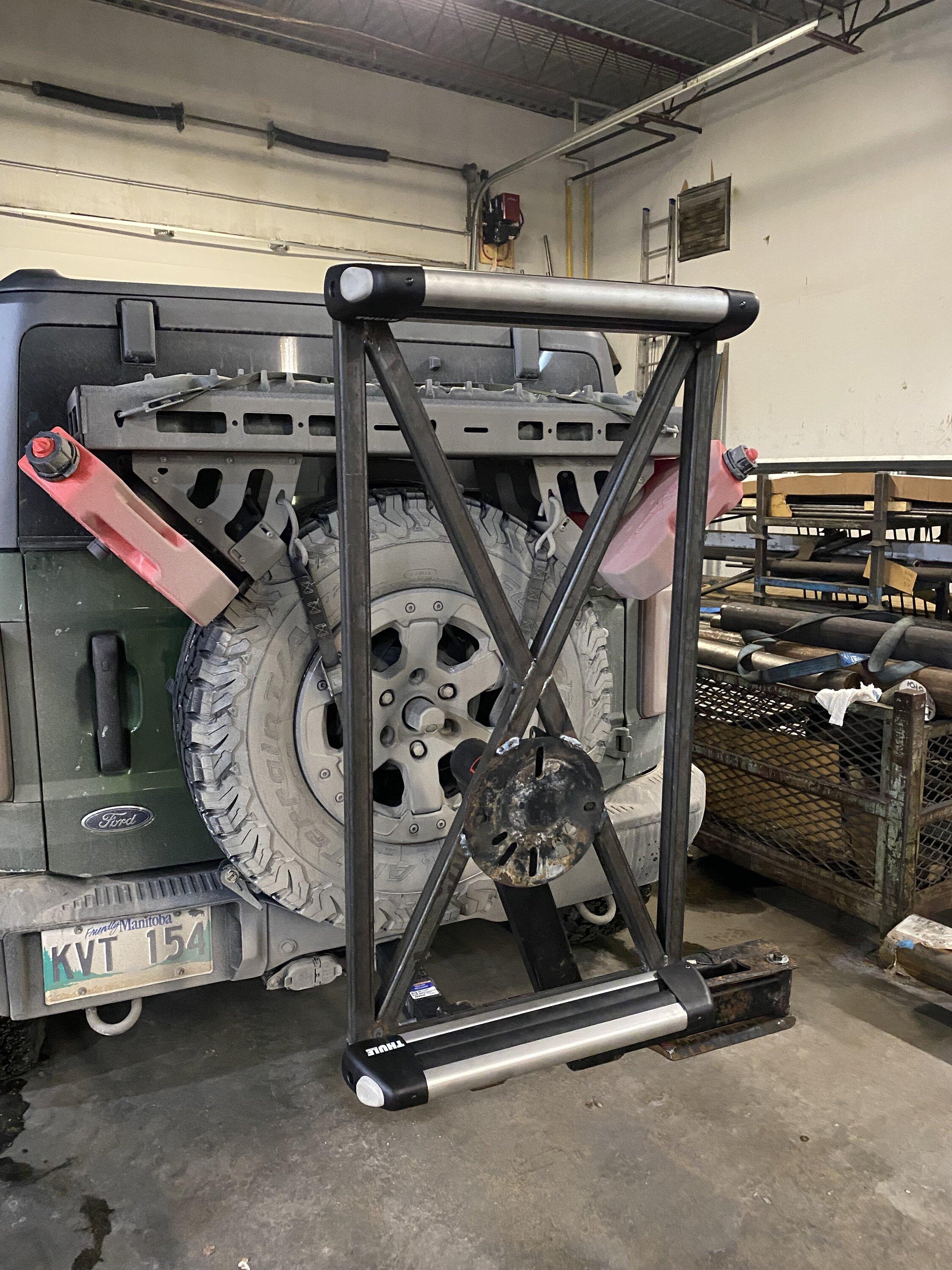

This week I need to pick up the hitch extension, fab up the mounting point for the snow gear carrier, and hopefully get the prototype light mounts back from powder to start testing!

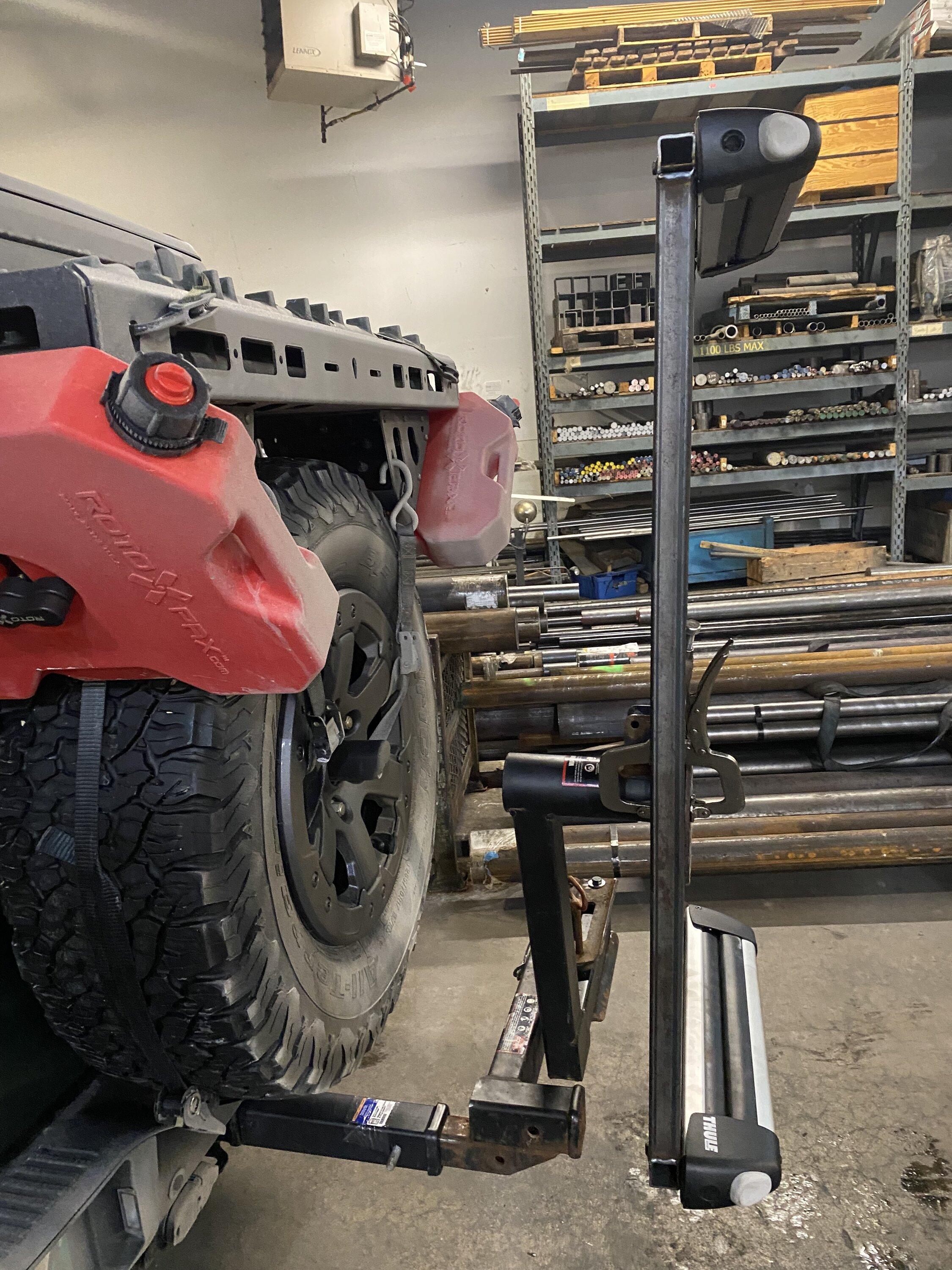

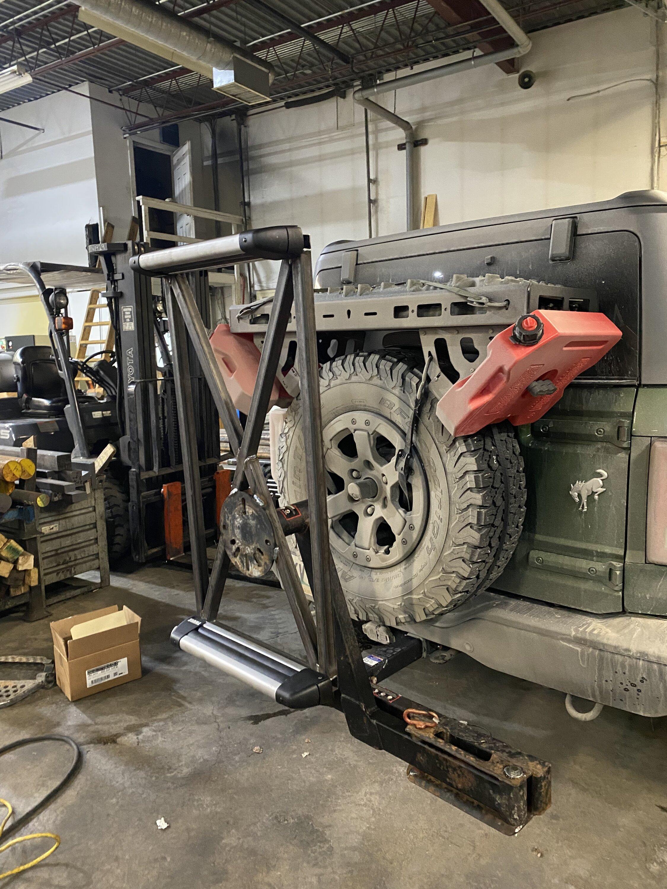

Its coming together. A whole lotta shop time this week. Amongst the chaos, the Wilco Hitchgate that was on the Forester was refreshed and repurposed.
Ford Bronco The Boreal Badlands IMG_9546
Ford Bronco The Boreal Badlands IMG_9551
Ford Bronco The Boreal Badlands IMG_9552
Some IAG goodies showed up. I quickly swapped the steps out for the fresh set. The seatback protectors were tough to find at a reasonable price last time I looked (Canada), I saved some bucks getting them on the I-Line and bunched into the shipment. The Interior LED kit and doors-off footpegs were tossed in the mix.
Another run to Princess Auto tomorrow to get the last bit of parts needed to tighten the assembly up for the snowboard/ski trip that's on the horizon!

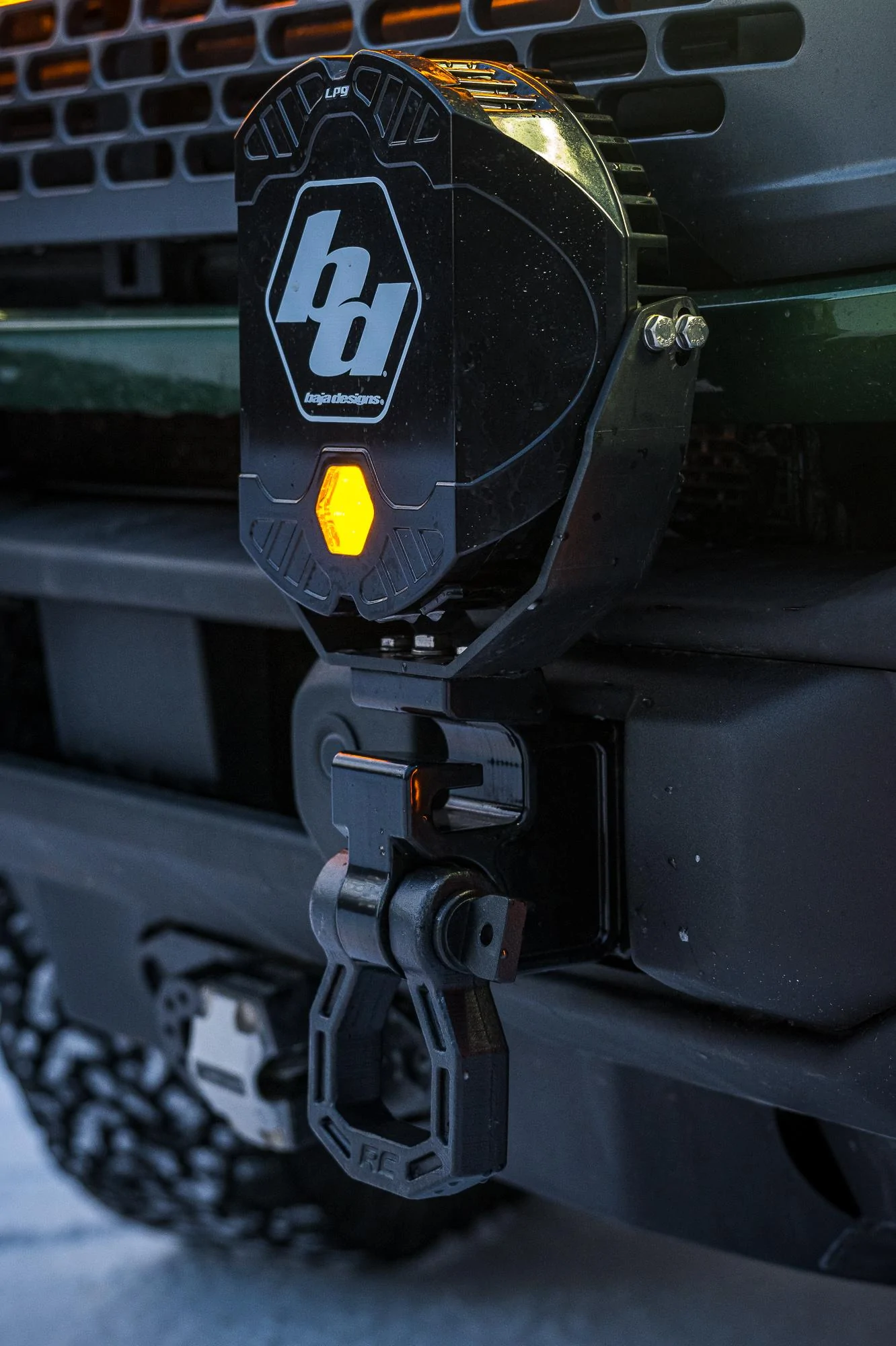

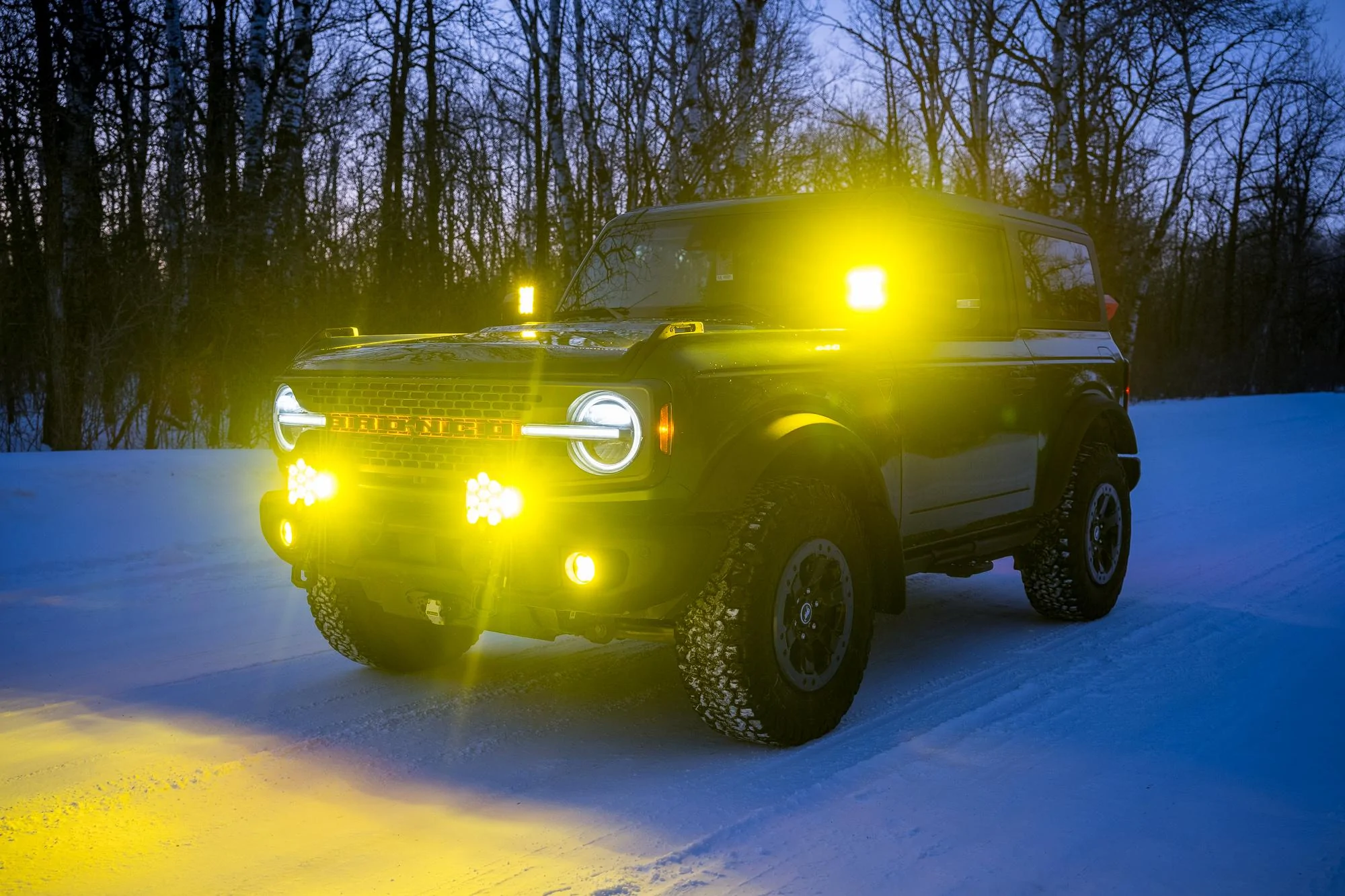

FIRST LOOK AT THE CAPABLE LIGHTMOUNT!!!
Ford Bronco The Boreal Badlands 3C492E38-B953-472D-8382-B0DCEC8146B3
After the Bronco threw its code, and Woodridge Ford/Lincoln in Calgary helped with the due diligence check over, I drove 13 hours home… rolling in a few hours later and redbulls deeper than expected. There haven’t been any issues since. The following day, I brought the rig to work, swapped the oil back to the 5w-30 (now that we are out of the deep cold and headed into spring). To be doubly sure about the cause, I popped the airbox cover off and the Air Filter was partially snowy with a layer of ice in the bottom of the box - plugging the drain. Perhaps the air filter got a tad frozen causing an air restriction that inevitably threw the code?
Before I left for this little boarding excursion, the v1 Recovery/Light Mounts came back from powder coating! While the powder was being applied, I created the light harness and routed it through the front end of the bronco… almost completely hidden. The LP9’s require pins 3 & 4 not to be energized simultaneously. I didn’t want to plumb in a double pole double throw switch, but I wanted to utilize the factory auxiliary switches. To do this I wired in two relays where the power output of the second relay routed (87 and 87A) is able to turn on each circuit as required without energizing both at the same time. You can trigger auxiliary one to fire the low beam of the pod light, and auxiliary two triggers the high beam. The benefit of this set up is that you must trigger low beam auxiliary in order to energize the pods at all, so you could leave the high beam on if you’re using it frequently and just flash Aux one on and off as a main power switch as needed.
Ford Bronco The Boreal Badlands DF771E5E-7545-4517-9935-C365BA03B250
Ford Bronco The Boreal Badlands 328EC83D-0EFB-429A-B506-4D9878F43A43
Ford Bronco The Boreal Badlands C1016154-DA9A-4D7F-B880-D9211099B5DE
Here’s a little sneak peak of what’s upcoming. These are v1 light mounts, of what I am looking for in this product. V2 should be even better… perhaps there’ll be a “Street Tier” and an “Off-road Tier”…
Ford Bronco The Boreal Badlands 88F42123-862F-451B-AC8D-7CE8BA769BA8
Ford Bronco The Boreal Badlands 12448D81-B657-4024-9675-F9DA04B4CE91
Ford Bronco The Boreal Badlands 3C013AAB-83EC-4380-808F-8D9EB679115A
Ford Bronco The Boreal Badlands 9B888240-3C36-450F-9767-7F1C82FE8474
Ford Bronco The Boreal Badlands E3F8899B-CC7B-4295-A03A-F553062BD26C
Ford Bronco The Boreal Badlands 28F21DA1-B1E7-4BC7-8B83-CBE92338477D
Ford Bronco The Boreal Badlands 6C58C07F-6735-4D38-BE14-CBD2230BA93C

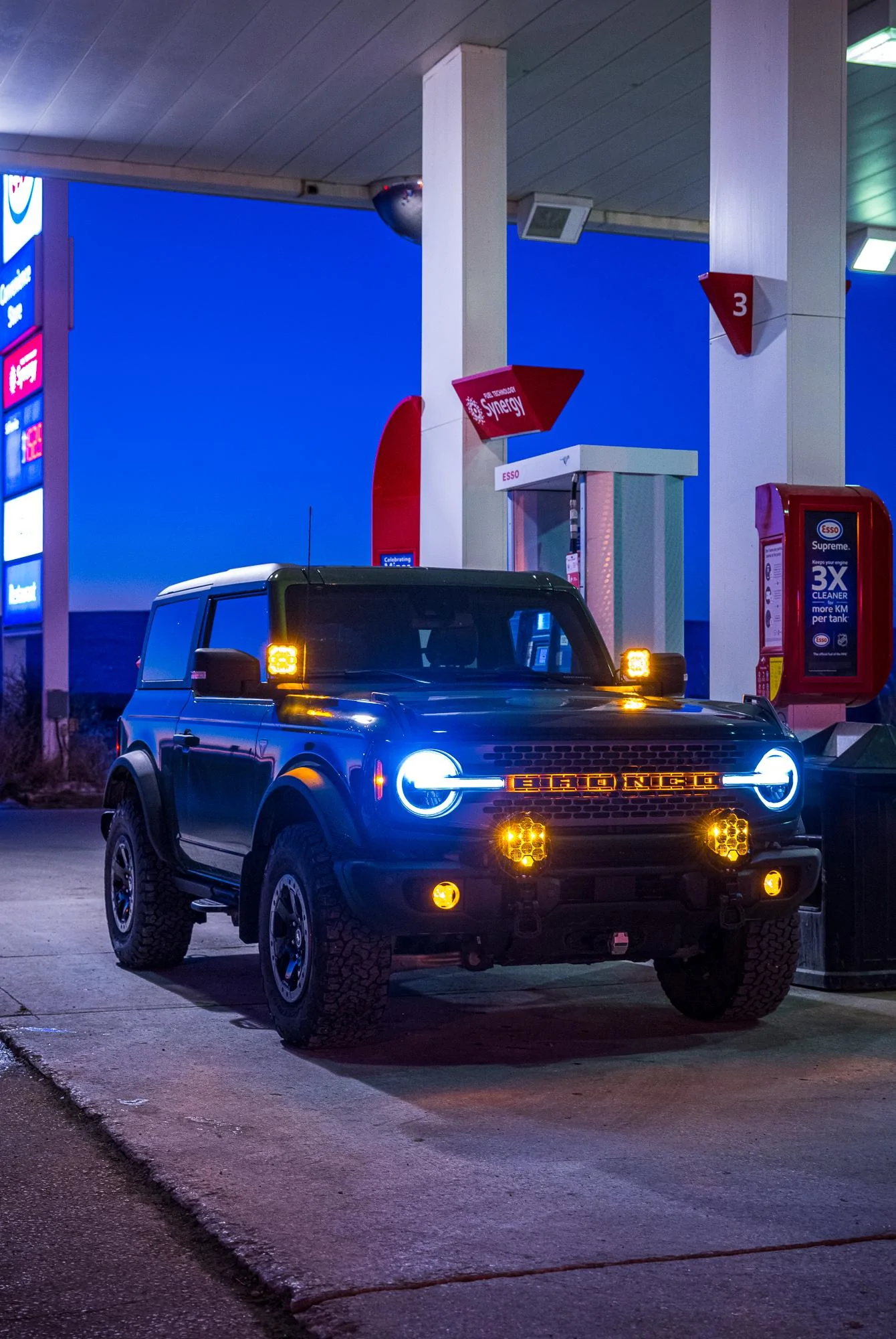

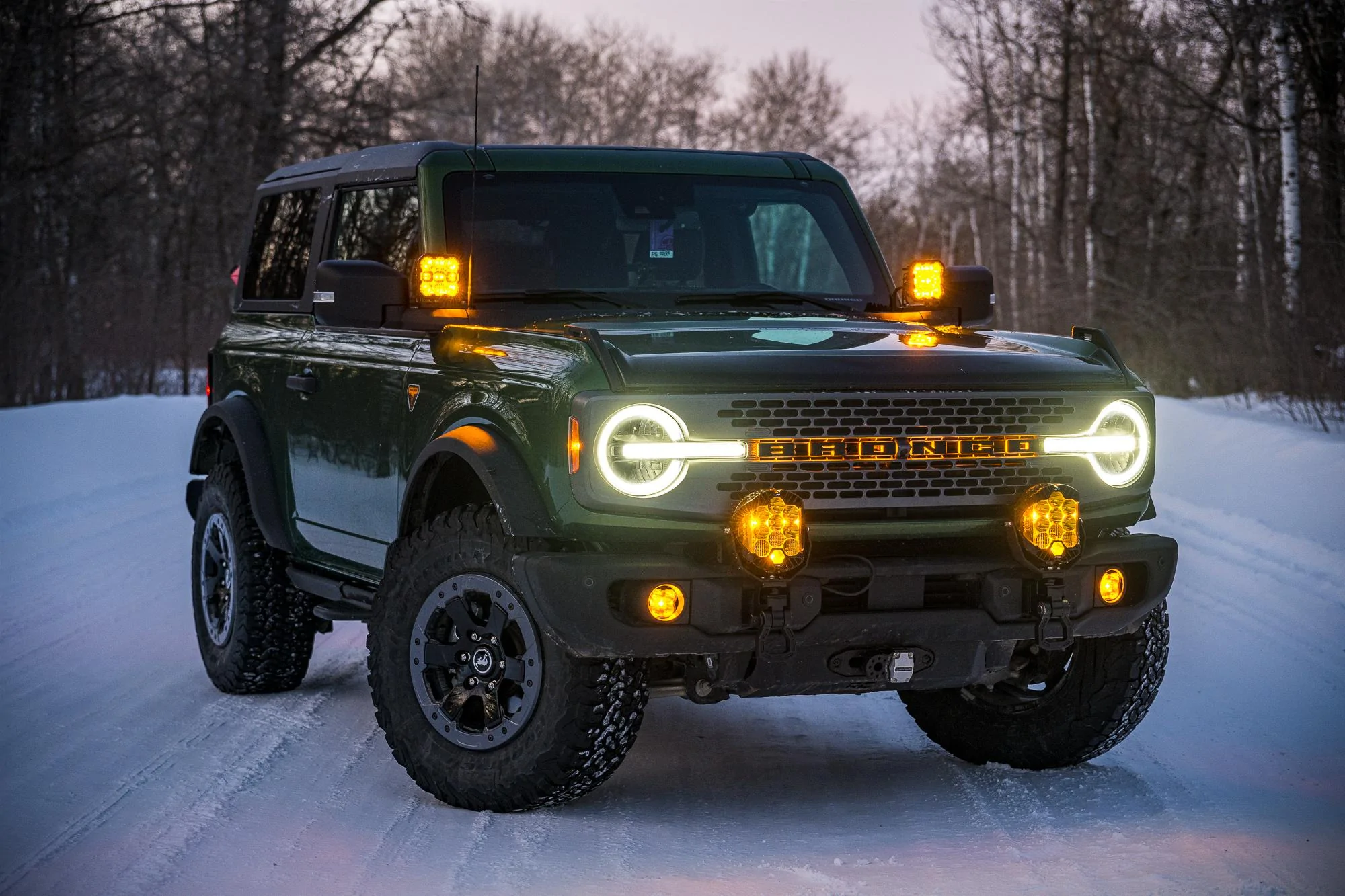

OEM Low Beams and SS3 Max Fogs
v
Ford Bronco The Boreal Badlands 51DC4E2E-E360-4FC2-AE02-BBA0F71DFA5E
OEM Low Beams, SS3 Max Fogs and LP9 Low Beams
v
Ford Bronco The Boreal Badlands 791F58C3-8B50-4988-A0E7-655845ABE7A3
OEM Low Beams, SS3 Max Fogs and SS5 Sport Ditch Lights
v
Ford Bronco The Boreal Badlands 35A17BCA-2F75-4043-BB2B-5503C526F77E
OEM Low Beams, SS3 Max Fogs, SS5 Sport Ditch Lights and LP9 Low Beams
v
Ford Bronco The Boreal Badlands 97EF714F-40B5-4D9F-9E4C-35DF2CA05015
OEM Low Beams, SS3 Max Fogs, SS5 Sport Combo Ditch Lights and LP9 High Beams
v
Ford Bronco The Boreal Badlands 5098016D-4494-4517-8FA6-9F3BA0D04753
As always, and still…. More to come!

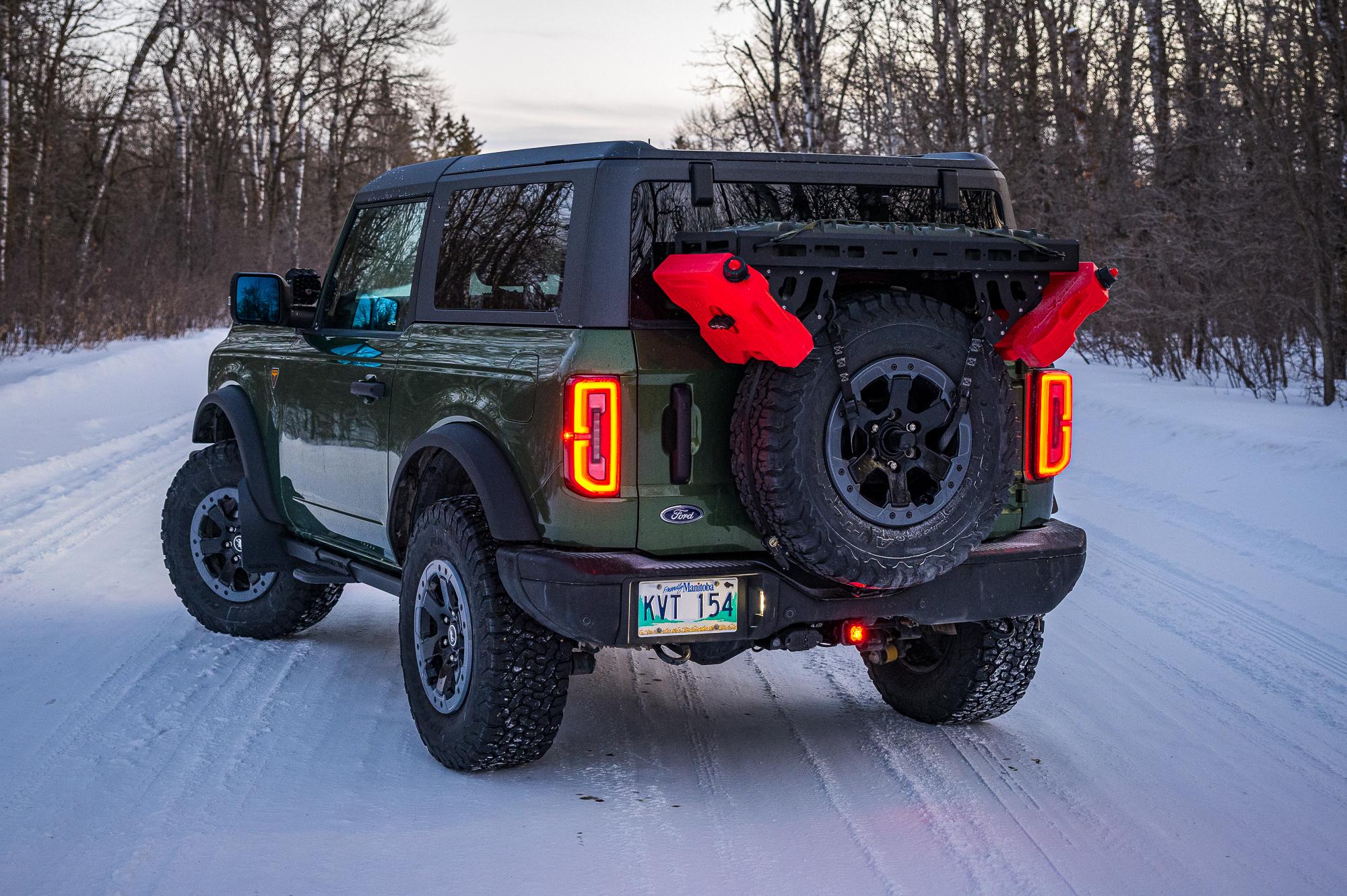

Looks great. I see you didn’t go with tailgate reinforcement. Not being critical, I just wanna know what you think. 1. Reinforcement is unnecessary. 2. You’re buying that next.
Documentation says that the tailgate is approx capable of 133lbs. Atleast I came across that somewhere.
OEM Sas Wheel weight Is approx. 87lbs. I’m on OEM 33’s…. So there will be some weight savings there…
The JCR Rack is about 20lbs. The DV8 Trax, Rotopax (Empty) and mounts are negligible ~5lbs.
Fuelled up Pax are 15lbs (15L).
87+40lbs (wet) and you are right at the limit of 130lbs.
I mostly run with the Pax empty to minimize the weight… one day ill swap the bumpers and suspension out to build everything up properly
