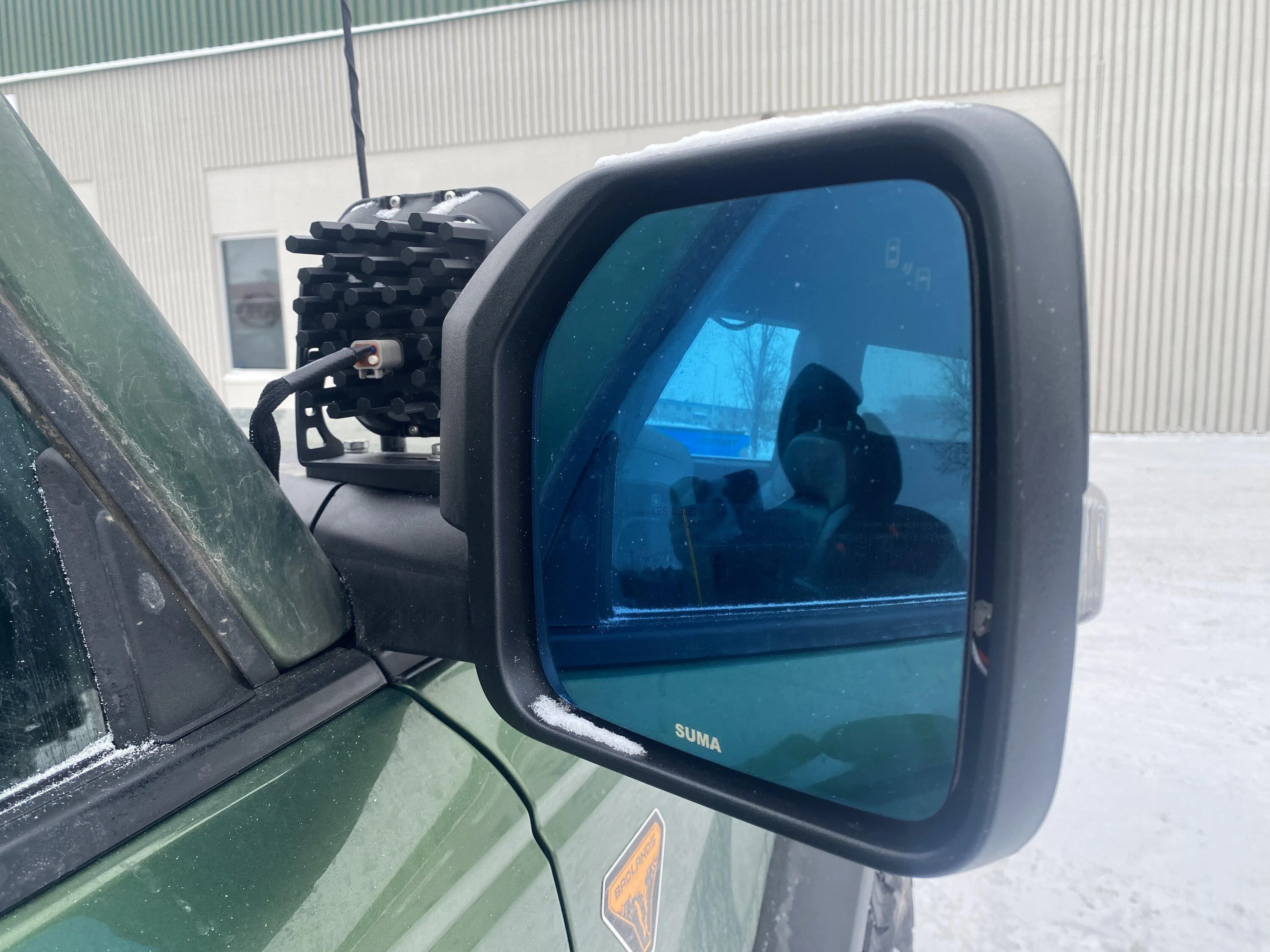

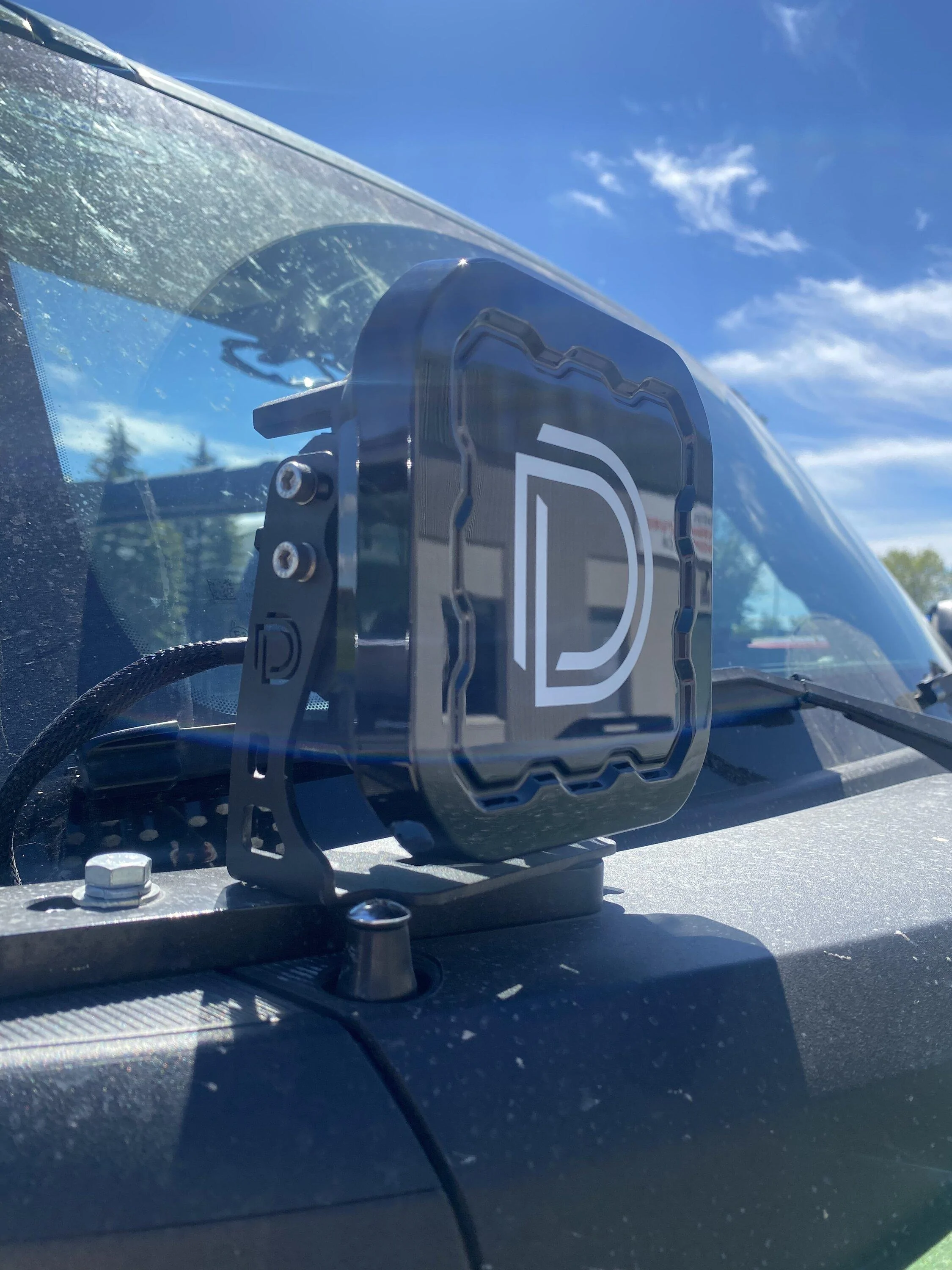

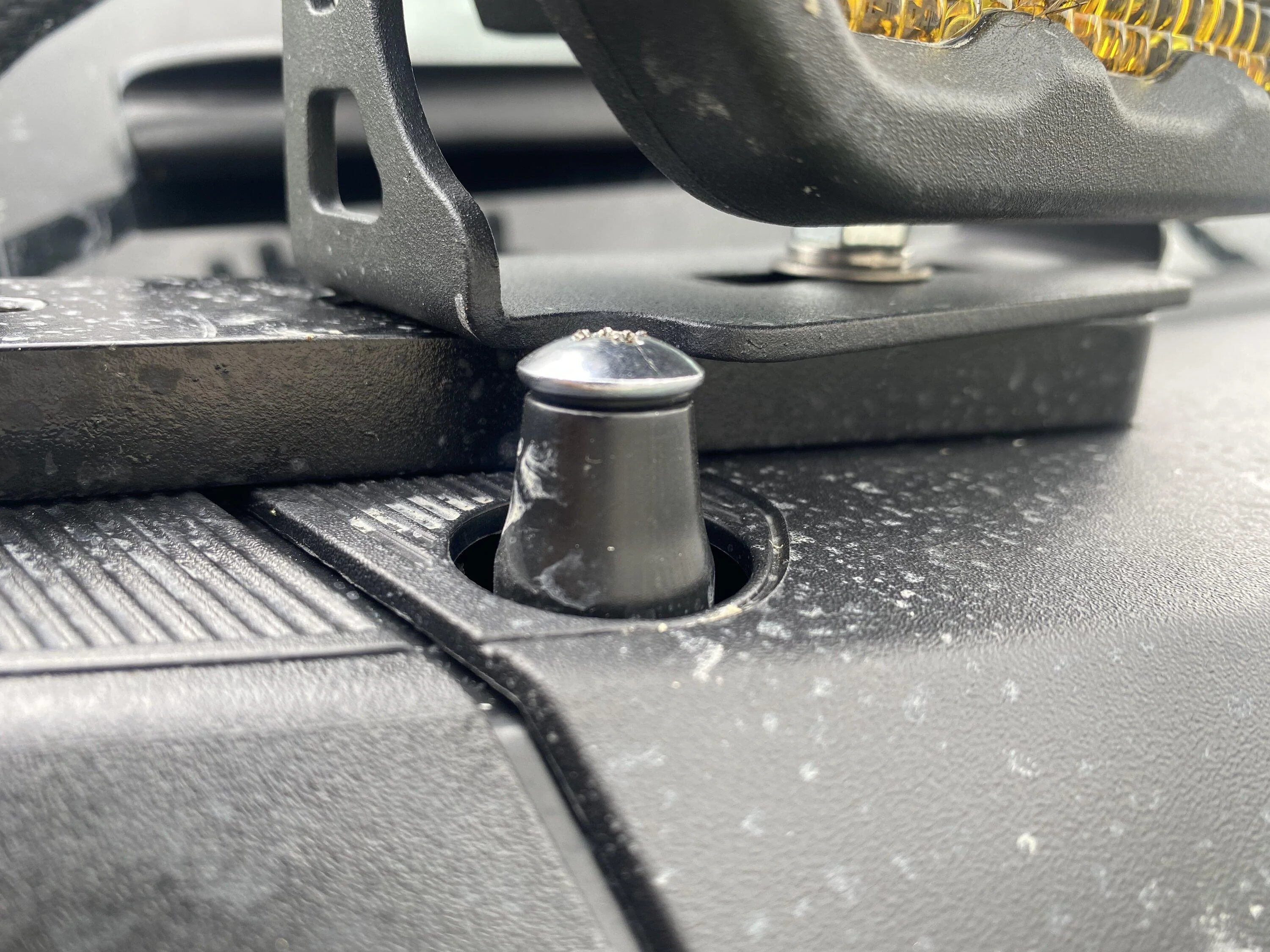

We hope you're loving our SS5 LED pods as ditch lights on your Bronco!
I’ll be giving them some use this weekend!

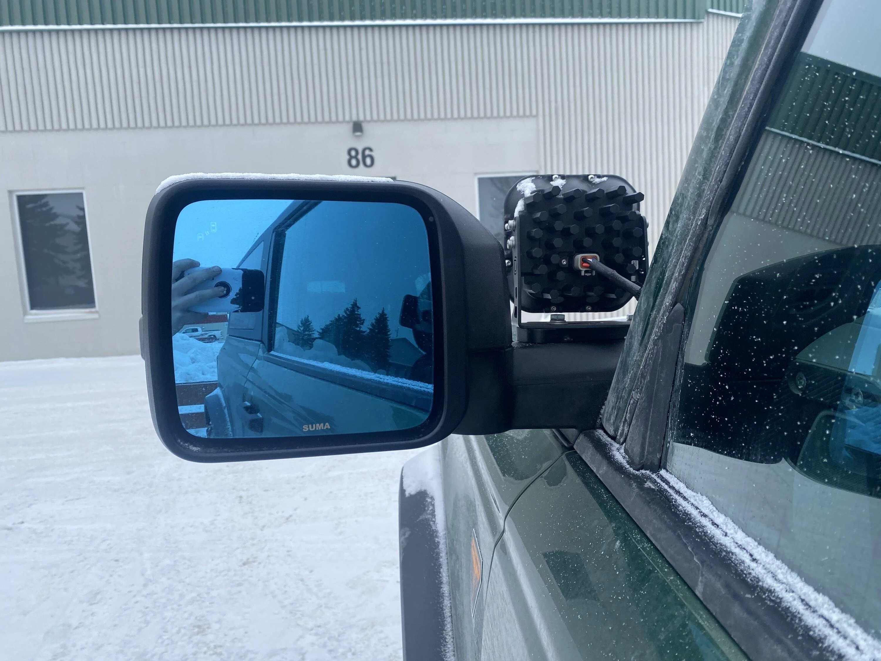

Meanwhile, to help with the fitment and keeping the lights symmetrical… A quick M6x1.25 with an O-ring under the head should work well enough for now as an Antenna Delete -98% of the time I am using the phone or an iPod for my music source

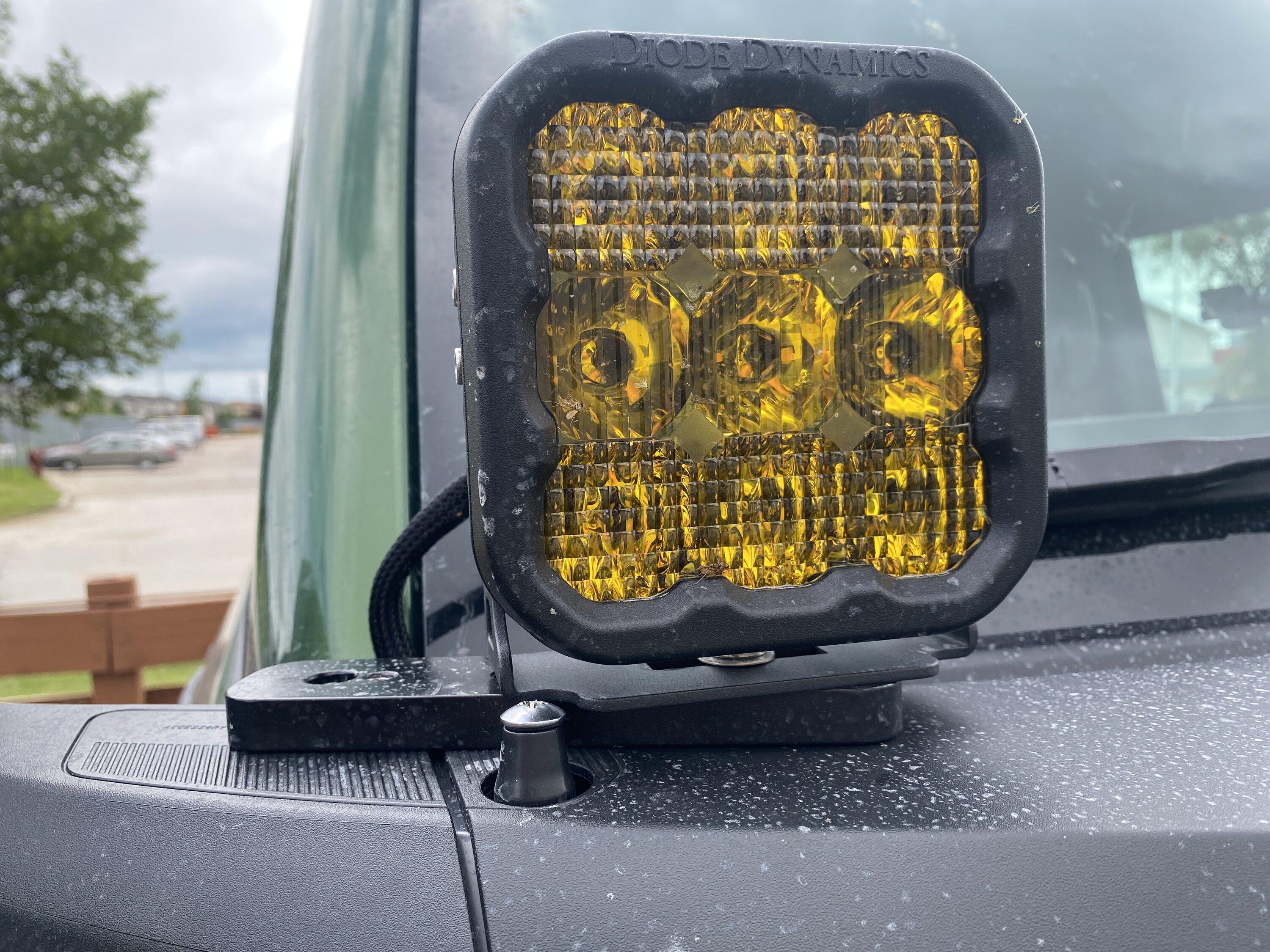

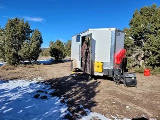

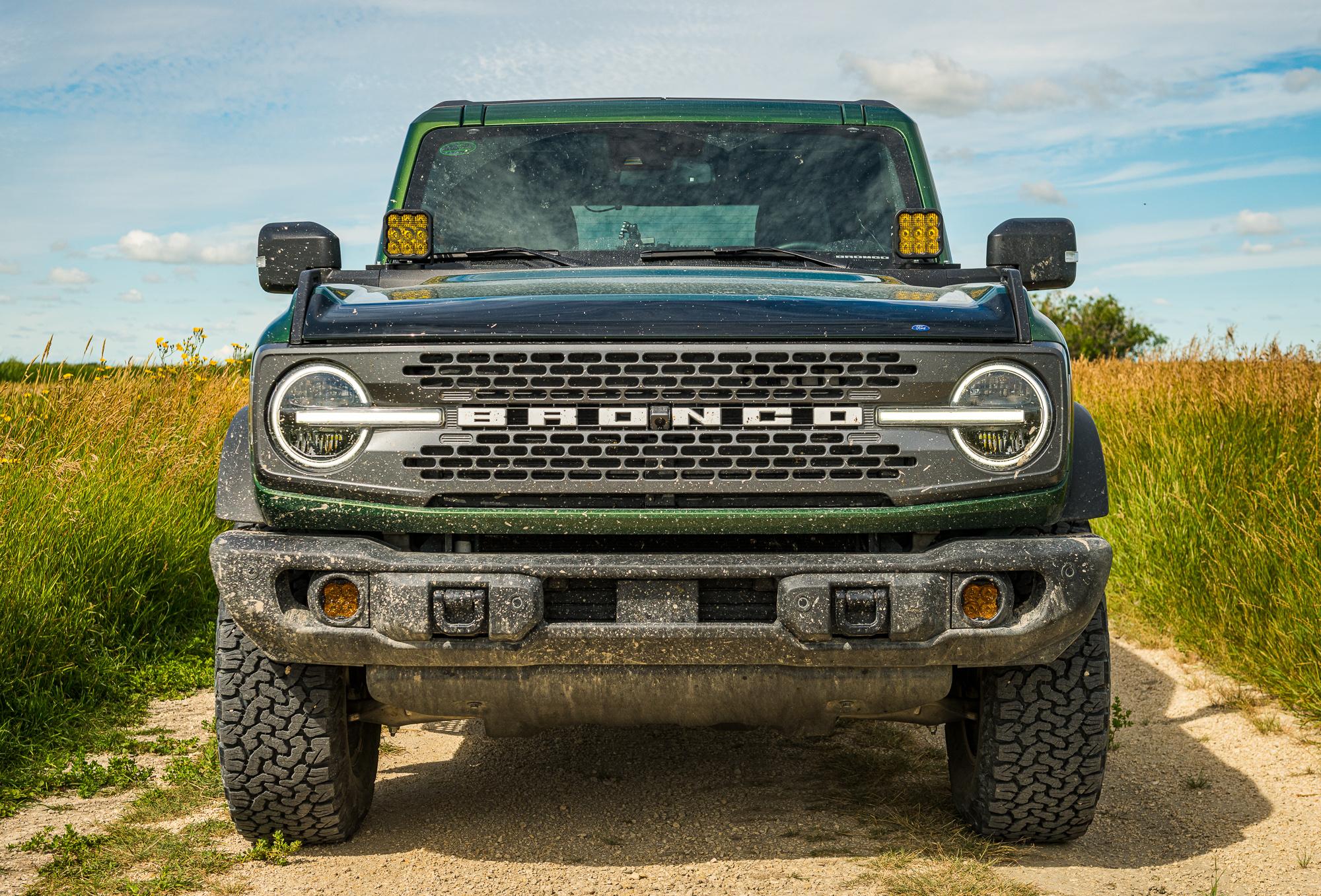

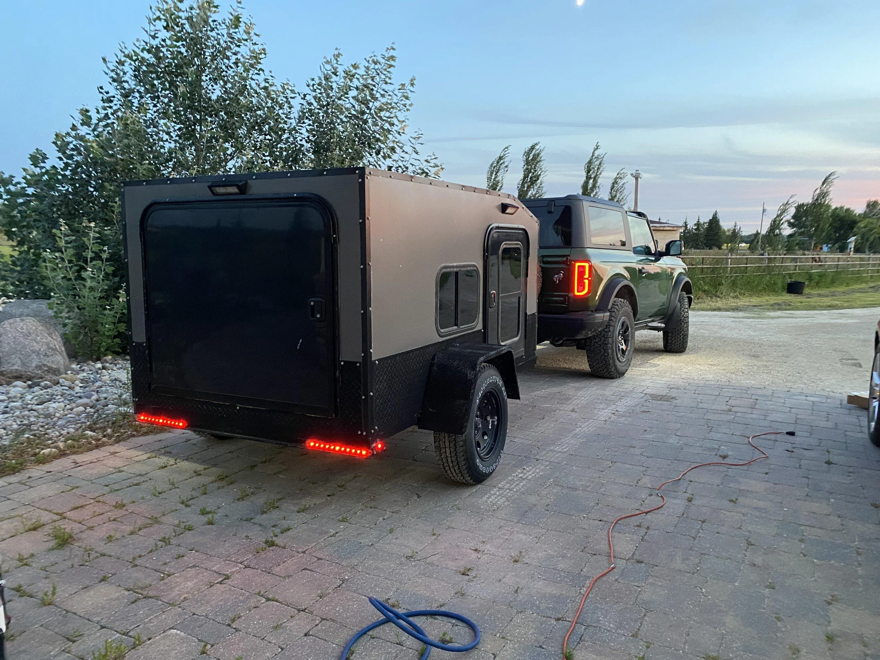

Installed the @Diode Dynamics SS3 Max Type A Fog Kit - Perfect! SS5 covers came in too, I’m happy to wear these Mon-Fri to avoid a needless ticket… they look good and kinda tie into the Aeroskin that I installed this past week too

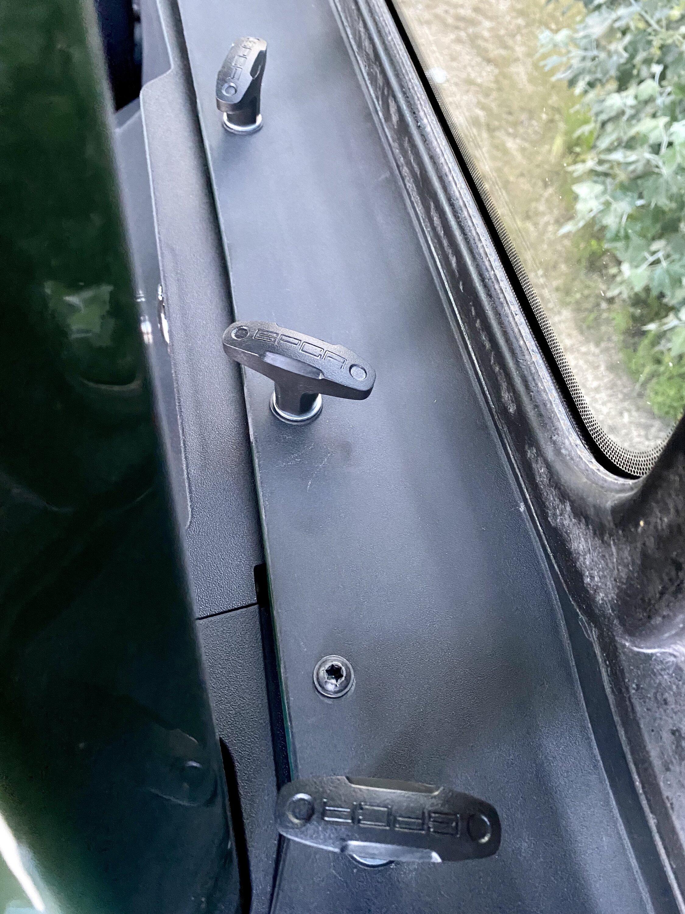

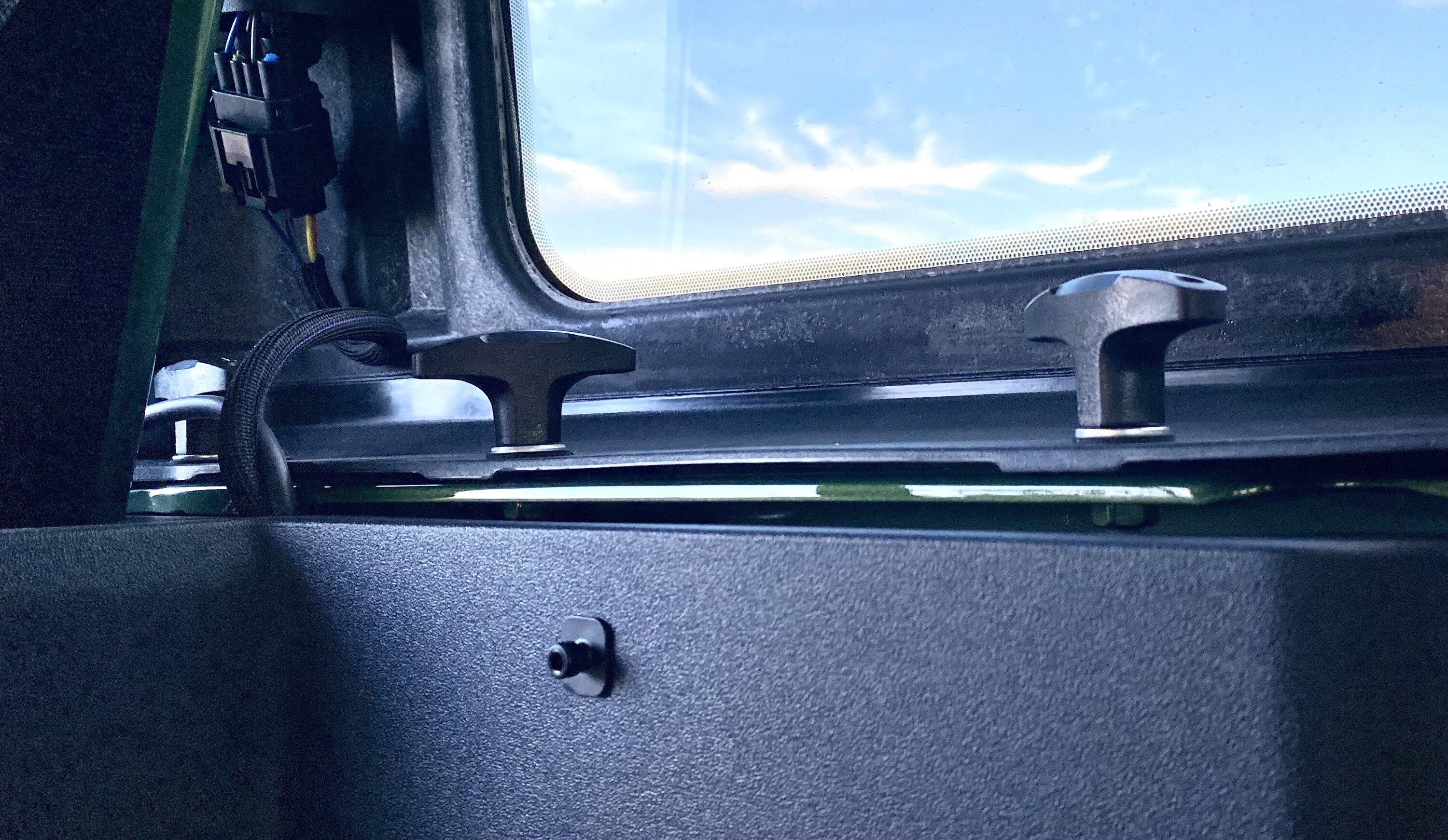

Got naked for the first time - GCPA T Bolts were a treat to use, OEM doorbags are worth every penny. This is the first time ive been topless/doorless and its weird but I love it.. ill be making some foot rests over the winter for next summer!

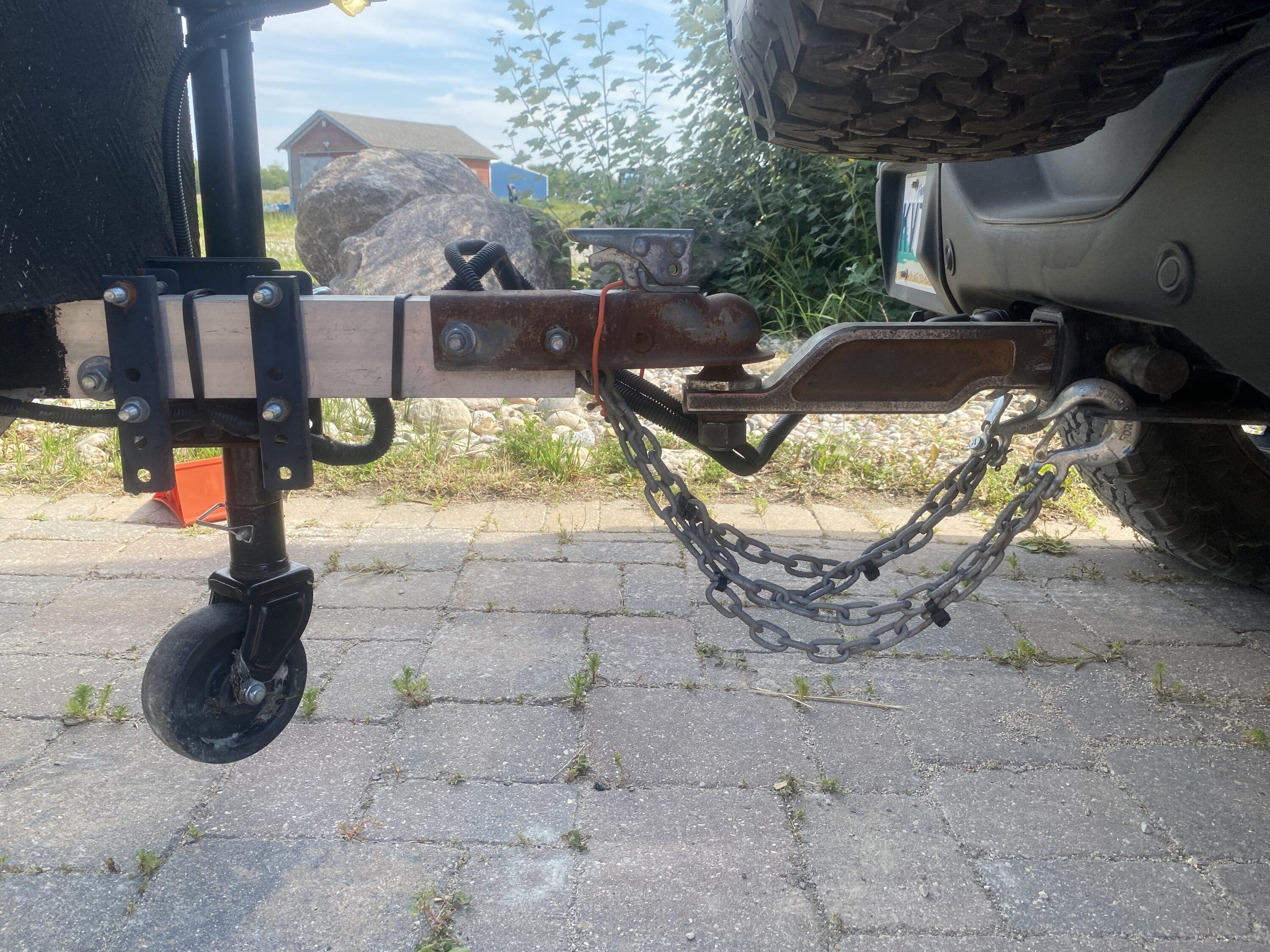

In the mean time, I've been working on the tedious finishing bits of my selfbuilt camper - lots going on in prep for a mountainous adventure! Replaced the batteries, greased the hubs, installed some functional mods... On my previous drive, a Subaru FXT(SJ), I had a Wilco Hitchgate spare tire setup that required a longer hitch... instead of using off the shelf extensions we machined one up and it has been given a second life as the Bronco's; it clears the spare tire perfectly! Ill share some more pics in Trip Journal once that story gets underway.

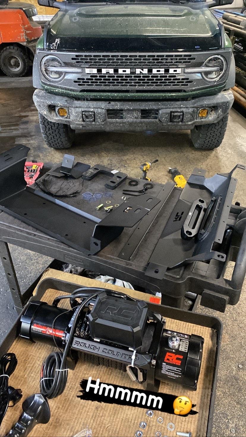

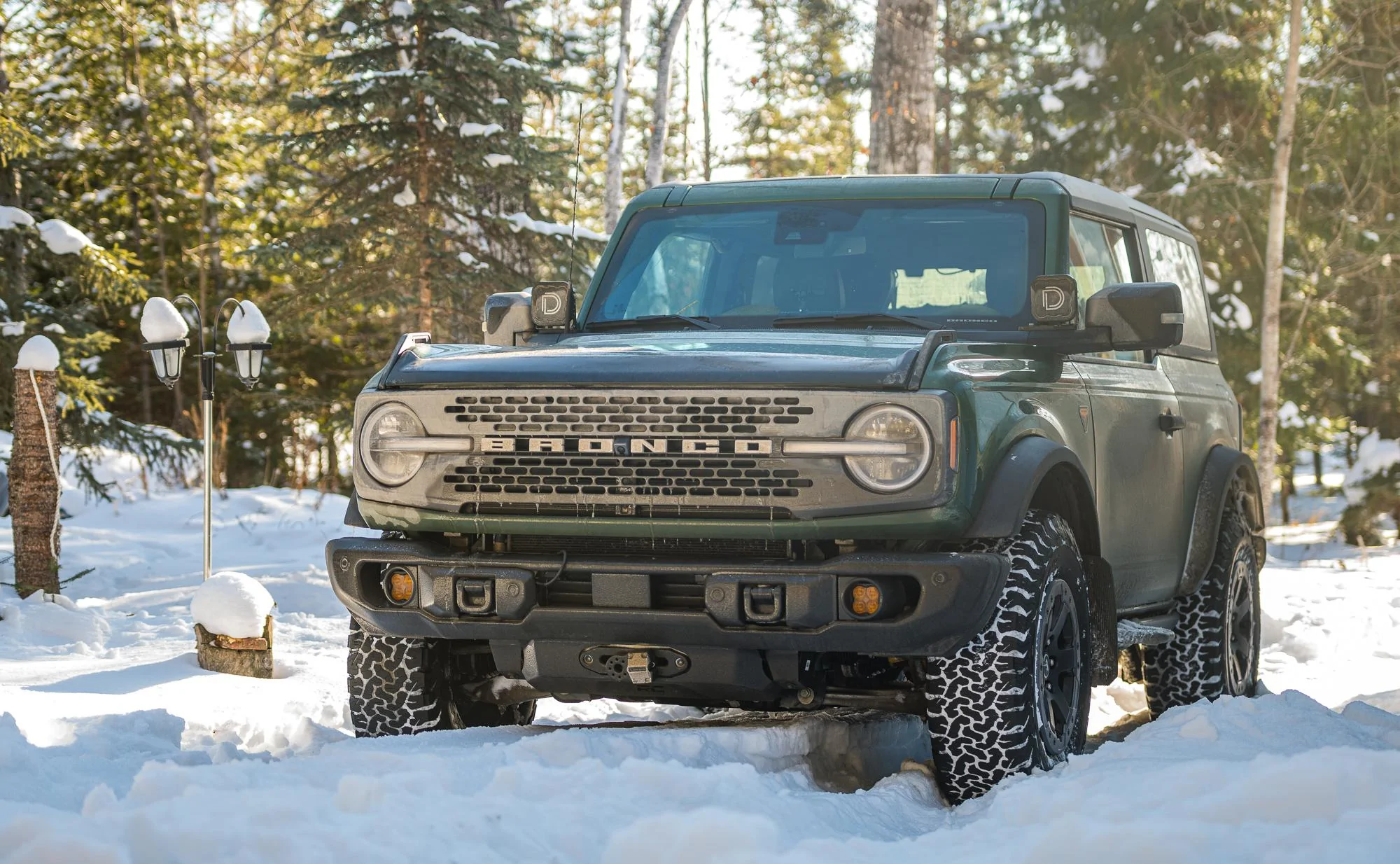

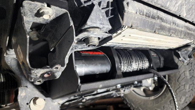

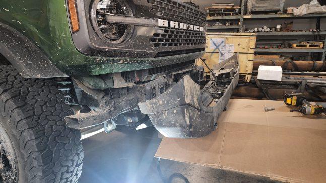

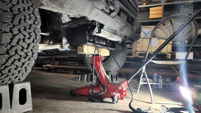

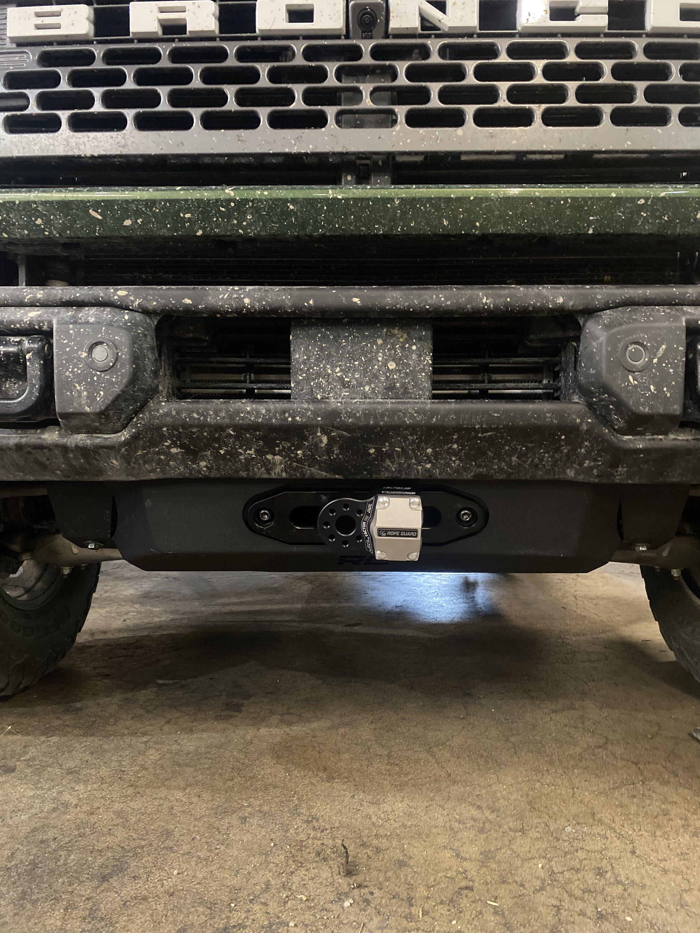

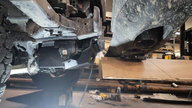

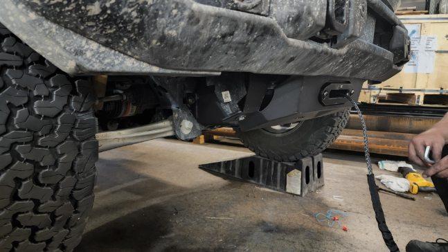

Got the RC Hidden winch in. I confirmed fitment pre-purchase, got the go ahead for the Capable Bumper. Turns out we needed two more bolts and washers - M10x1.5x30mm.
Also, this winch kit does not allow you to free spool without some serious mods to the handle. I ended up fabbing up a spool handle... machining an adapter and welding a bunch of ⅜ 304SS rod together while giving it a 2" offset by 3.5" tall notch to avoid the crossmember. After four or five weld-cut-test-repeat's later, I had the perfect setup to rotate 180º and allow freespool!
You do have to drop the bumper to get to those extra M10x1.5 welded thread bosses. Pop the Sensor/Shackle surrounds off with a trim tool, pop the wiring harness holding clips and drop the six 15mm bolts out.
I topped the winch setup off with a Black Factor 55 Flatlink and Rope Guard. UV protected and stealthy all throughout.
Everything bolted up as expected. I I thought the approach angle would be impeded more, but not really at all when you consider the general shape of the skid vs approach. I hope that I don't have to use this winch terribly much - as that means im stuck in a bunch of snow... but its a good recovery policy to have at any point in time.
Are you saying that you had to remove the bumper only because you were installing the custom fabricated clutch extension? Or did you have to remove it for the basic install?
The RC kit requires the capable bumper to be dropped to get to the two most forward bolt locations… (doesn’t mention this in the instructions). And it requires the two extra bolts/washers for this mount point (also not included - but I did tell the webchat dude this)

Great build and thank you for the complete list.
Did you have to modify anything for the SS3 Yellow fog lights? or were they plug and play?

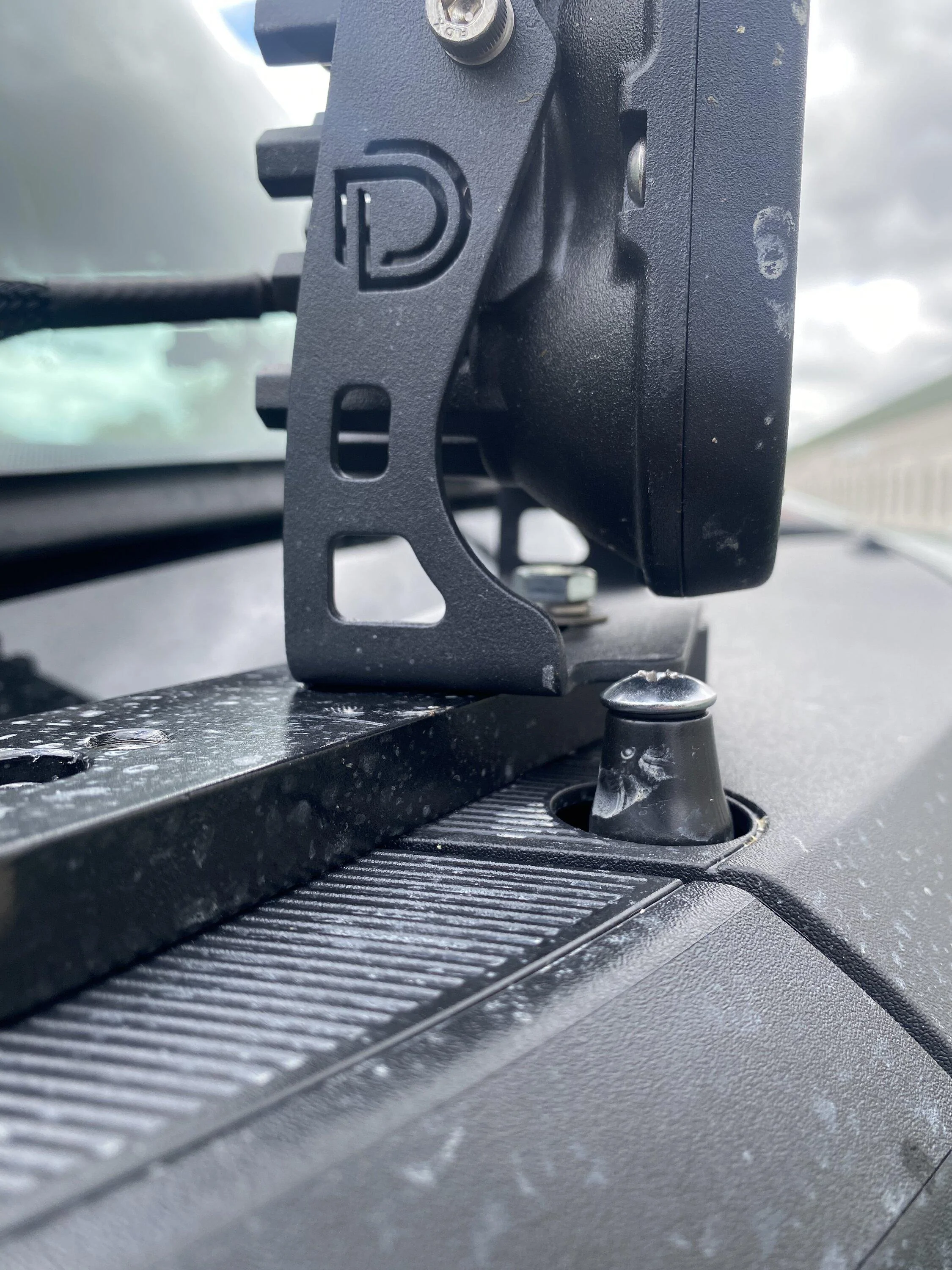

The Diode fogs just, and I meant just, fit up and aim where you need them to be. It’s a bit of a pain to drop in without removing the bumper… you can’t pull your crash bars off without removing the wings on the capable bumper, which you can’t remove with the crashbars in the way…
So, either drop the bumper or be prepared to fiddle with bolts. Otherwise the Lights are plug and play!
Your OBX might have a different bumper so, your results may vary

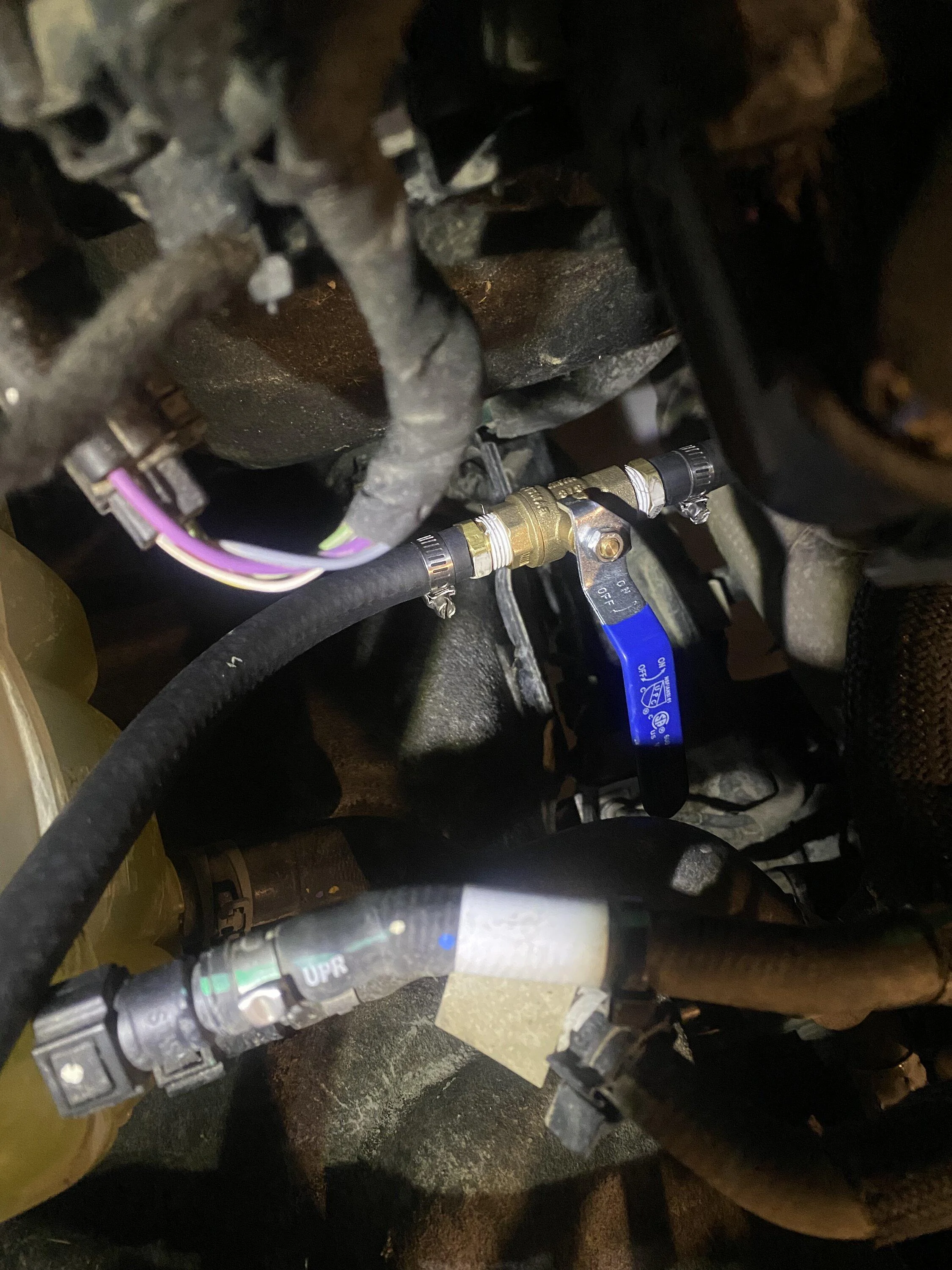

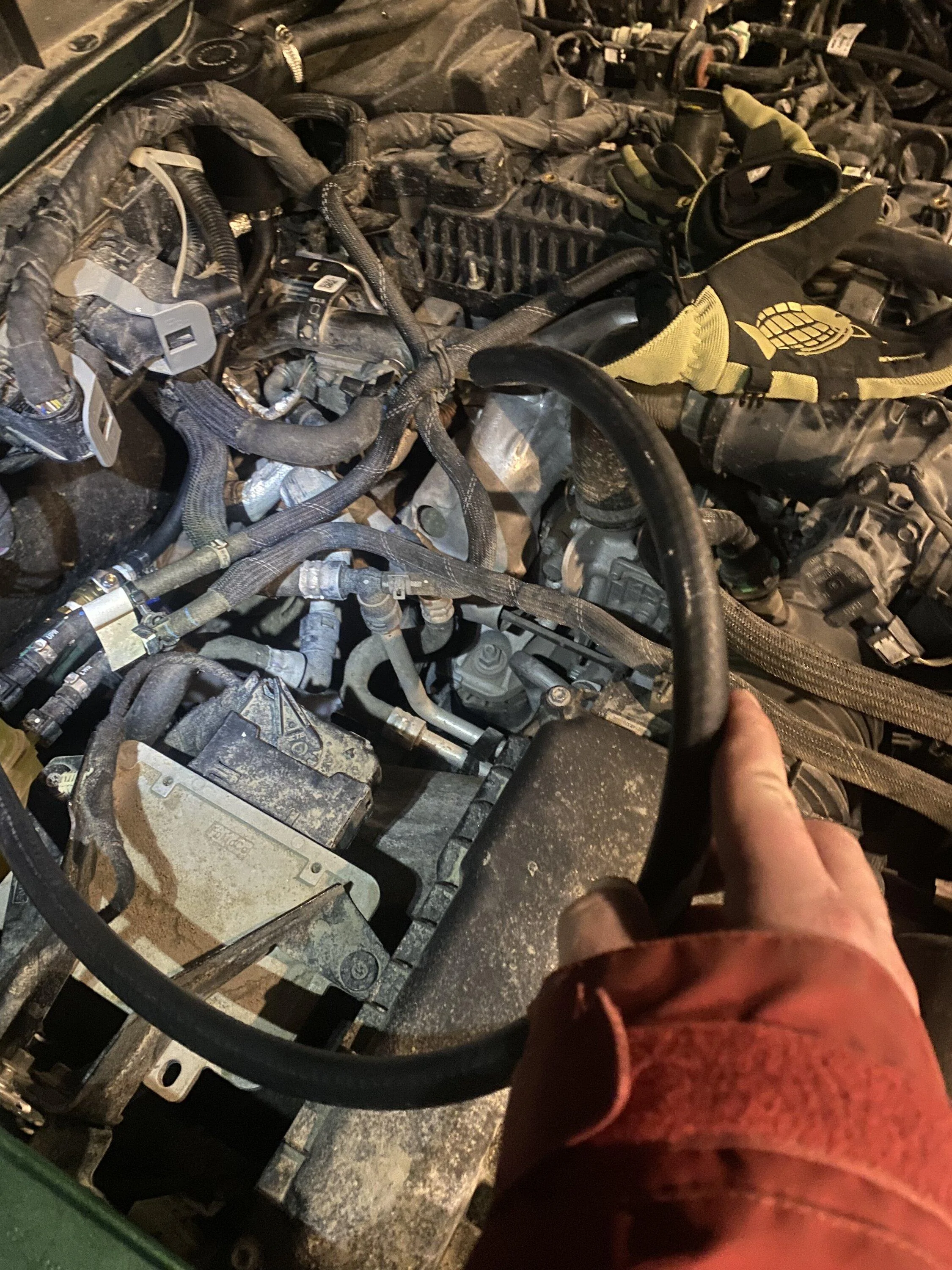

Finally, the latest mod is a Princess Auto/Piston Ring parts collection to DIY a drain for the Catch can! Janky or genius? Cheaper than getting the Mishi drain kit shipped, so it’s a win in my books.

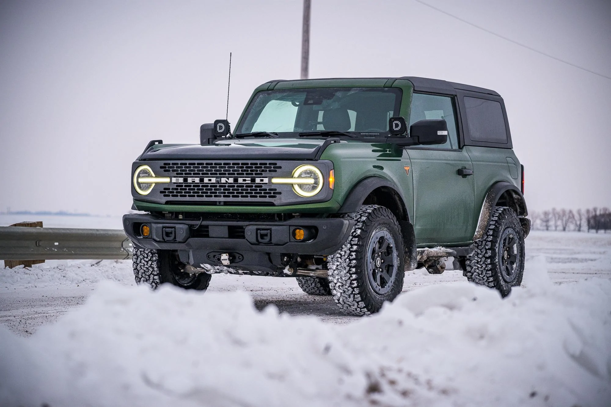

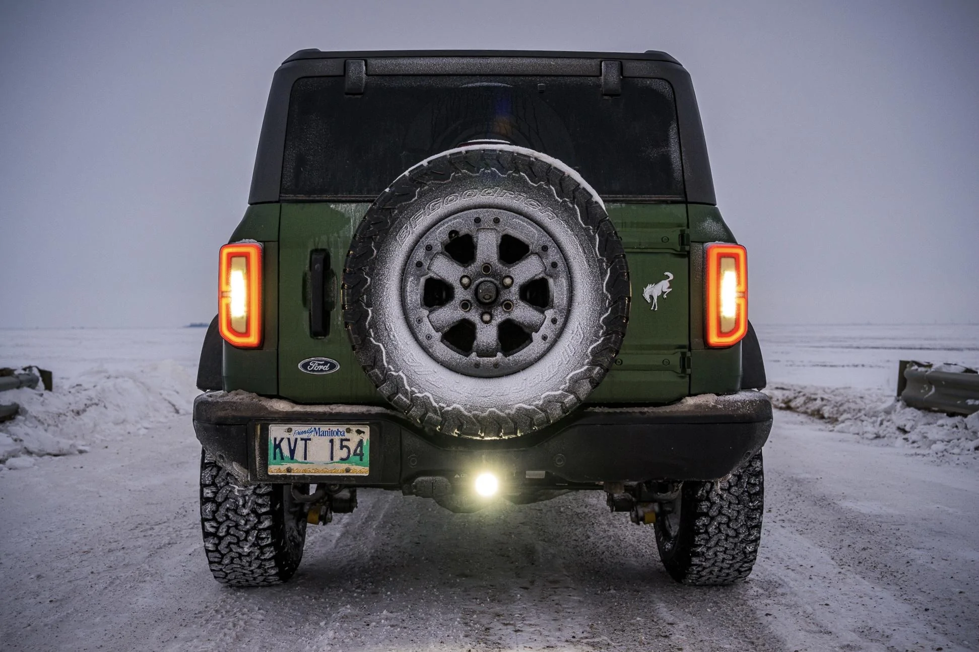

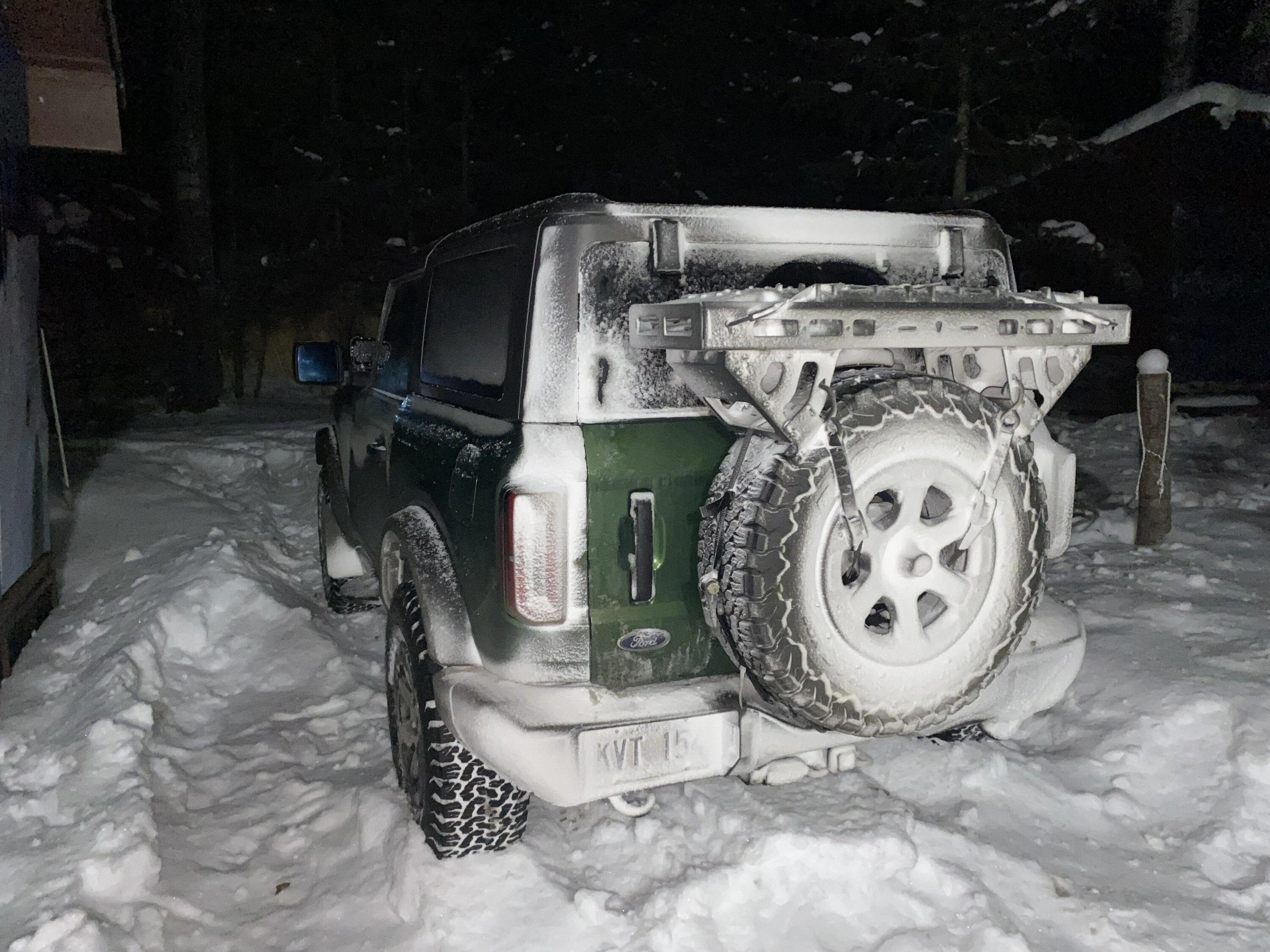

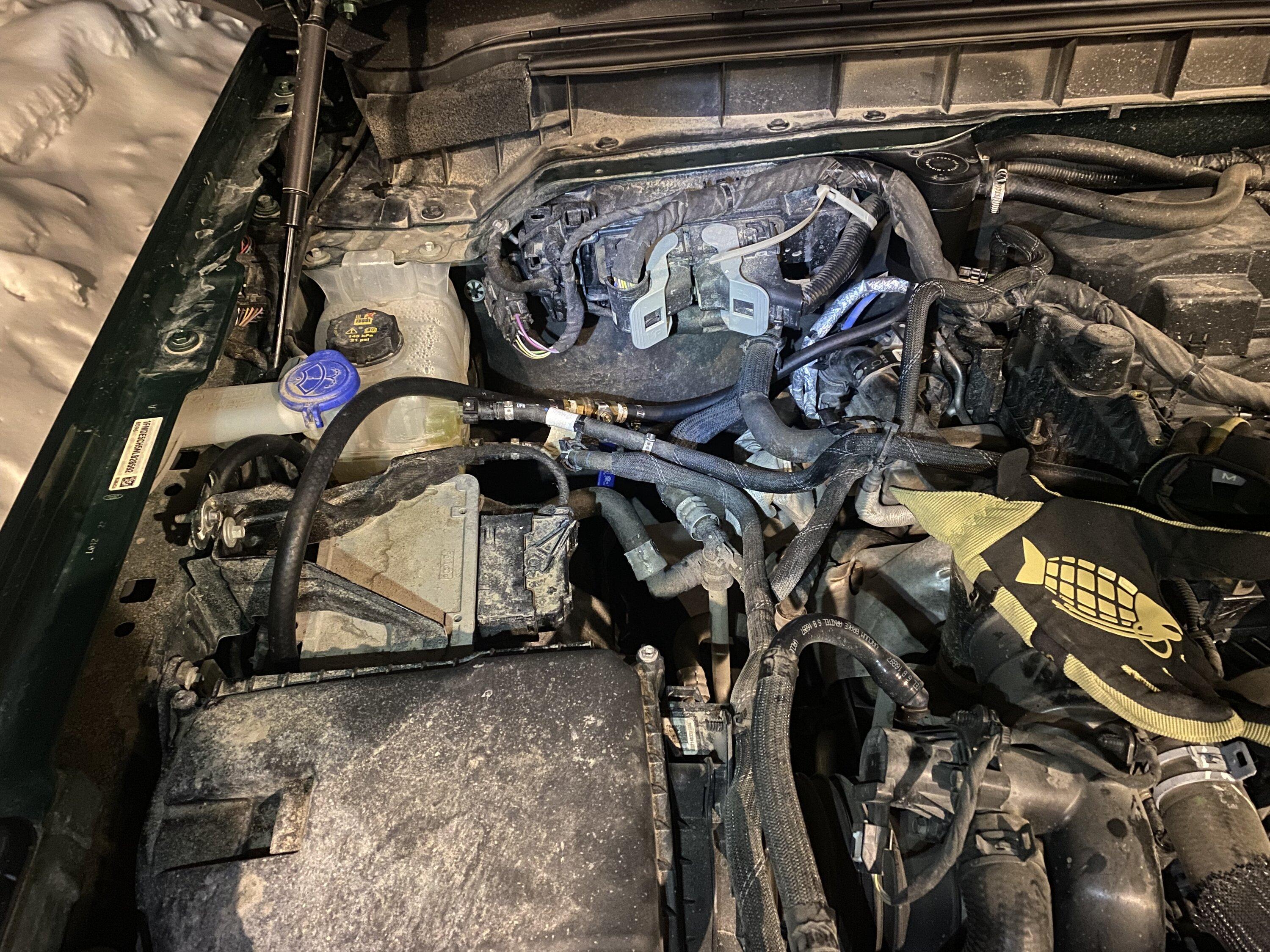

The cold has set in, -35ºC these nights/mornings. I like to always carry a little extra fuel on the travels in case of a general emergency, getting stuck, etc. you know.

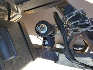

Im not a fan of any of the roof rack/storage solutions yet, so for the time being the @JcrOffroad Spare tire rack fits the bill for a decent price. It can always be sold in the future if a suitable roof setup comes along or even just used for extra storage on longer trips. The fact that a pair of the DV8 Traction boards fit perfectly in the basket is icing on the cake.
While hunting for this I came across some images and FAQ's that showed and stated that 1&2 Gallon Rotos were tested and proven to work. While yes, the bolt pattern is there for the rotopax DLX mount... It does not immediately fit a 33" tire while spacing the feet inward to clear the third brake light. The Mount fits just fine, but the 2 Gallon Pax is too large for the overhang of the tray, makes contact and just simply doesn't work.
Ford Bronco The Boreal Badlands IMG_8482
Ford Bronco The Boreal Badlands IMG_8483

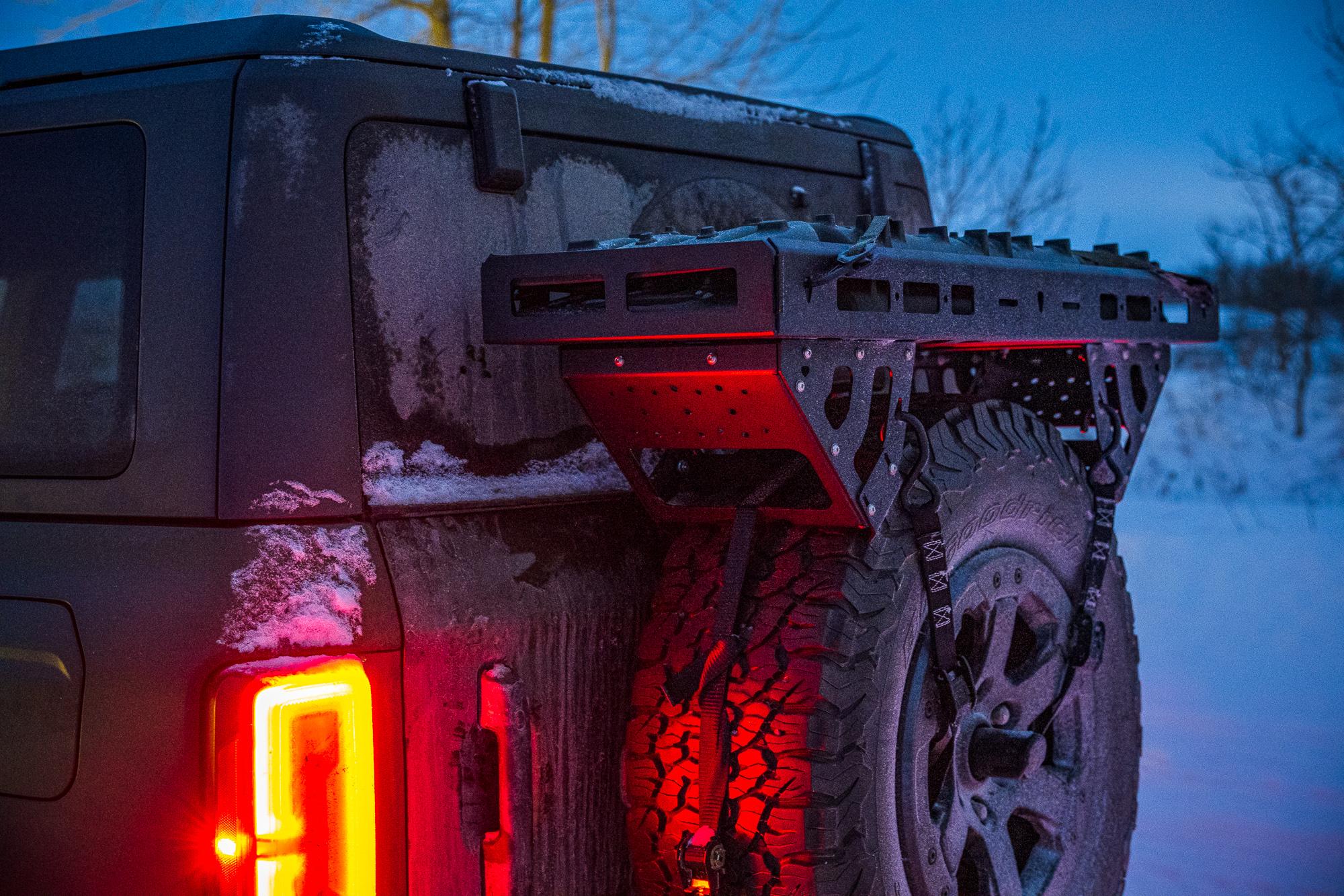

Im not about to change up to a 37" tire and relocate the third brake light for this... the quickest and easiest solution to the solution is to make up a spacer. 4" Delrin. 1.25" Thick. I broke into some of the machines at work between jobs and while guys were on break to whip these up.
Ford Bronco The Boreal Badlands IMG_9054
Ford Bronco The Boreal Badlands IMG_9055
Ford Bronco The Boreal Badlands IMG_9059
Ford Bronco The Boreal Badlands IMG_9056

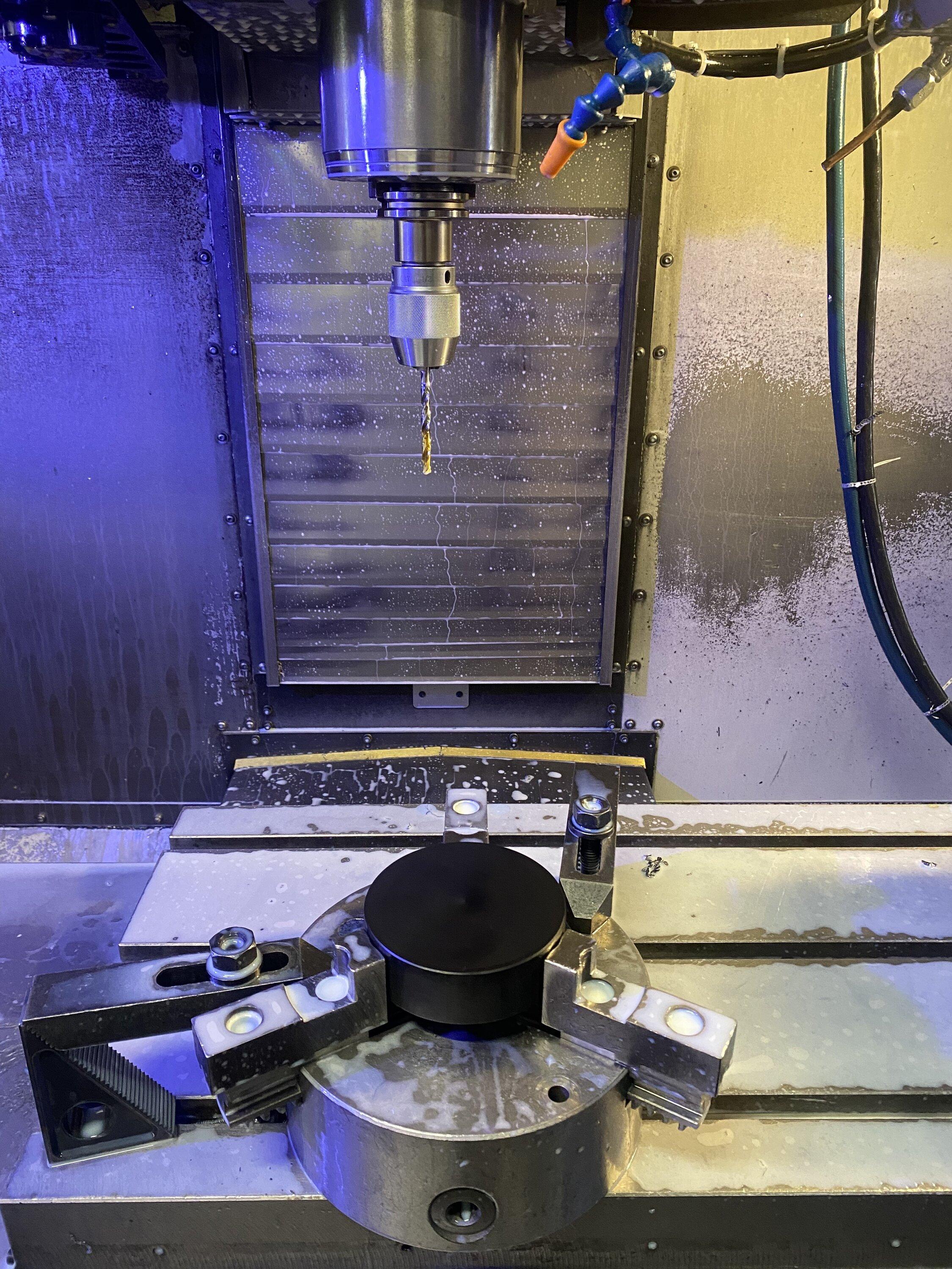

Fastenal (Bolt Supply) down the street had 2" long 1/4-20 SS Carriage bolts, and I was able to reuse the supplied washers and lockers. A bit of percussive assistance to seat the carriage heads into the Delrin and in no time the assembly was tight.
Ford Bronco The Boreal Badlands IMG_9065
Ford Bronco The Boreal Badlands IMG_9082
Ford Bronco The Boreal Badlands IMG_9067
Ford Bronco The Boreal Badlands IMG_9069
Ford Bronco The Boreal Badlands IMG_9072
Ford Bronco The Boreal Badlands IMG_9077
Ford Bronco The Boreal Badlands IMG_9078
The spacer just clears for contact with the hardtop at full door open, and it clears the tray by the slimmest of margins. PERFECT. It all aligned up First Second kick at the can. Its only 15L/4G but its enough to have for a day drive almost to anywhere in Manitoba. For those extended journeys I can always throw a jerry in the cargo area like normal.

With it all going so right, there had to be something to pop up. Hello MIC Micro Fractures..... YAYYYYYYYYYY. Ill have to mention that next time it goes in... March for the Trans ⅚ Synchro TSB..
I love your trailer build. I’ve been building my own cargo conversion as a distraction during the wait for my Bronco. I had a standard tongue jack that rattled down on a washboard road (it was bad). I had my neighbor weld on a removable jack, so I never have to worry again.

GCPA Bolts thrown in, and still haven't had a chance to take the roof of either rig so far. Between the bitterly cold winter, the torrential spring and continuing on as a wet summer, we have hardly had more than two days of good weather at a time
Brother, this build is absolutely epic. So many folks over index on vanity parts but everything you’ve posted is a utility MOD with exceptional thought. BRAVO!!!
Did I miss the link to these replacement bolts? As a Texan who is also trading a soft top base BigBend in next week for a hard top Badlands, I’m desperate to make the top removal as easy as possible. I’ve gotten addicted to quoting Thelma and Louise at every red light.
On my travels I met a couple with a Cargo conversion. This thing had a king(queen?) size bed, sitting room with a small table, a kitchenette with a Dometic fridge and a shitter. It was wild how setup this thing was, storage for about two weeks of supplies - about the same size as yours. Fortunately DIY’s are anything you need them to be to fit your intended use. Best of luck on the build and figuring it out along the way!!
