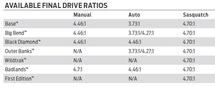

Then answer @mlcinema, sure change to 33" tires like Badlands, your OBX fender flares are fine, go with 35" tires and then you need wider Sasquatch style fender flares and a lift.
Then you all set to drive, oh wait, mpg, acceleration, holding you back, learn about rear end gearing and why the factory matches it to tire size.

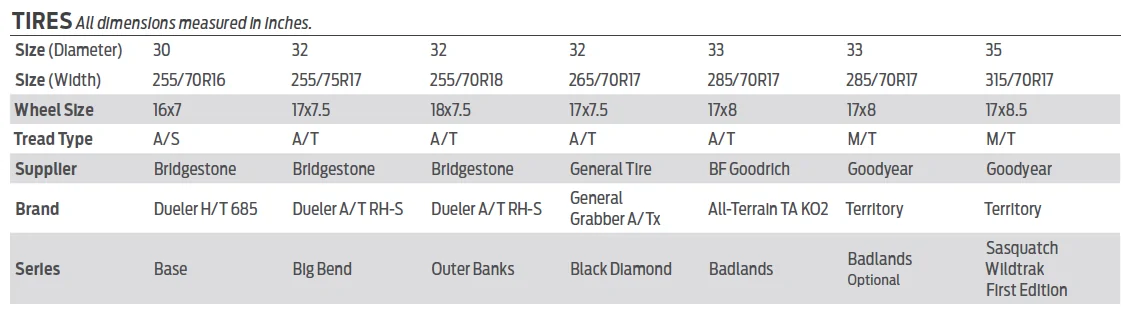

Hello,
Is it safe to think that the suspension is the same on the Base, BB, BD, and OBX? I think BL is a little different.
Is it safe to think I could put BL size tires and wheels on an OBX to change the look and height?
What’s your definition of ‘safe’?
we’re all working on preliminary spec sheets and speculation. we’re all waiting to get some more concrete info so speculating is getting tough for some.
that said, yeah probably be ok, as I speculate. What’s the gearing of the OBX? What transmission? what size are the OBX tires? What engine? If I know this I can get closer to a speculative decision that’s purely speculation.

Here ya go....
10-7-20 Edited
ANSWERS:
1. Max tire size with standard suspension on Base - BB- BD -OB
32”
2. Suspension Difference on BL vs Sasquatch how? -Will 35' tires fit BL
Sasquatch has stiffer springs and longer shocks. There is no “ spacer”
