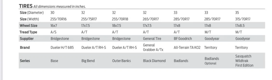

Ok, but if you are looking for the differences between BD and BL it is a key difference, and why if I go BD it will be Squatched.
What we really don’t know is besides the Bilsteins and springs, what else in the front suspension is different? The track width is the same, yet the BL is 0.4” wider. I’d guess that is wheel & tire width.
Ford Bronco BD vs BL Suspension: What is the Real Difference? F6145327-0A06-459B-A29A-E7568DECF705
Ford Bronco BD vs BL Suspension: What is the Real Difference? D6516802-AE21-4C9A-870F-7A31CE1577E9
Interestingly the track width on the Squatch is 1.9” wider. Does different wheel backspacing account for track width differences or is there a difference in the upper and lower control arms?
Could it all be related to tire width? 265 vs 285 vs 315?
If that was the case, the BL would have a different track width than the Base-OB. So it has to be the center of the wheel. If you added the 1/2” on the Squatch wheel width just to the outside on both sides it would widen the track 1/2” (1/4” per side). So where does the extra 1.4” of track width come from?
either a) Squatch has wider control arms, or b) the wheels have 1” less offset (moving them both out 1”).
I really wish Ford would be very specific on this for Badlands buyers (the very people who are likely to be most specific on things like lifts).

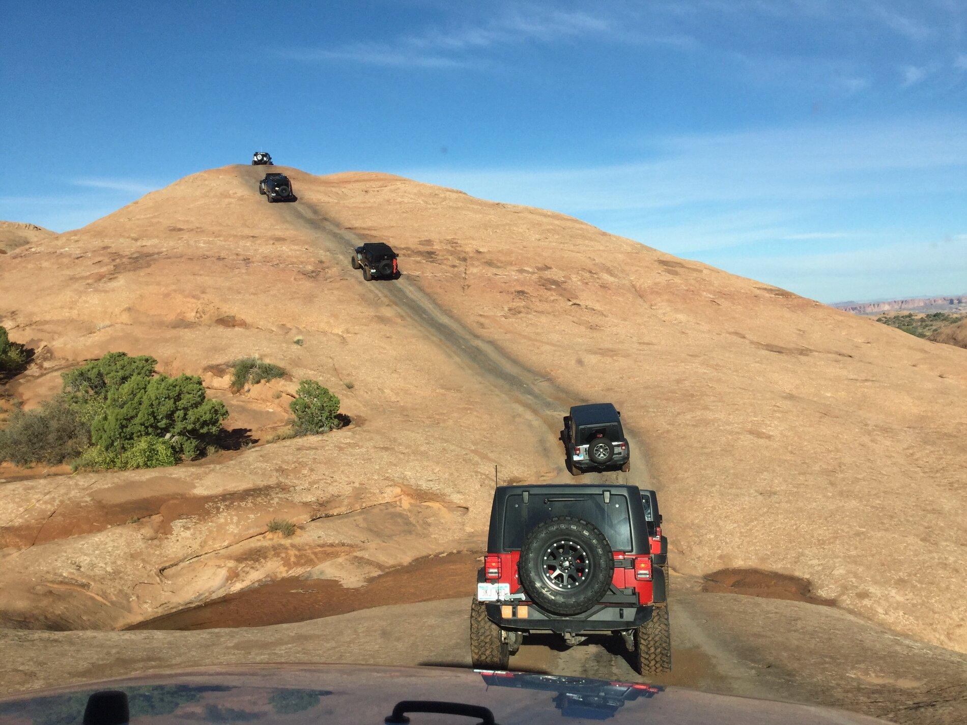

Do yourself a favor and check out Moab. Vehicles with no lockers at all go all the time. Lots of easy trails available to just cruise in 4hi and 2WD.
God I would love something like this on east coast. Not looking for technical stuff
