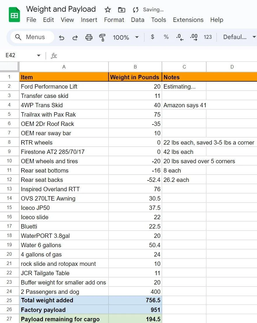

Ford Bronco Suspension clearance - Overlanding 1720447972651-sd
I've removed 20 lbs from this list now.
So fully loaded (Passengers, food, water, etc) I still have 215 or so pounds of payload remaining.
That’s a good list and smart for you to keep up with. 215lbs is a good amount.
I think where Ford may have missed on things, is the love for RTTs. RTTs alone add at times up to 150lbs on a removable top that must be supported in dynamic load. I see yours is smaller and lighter, so that’s great.
Not sure what the fix would have been, such as a more weight bearing suspension and stronger frame, but truth is, they make sense on a 4Runner or a pickup bed, but on a Bronco with the removable top, they can cause some concern. Haven’t seen any crazy failures of the roofs, but I imaging the weight makes wheeling a bit more tricky to balance.
