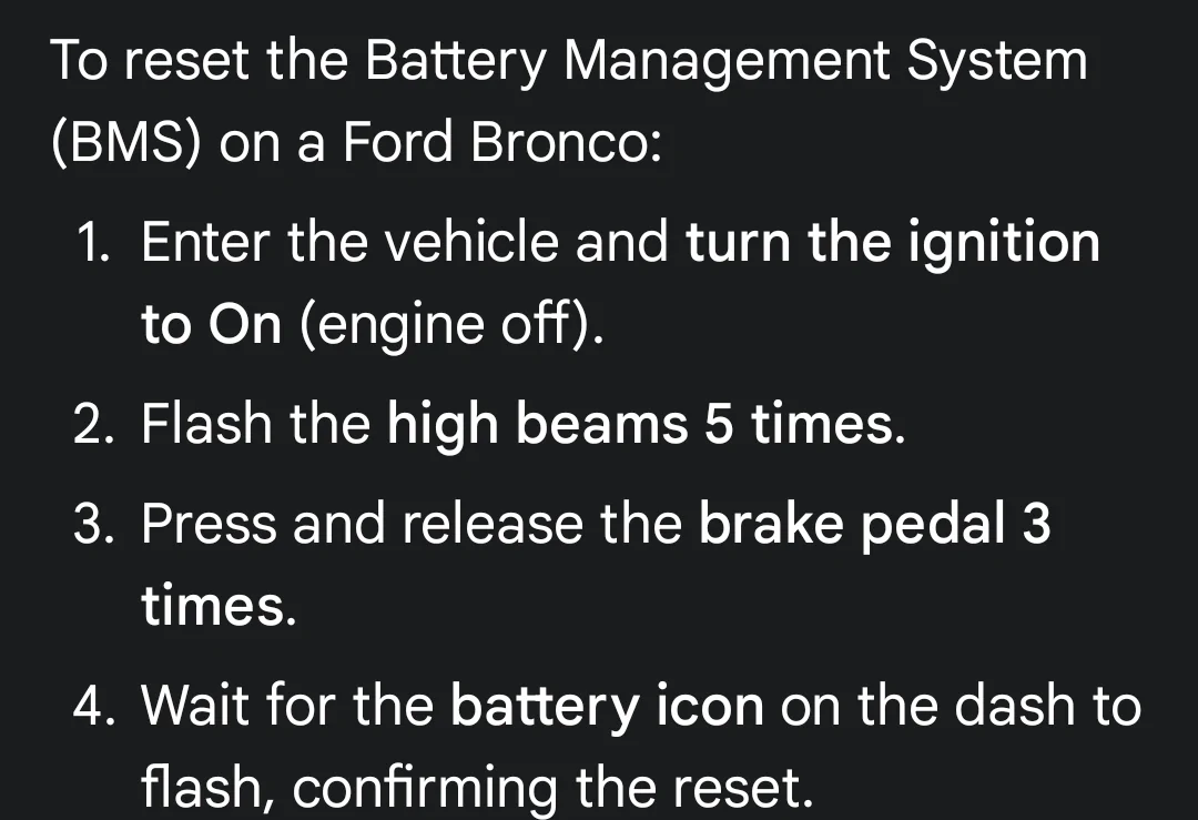

Did you reset the battery management system?
That's useful - where did you find that?
Edit: I found the link here: Resetting the Battery Sensor. Looks like the online Owner's Manual has the info - the 2021 manual doesn't have a page on this. The manual I have only has the info on leaving the vehicle locked for 8 hours to relearn the battery state.
I asked AI 😁

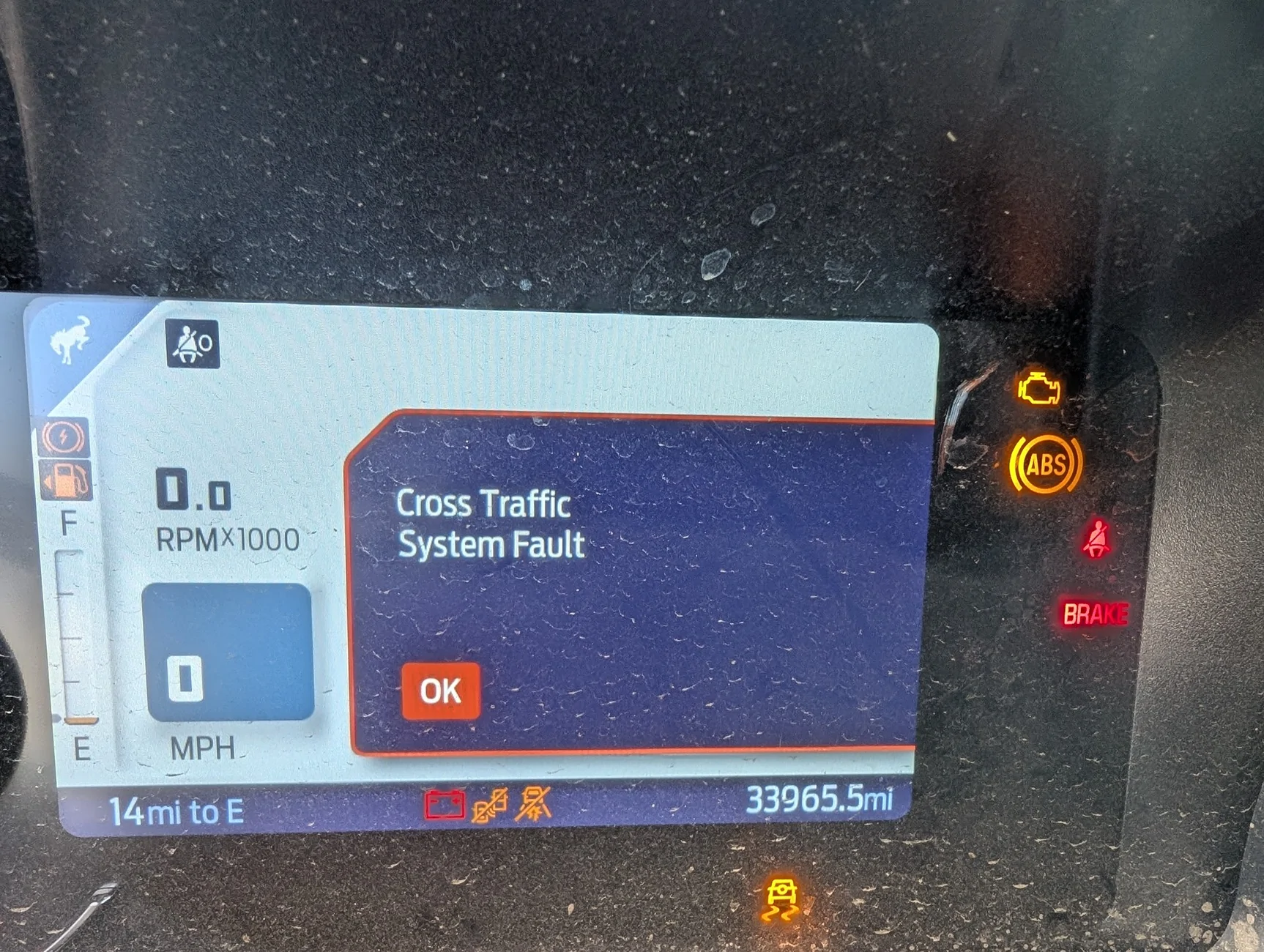

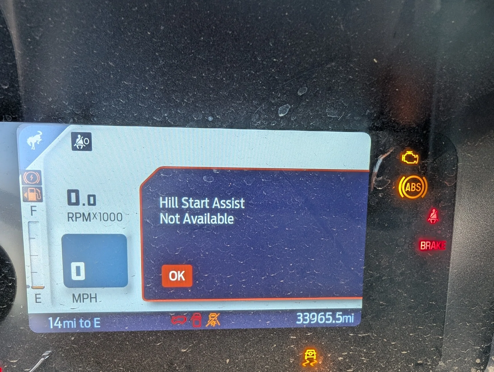

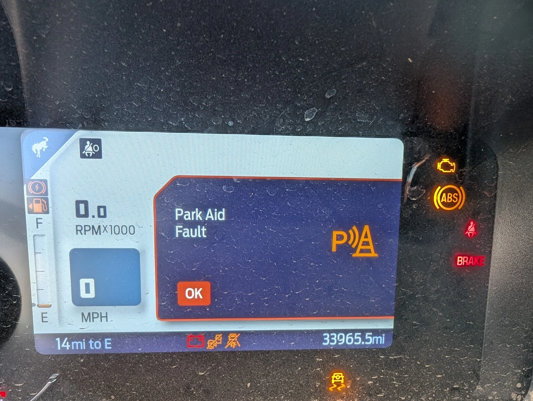

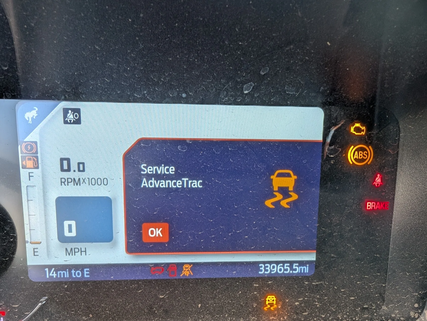

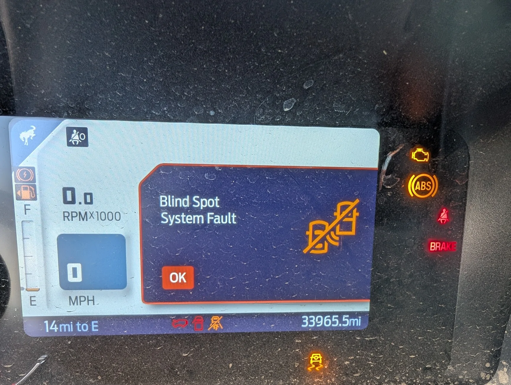

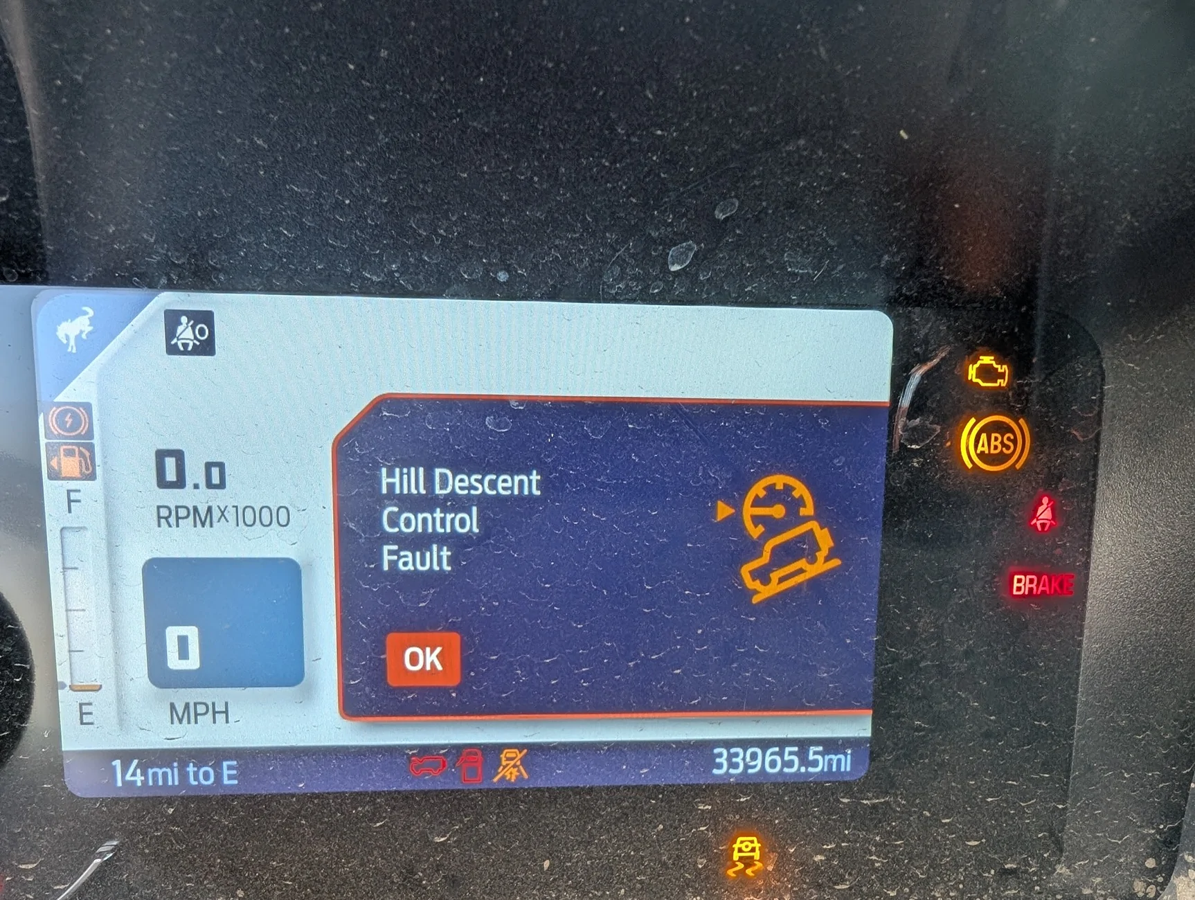

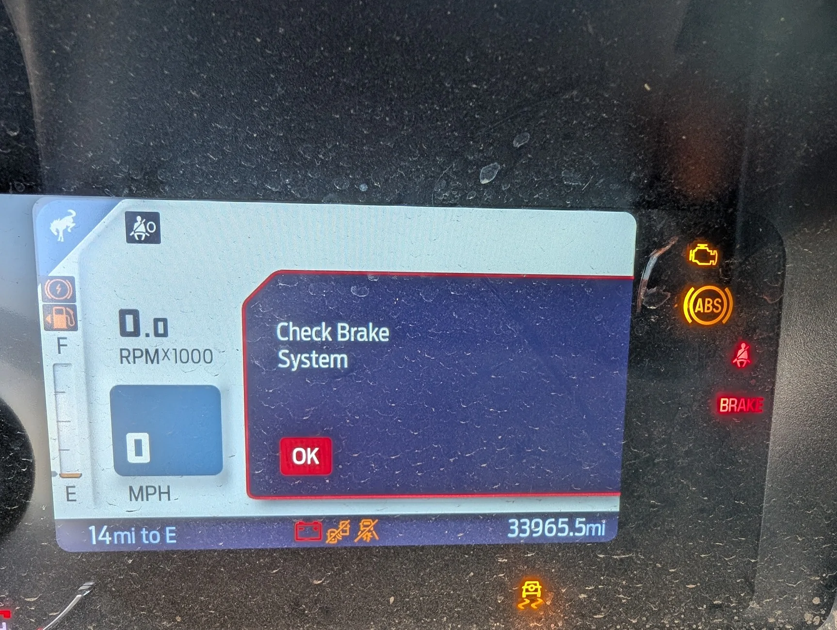

My Bronco hasn't been started in 6 months and I didn't leave it on a tender. Now the stock battery won't take a charge at all. I replaced the battery and now have a slew of faults.
If you know it is going to set for any length of time disconnect the negative battery terminal. 10mm wrench and about 30 seconds of time. You could use a tender also, but some do not always have access to a power outlet. Disconnecting the battery cable is quick and works every time even if you don't have a power source.
