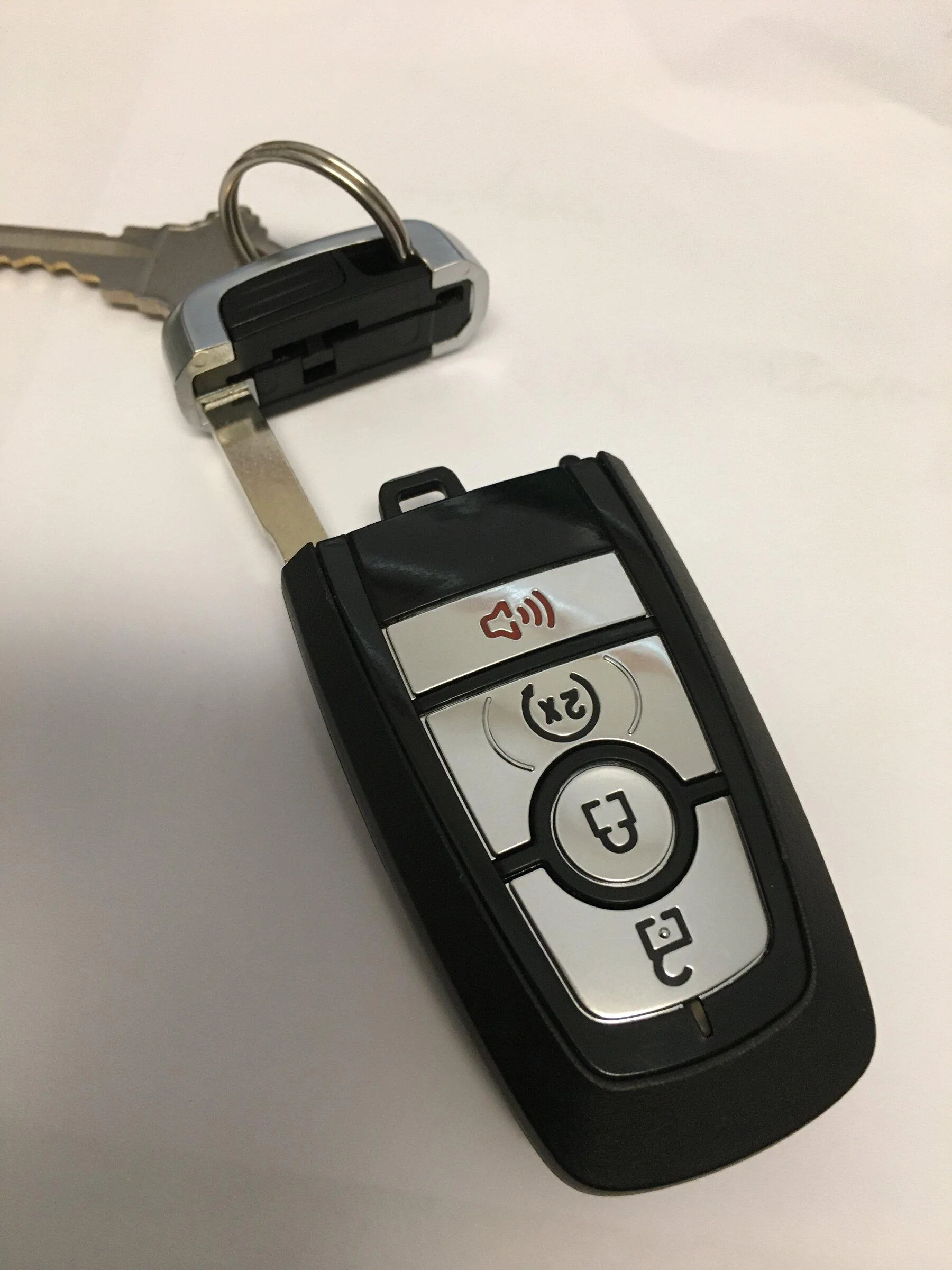

Maybe this is already known....but still good info.
If your FOB battery for push to start dies.....what can you do to strart your Bronco?
Do this:
Open consol between front seat and remove piece of foam in the bottom of consul.
Lay your dead FOB in the FOB shaped depression at the bottom of the consol. Push to start.
I have zero knowledge of the why....just the what. I took out my battery to test it.
Also most of you know that the FOB has a key to open your drivers door.
Ford Bronco Key FOB Battery Dead IMG_1025

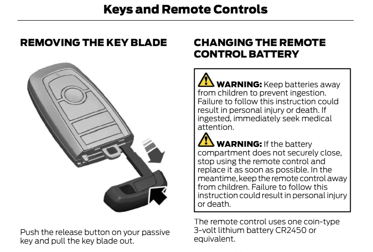

What battery is it ?

In the owners manual. All you have to do is read it.
Ford Bronco Key FOB Battery Dead Open 2021-Ford-Bronco-Owners-Manual-version-1B_om_EN-US_03_2021
