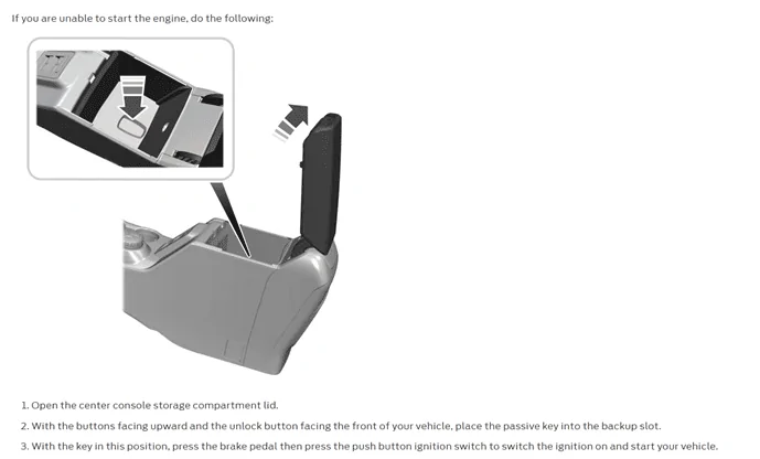

Not sure what caused the interference, but that is why most (if not all) vehicles with fobs have a backup. You can always unlock the doors using the key blade in the fob. If the fob battery is actually dead, you can place the fob in the bottom of the center console and still still start the engine.

Same thing happened to me a few weeks ago and then again today. Last time I couldn’t open the door but I could start it. Today I went to Walgreens and it wouldn’t lock. I left it unlocked and when I came back out it wouldn’t start. The odd thing is before I started it in the center compartment slot, the lock and unlock were working.
