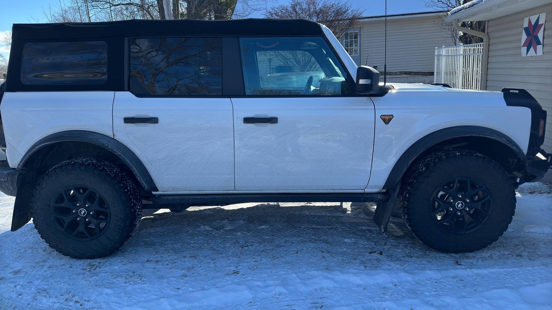

Ford Bronco SumoSprings Front Coil Spacers IMG_2033
I had installed the sumosprings in the front after installing DV8 Front MTO bumper and winch combo. I will upload after pictures as it did raise the front a bit and reduced the sluggish feeling in the suspension. I have non-sas badlands. I like the ride after install, and it does not feel too stiff. If anything, as an early post said, it returned the suspension to a factory feel. I hope this helps if someone was on the fence; for $180, it is a value versus $1,000 to get new heavier springs. I will also get the ones for the rear because it sits too low when I'm towing my boat.
