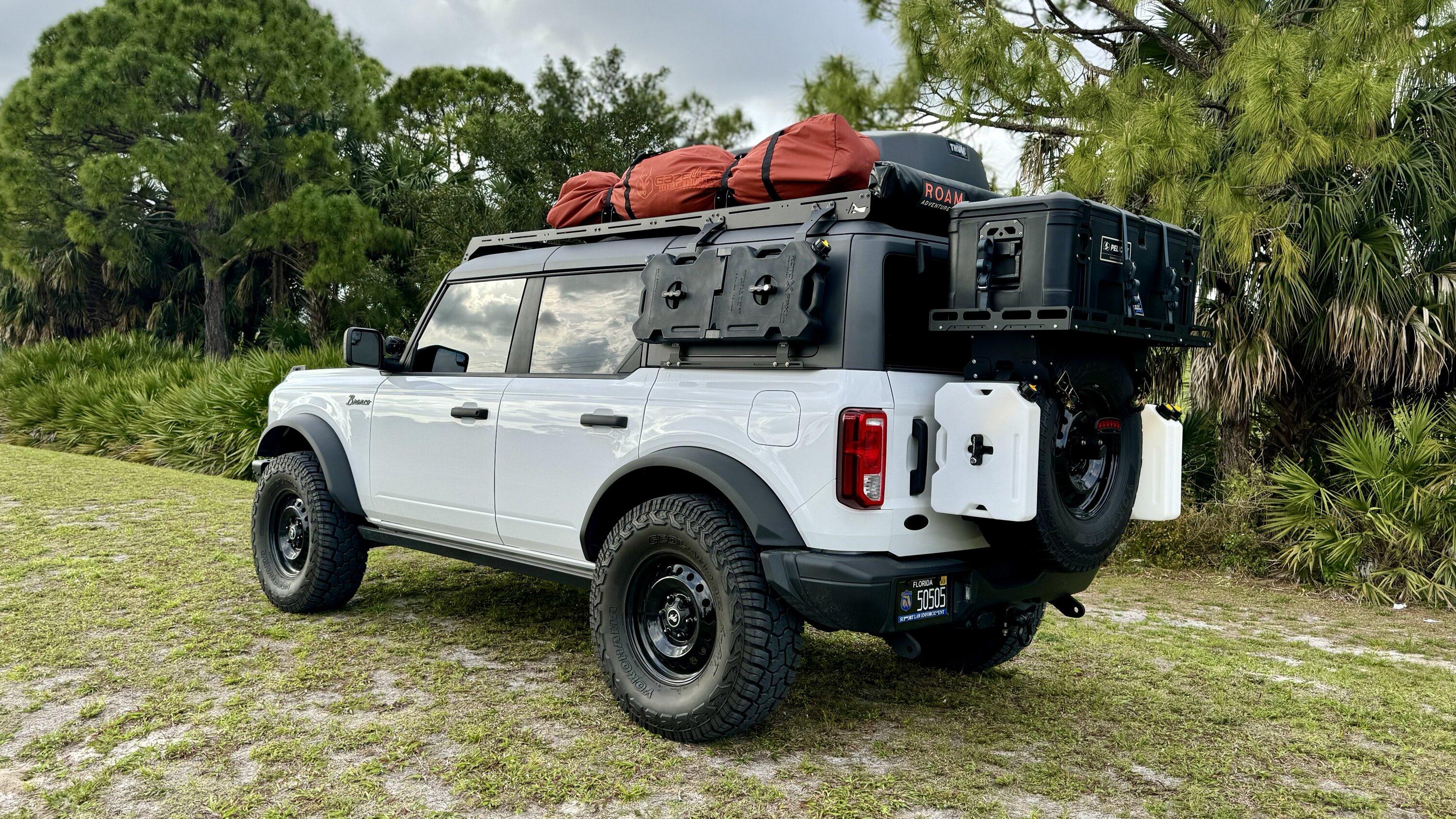

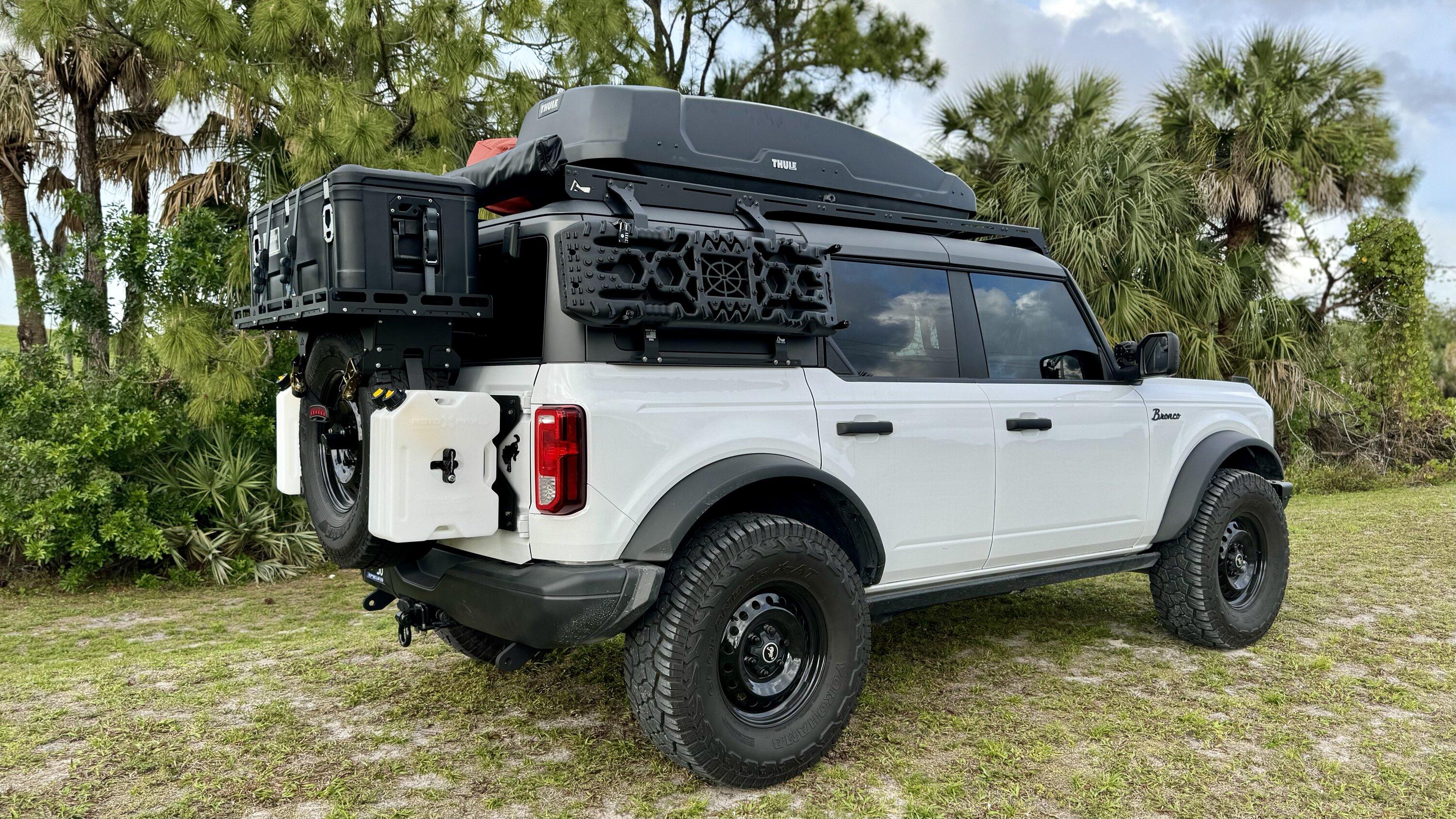

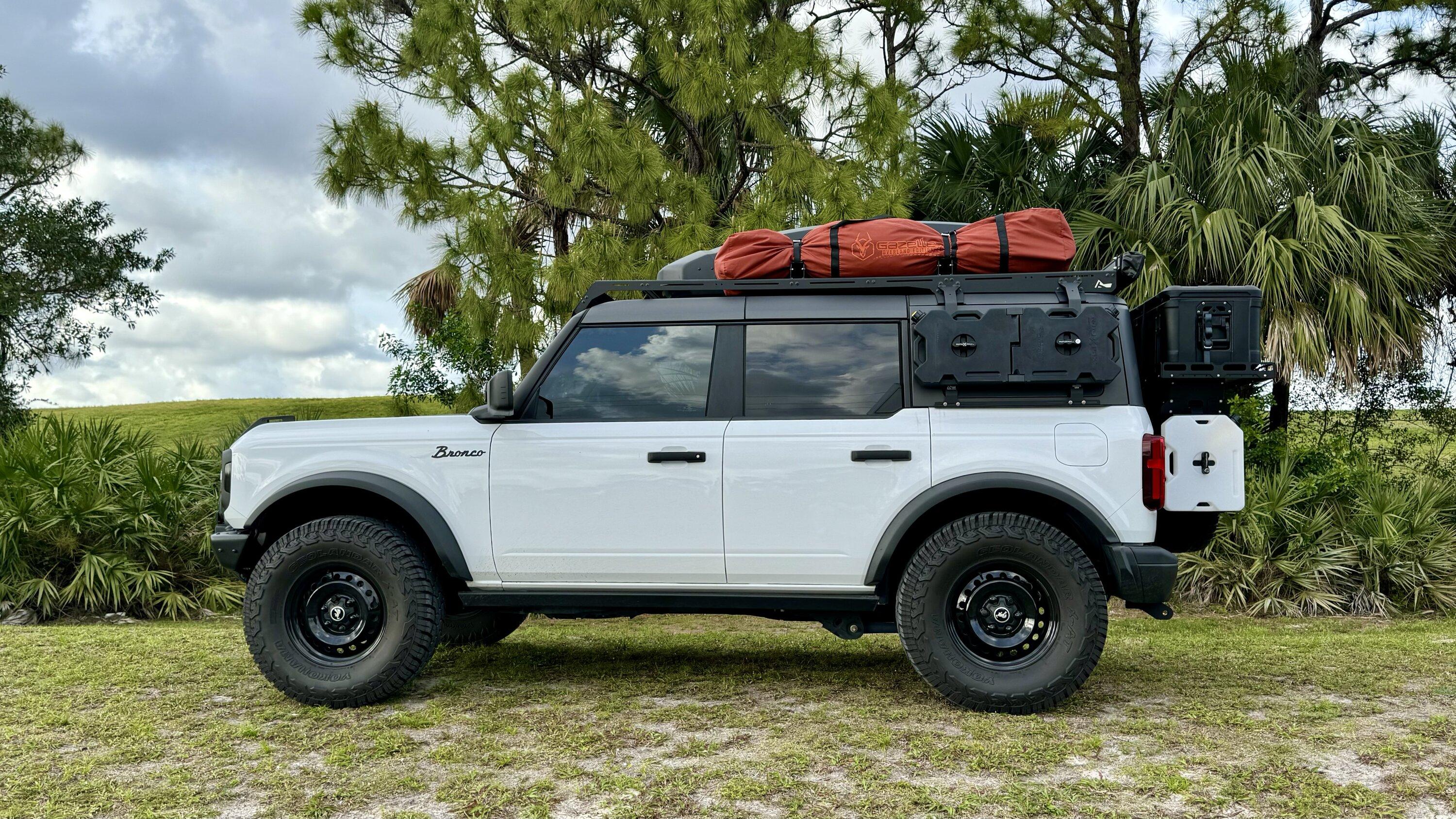

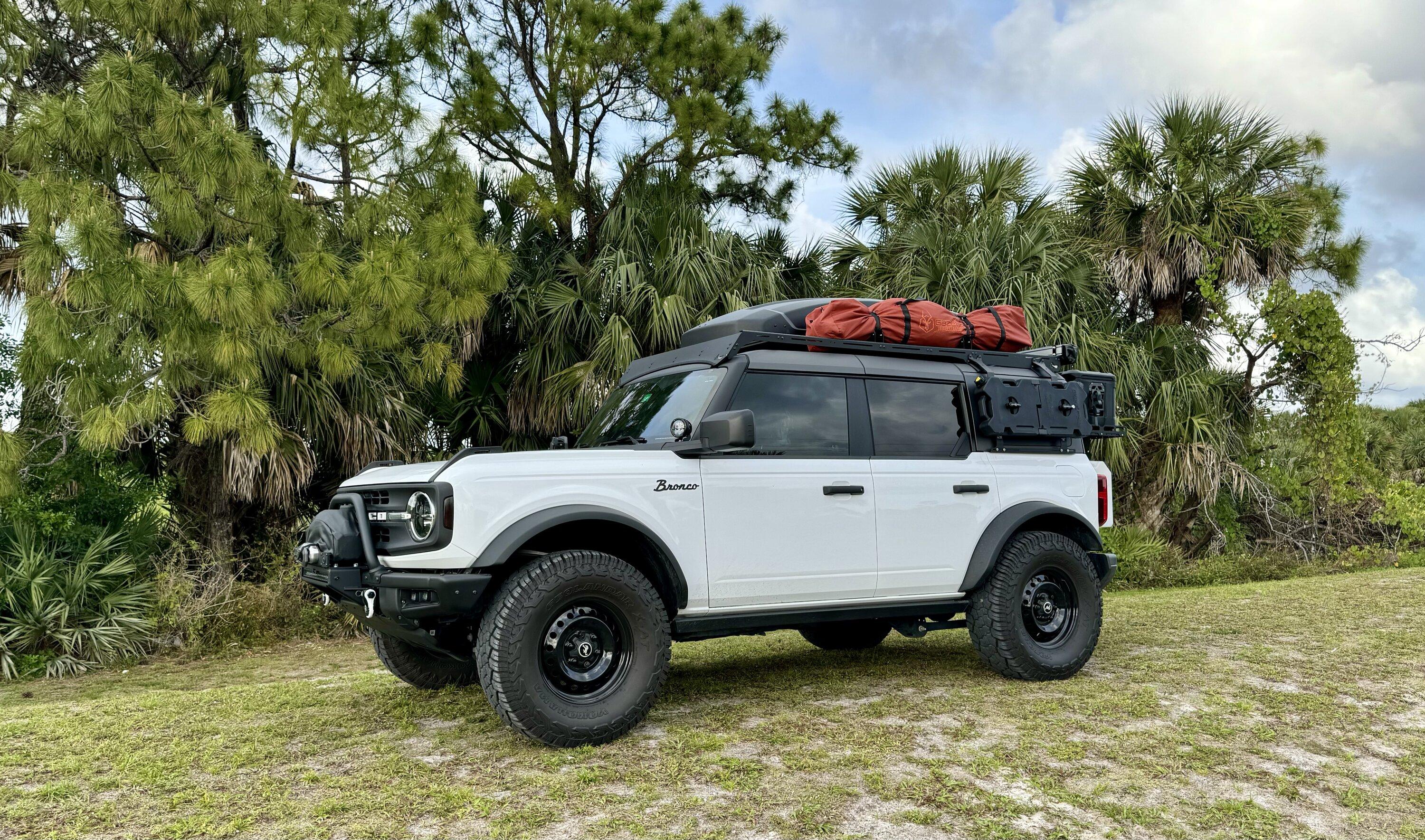

Thanks to the guys on here, I was able to install my Sumposprings plus 2 inches of Timbren's on each side. Unloaded, there is just about 1/2 inch gap. Fully loaded without water jugs filled up, the springs are compressed by about an inch. This is what is looks like now. I will fill up my Rotopaxes tomorrow and will take more pictures.
