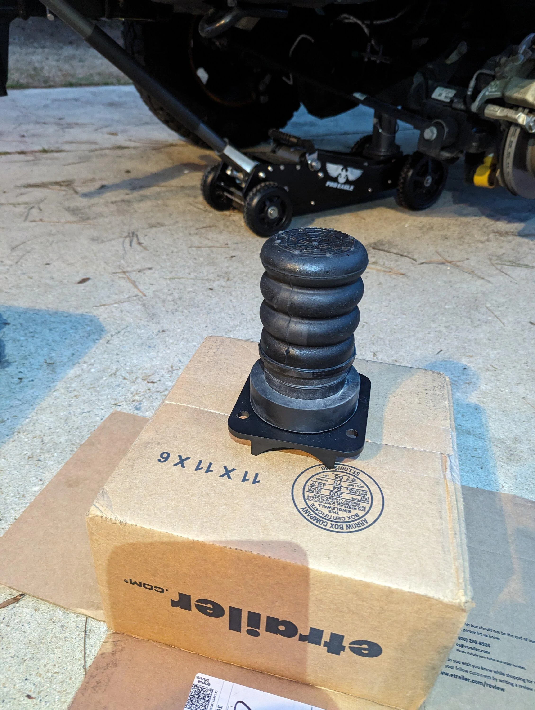

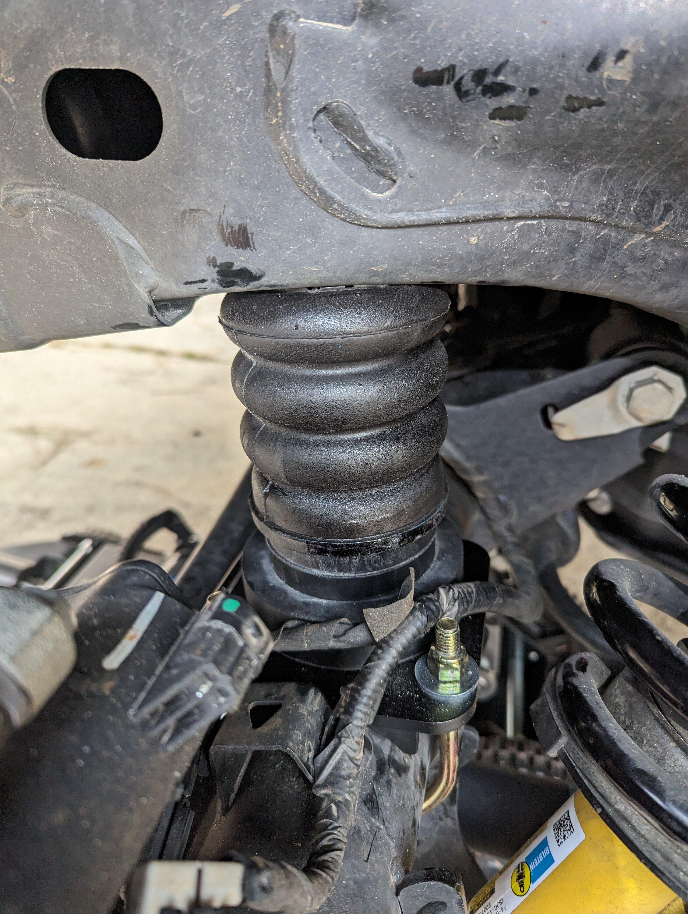

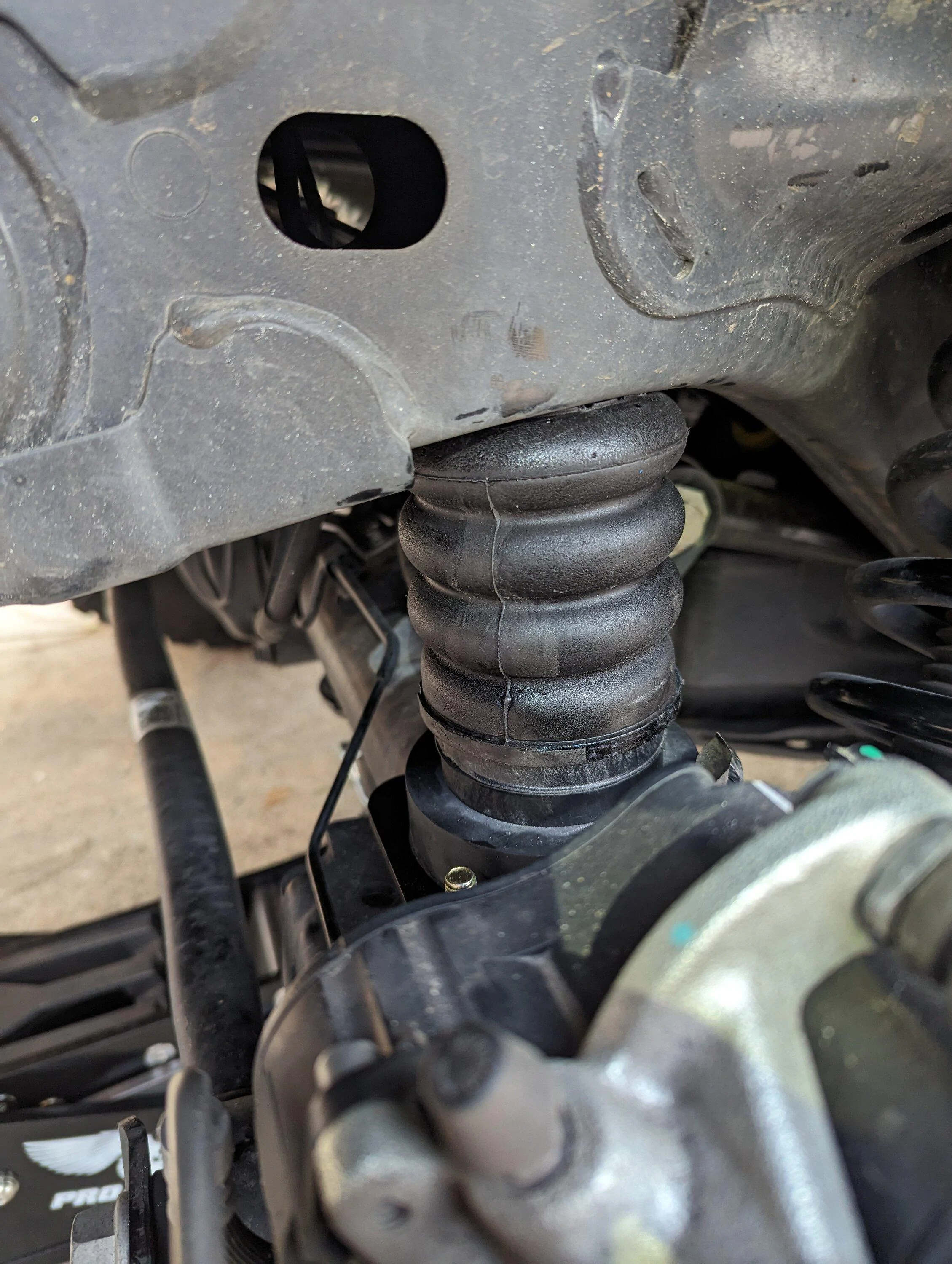

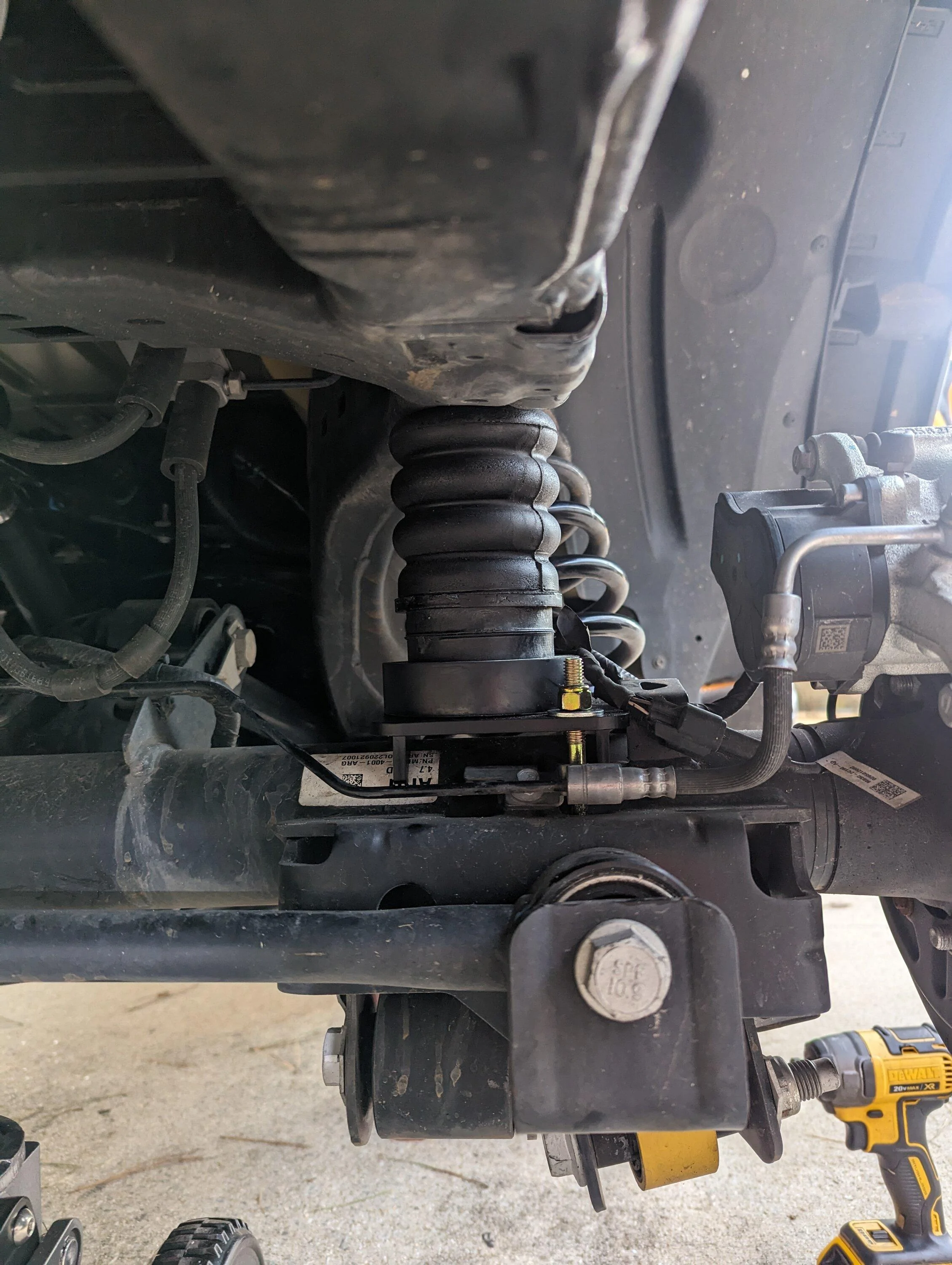

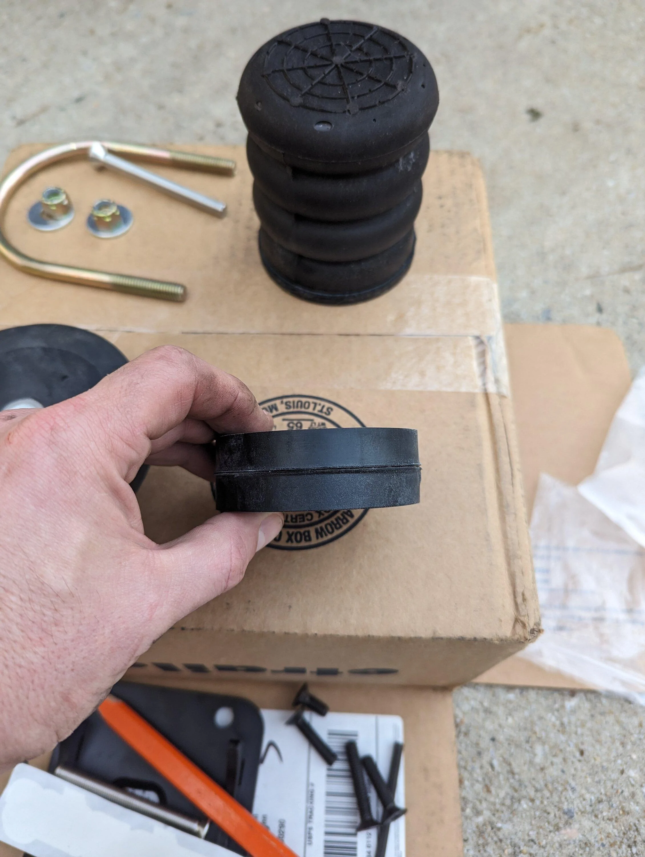

Great. I may skip that step. I also changed the length to 70 mm. Seems the 90 mm were a little to long based on the thread depth using their bolt with the 2 x 1/2 in spacers they provide. Did you cut the 90 mm bolts?
I used the two 1/2 inch spacers that come with the kit in conjunction with a 1 inch rubber Timbren spacer for a total of 2 inches on each side, hence the reason for using the 90mm.

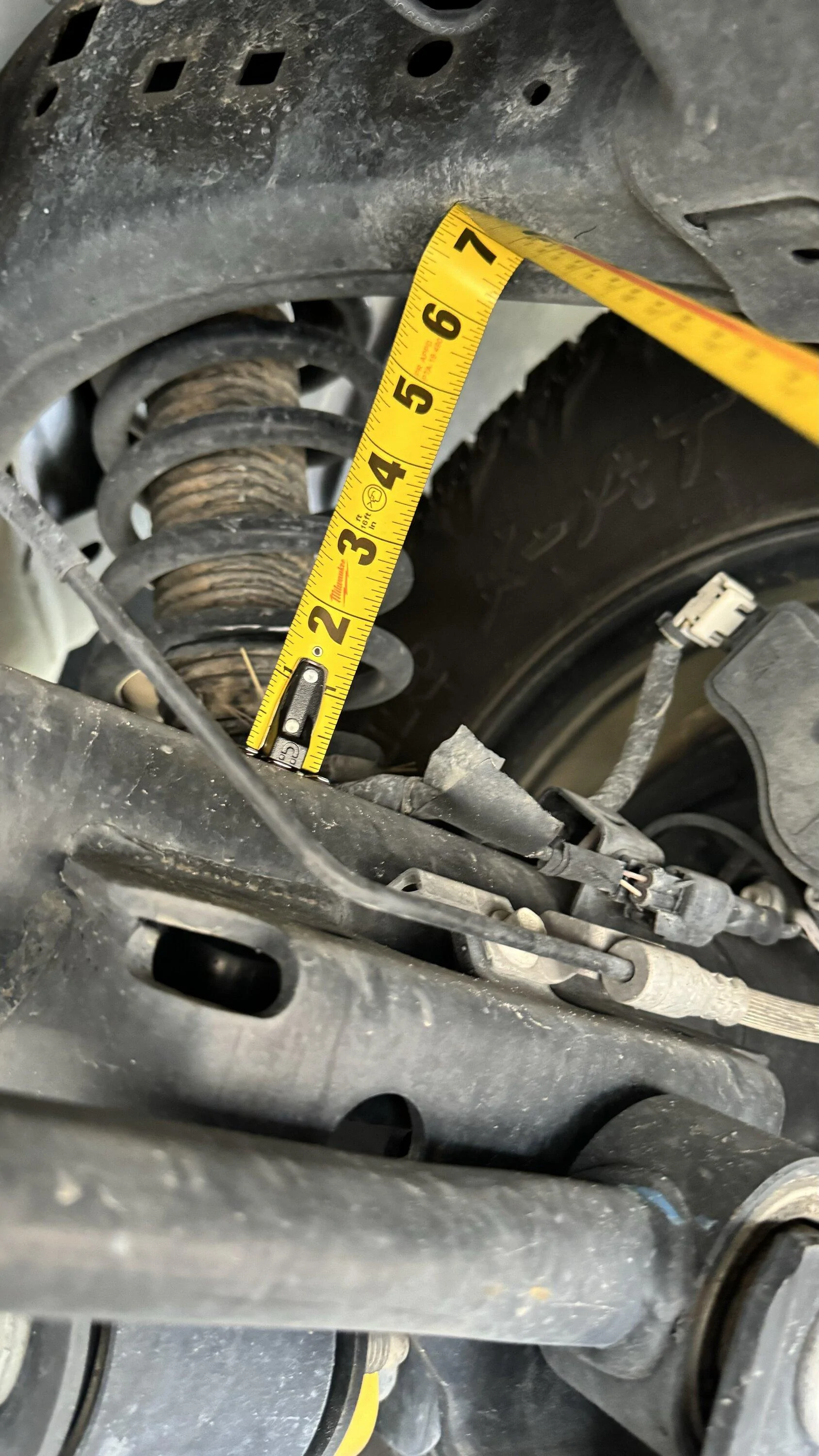

My Bronco Heritage has also a 7in gap.

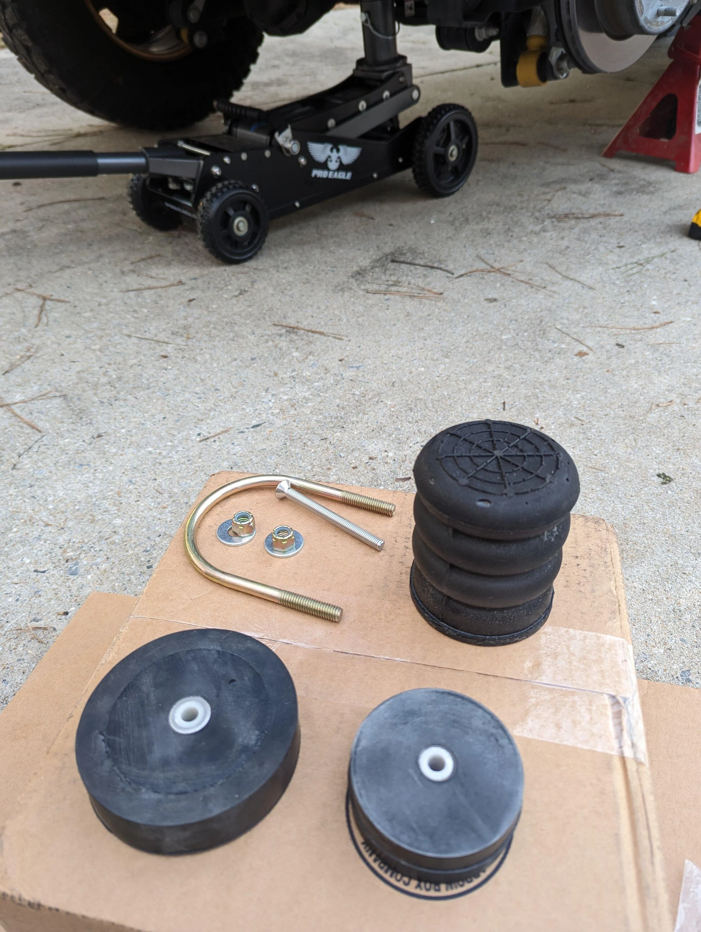

The Timbren 1in spacer is also offered with a 3/8in bushing (=9.5mm)
https://www.etrailer.com/Accessories-and-Parts/Timbren/A25723-90AH00.html
With this one, can I skip the plastic sleeves for the M8, correct ?
And what length of the M8 screw to use, 70 or 90 mm if planning to use the Timbren 1in and both supplied 1/2in spacers ?

As the sale ends tonight, went with the blue ones and 1" Timbren disc. I will get the M8 screw at the 70mm length (logical when you read the instruction).
