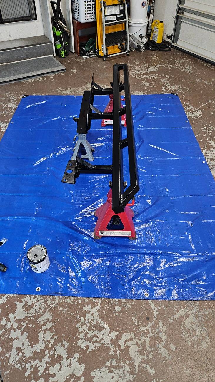

Rust-oleum Roll Bar and Chassis paint. I found it at Harbor Freight.
I'm using it to touch up powder coated parts.

Another vote for Rustolem. I use the Black Bedliner stuff - it matches most every textured powder coat out there, and has held up really well. The spray can isn't thick like Rhino Liner or LineX, it just has a very little bit of texture to it when it dries. And seems to hold up pretty good.
