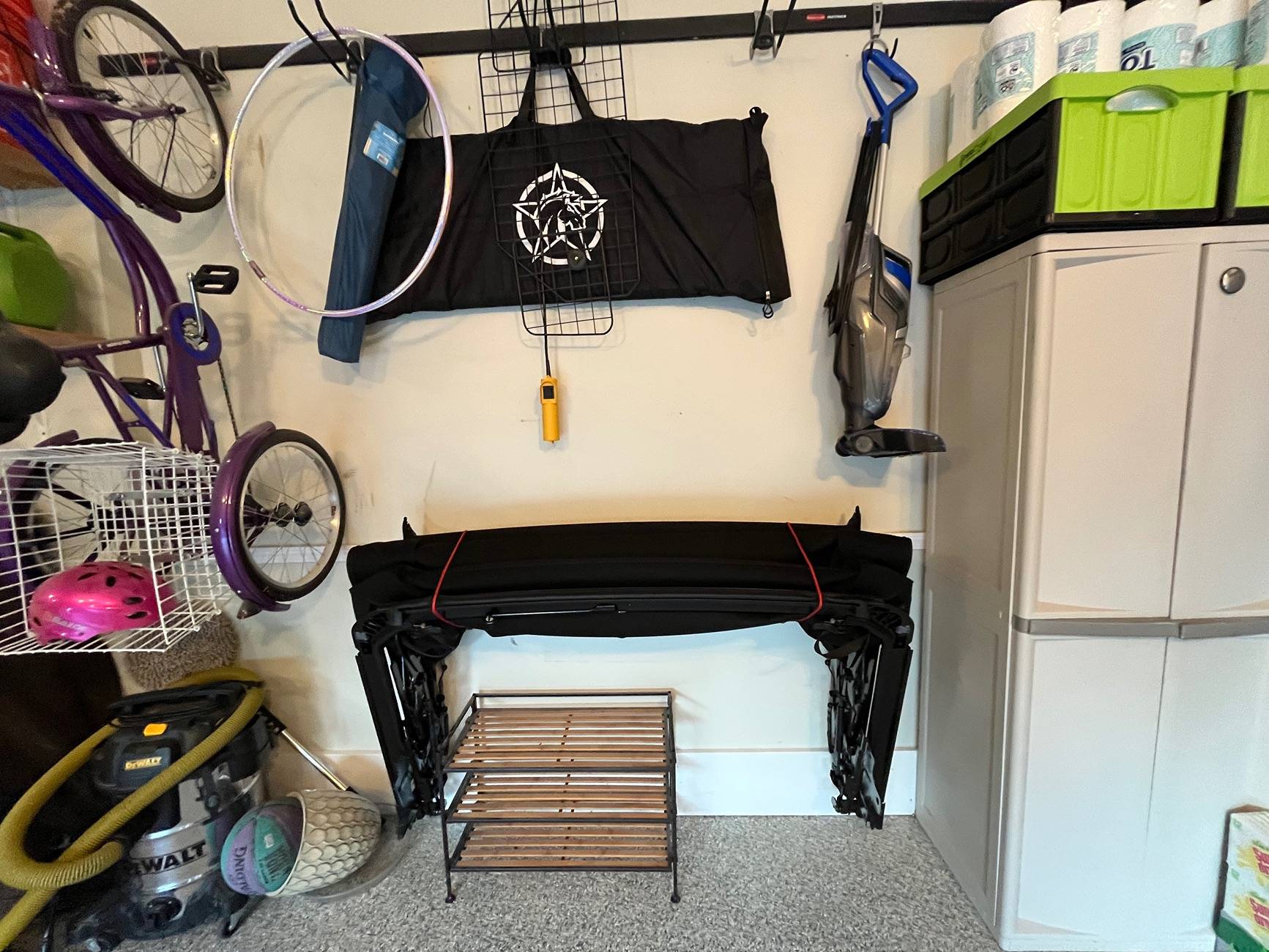

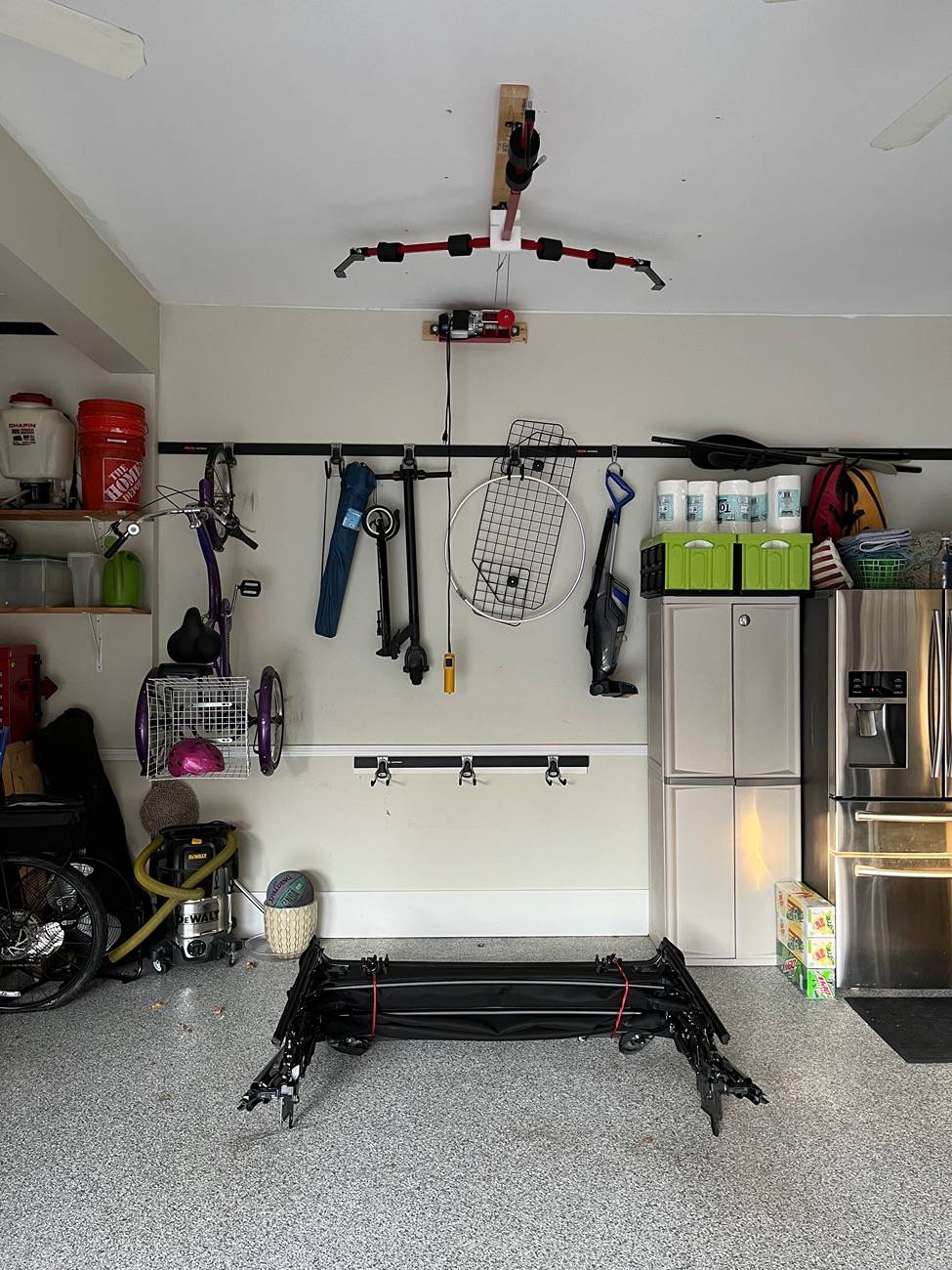

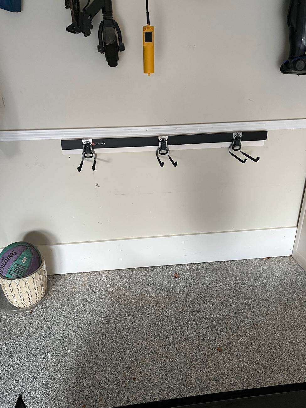

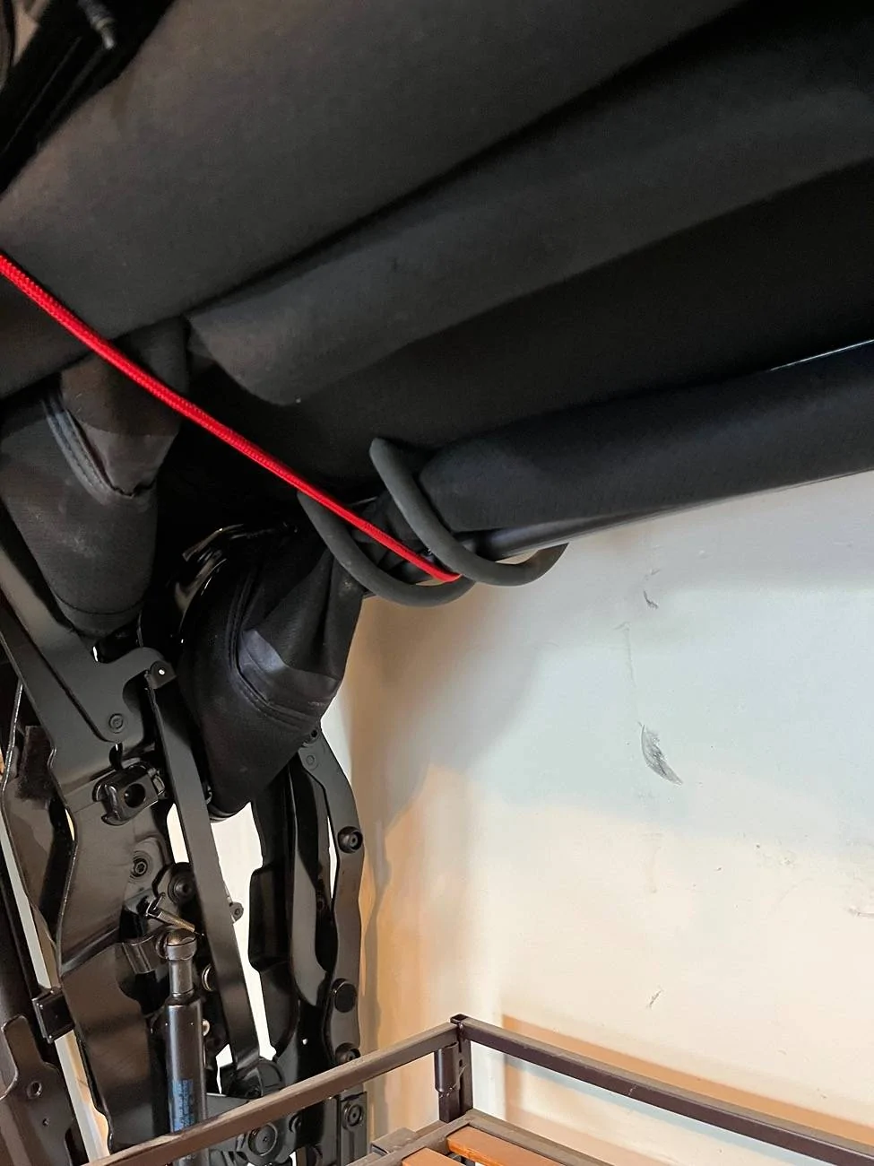

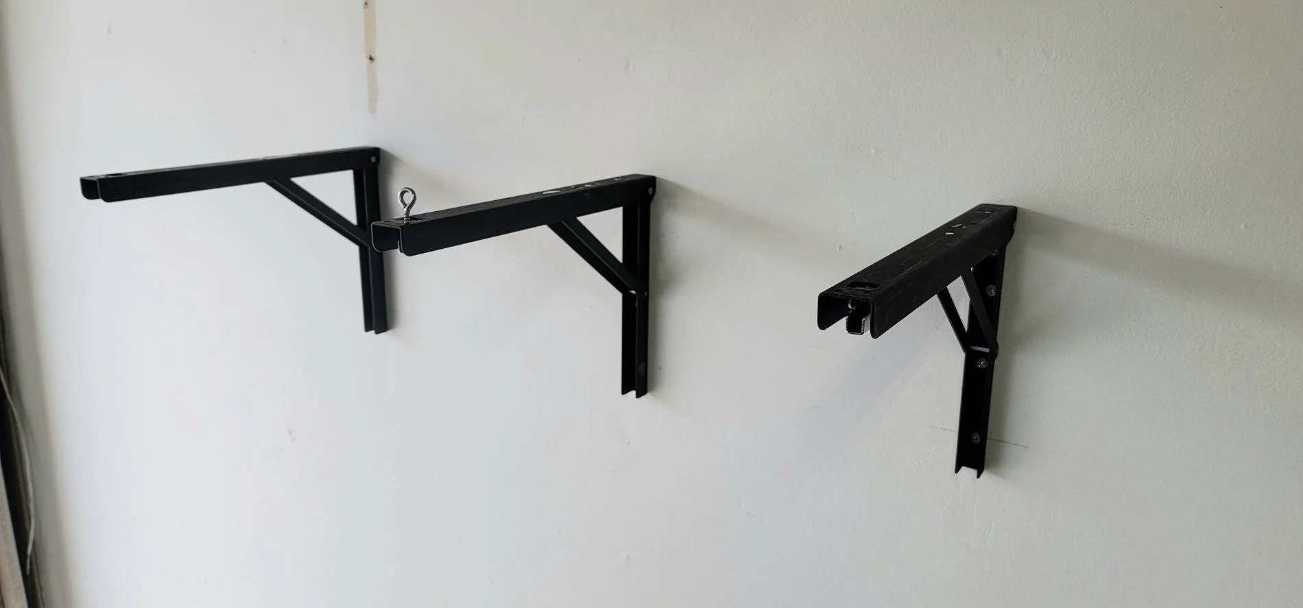

Problem solved. $70. Going to get a ratchet strap tomorrow instead of bungee cords to hold it closed. If you do something similar, you will need the big “U” type of hooks and not the flat arms like I show in the photo of just the bracket on the wall. Look at the photo from underneath the top to see the U hook bracket. It wants to lean forward, so the U hook actually holds it in place. The bracket is a 48 inch from Lowes, along with a piece of primed 1x4 anchored into the studs behind it. Will want 3 U brackets to clip onto it (sides and middle) to share the load.

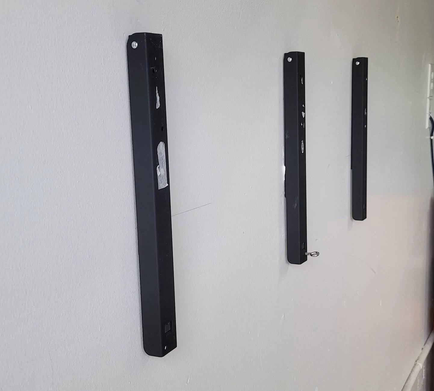

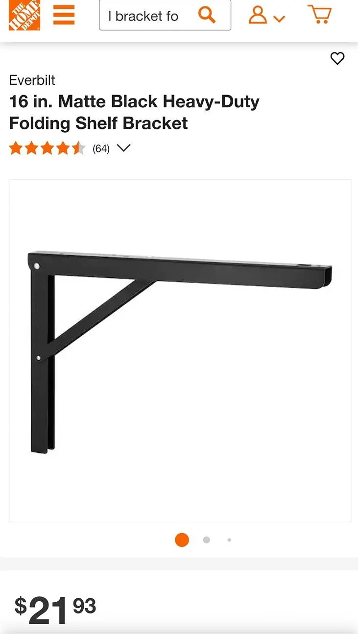

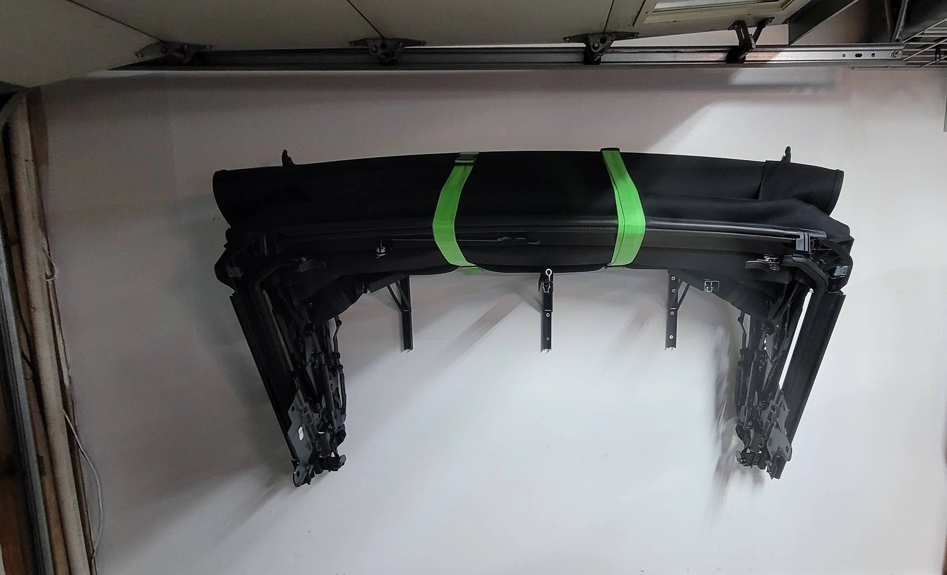

I got one of these installed in my garage. I slide it into a queen size mattress moving bag and seal it to keep bugs out. Has worked out so far!
