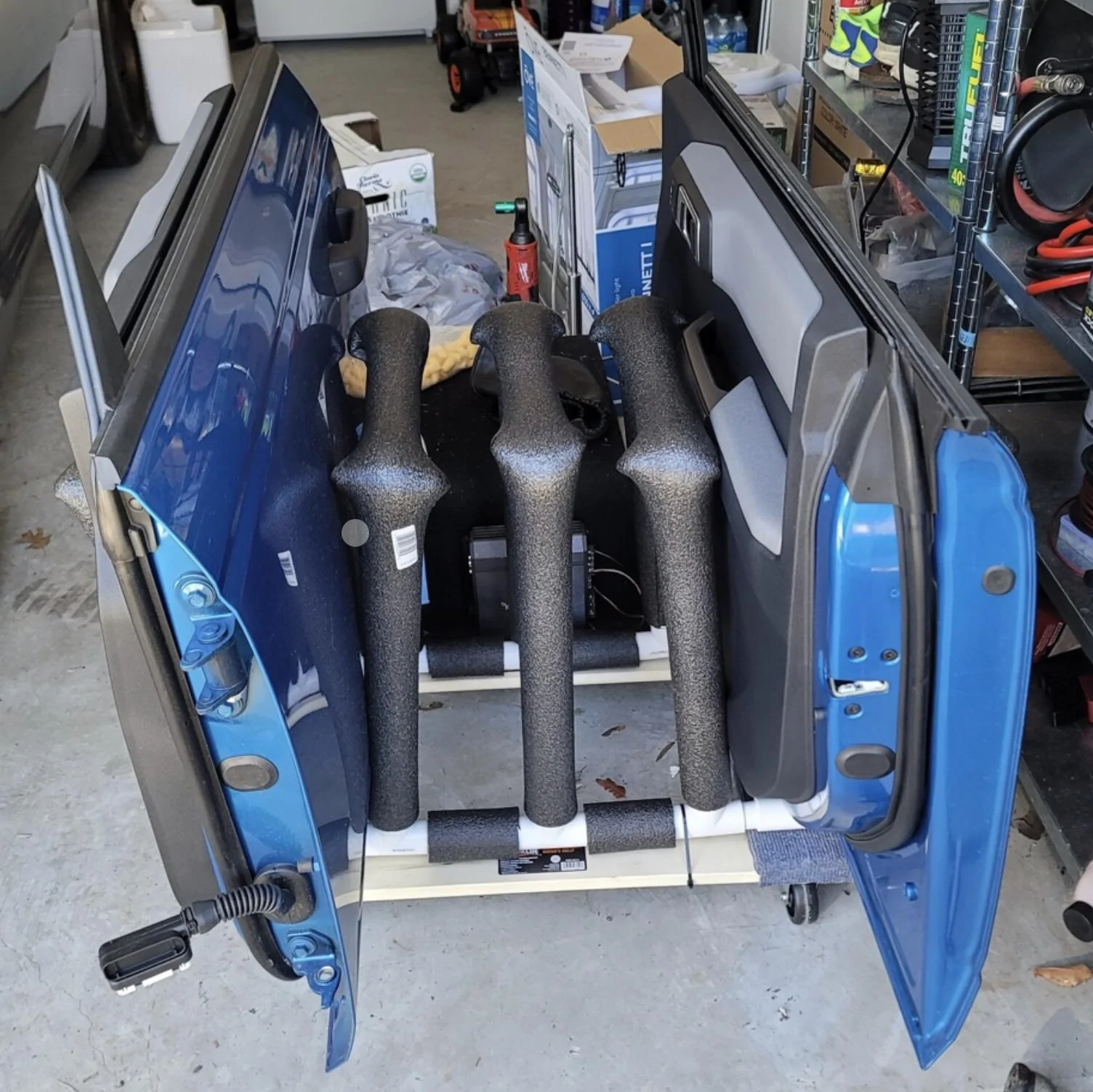

I’m almost done building something like this for about a $65 trip to Lowe’s. 30’ of 1” 450psi schedule 40 and a bunch of T’s/Elbows + some pipe wrap

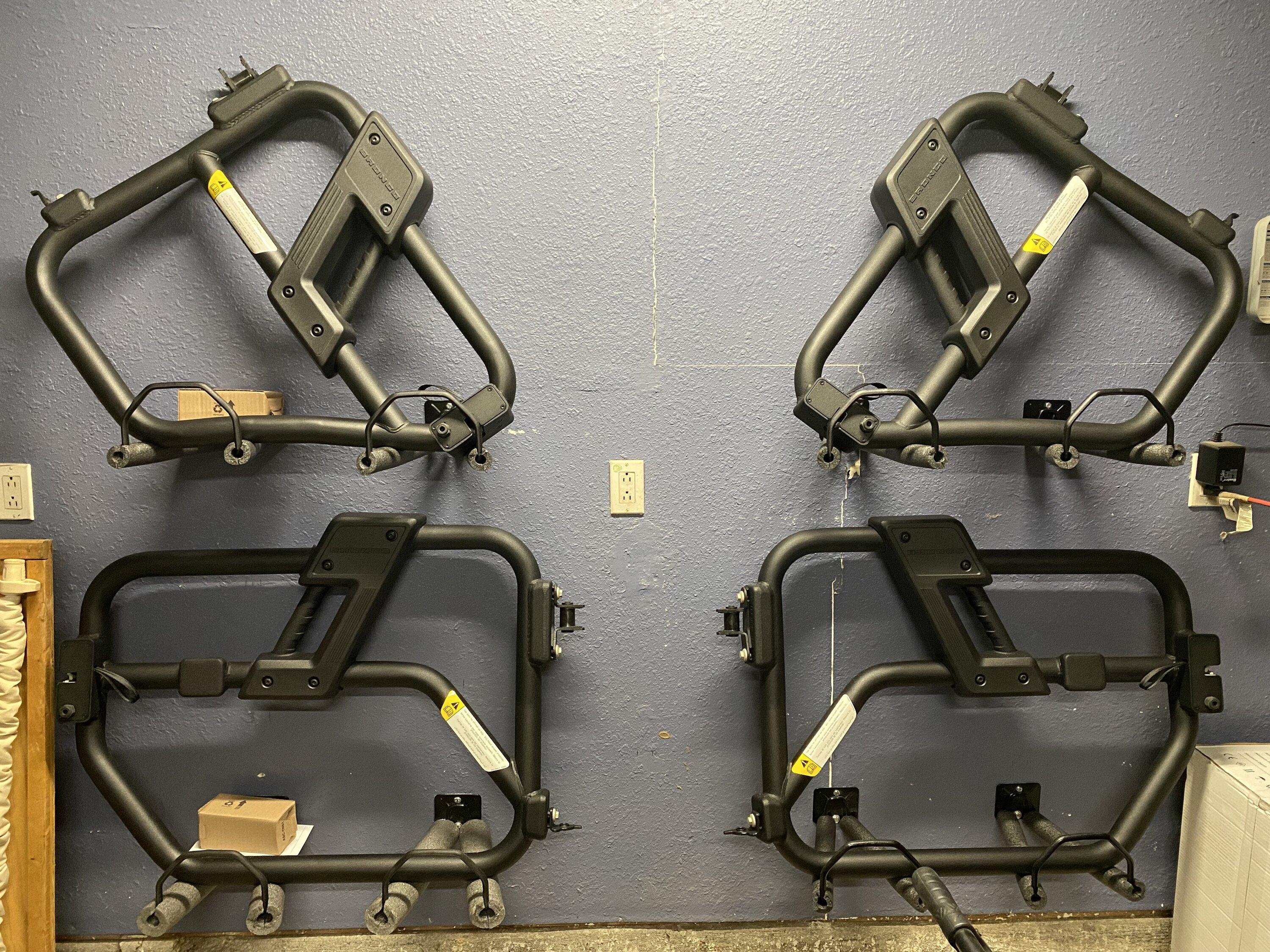

I used these wall mounts, claimed to support 50 lbs ea. However I used 1/4” lag screws to the stud vs their drywall anchors/screws. They seem pretty sturdy so far. I added 1/2 foam padding also. I measured and spaced according to the full doors.

I used these wall mounts, claimed to support 50 lbs. However I used 1/4” lag screws vs their drywall anchors/screws. They seem pretty sturdy so far. I added 1/2 foam padding also. I measured and spaced according to the full doors.

Total for all hooks/mounts, lags and foam was ~$75…

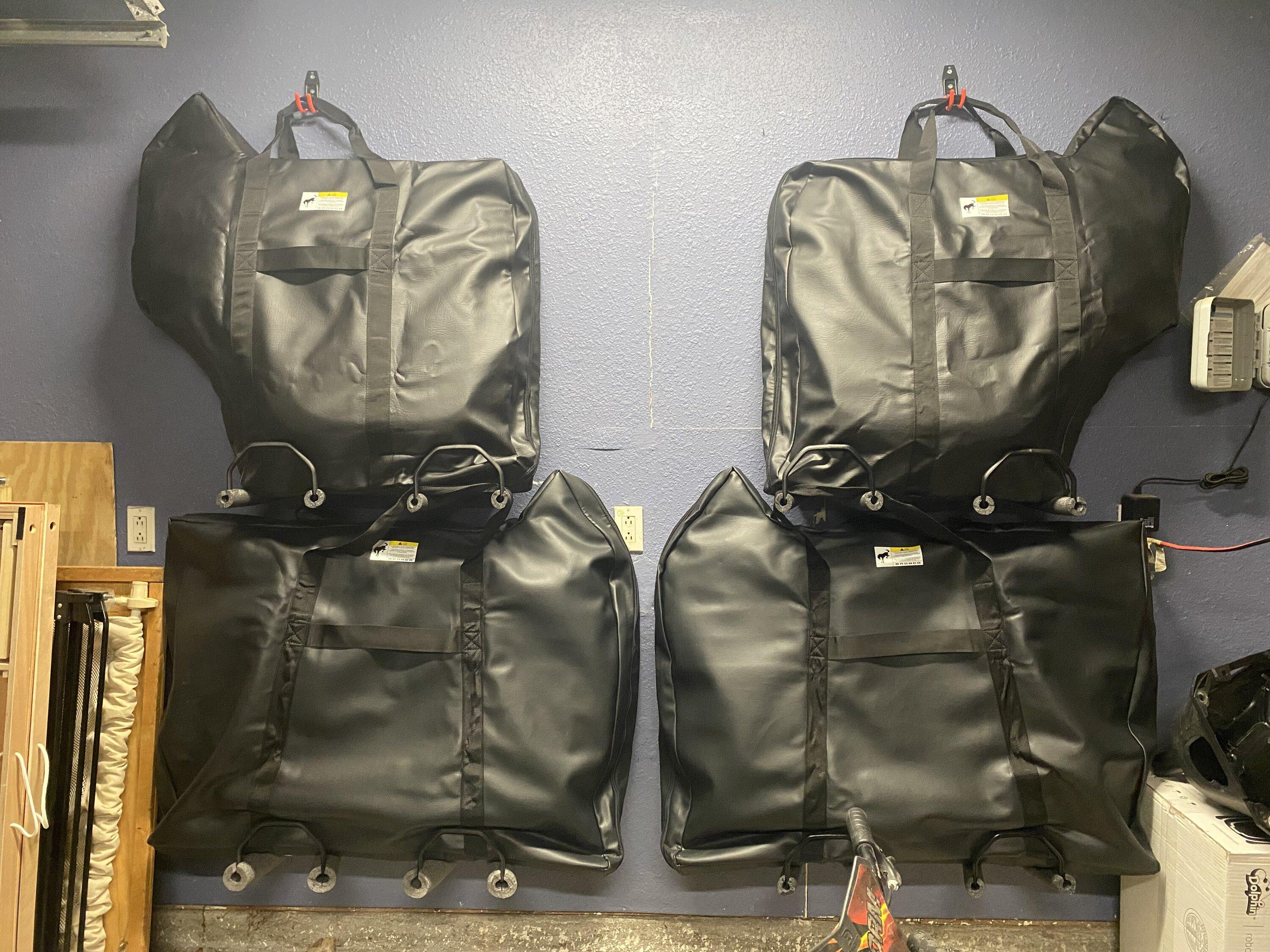

I also bought these as an extra safety measure to hang the bag handle on when I put the doors in bags and place on the mounts. I still need to add these. Rates to support 60 lbs. Also, be sure to use lag screws to the stud!

Doors stored
