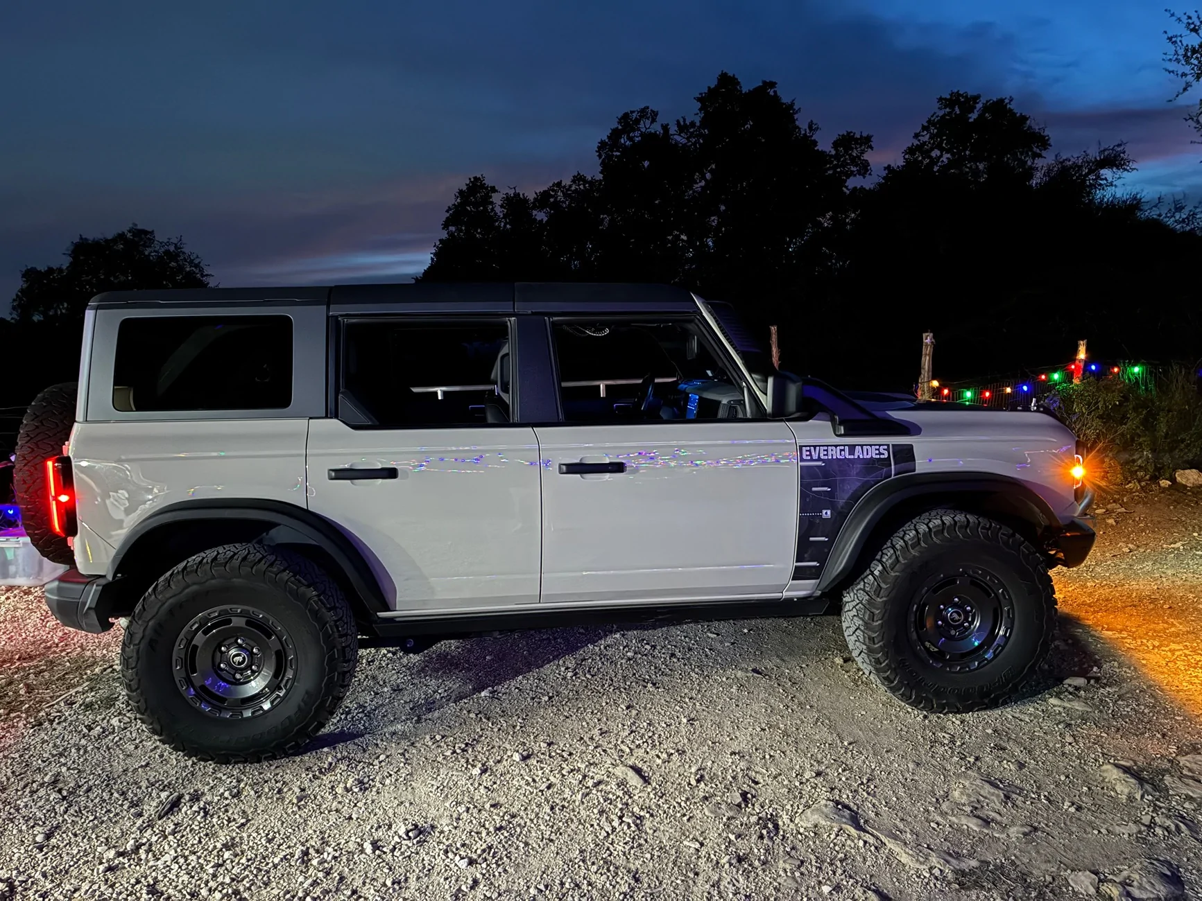

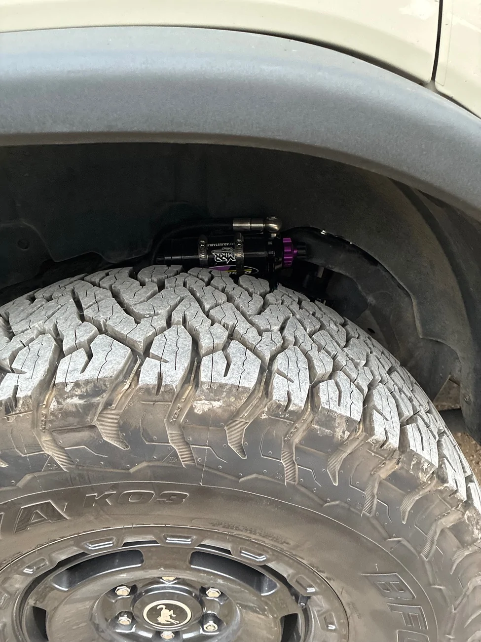

Anyone with an Everglades have the measument from the top of the tire to the fend flare? I put new Dobinsons MRRs on mine and I didn’t measure the before because I didn’t think it was going to be that high but right now I am sitting at 8-1/4”. I not hating it just curious how much of a lift it is. The second pic is a before shot
thanks for the help.

No measurements from tire to fender but do on ground.
These are from the ground to the fender at the centerline of the wheel. Rear left was 39 1/2” front left was 38 1/2”.
My right side was 1/2” lower on both oddly.
This was after 3k miles on factory setup.
I see you have different shocks and tires as well so these measurements I don’t think will help you see what changed but at least a benchmark from where it originally started.

Thanks, this is useful information. I am not looking for exact numbers just general. I think I have those same measurements somewhere I took about three years ago now that I think of it.
Since this suspension has a lift range I am trying to figure out if it is at it max height or the lowest setting. I told the shop to install it at the lowest setting. But now that I have driven it like this I don’t want to go lower. But if it is at its max height I need new UCAs.

If you look at the shock body you can see and measure where the adjustment collar is set at. Look at the manufacturer install instructions and that will show you where you’re sitting in the range of high or low.

If it helps mine are 41" front and back. I installed MRR's back last May with 2" lift. Dobinsons shows max lift is 2.5". I did install Icon DJ pro UCA and rear track bar drop bracket. I did not get the diff drop kit. Also installed the rockjock antirock front sway bar kit. I have been happy with shocks and with extra front flex from rockjock get slight tire rub when wheeling. The only dislike was the rear rebound adjustment screw very hard to get to. I set front and back at 50% and run high and low speed compression on low settings for intown and trail.

also I measured and I am at 40-5/8” front and 41” rears.
